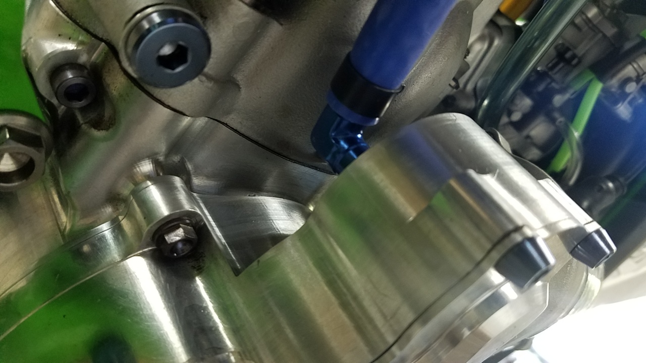

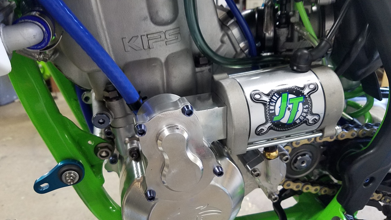

Here is another thing you can do ahead of time and prevent it from being a issue.
Relocate the vent off the back of the starter housing.
Some of these units will splash oil up and through the vent screen.
Messy :?

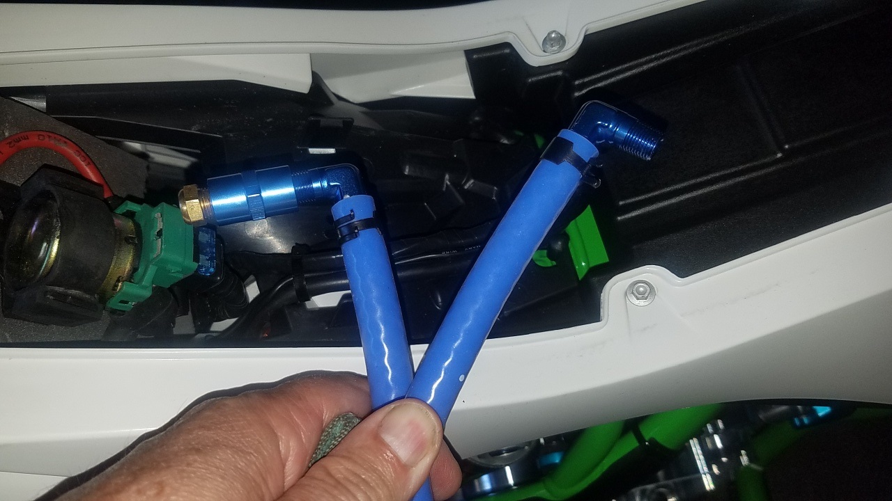

You unscrew the vent and replace it with a fitting.

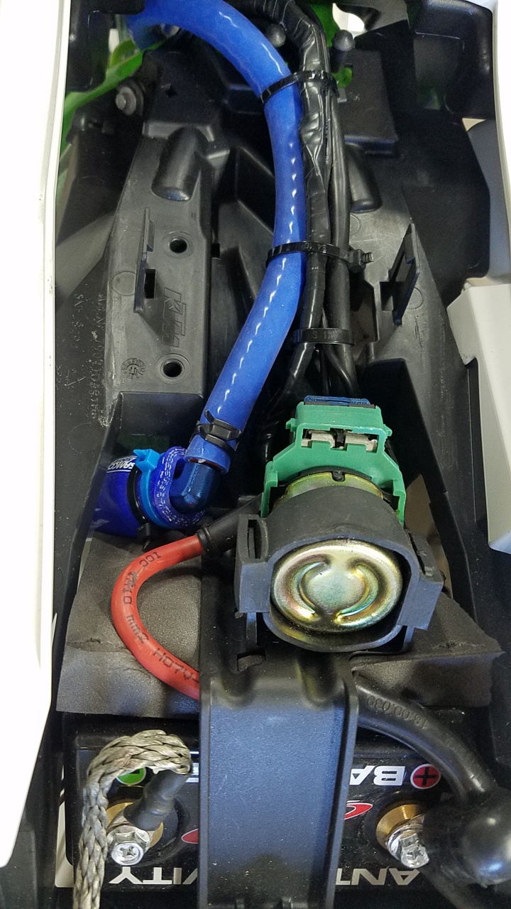

Attach some hose and run it up and into your air box.
It's a easy fix.
I'm not 100% sure but I think the fitting is 1/8 NPT.

One other thing I did was to put some radiator hose over the top of the vent and I left the hose long and packed it with some foam to act as a additional filter.
It does not leak and no issues.
At some point I will likely change this to make it a bit more factory looking :lol:

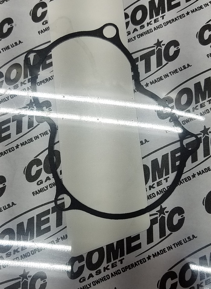

O-RING replacement.
If you remove your starter very much, ie for jetting changes (yes it's way easier to remove the starter when making carb changes), you will loose that O-ring fairly quickly.
The cross section of the O-Ring is 3.2mm.
the ID is approximately 24mm.
The Inspection plate gasket is available direct from Cometic.
It's actually listed as a Honda number through Cometic but it's the same for the Kawasaki.
HON CR500 PANTHERA E-START .018" AFM STARTER CAP
EC2184018AFM
