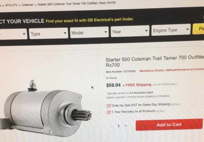

I have some useful information regarding that electric starter setup that may be of help to you (If it's the same as the cr500 one that is.) First of all, I believe the electric starter motor is made by DB electrical. It is used on machines like the Coleman ATV and UTVs. If it's the same starter as the CR500 one I have, it's part #SCH0093. It looks like to me that all Panthera has done is ground down a mounting point and flipped the cap around. The starter is CCW (counter clockwise) and is 9 tooth. I believe the supplied solenoid is also made by DB Electrical #SMU6096. Which brings me to another problem that I had this past week, I just felt compelled to tell you in case you have the same problem. I had the solenoid stick on me, which caused the starter to drain my battery. Obviously a bad chinese solenoid, I ended up buying a better solenoid (a genuine honda solenoid -- almost the same solenoid on every street bike, this one was off a 2014 CRF250L). Also, what electrical starter button are you going with? A ktm button? What kind of bike are you making this build in to? Is it a dual sport? As in, are you going to have plenty of accessories such as lights, a mirror, turn signals, etc? I have a ton of good information on all of that if you would be interested.

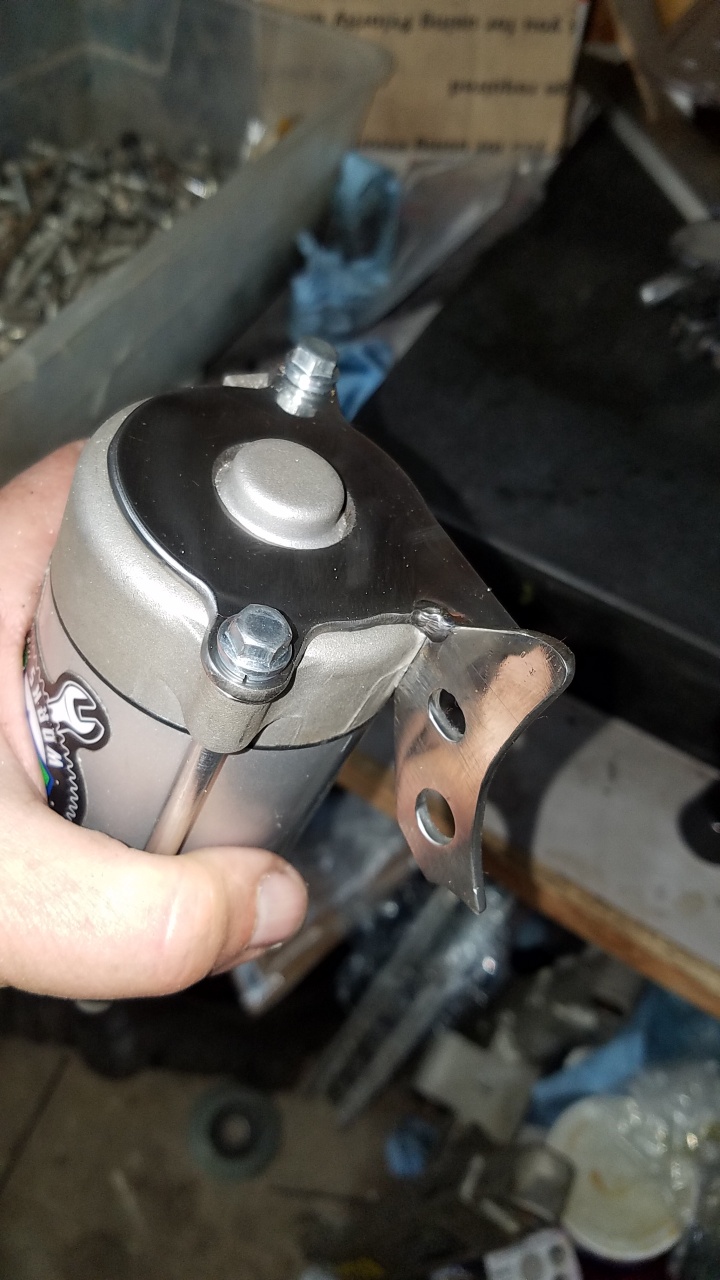

Re: KX500 Panthera Electric starter information

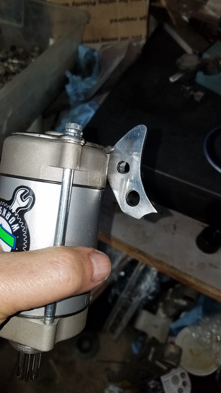

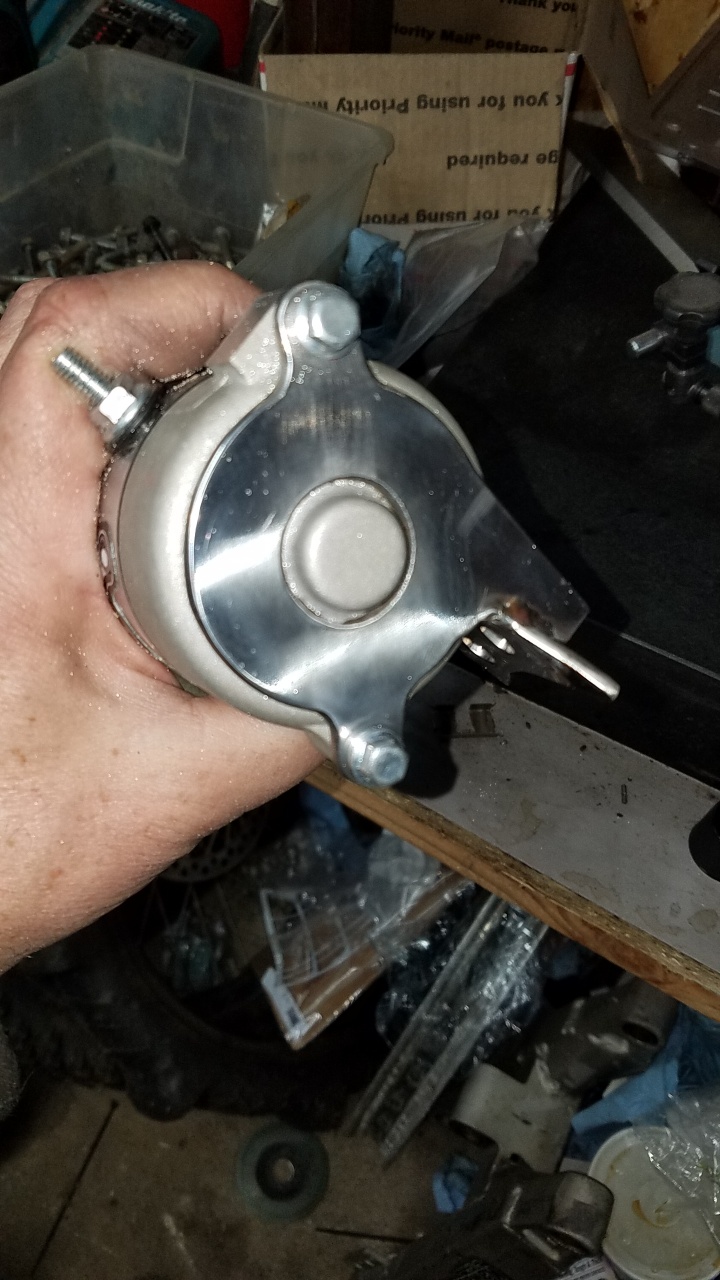

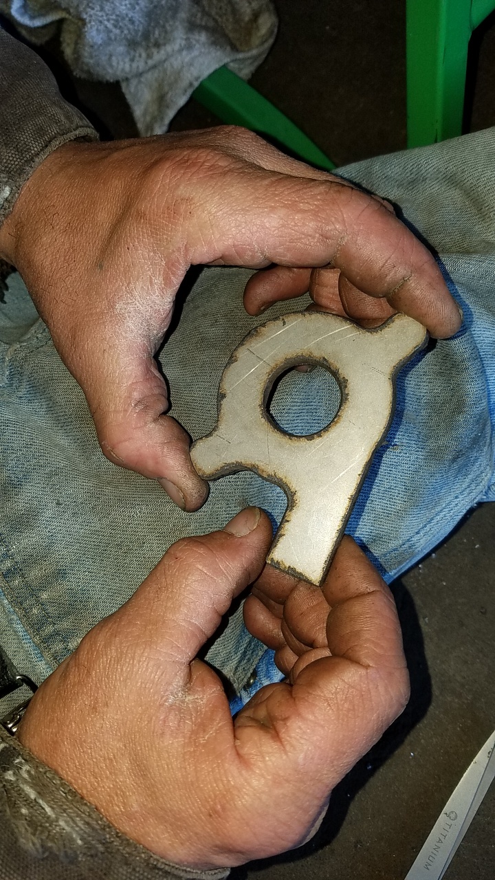

Jason tanner, myself and Travis Brewer put our heads together and all came up with the same idea.
First we needed a piece to fit on the back of the starter to support it.
I made a quick CAD drawing and Travis burned it out on his plasma machine out of some Stainless Steel.
After a few changes we came up with this.

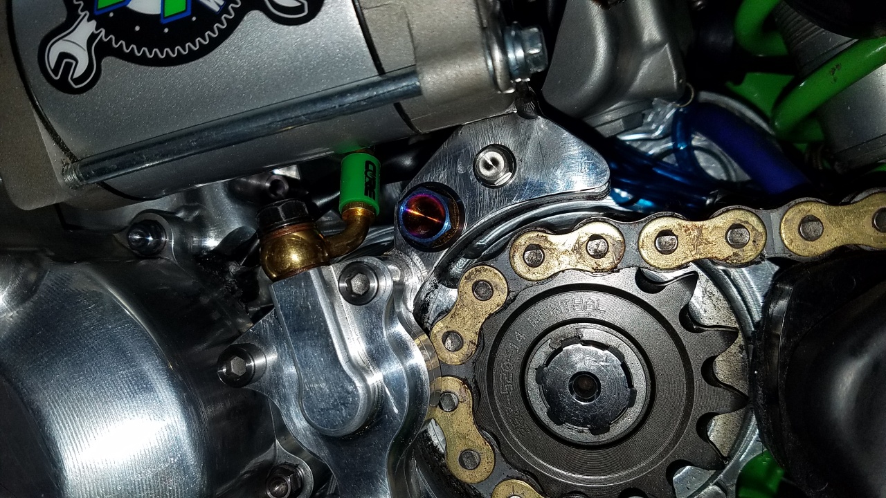

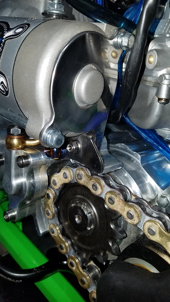

Next we made a piece that would weld to the previous bracket at a 90 degree angle.
Stainless Steel is incredibly strong.
Once Vince Brewer welded this thing together you could hang a pickup truck from it :shock:
We did not make a CAD drawing of it but we will be doing that once we make it to fit standard KX500 cases and not the TSR Billet cases.
I gave it a quick polish, mounted it to the bike, loaded up the bike and drove to Glen Helen for the MXA Shootout.
The starter had no issues and held up very well.
It wasn't perfect but with a little polishing you would never know that it did not come with the kit.
So, if you buy a Starter I would preempt the issue and make your own adapter similar to what we made.

Replacement starter info..
DB Electrical
SCH0093
I put that number into ebay and 59 bucks is about the least expensive I could find.
