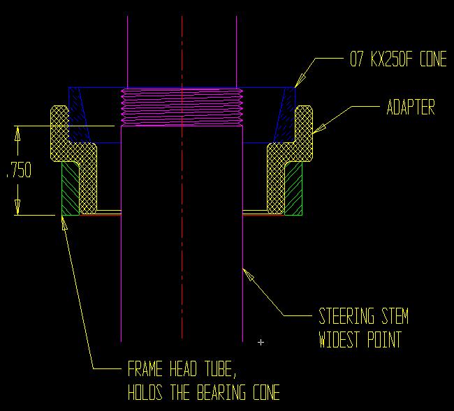

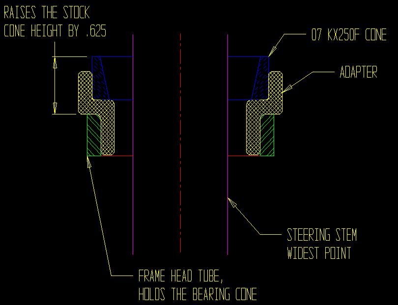

Here's a adapter I was thinking about..
This would allow for using all the factory bearings from the 07 KX250F.
I'm not sure about the addition of 5/8" of material.
It may be too much for the steering stem even though the 07 KX250F is longer then the KX500 stem.
But, I'll have to do some careful measuring and see what I can find out..
Posted: Wed Nov 06, 2013 11:20 pm
After a few more measurements I came to the conclusion that the threads need to be about 1/4" higher up the stem or we need a completely different adapter size.. :?
ADAPTER 2.JPG (41.51 KiB) Viewed 11325 times
Then again... perhaps I could turn some smaller diameter threads just above the where the existing threads are...
Probably not as I don't think the stem is long enough but it's worth checking... After all I've gone this far.. :D

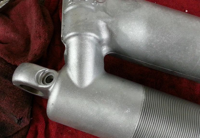

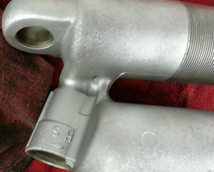

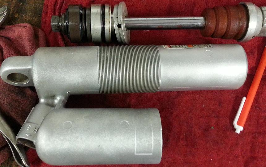

The next step is building a KX450F shock to fit the KX500.
It won't be easy but it is possible.
The most difficult thing is moving the reservoir...
Yeah, that will be a issue :o
And the clevis needs to be modified.
KX500 WITH A KX450F REAR SHOCK 101.JPG (83.53 KiB) Viewed 10767 times
