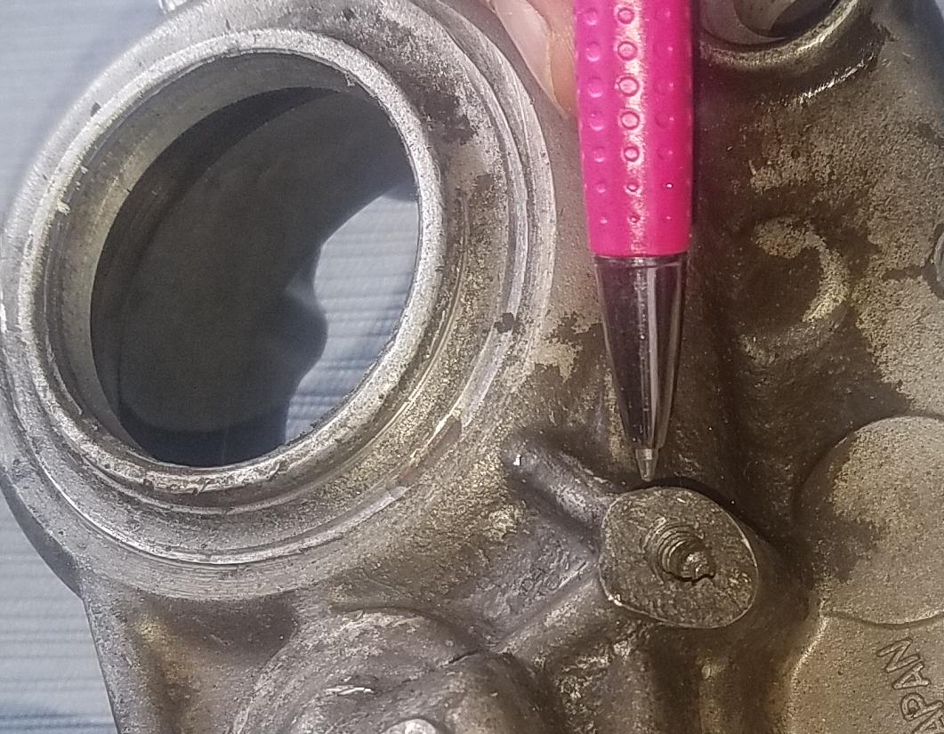

Plating is hashed..

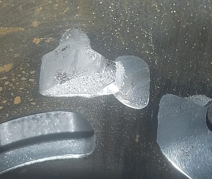

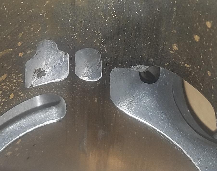

Exhaust Port work is rough..
KX GURU RACING 1992 KX500 SNOW BIKE ENGINE BUILD FOR BRENT 122.JPG (74.67 KiB) Viewed 10724 times

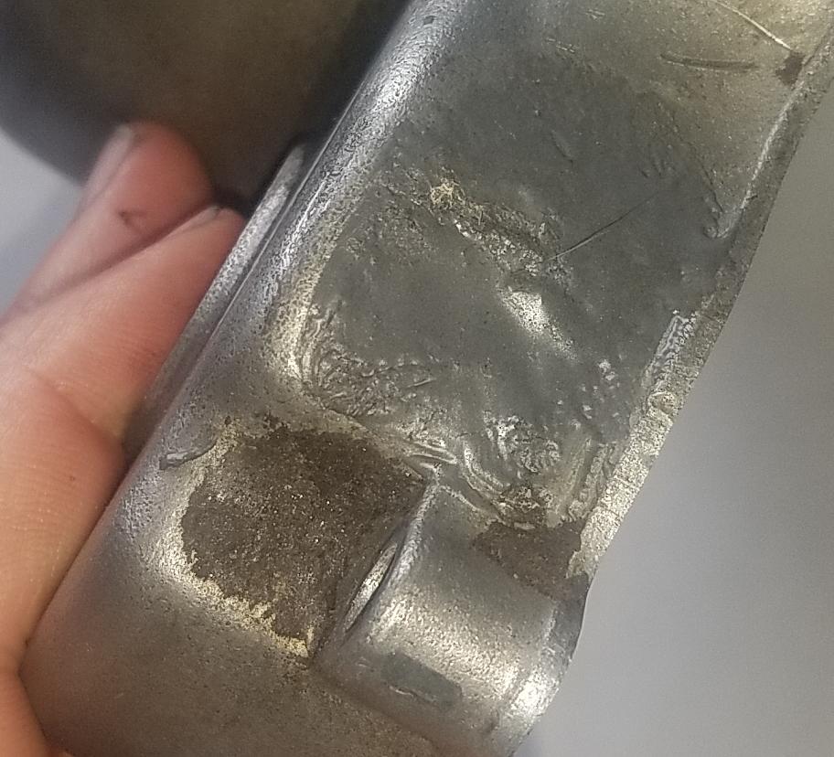

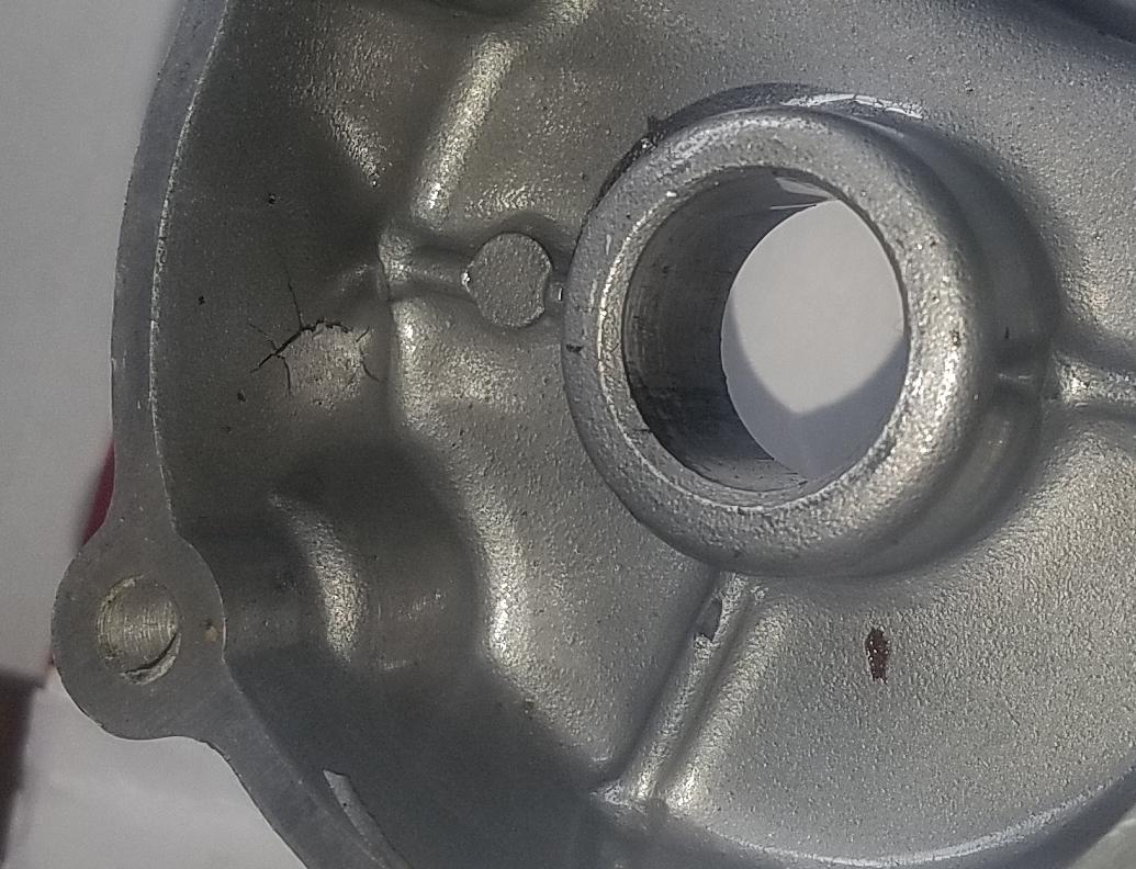

Clutch cover is jacked up..
KX GURU RACING 1992 KX500 SNOW BIKE ENGINE BUILD FOR BRENT 123.JPG (132.26 KiB) Viewed 10723 times
Oh, good ole JB Weld... Someone knew they had an issue.. :lol:
KX GURU RACING 1992 KX500 SNOW BIKE ENGINE BUILD FOR BRENT 124.JPG (106.74 KiB) Viewed 10723 times

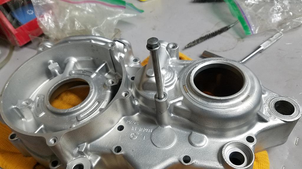

Posted: Sat Dec 10, 2016 3:40 am
Here is what the left case looks like just before I sent it off to weld..
KX GURU RACING 1992 KX500 SNOW BIKE ENGINE BUILD FOR BRENT 127.JPG (111 KiB) Viewed 10721 times
This is what we call our Pre-clean up..
Gotta make sure the welder has nice clean material to work with..

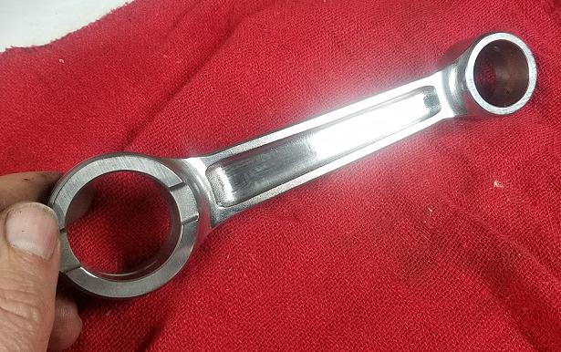

Wossner rod after polishing..
KX GURU RACING 1992 KX500 SNOW BIKE ENGINE BUILD FOR BRENT 131.JPG (55.24 KiB) Viewed 10720 times
KX GURU RACING 1992 KX500 SNOW BIKE ENGINE BUILD FOR BRENT 128.JPG (76.19 KiB) Viewed 10720 times
KX GURU RACING 1992 KX500 SNOW BIKE ENGINE BUILD FOR BRENT 129.JPG (57.08 KiB) Viewed 10720 times
KX GURU RACING 1992 KX500 SNOW BIKE ENGINE BUILD FOR BRENT 130.JPG (59.93 KiB) Viewed 10720 times
I like eye candy 8-)

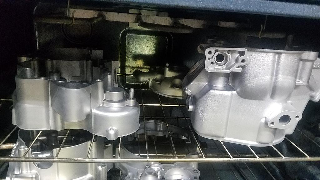

Posted: Sat Dec 10, 2016 3:51 am
The top rack has the parts for this project.
All these are in their pre-cleaning stage..
KX GURU RACING 1992 KX500 SNOW BIKE ENGINE BUILD FOR BRENT 132.JPG (117.13 KiB) Viewed 10719 times

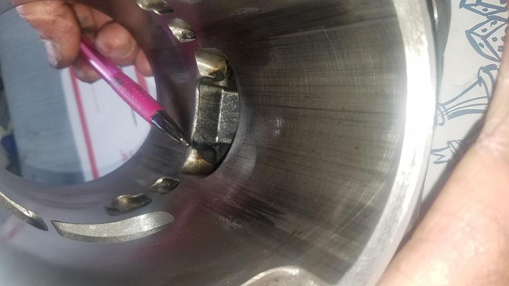

Posted: Mon Dec 12, 2016 6:52 pm
I went ahead and spent some time last night porting the cylinder.
Normally the exhaust ports look like this..
KX GURU RACING 1992 KX500 SNOW BIKE ENGINE BUILD FOR BRENT 133.JPG (90.38 KiB) Viewed 10682 times
But not for long... Just starting to whittle away some material..
KX GURU RACING 1992 KX500 SNOW BIKE ENGINE BUILD FOR BRENT 134.JPG (78.43 KiB) Viewed 10682 times
