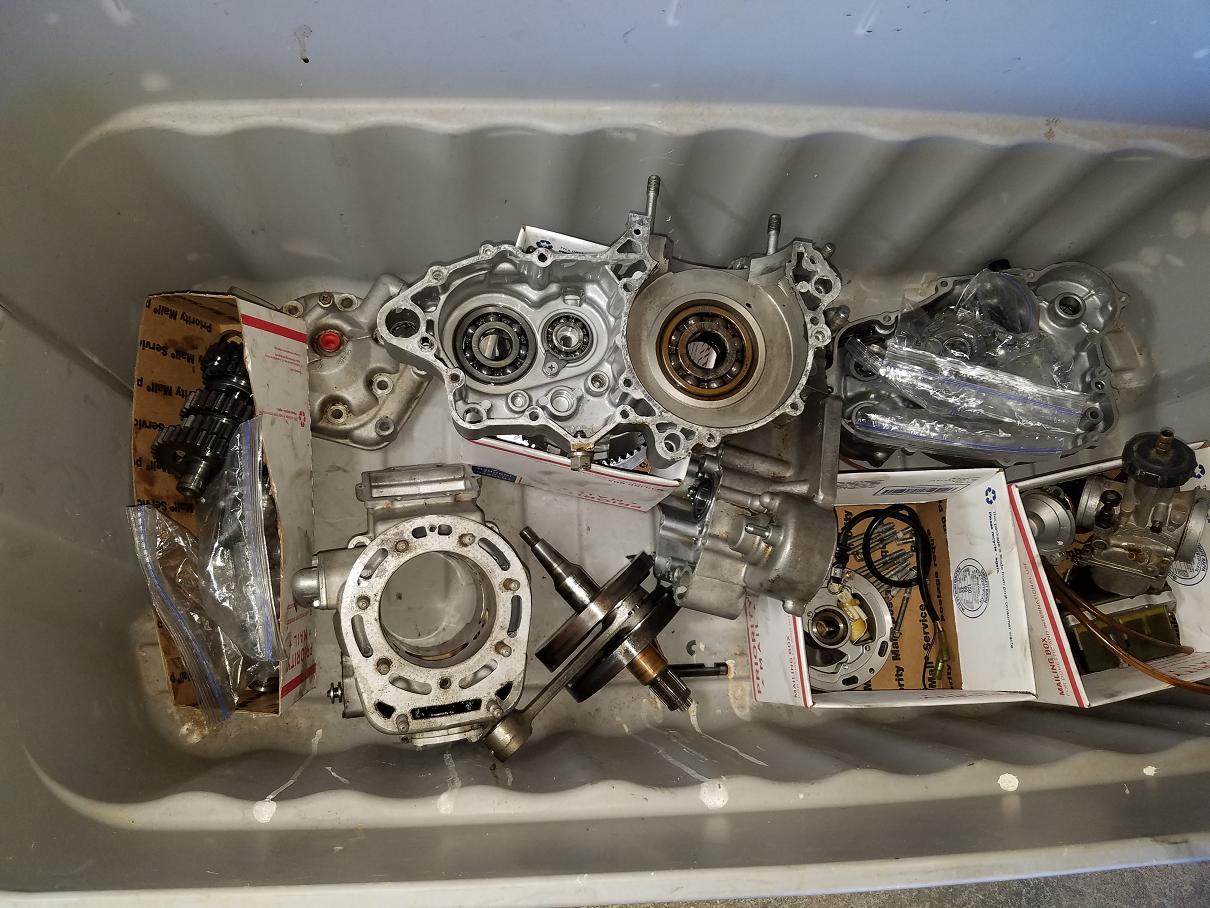

Ok, the plating was actually pretty good...
We could slap in a stock piston and ring set and run it....
But that isn't gonna happen
Flywheel weight...
Hmmmm... Maybe.... Maybe not ...
- KX GURU RACING SEAN COLLIER KX500 114.JPG (178.25 KiB) Viewed 12975 times
She is coming apart nicely and so far I really like what I see..
- KX GURU RACING SEAN COLLIER KX500 115.JPG (174.79 KiB) Viewed 12975 times
Nothing cracked, broken or overly worn...

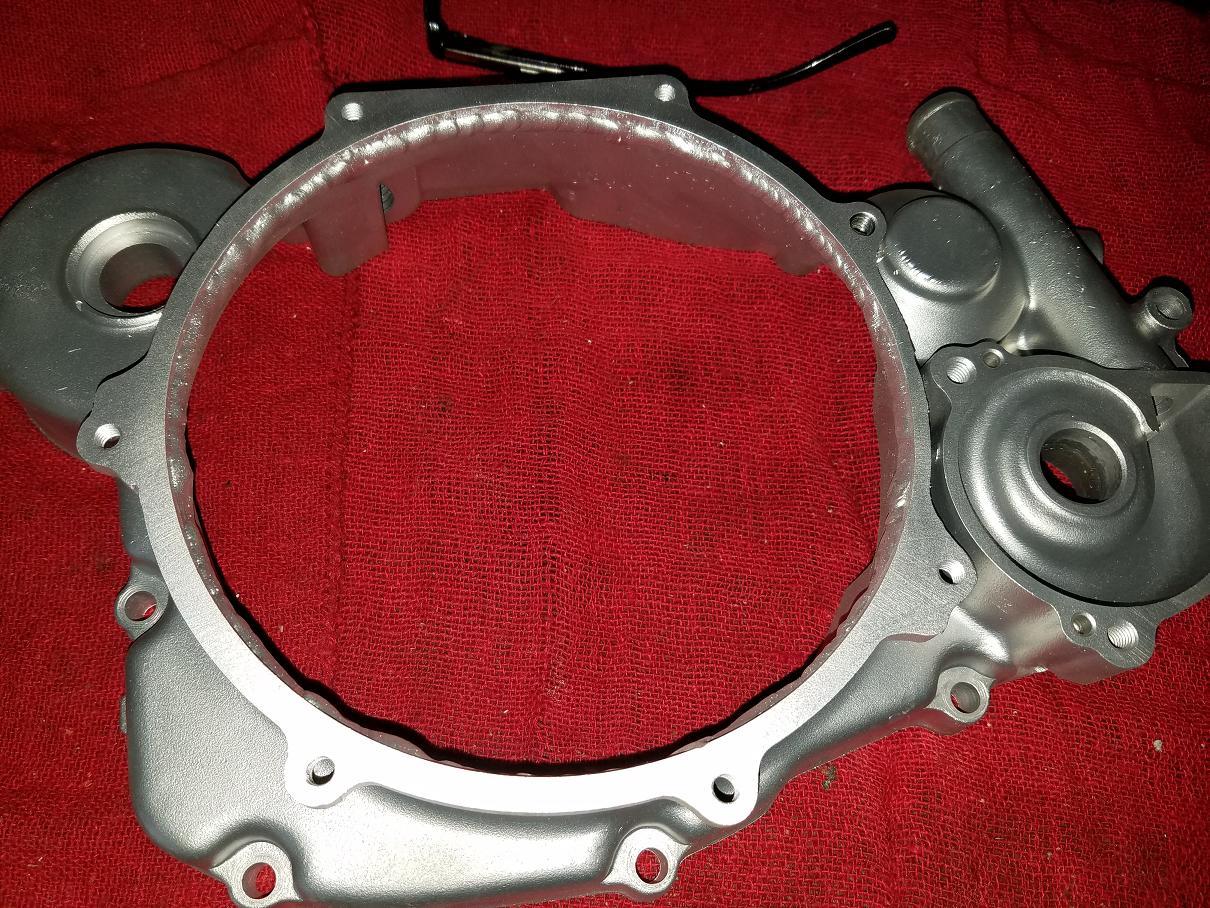

And of course... It wouldn't be right to do this level of build without a 2 piece clutch cover..
- KX GURU RACING SEAN COLLIER KX500 116.JPG (281.33 KiB) Viewed 12974 times

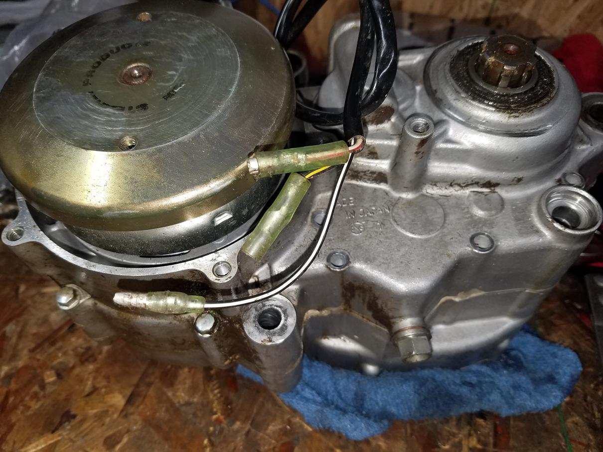

Ok... it's all apart except for the exhaust valves and the gears on the trans shafts.
That will happen later today..
So far so good..
- KX GURU RACING SEAN COLLIER KX500 107.JPG (191.46 KiB) Viewed 12964 times

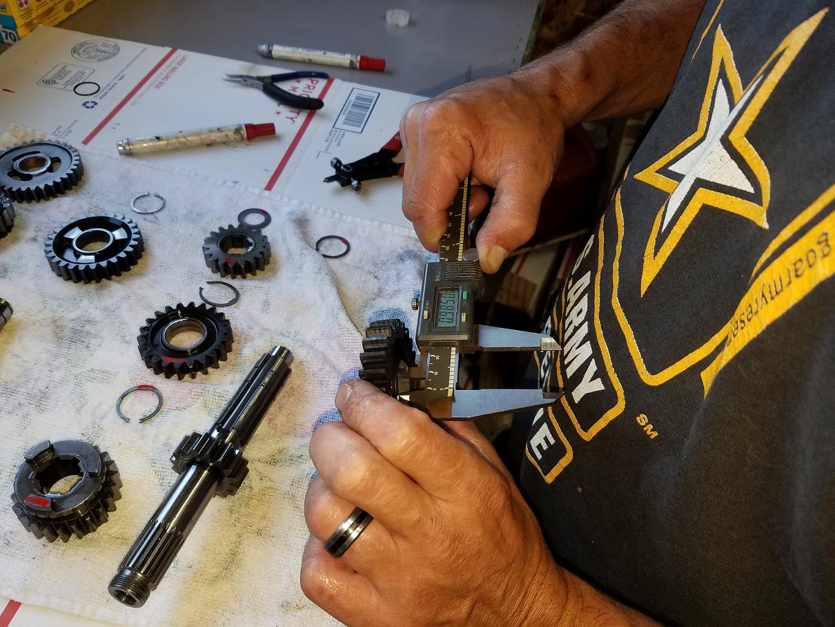

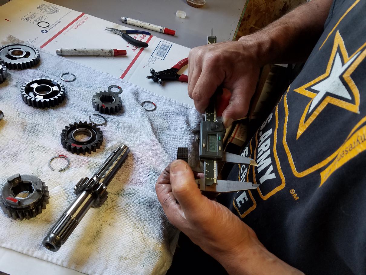

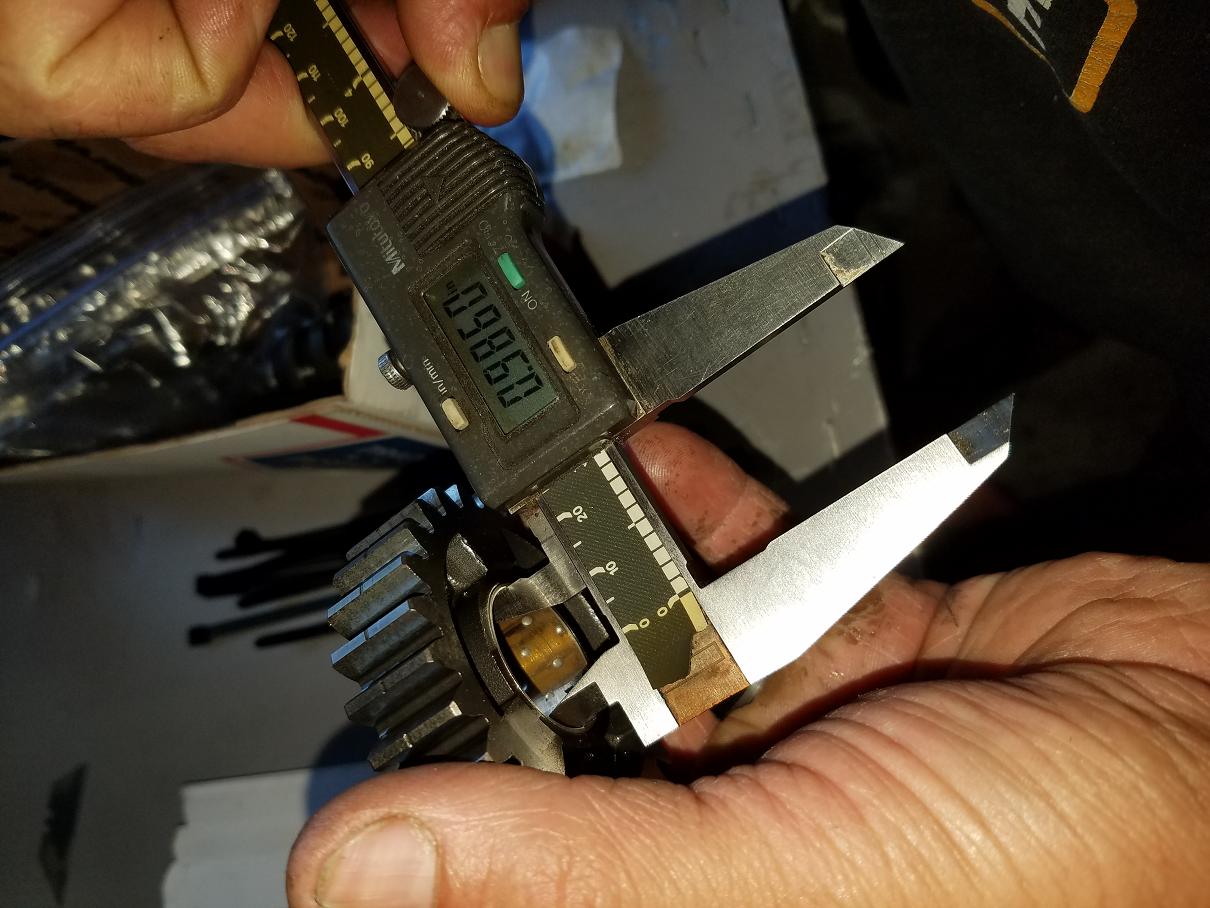

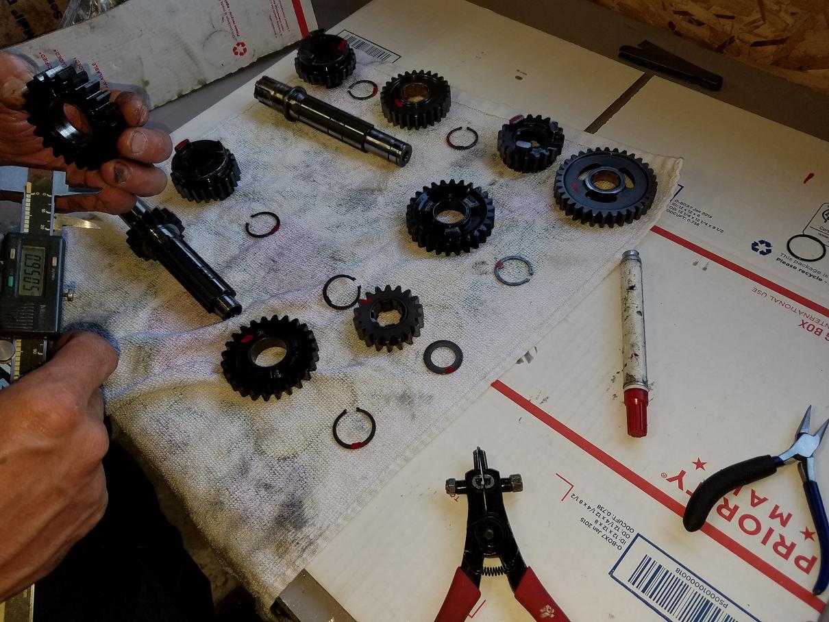

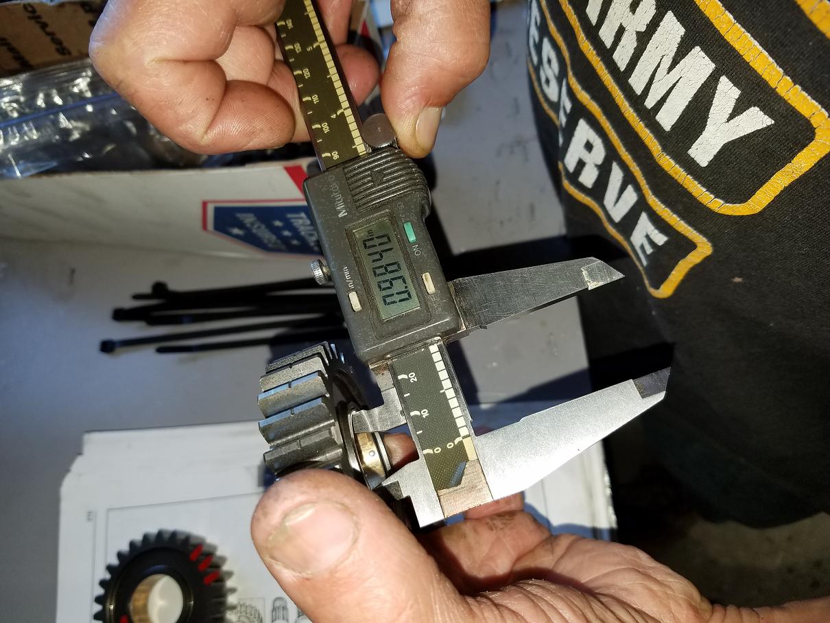

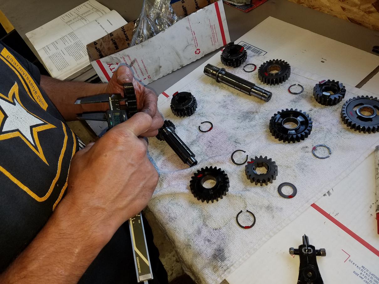

Any KX500 build should keep one thing in mind... Build that bottom end like you want it to last forever... cause it won't
But, there are several things you can do to ensure that it last's a good long time...
Number one.... INSPECT EVERYTHING!!!!
Every gear should be carefully measured and inspected..
- KX GURU RACING SEAN COLLIER KX500 108.JPG (216.49 KiB) Viewed 12952 times
- KX GURU RACING SEAN COLLIER KX500 109.JPG (209.14 KiB) Viewed 12952 times

A steady hand, a keen eye, and attention to detail, makes Jason Tanner (JT Engine Works) crucial to a project of this magnitude.
- KX GURU RACING SEAN COLLIER KX500 114.JPG (202.48 KiB) Viewed 12949 times
- KX GURU RACING SEAN COLLIER KX500 115.JPG (142.95 KiB) Viewed 12949 times

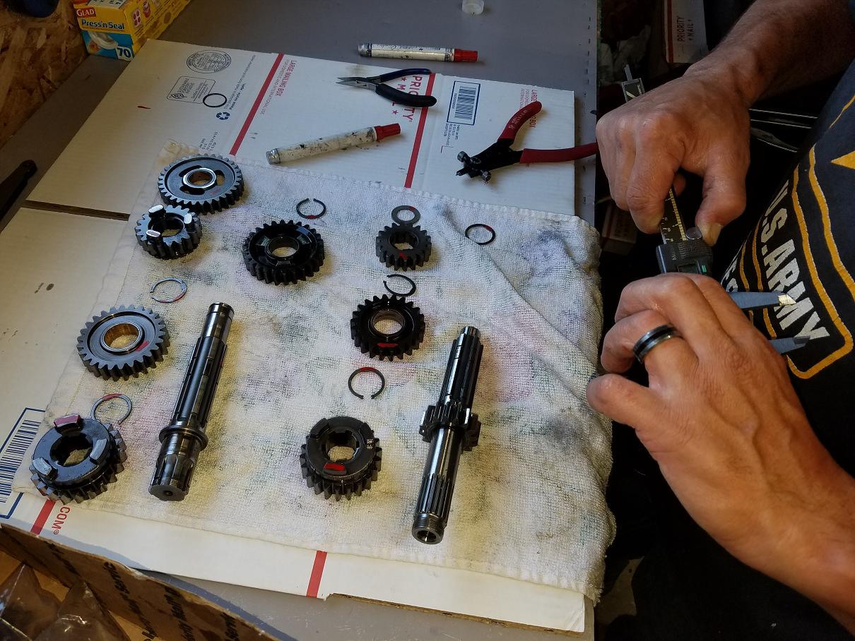

- KX GURU RACING SEAN COLLIER KX500 116.JPG (175.91 KiB) Viewed 12947 times

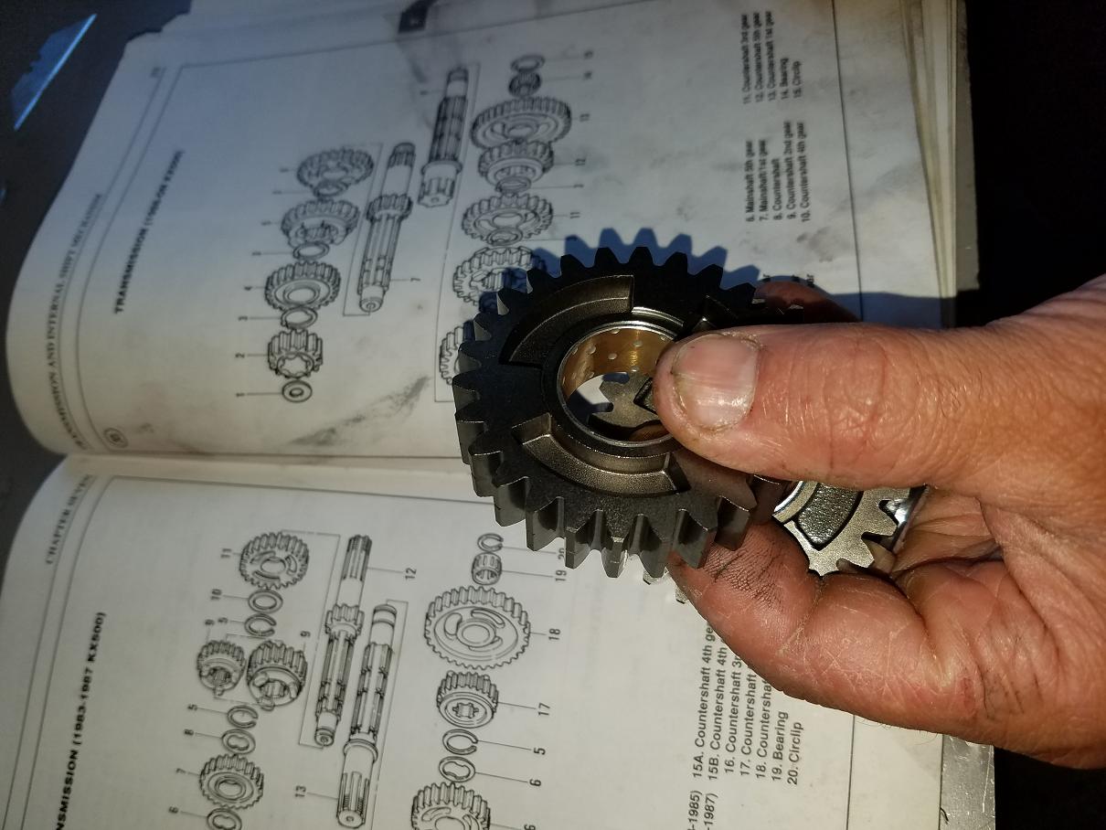

Even if you think you know the manual forwards and backwards... keep it handy... You never know when it can save you from a glitch in the matrix
- KX GURU RACING SEAN COLLIER KX500 117.JPG (137.69 KiB) Viewed 12947 times
This is probably the nicest used trans from a KX500 that I have seen in the recent past but leave it to Jason to find some gears that just aren't up to his standards.
