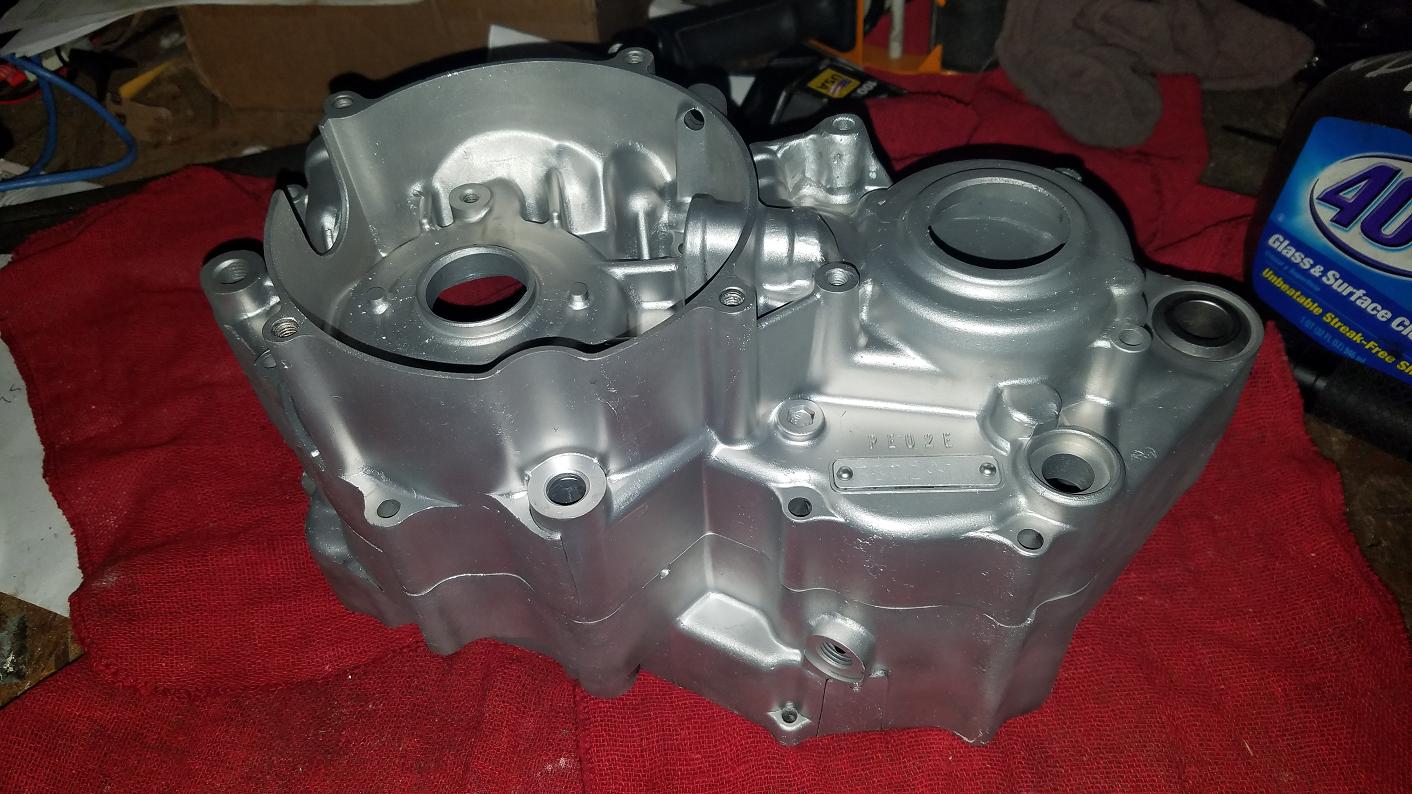

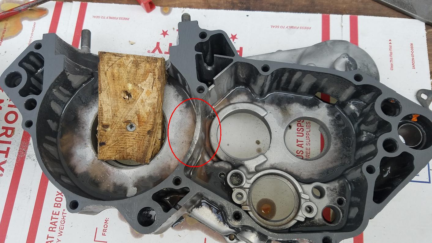

I must love lapping cases... I have gone through a entire can of Timesaver.. :lol:
JT ENGINE WORKS 89 CR500 CART ENGINE BUILD 111.JPG (178.31 KiB) Viewed 15134 times
JT ENGINE WORKS 89 CR500 CART ENGINE BUILD 112.JPG (184.38 KiB) Viewed 15134 times
JT ENGINE WORKS 89 CR500 CART ENGINE BUILD 113.JPG (154.87 KiB) Viewed 15134 times

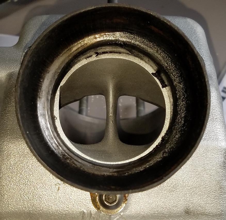

This is ugly....
JT ENGINE WORKS 89 CR500 CART ENGINE BUILD 115.JPG (142.23 KiB) Viewed 15133 times

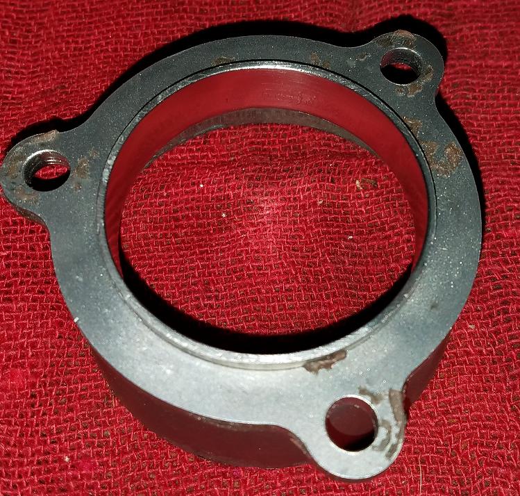

Polished the ID of the exhaust flange..
JT ENGINE WORKS 89 CR500 CART ENGINE BUILD 116.JPG (139.17 KiB) Viewed 15133 times

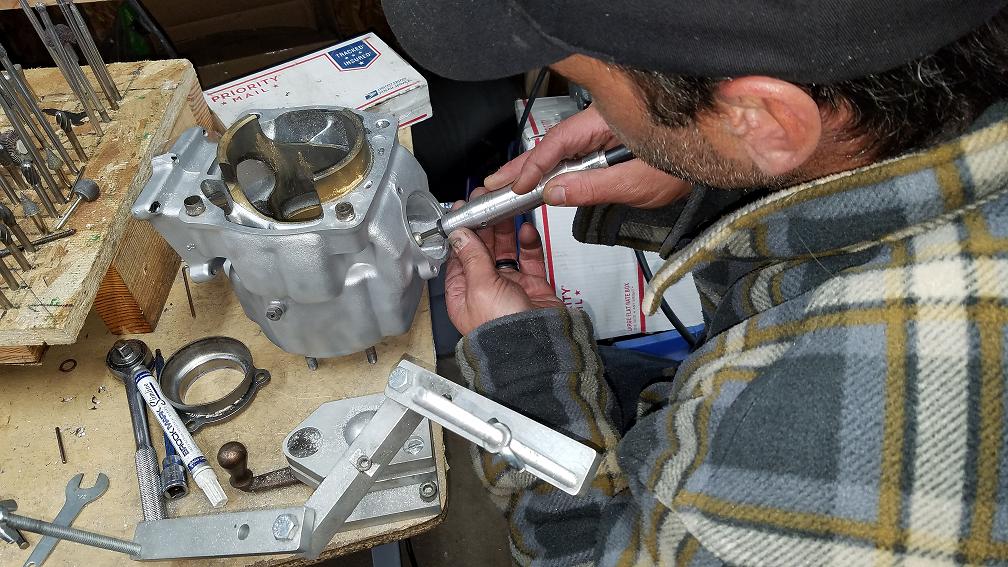

Posted: Fri Apr 29, 2016 12:19 am
Hogging material
JT ENGINE WORKS 89 CR500 CART ENGINE BUILD 117.JPG (114.82 KiB) Viewed 15130 times

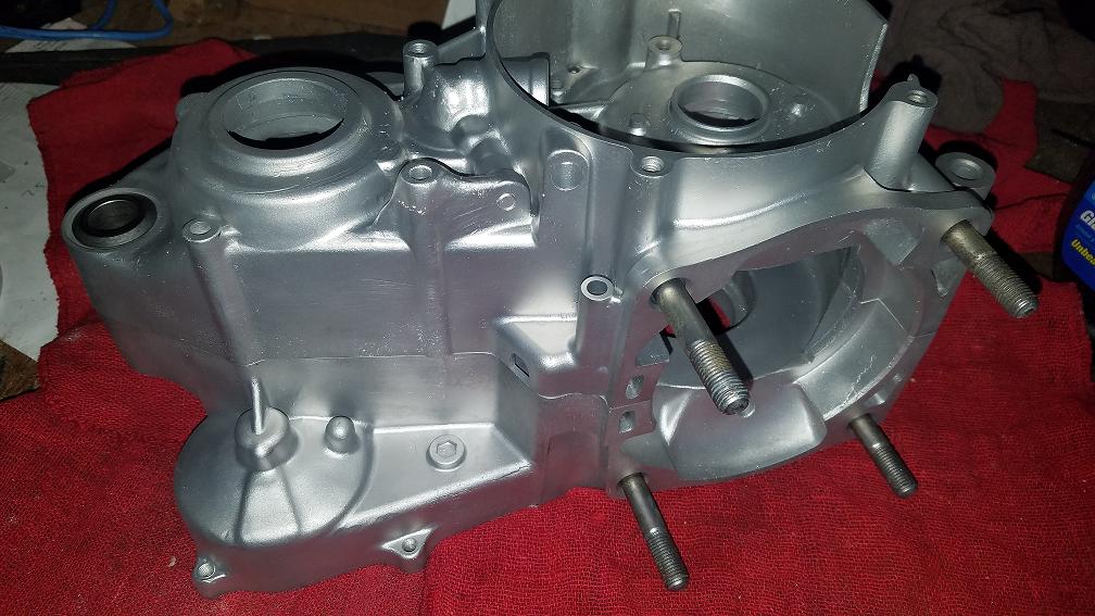

First clean up on the cases..
JT ENGINE WORKS 89 CR500 CART ENGINE BUILD 118.JPG (177.91 KiB) Viewed 15130 times
JT ENGINE WORKS 89 CR500 CART ENGINE BUILD 119.JPG (114.57 KiB) Viewed 15130 times
Looks like we might make the 5th deadline

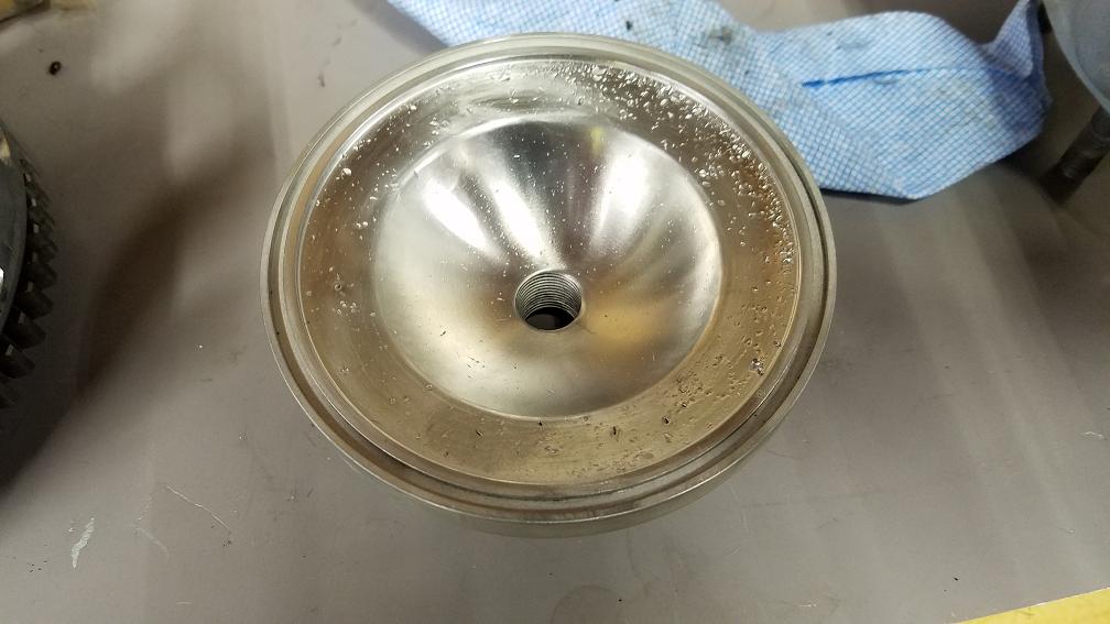

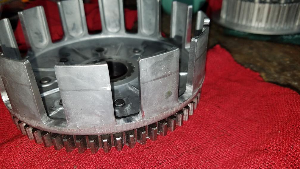

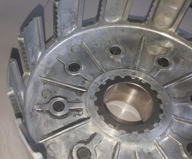

the clutch basket is hashed and there is not enough time to get another...
JT ENGINE WORKS 89 CR500 CART ENGINE BUILD 121.JPG (63.49 KiB) Viewed 15128 times
So, out come the files :shock: I know, I know, that's not all that great but it will get him through a few races..
JT ENGINE WORKS 89 CR500 CART ENGINE BUILD 122.JPG (64.42 KiB) Viewed 15128 times
Hogging more material... Jason is a porting machine :lol:
JT ENGINE WORKS 89 CR500 CART ENGINE BUILD 123.JPG (157.88 KiB) Viewed 15128 times

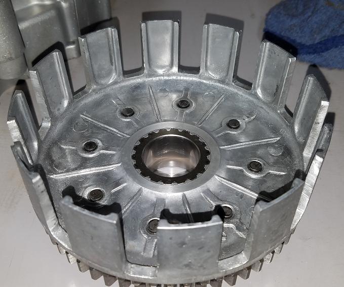

Worked on the basket a bit more today..
JT ENGINE WORKS 89 CR500 CART ENGINE BUILD 124.JPG (111.8 KiB) Viewed 15122 times
I even cleaned up the inner hub a bit..
JT ENGINE WORKS 89 CR500 CART ENGINE BUILD 125.JPG (123.61 KiB) Viewed 15122 times

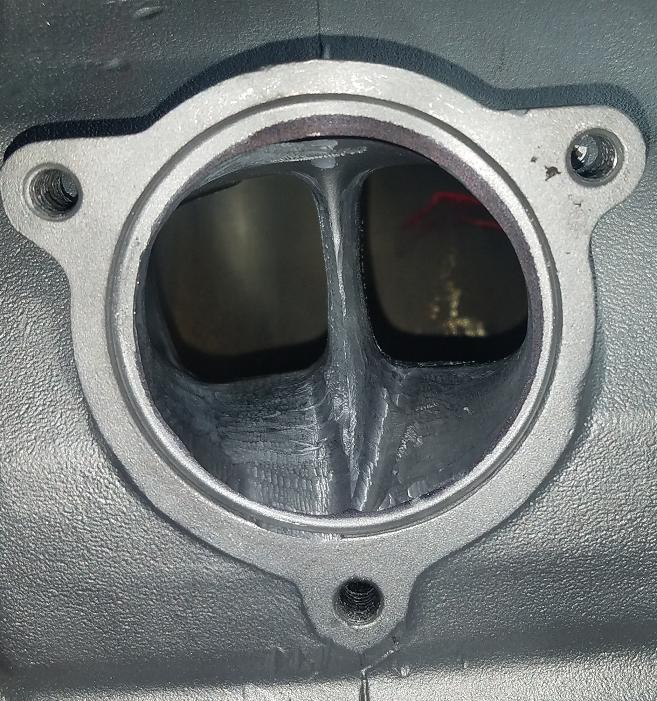

Well... The top end is torched... Disassembled and found a plugged pilot jet :cry:
I know I know, that's racing... But I don't have to like it.
So, rebuilding the top end. The next race is in two weeks...
