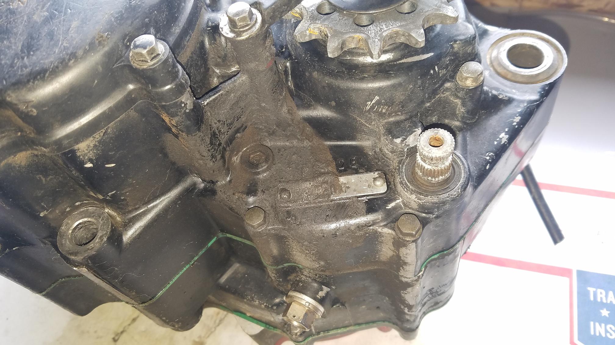

This is what we are starting with..
JT ENGINE WORKS 89 CR500 CART ENGINE BUILD 10.JPG (388.85 KiB) Viewed 19073 times
JT ENGINE WORKS 89 CR500 CART ENGINE BUILD 11.JPG (360.21 KiB) Viewed 19073 times
JT ENGINE WORKS 89 CR500 CART ENGINE BUILD 12.JPG (385.6 KiB) Viewed 19073 times

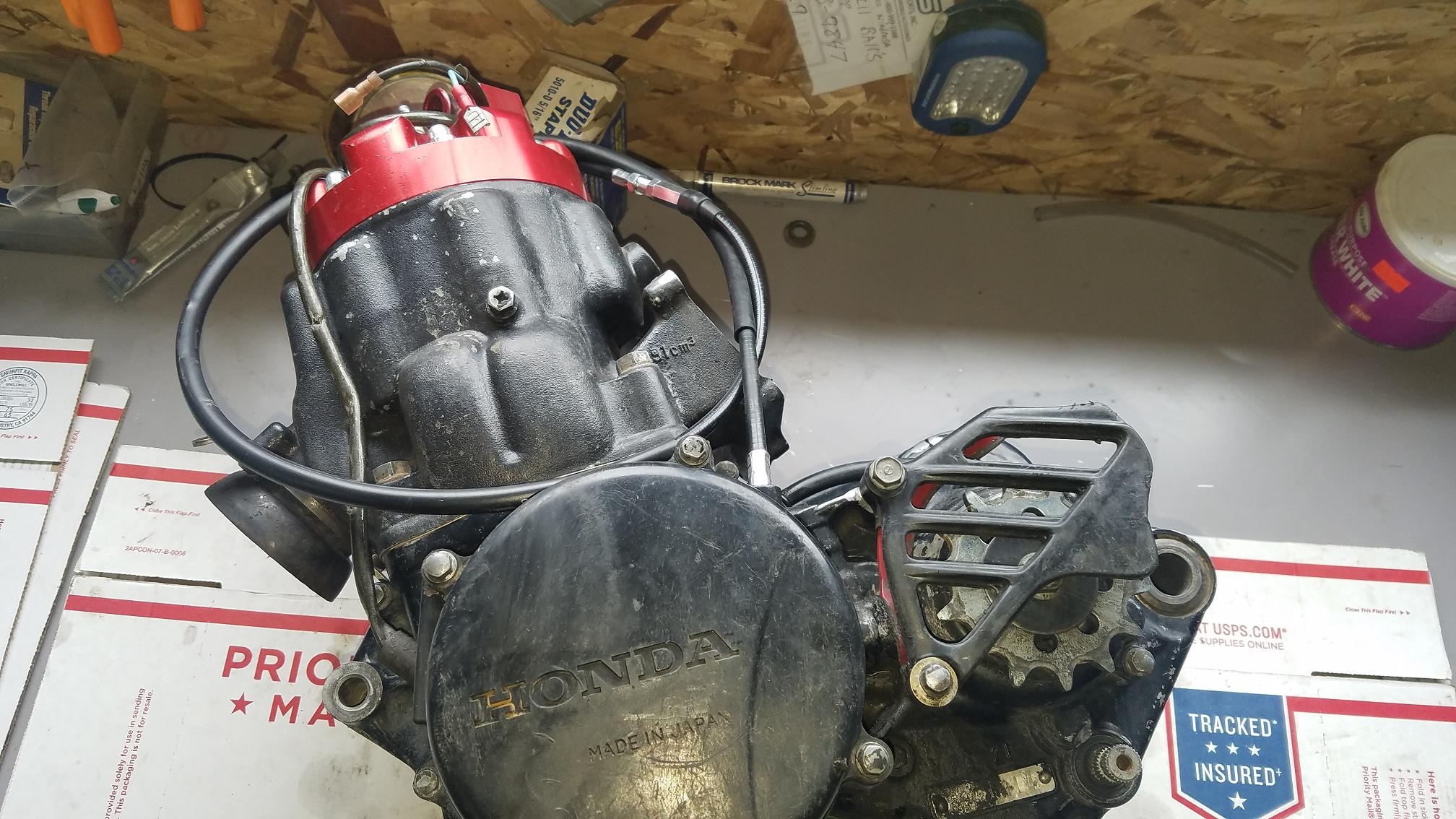

Re: CR500 Kart engine rebuilds
So, the first thing we did was get out the Hot water pressure washer and get all the dirt and grease off this engine.
I hate cracking open a engine with dirt and grease on it... :)
JT ENGINE WORKS 89 CR500 CART ENGINE BUILD 13.JPG (374.07 KiB) Viewed 19072 times
Cracked open the stator cover and found a nice little surprise! :lol:
Light weight fly wheel... Yes!! and other goodies...
JT ENGINE WORKS 89 CR500 CART ENGINE BUILD 14.JPG (382.92 KiB) Viewed 19072 times
JT ENGINE WORKS 89 CR500 CART ENGINE BUILD 15.JPG (386.99 KiB) Viewed 19072 times

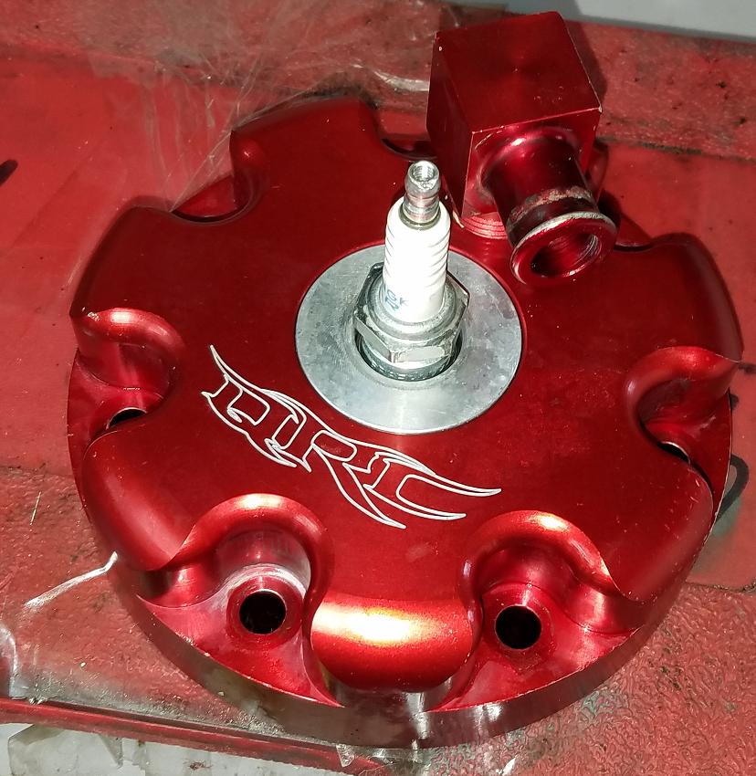

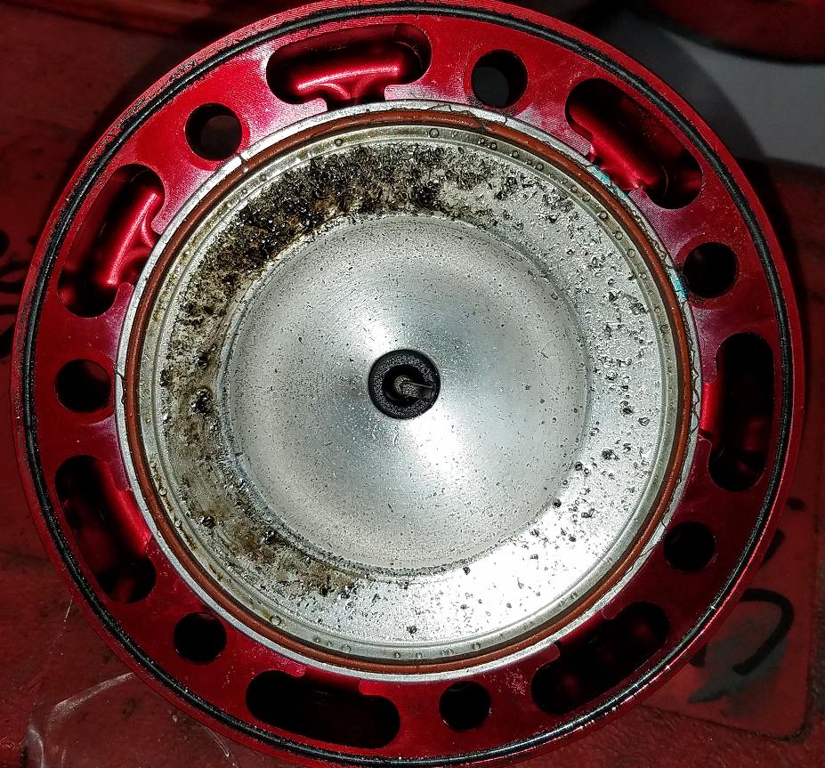

Cool head!
JT ENGINE WORKS 89 CR500 CART ENGINE BUILD 16.JPG (106.36 KiB) Viewed 19071 times

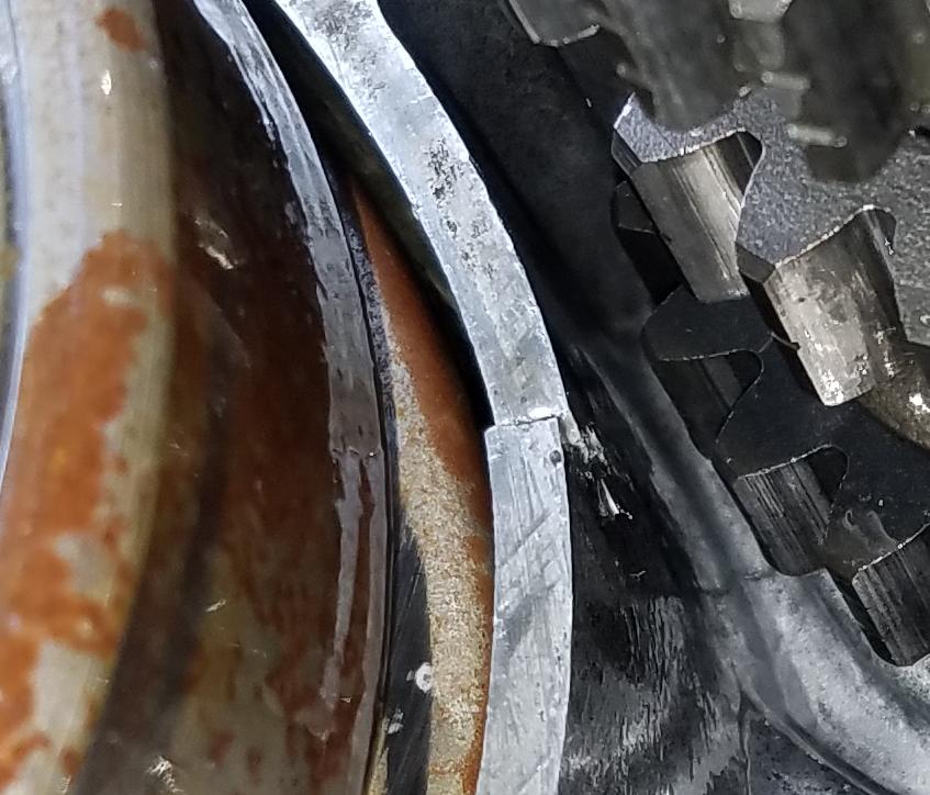

Ugh! Not so cool..
JT ENGINE WORKS 89 CR500 CART ENGINE BUILD 17.JPG (209.77 KiB) Viewed 19071 times

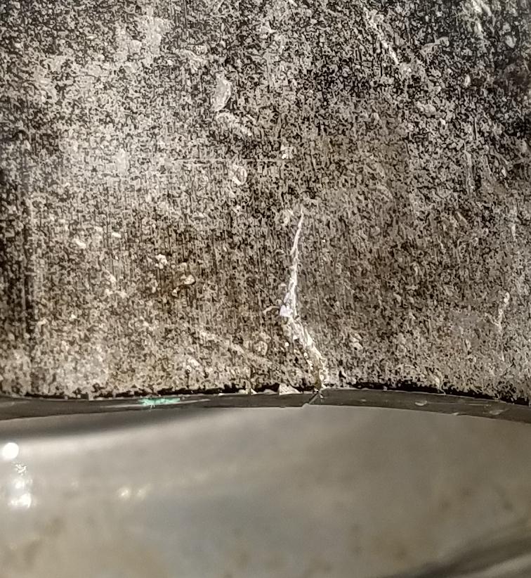

Oh no... A crack...
JT ENGINE WORKS 89 CR500 CART ENGINE BUILD 101.JPG (338.63 KiB) Viewed 19071 times

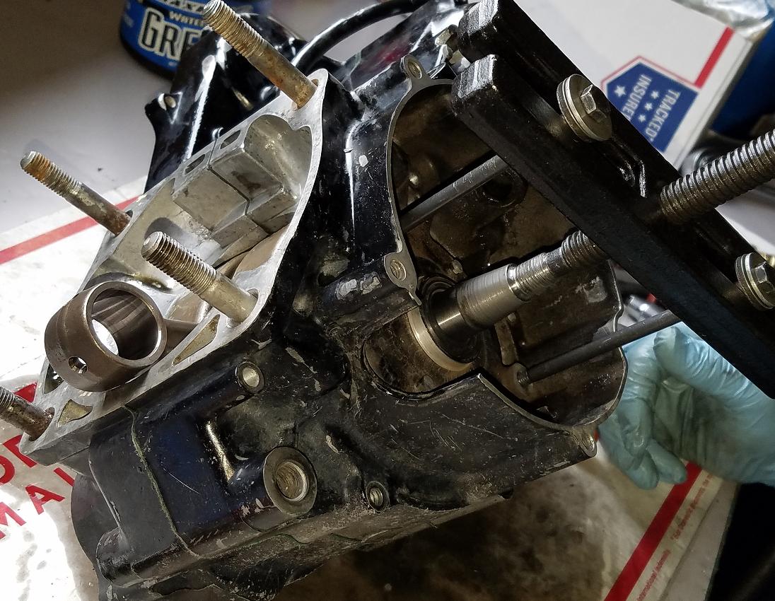

I see some improvement to be had..
JT ENGINE WORKS 89 CR500 CART ENGINE BUILD 102.JPG (327.75 KiB) Viewed 19069 times
Looks good..
JT ENGINE WORKS 89 CR500 CART ENGINE BUILD 103.JPG (166.51 KiB) Viewed 19069 times
Not so fast...
JT ENGINE WORKS 89 CR500 CART ENGINE BUILD 104.JPG (336.88 KiB) Viewed 19069 times
JT ENGINE WORKS 89 CR500 CART ENGINE BUILD 105.JPG (160 KiB) Viewed 19067 times
JT ENGINE WORKS 89 CR500 CART ENGINE BUILD 106.JPG (156.73 KiB) Viewed 19067 times
JT ENGINE WORKS 89 CR500 CART ENGINE BUILD 107.JPG (87.86 KiB) Viewed 19067 times

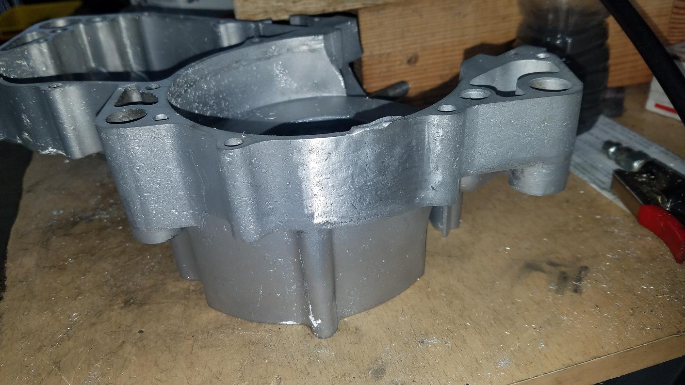

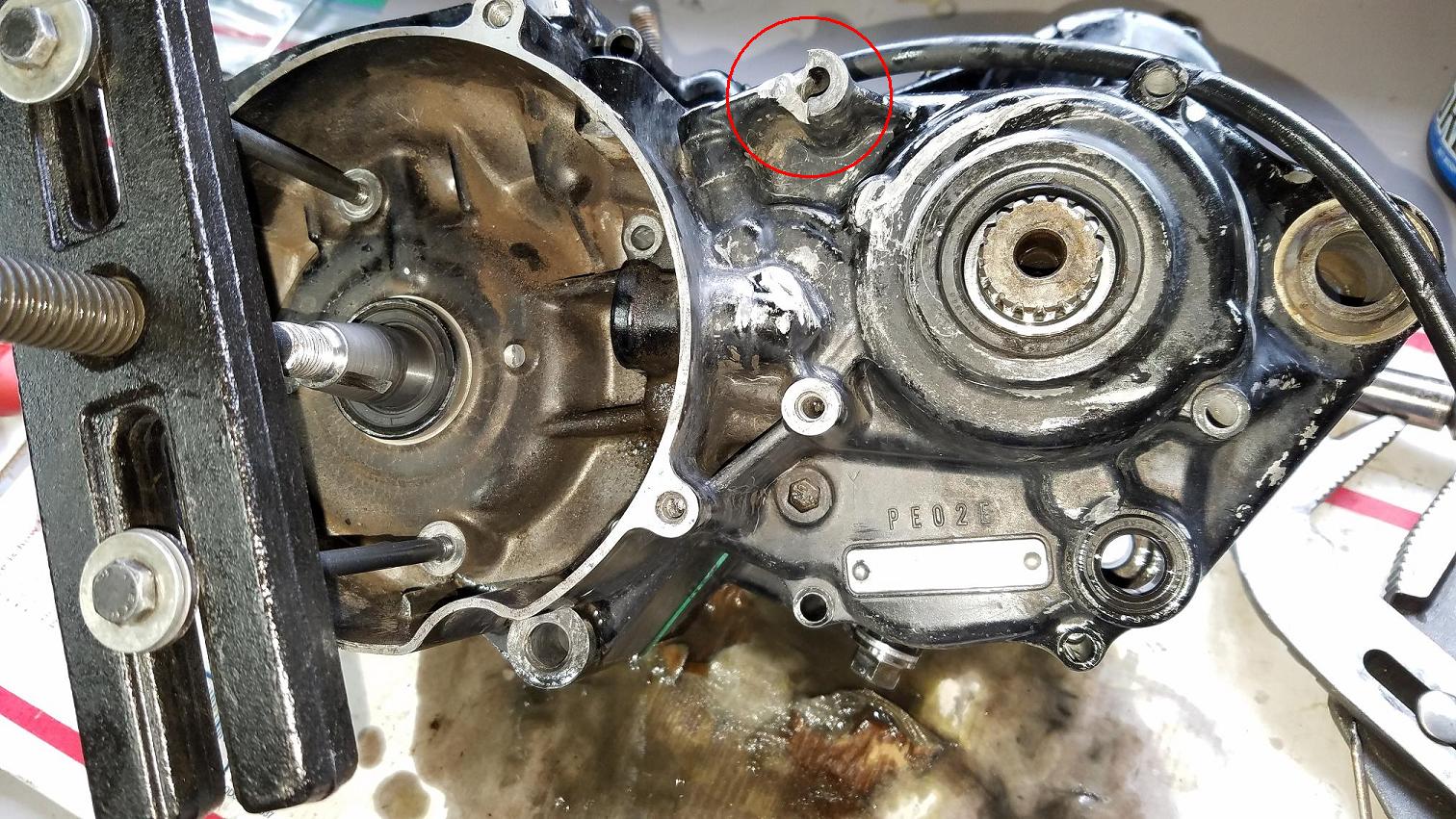

Cases are back from weld...
JT ENGINE WORKS 89 CR500 CART ENGINE BUILD 108.JPG (198.5 KiB) Viewed 19047 times
JT ENGINE WORKS 89 CR500 CART ENGINE BUILD 109.JPG (166.65 KiB) Viewed 19047 times
JT ENGINE WORKS 89 CR500 CART ENGINE BUILD 110.JPG (174.47 KiB) Viewed 19047 times
