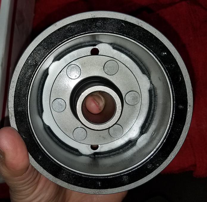

The flywheel came in today..
It cleaned up pretty good..
JT ENGINE WORKS AND OEM-CYCLE KX500 BOTTOM END REBUILD 141.JPG (68.12 KiB) Viewed 8706 times
JT ENGINE WORKS AND OEM-CYCLE KX500 BOTTOM END REBUILD 142.JPG (95.25 KiB) Viewed 8706 times
It's baking in the oven right now for an hour at 200F

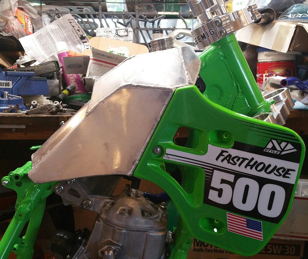

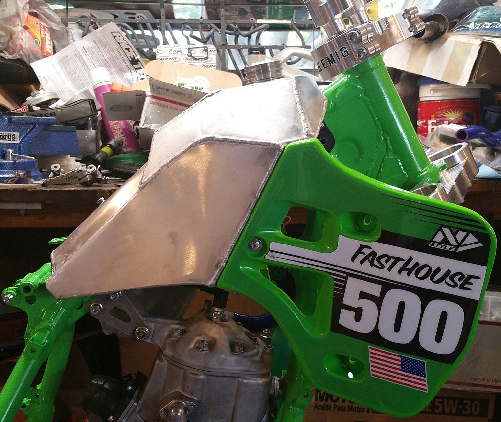

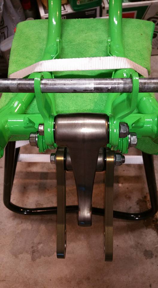

JT ENGINE WORKS AND OEM-CYCLE KX500 BOTTOM END REBUILD 123.JPG (67.59 KiB) Viewed 8665 times
JT ENGINE WORKS AND OEM-CYCLE KX500 BOTTOM END REBUILD 122.JPG (157.74 KiB) Viewed 8665 times
