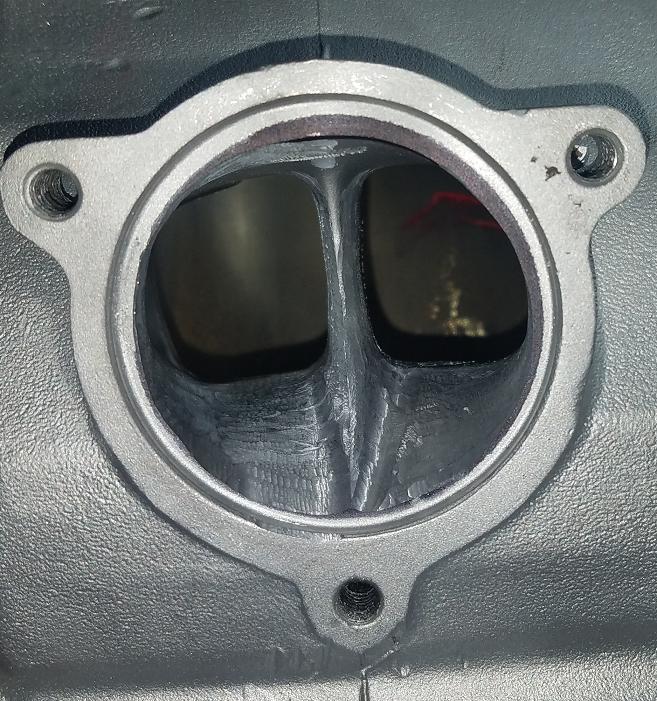

- JT ENGINE WORKS 89 CR500 CART ENGINE BUILD 115.JPG (142.23 KiB) Viewed 8647 times

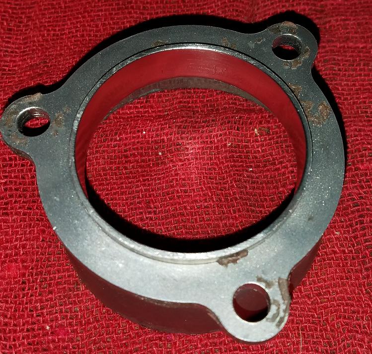

Polished the ID of the exhaust flange..
- JT ENGINE WORKS 89 CR500 CART ENGINE BUILD 116.JPG (139.17 KiB) Viewed 8647 times

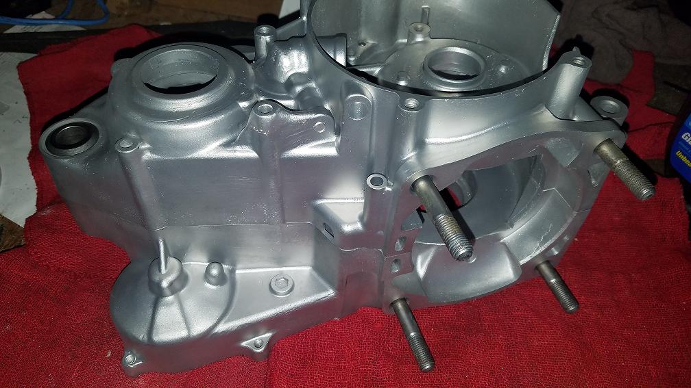

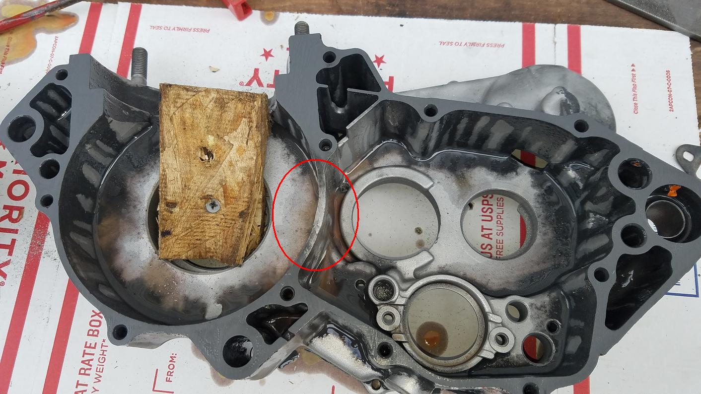

Hogging material
- JT ENGINE WORKS 89 CR500 CART ENGINE BUILD 117.JPG (114.82 KiB) Viewed 8644 times
First clean up on the cases..
- JT ENGINE WORKS 89 CR500 CART ENGINE BUILD 118.JPG (177.91 KiB) Viewed 8644 times
- JT ENGINE WORKS 89 CR500 CART ENGINE BUILD 119.JPG (114.57 KiB) Viewed 8644 times
Looks like we might make the 5th deadline

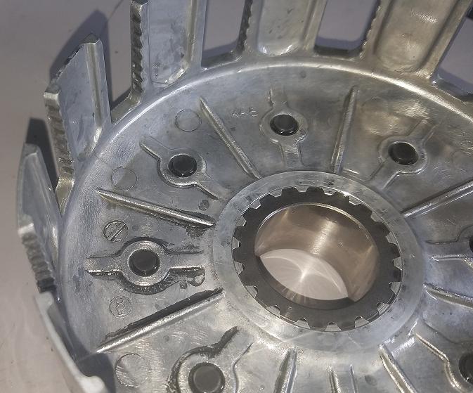

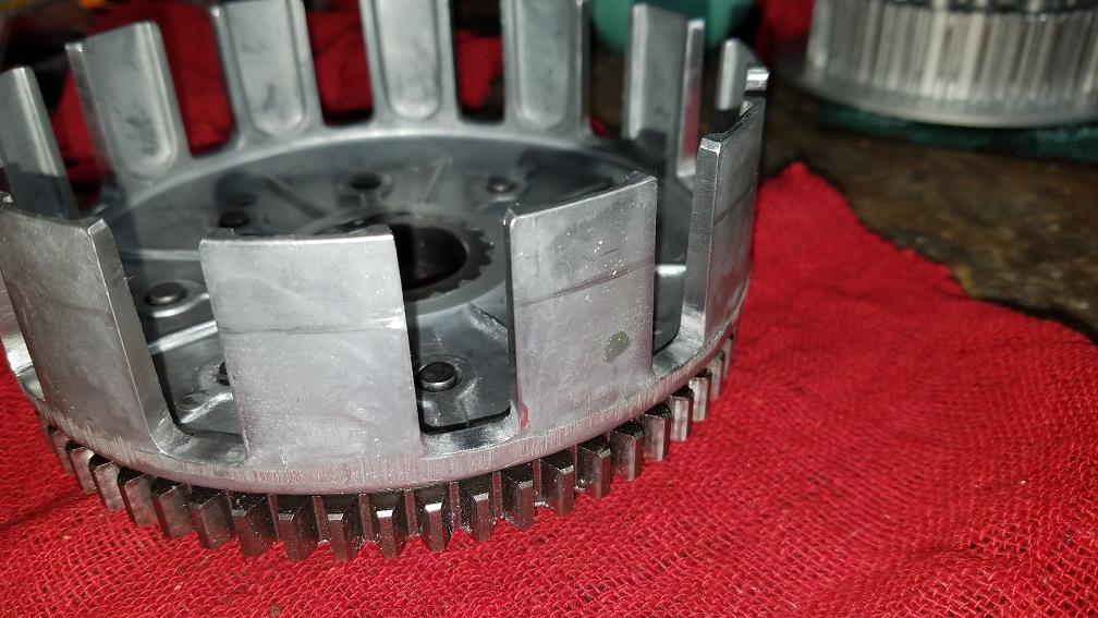

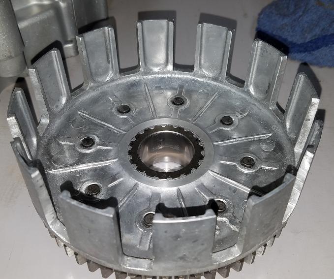

Posted: Sat Apr 30, 2016 4:25 pm
the clutch basket is hashed and there is not enough time to get another...
- JT ENGINE WORKS 89 CR500 CART ENGINE BUILD 121.JPG (63.49 KiB) Viewed 8642 times
So, out come the files
I know, I know, that's not all that great but it will get him through a few races..
- JT ENGINE WORKS 89 CR500 CART ENGINE BUILD 122.JPG (64.42 KiB) Viewed 8642 times

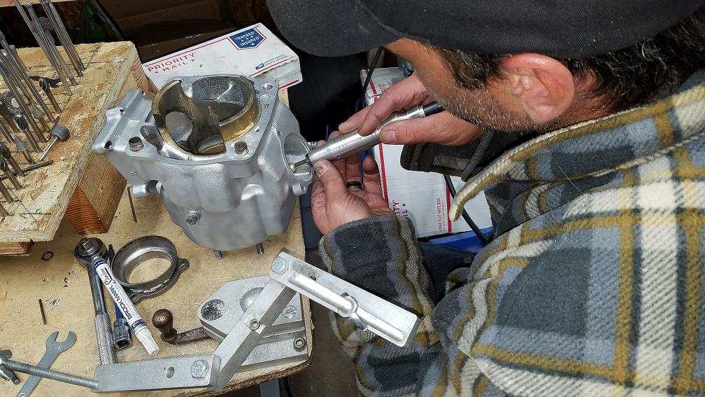

Hogging more material... Jason is a porting machine
- JT ENGINE WORKS 89 CR500 CART ENGINE BUILD 123.JPG (157.88 KiB) Viewed 8642 times

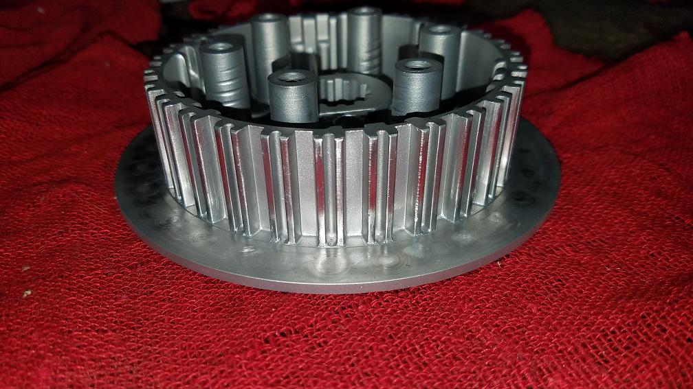

Posted: Sun May 01, 2016 1:57 am
Worked on the basket a bit more today..
- JT ENGINE WORKS 89 CR500 CART ENGINE BUILD 124.JPG (111.8 KiB) Viewed 8636 times
I even cleaned up the inner hub a bit..
- JT ENGINE WORKS 89 CR500 CART ENGINE BUILD 125.JPG (123.61 KiB) Viewed 8636 times

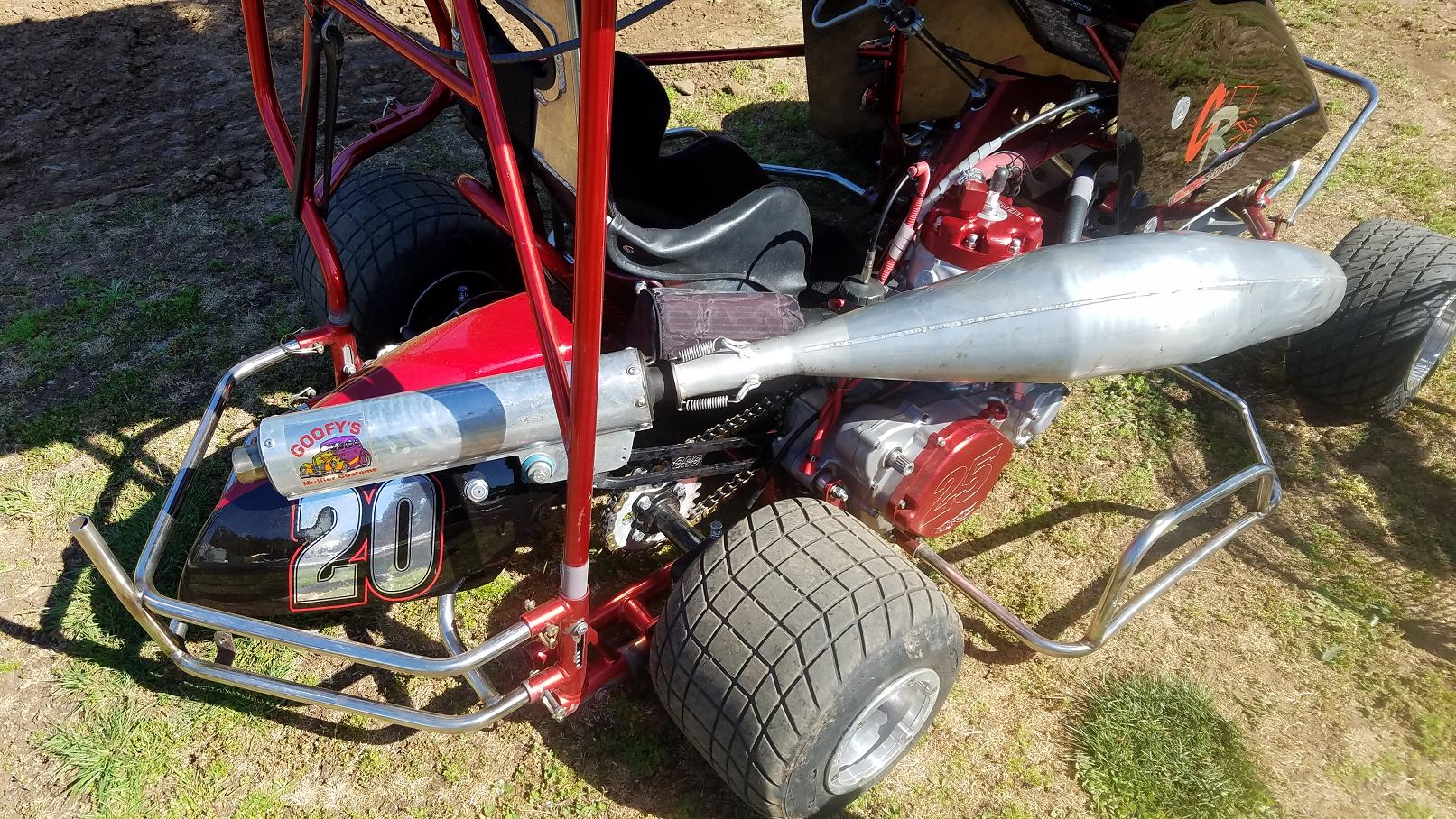

The customer picked up the engine today..
He will do some heat cycles tomorrow and race tomorrow evening
Jason and I will go down there and see how he does.
