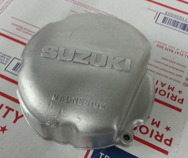

More clean up
Before:
OEM-CYCLE.COM 1988 RM250 ENGINE REBUILD 123.JPG (111.17 KiB) Viewed 8936 times
After:
OEM-CYCLE.COM 1988 RM250 ENGINE REBUILD 122.JPG (91.88 KiB) Viewed 8936 times

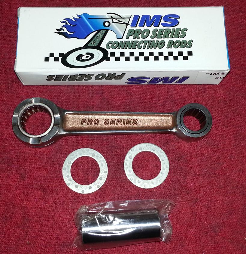

Posted: Wed Nov 04, 2015 9:02 pm
Got the rod kit in... Nice!

Posted: Tue Dec 01, 2015 10:25 pm
We should make Millennium happy with this order..
Remove sleeve, weld, install new sleeve, port match and grind the deck to clean up.
Rebuild the crank using a IMS Pro rod...
We even Vapor blasted the parts so that they would be nice and clean for them to work on :D

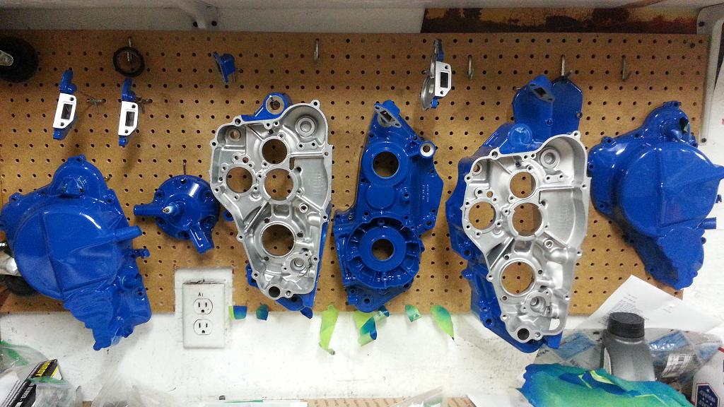

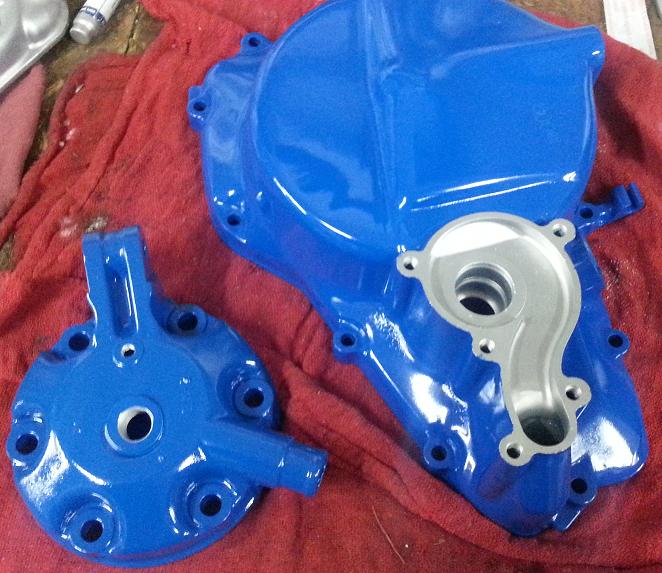

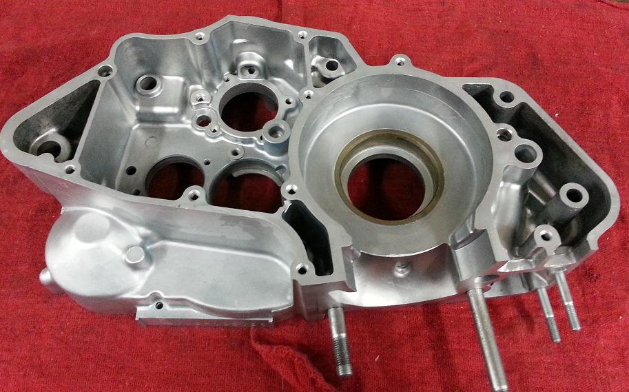

More clean up and paint test..
Vapor blasted but since it is made from Magnesium you can't leave it unpainted or your asking for trouble.
We used VHT Engine Paint SP134 Ford Light Blue.
Painted the inside and bakes at 200f for an hour.
Then we let it cool and painted the outside and baked it again for another hour.
Turned out pretty good.
1988 RM250 ENGINE REBUILD WWW.OEM-CYCLE.COM 123.JPG (39.83 KiB) Viewed 8887 times
1988 RM250 ENGINE REBUILD WWW.OEM-CYCLE.COM 124.JPG (64.86 KiB) Viewed 8887 times

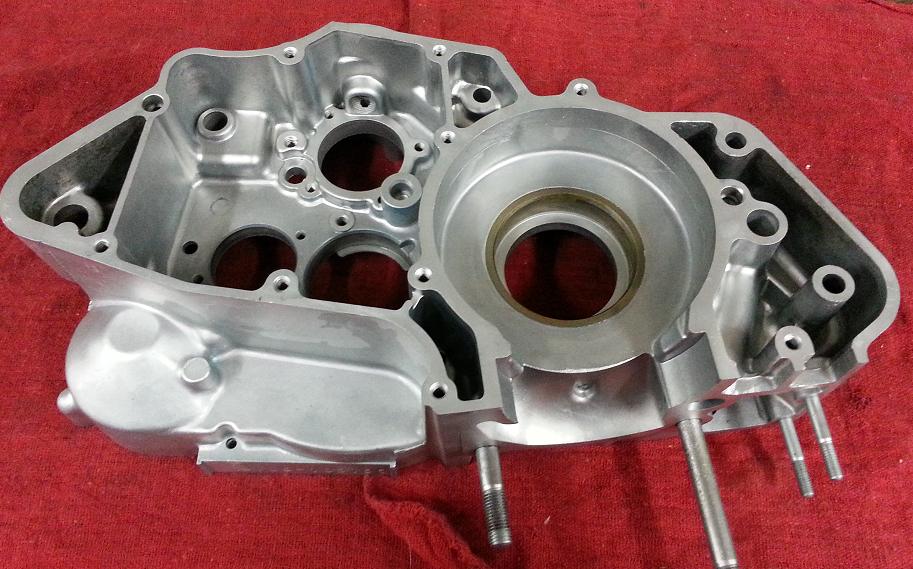

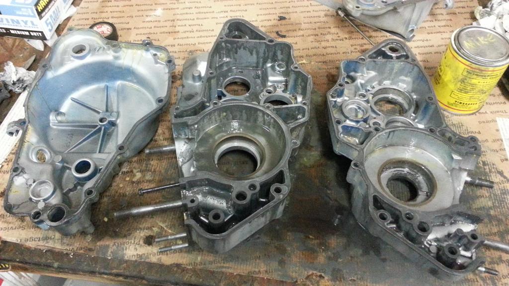

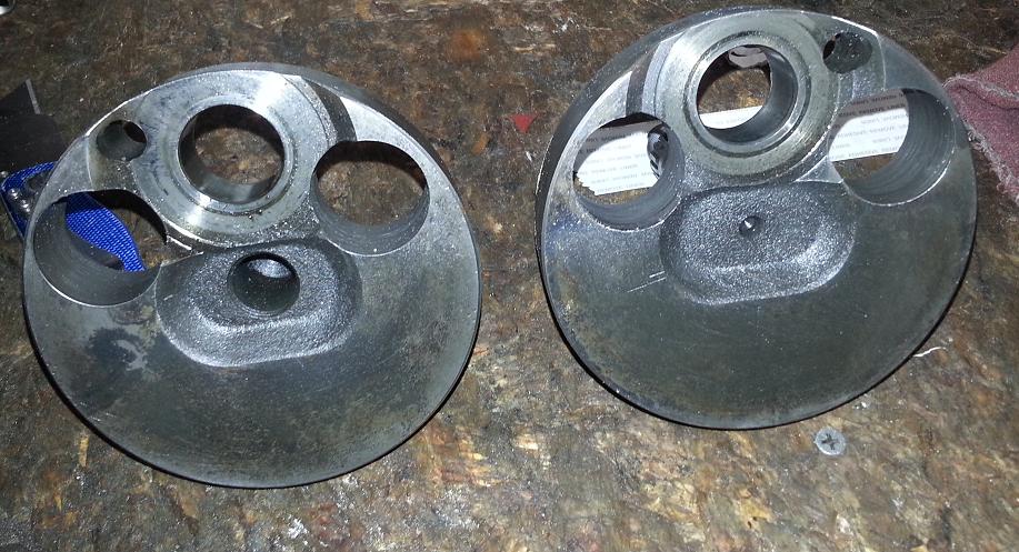

Posted: Mon Dec 28, 2015 9:14 pm
Lapping and prepping the cases..
1988 RM250 ENGINE REBUILD WWW.OEM-CYCLE.COM 125.JPG (150.41 KiB) Viewed 8879 times
Ready for main oil passage porting and entry clean up.
1988 RM250 ENGINE REBUILD WWW.OEM-CYCLE.COM 126.JPG (64.99 KiB) Viewed 8879 times
1988 RM250 ENGINE REBUILD WWW.OEM-CYCLE.COM 127.JPG (94.28 KiB) Viewed 8879 times

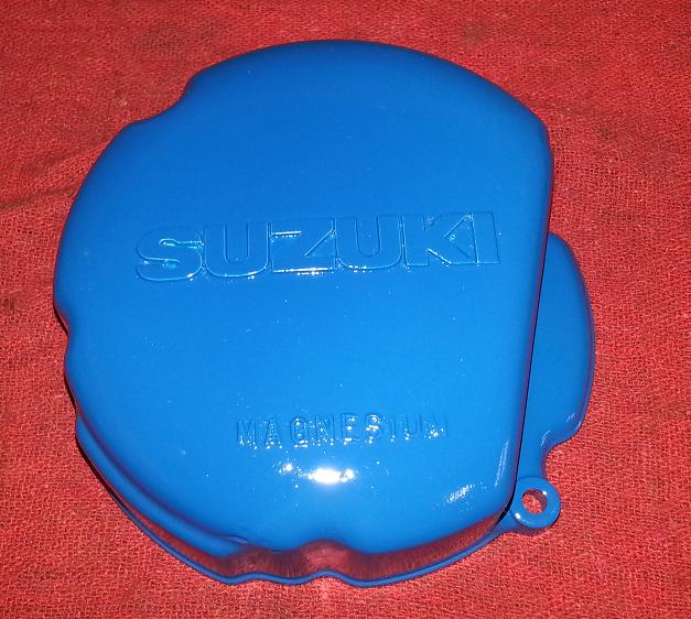

Posted: Sun Jan 10, 2016 10:56 pm
These look good but didn't pass inspection..
Found some wrinkles :evil:
1988 RM250 ENGINE REBUILD WWW.OEM-CYCLE.COM 135.JPG (68.89 KiB) Viewed 8849 times
These are good to go.
1988 RM250 ENGINE REBUILD WWW.OEM-CYCLE.COM 136.JPG (152.09 KiB) Viewed 8849 times

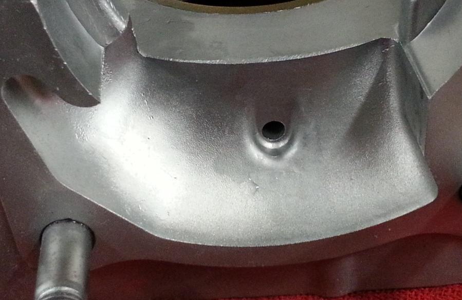

Posted: Fri Jan 15, 2016 11:56 pm
Starting to port the cylinder.
Here is what we are starting with.
1988 RM250 ENGINE REBUILD WWW.OEM-CYCLE.COM 140.JPG (47.88 KiB) Viewed 8848 times
1988 RM250 ENGINE REBUILD WWW.OEM-CYCLE.COM 141.JPG (56.33 KiB) Viewed 8848 times
1988 RM250 ENGINE REBUILD WWW.OEM-CYCLE.COM 142.JPG (41.32 KiB) Viewed 8848 times
1988 RM250 ENGINE REBUILD WWW.OEM-CYCLE.COM 143.JPG (37.02 KiB) Viewed 8848 times
1988 RM250 ENGINE REBUILD WWW.OEM-CYCLE.COM 144.JPG (39.36 KiB) Viewed 8848 times

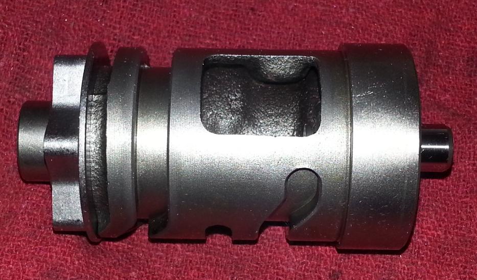

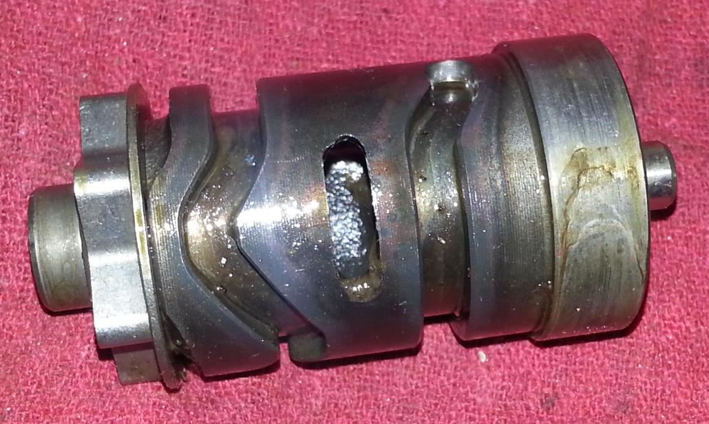

Posted: Thu Jan 21, 2016 9:45 pm
We are having a rough time finding a inner clutch hub in good condition.
This is the best of 4 that we have available.
1988 RM250 ENGINE REBUILD WWW.OEM-CYCLE.COM 145.JPG (102.83 KiB) Viewed 8829 times

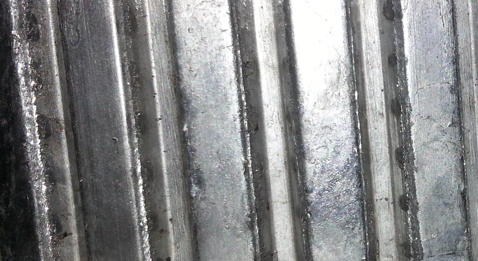

1988 RM250 ENGINE REBUILD WWW.OEM-CYCLE.COM 146.JPG (108.67 KiB) Viewed 8829 times
But we have something in mind to make this a bit easier to shift :-)
