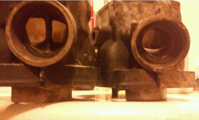

Right away I received a email from a potential buyer telling me that my cylinders were 84-85 KXT250 cylinders.
He was nice enough to send me pics.
The Tecate cylinder is on the right and the kx on the left.

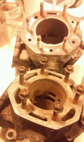

Note that the KX cylinder (bottom) has split exhaust and extra boost ports high in the cylinder.

This was my customers final statement.
This jug (kx250) unported, with the right carb, pipe, and KX ignition is good for 9hp on a Tecate.
Whoa!
I believe it.
Big difference.

cool...I always heard there was a difference, just never saw it confirmed.
