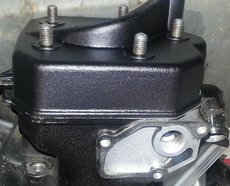

I stumbled upon this by accident.
I had a 1986 kx125 head that I wanted to clean up.
So I vapor blasted it, dried it and painted it with some High head black that I had sitting on the shelf, and baked it at 200 degrees F for 1 hour.
Looked great, but I didn't have a clue about the color until I set the head on the cylinder.. :shock:

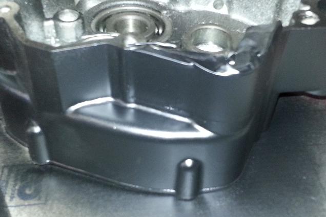

And the results..
OEM-CYCLE.COM ENGINE PAINT FOR 85-87 KX125 3.JPG (135.92 KiB) Viewed 9815 times
It's not a perfect match but if you painted the entire engine you would have a hard time ever knowing that it wasn't factory

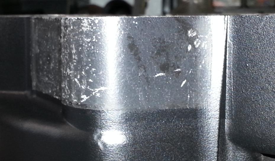

OEM-CYCLE.COM ENGINE PAINT FOR 85-87 KX125 4.JPG (59.81 KiB) Viewed 9813 times

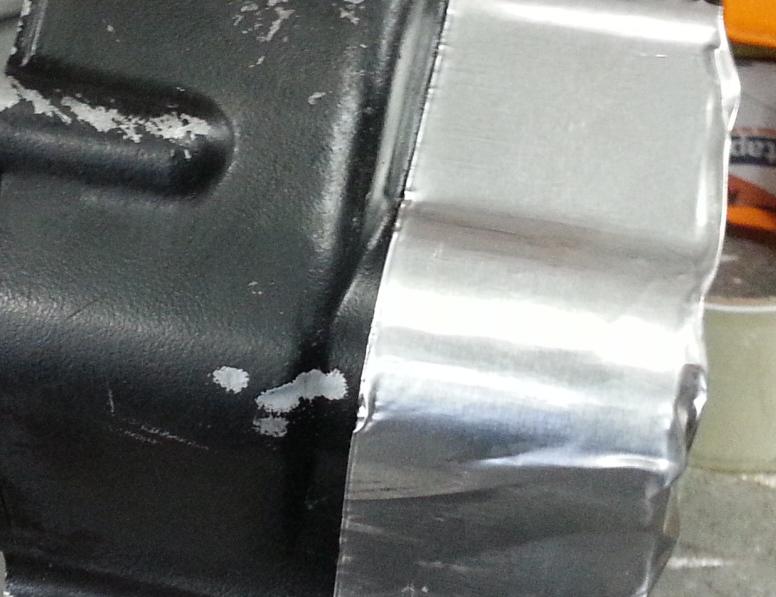

Taped it off...

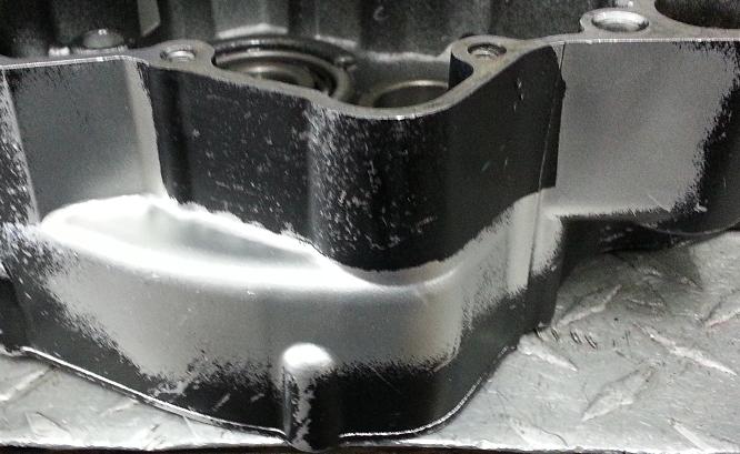

Painted and baked.
OEM-CYCLE.COM ENGINE PAINT FOR 85-87 KX125 7.JPG (29.84 KiB) Viewed 9813 times
Removed the tape and?????
OEM-CYCLE.COM ENGINE PAINT FOR 85-87 KX125 8.JPG (40.76 KiB) Viewed 9813 times
Not exactly what I had hoped for.
OEM-CYCLE.COM ENGINE PAINT FOR 85-87 KX125 9.JPG (78.02 KiB) Viewed 9813 times

All things being equal... the case paint is in really bad shape so it really isn't a definitive test...
If I was going to build a earlier KX I'd consider using it.
Unless of course some of you Guru's out there have a better alternative that you would like to share :ugeek:
