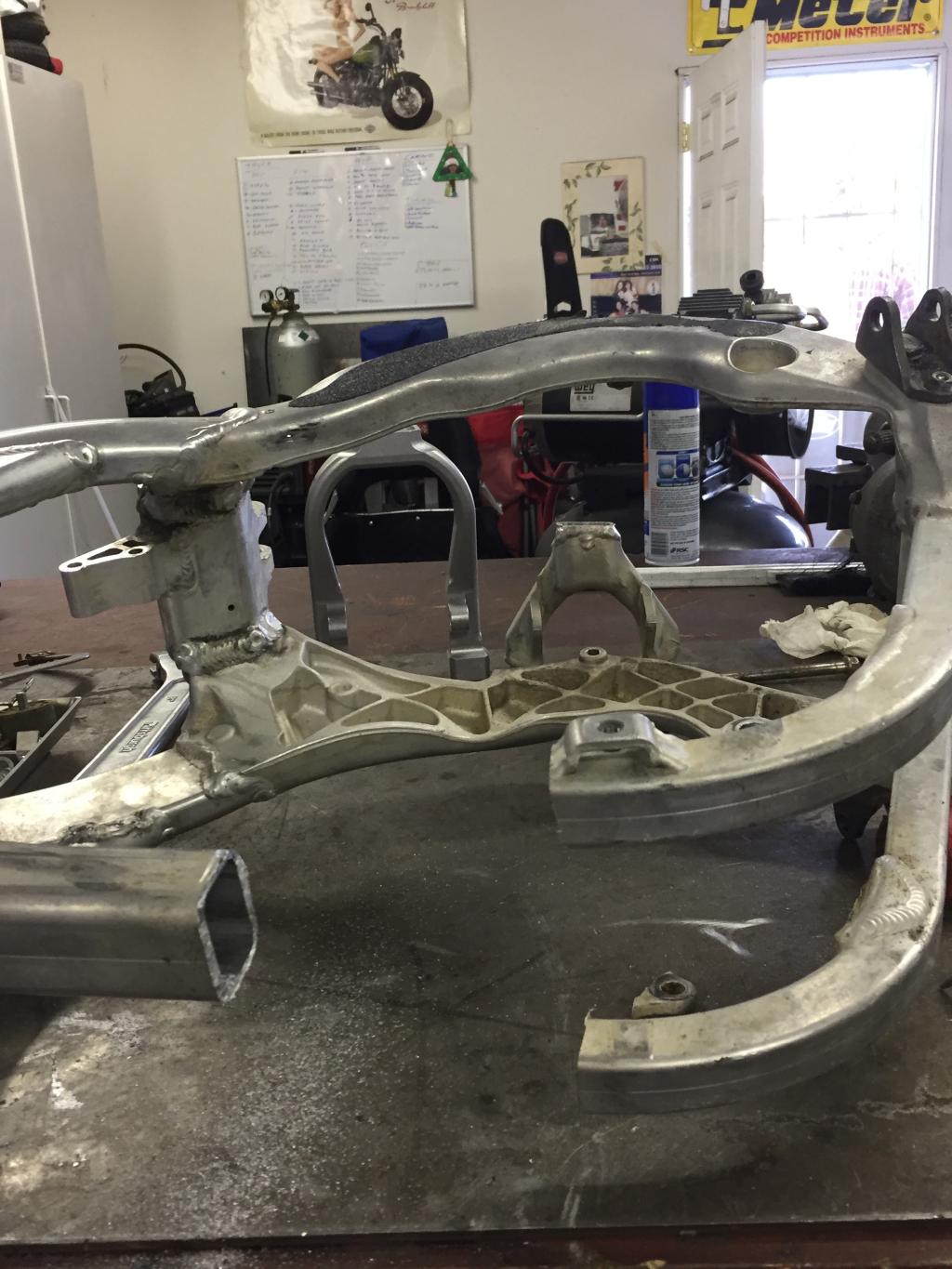

SO, I had the 04 mod plate instead of the 06.. I put it together like this and then just shaved away the excess material.

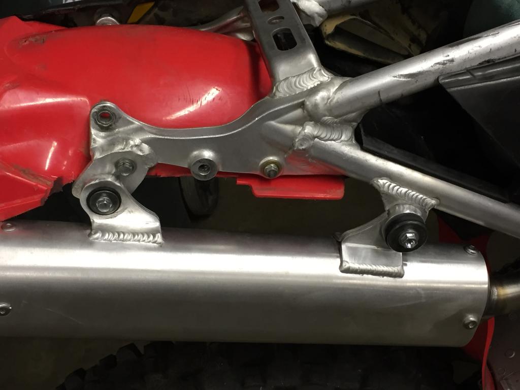

Exhaust mounts look factory IMO

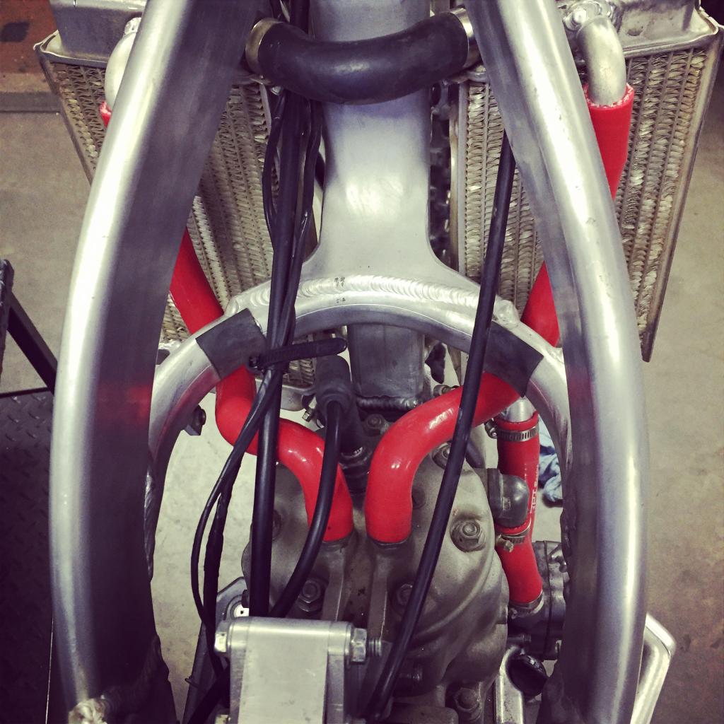

Got some cheap China hoses, factory CR500 kit worked great.

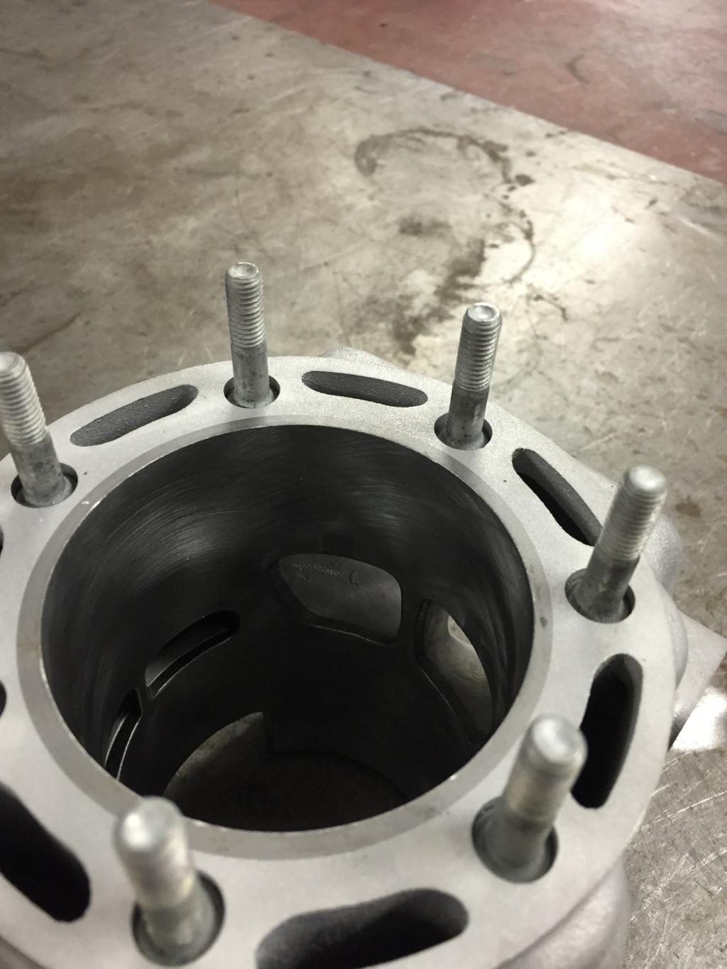

I got the engine bored and honed out to 89.5mm (one step over stock .020) using wiseco poston kit. Got the bike altogether and running. Was having starting issues due to lack of fuel most likely. Started 5-6th kick. I did two heat cycles then went for a cruise around the block. She rips. Let cool once more and went to start, CATASTROPHIC FAILURE!!! got a nasty kick back, low and behold

After that dilemma i was worried about the same thing happening again so i sent my head out to Adam Millar at MillAr Race Engines to have a decompression head mod and a new squish angle machined.

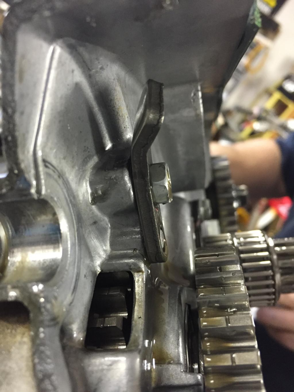

Mechanically everything works as if it should. I got the cases back in order and inspected everything. nothing was out of the ordinary minus the kick starter stopper was a little cracked, which i replaced.
