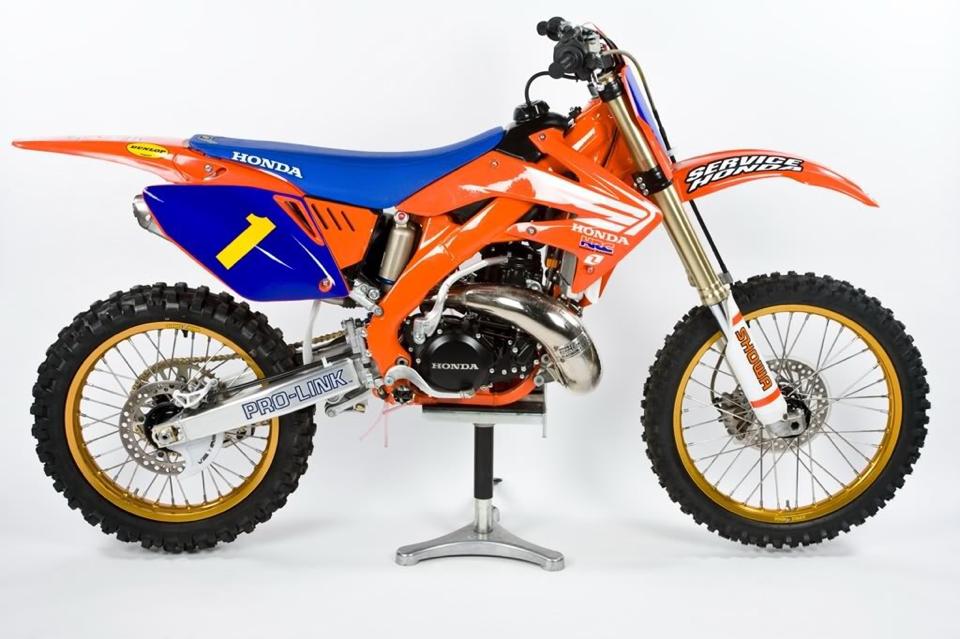

I origionally wanted to do a cr 500 af conversion, but after drooling over bikes on the service Honda website , I discovered service Honda also make a cr 250,, which is a crf 250 frame with an 01 motor, this is essesntially what I copied
service honda cr 250.jpg (75.06 KiB) Viewed 9366 times

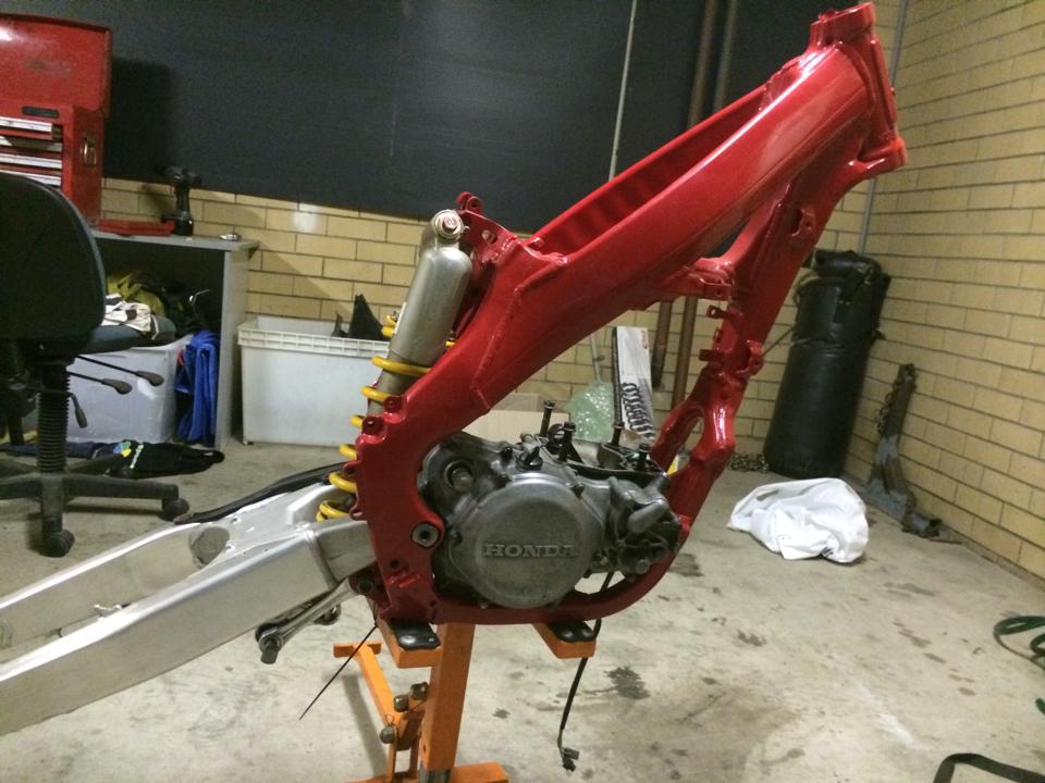

I bought a 06 frame from ebay and had it powder coated, and the next few months started buying bits and pieces of ebay and gum tree, there was never any shortage of parts because 02-07 cr 250r shares suspension, swing arm, forks wheels brakes, with 04-08 crf series. parts were cheap and easy to find.

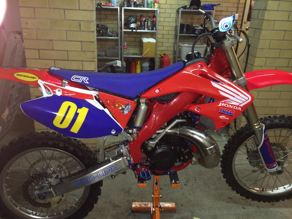

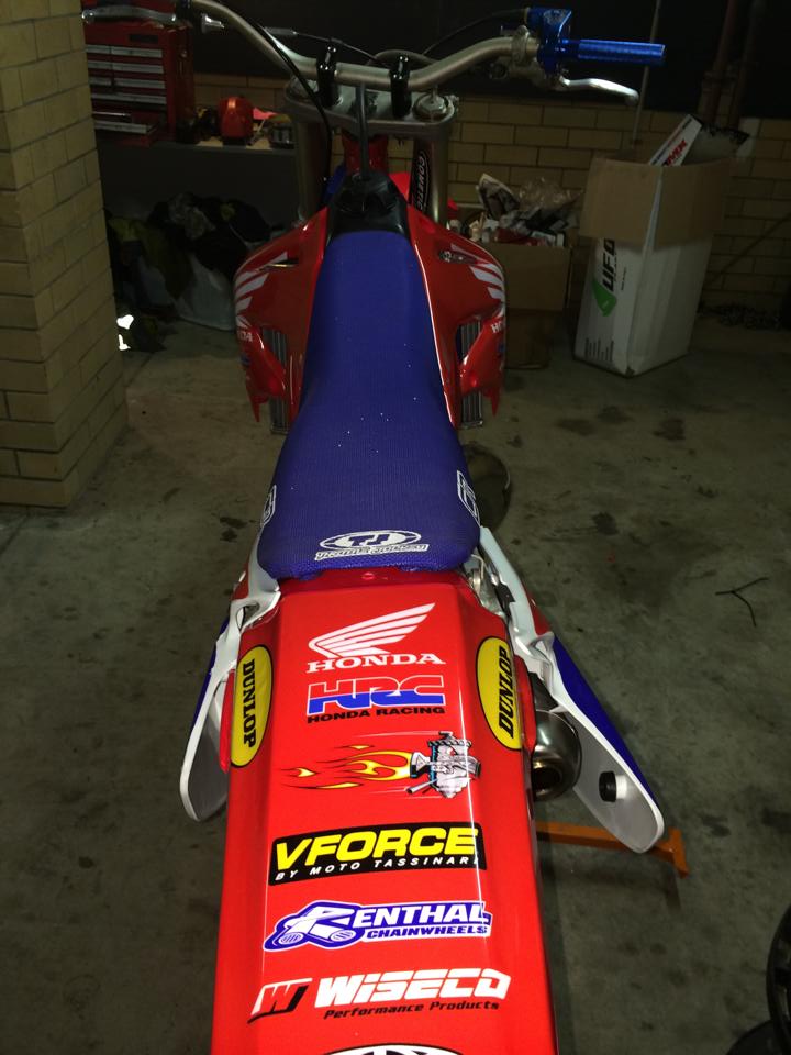

finished product !!!1

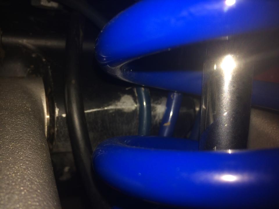

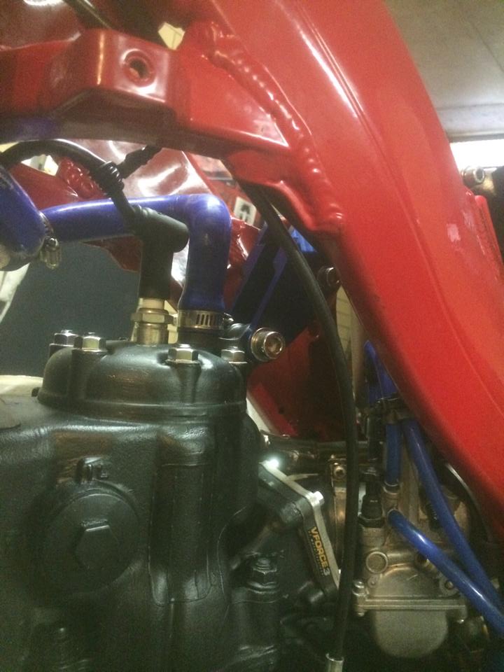

rear of the engine filed down a few mm so that the carb hoses are not pinched by the rear srping
engine mod.jpg (43.46 KiB) Viewed 9366 times

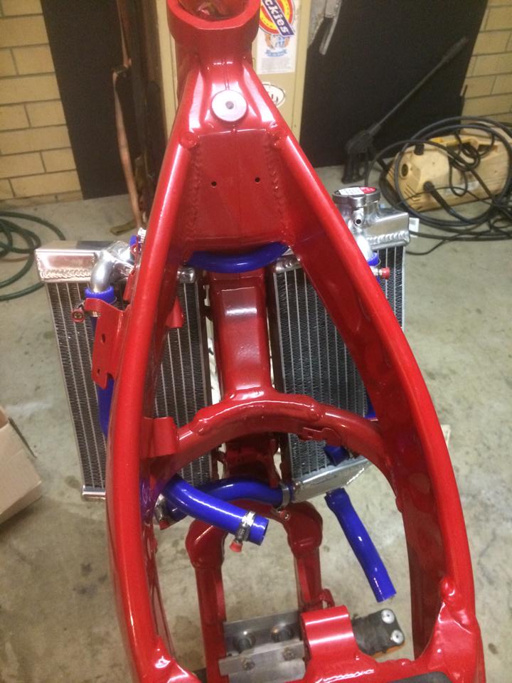

front mount opened up slightly so the engine mounts line up
front mount.jpg (63.08 KiB) Viewed 9366 times

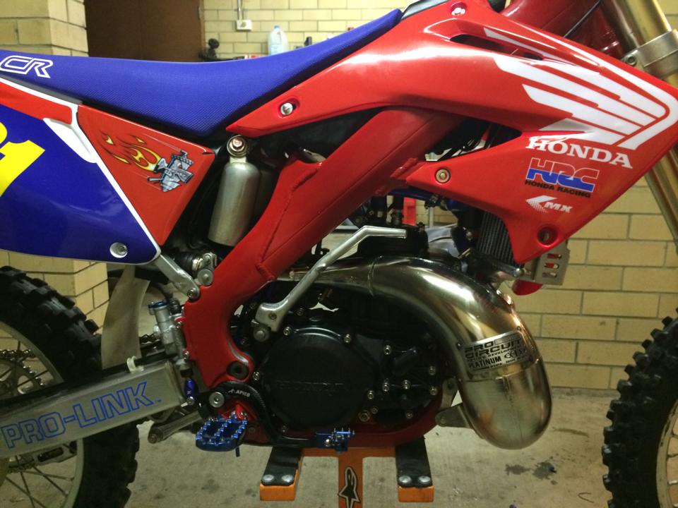

heres some more conversion pics

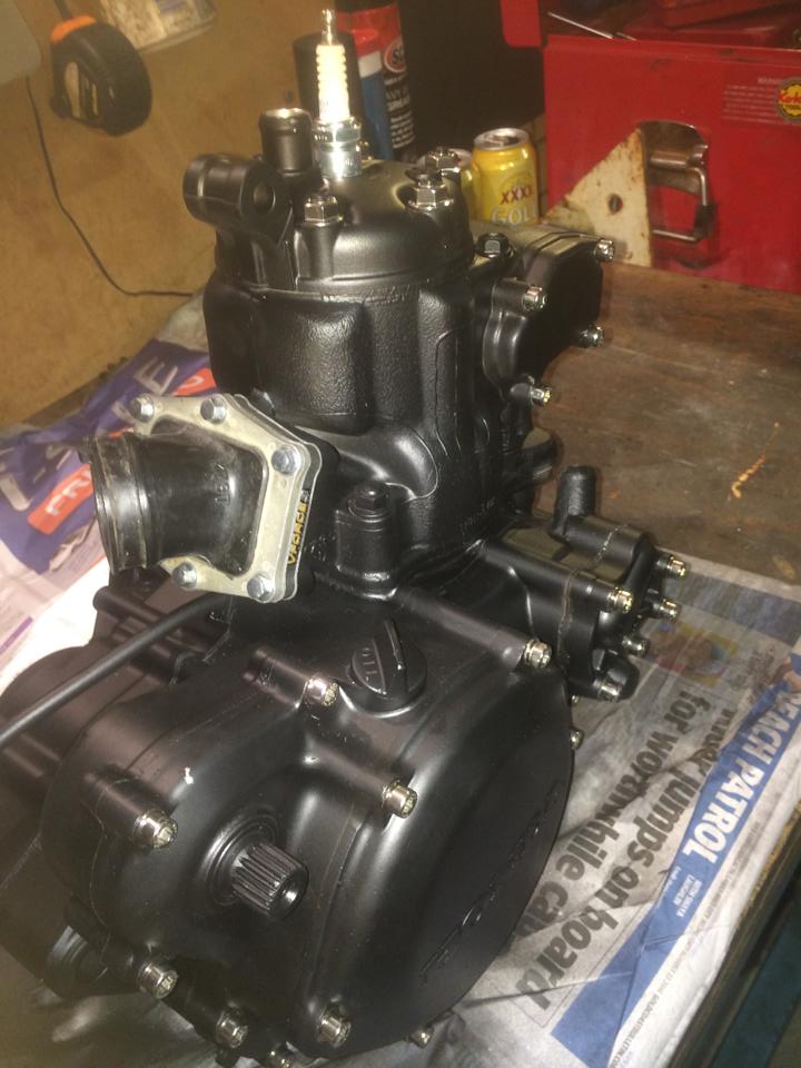

complete motor.jpg (78.64 KiB) Viewed 9359 times

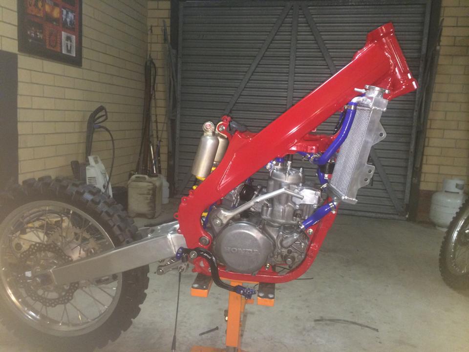

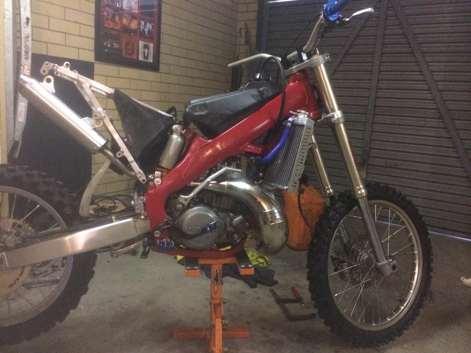

more pics
