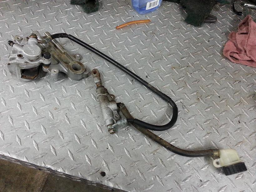

To start with we have to start disassembling this mess.
It's best to clean your brake BEFORE you start but whatever I'm in a hurry and I'll do it wrong anyway..

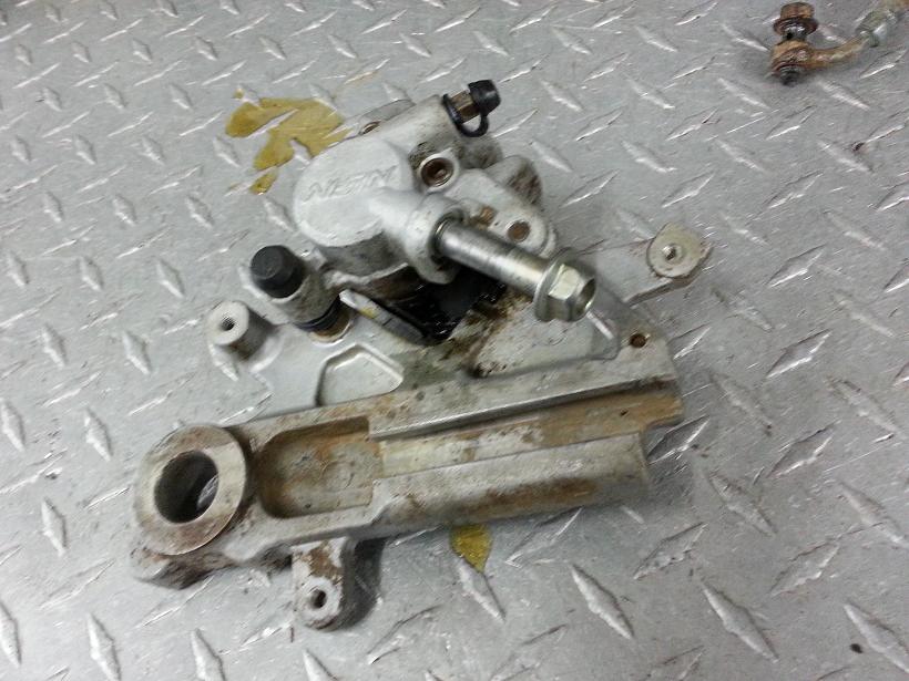

To do what I want I have to disconnect the brake hose.
- OEM-CYCLE.COM BRAKES 102.JPG (89.38 KiB) Viewed 18371 times
When you disconnect the brake line you open up a direct path to the inside so I plug the hole with a bolt so I can continue cleaning without contaminating the insides.
- OEM-CYCLE.COM BRAKES 101.JPG (117.29 KiB) Viewed 18371 times

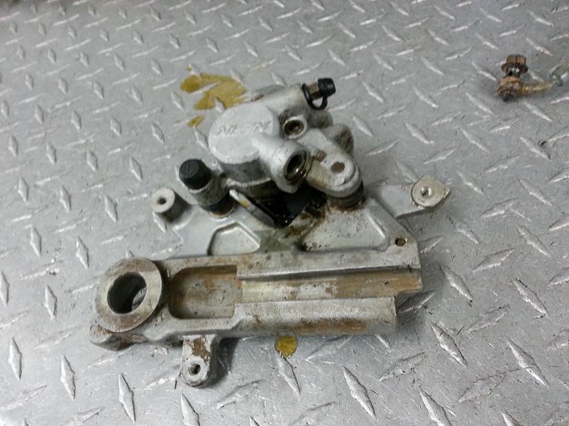

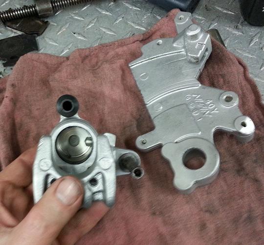

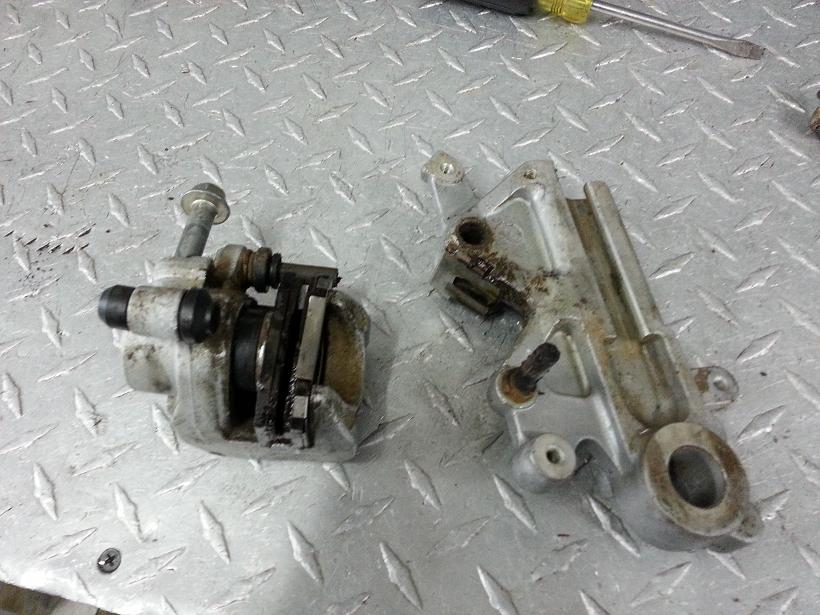

Next I removed the caliper mount.
This style is easy, just pull them apart.
- OEM-CYCLE.COM BRAKES 104.JPG (91.14 KiB) Viewed 18370 times

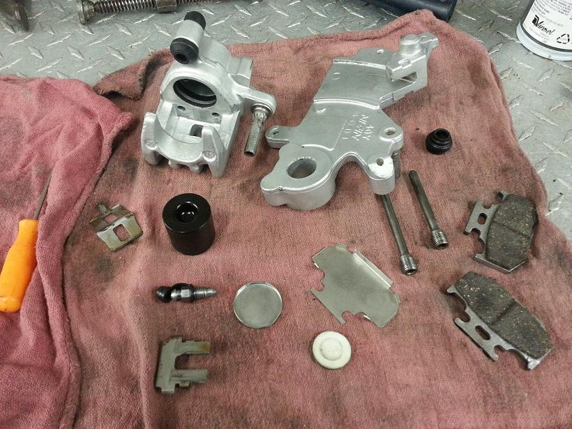

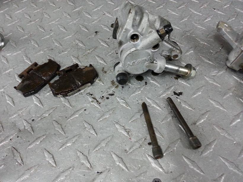

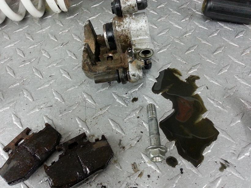

After removing the mount I removed the two pad pins... What a mess...
- OEM-CYCLE.COM BRAKES 105.JPG (97.23 KiB) Viewed 18370 times
I removed the bolt that is in the hose mount because I need to blow compressed air down that hole to remove the piston.
What a mess...

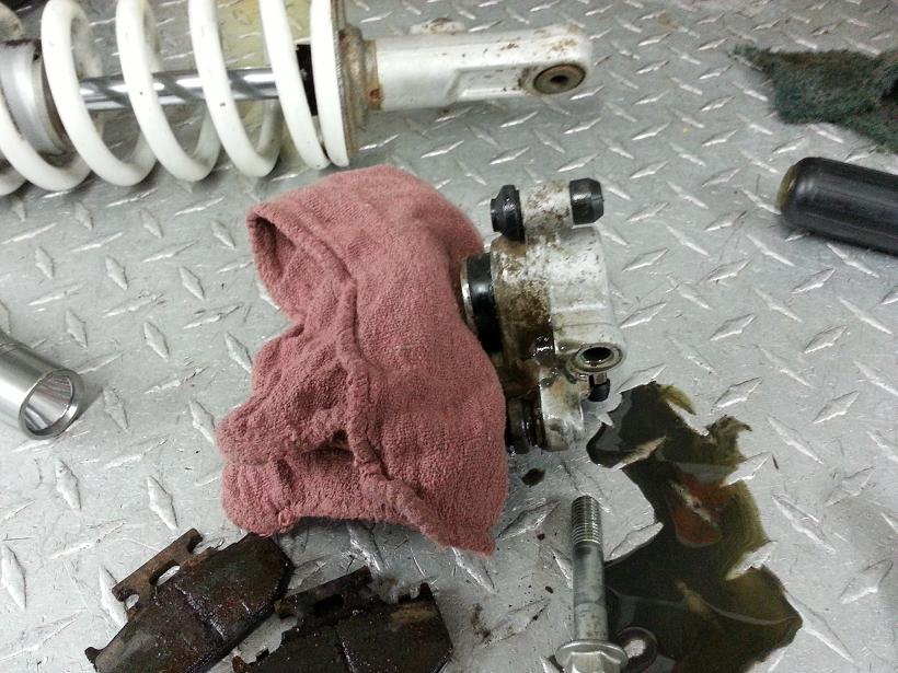

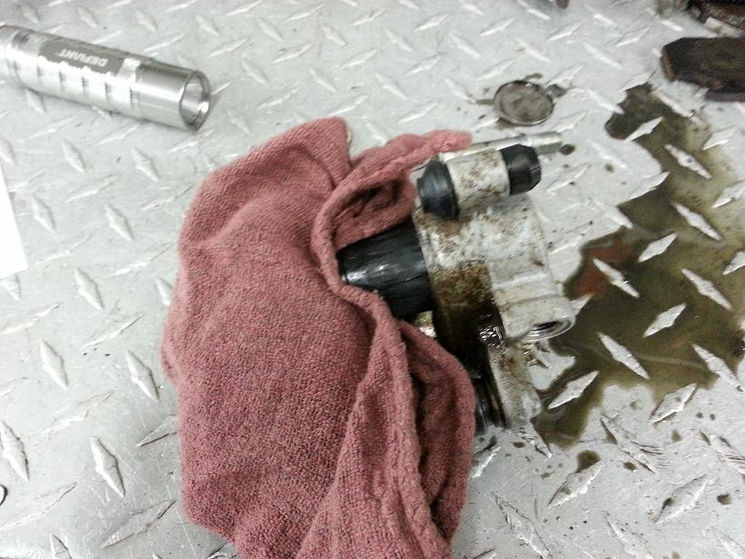

When using compressed air to move the piston I like to use a shop rag to make a barrier to keep the piston from shooting across the room.
Yes, they will shoot across the room
- OEM-CYCLE.COM BRAKES 107.JPG (104.88 KiB) Viewed 18370 times
Put your rubber tipped nozzle in the brake hose hole and give short bursts of air.
- OEM-CYCLE.COM BRAKES 108.JPG (84.67 KiB) Viewed 18370 times
Typically they will shoot out with a noticeable pop..
If you don't use a rag to keep the piston from shooting out, be sure to aim it in a safe direction because the piston will easily shoot out 12 or more feet even under fairly low air pressure.
This one oozed out because the piston and seals were completely gummed up.
- OEM-CYCLE.COM BRAKES 109.JPG (99.39 KiB) Viewed 18370 times

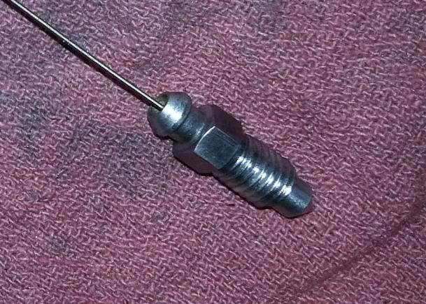

I clean the bleeder valve with a guitar string.
- OEM-CYCLE.COM BRAKES 112.JPG (80.7 KiB) Viewed 18370 times

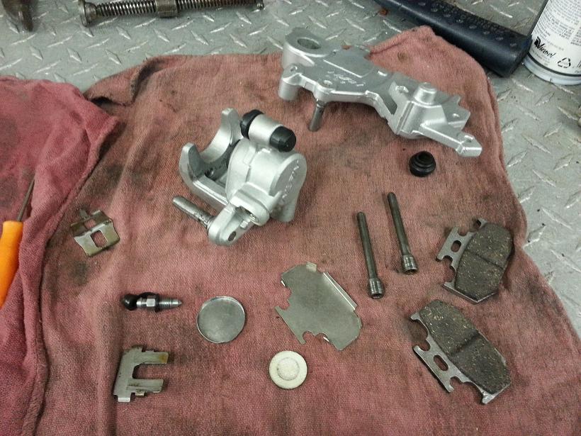

If I had my way I would replace the seals, pads, and pad pins.... but... I don't have replacements so he is gonna get what I give him and like it...
- OEM-CYCLE.COM BRAKES 116.JPG (122.38 KiB) Viewed 18370 times

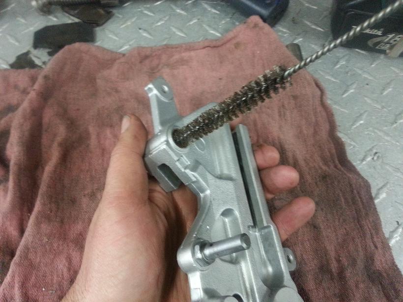

Again, I clean everything..
- OEM-CYCLE.COM BRAKES 117.JPG (113.08 KiB) Viewed 18370 times

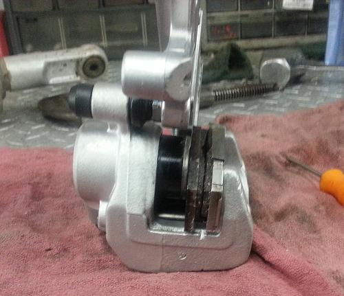

Assembled.
- OEM-CYCLE.COM BRAKES 118.JPG (34.26 KiB) Viewed 18370 times
Because the pads are wide open I give the caliper a quick shot of air down the hose hole and they snap shut.
If yours is slow to close, better give it a complete rebuild...
- OEM-CYCLE.COM BRAKES 119.JPG (33.56 KiB) Viewed 18370 times
