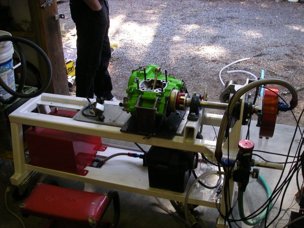

I got to spend a day in Dave Roberts shop (ILR performance) with my tecate 330 on his Dyno. its a Land and Sea dyno.
it measures it at the crank.
I think you could make somthing simular with a hyd pump and valves and pressure sensors

what works good is if you take the power off your front sprocket. take an old sprocket and weld a ~4 in long piece of pipe onto it. use a large enough ID to get your snap ring pliers inside to attach it to your bike. on the other end of the piece of pipe, weld on a flange. weld the same flange onto a shaft going to your dyno and bob's your uncle. its nice to have a rubber dampnner in your system somewhere.
power varies alot with air temp, crankcase temp, coolant temp all sorts of things so consistancy is important.
