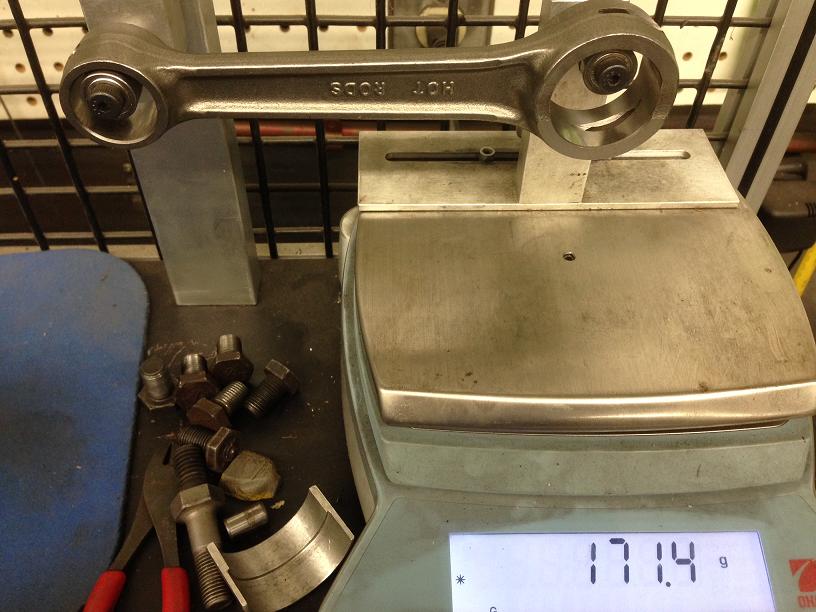

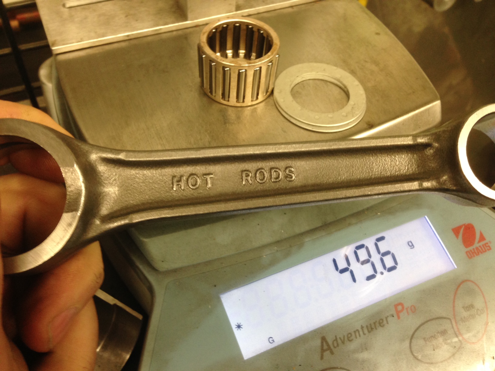

Here we will be comparing the weight of Hot Rods, Vesrah, Wossner, and Hot Rods for the KX500.

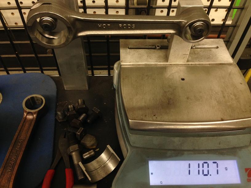

HOT RODS
Total 282.1 GRAMS
BIG END (CRANK END)
171.4 GRAMS
SMALL END (CONNECTING ROD END)
110.7 GRAMS

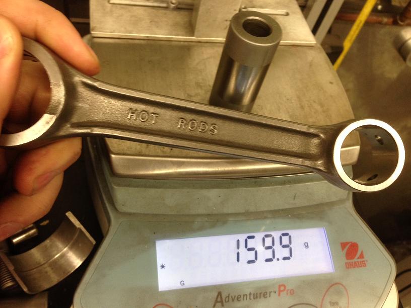

WRIST PIN
159.9 GRAMS

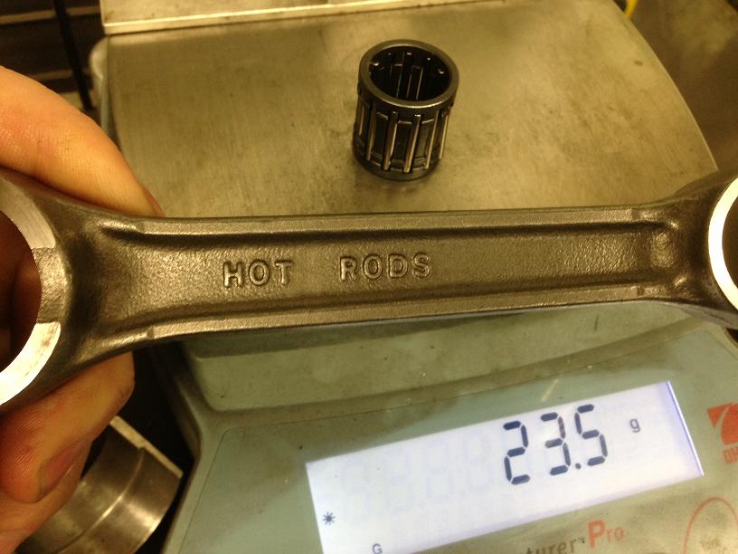

WRIST PIN BEARING
23.5 GRAMS

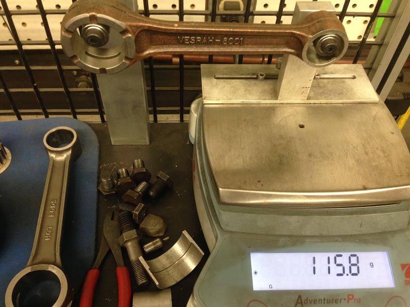

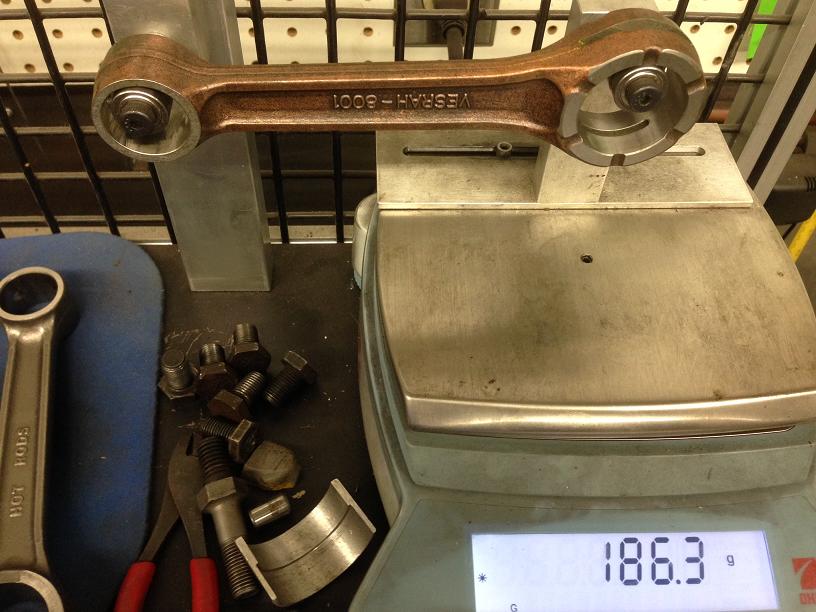

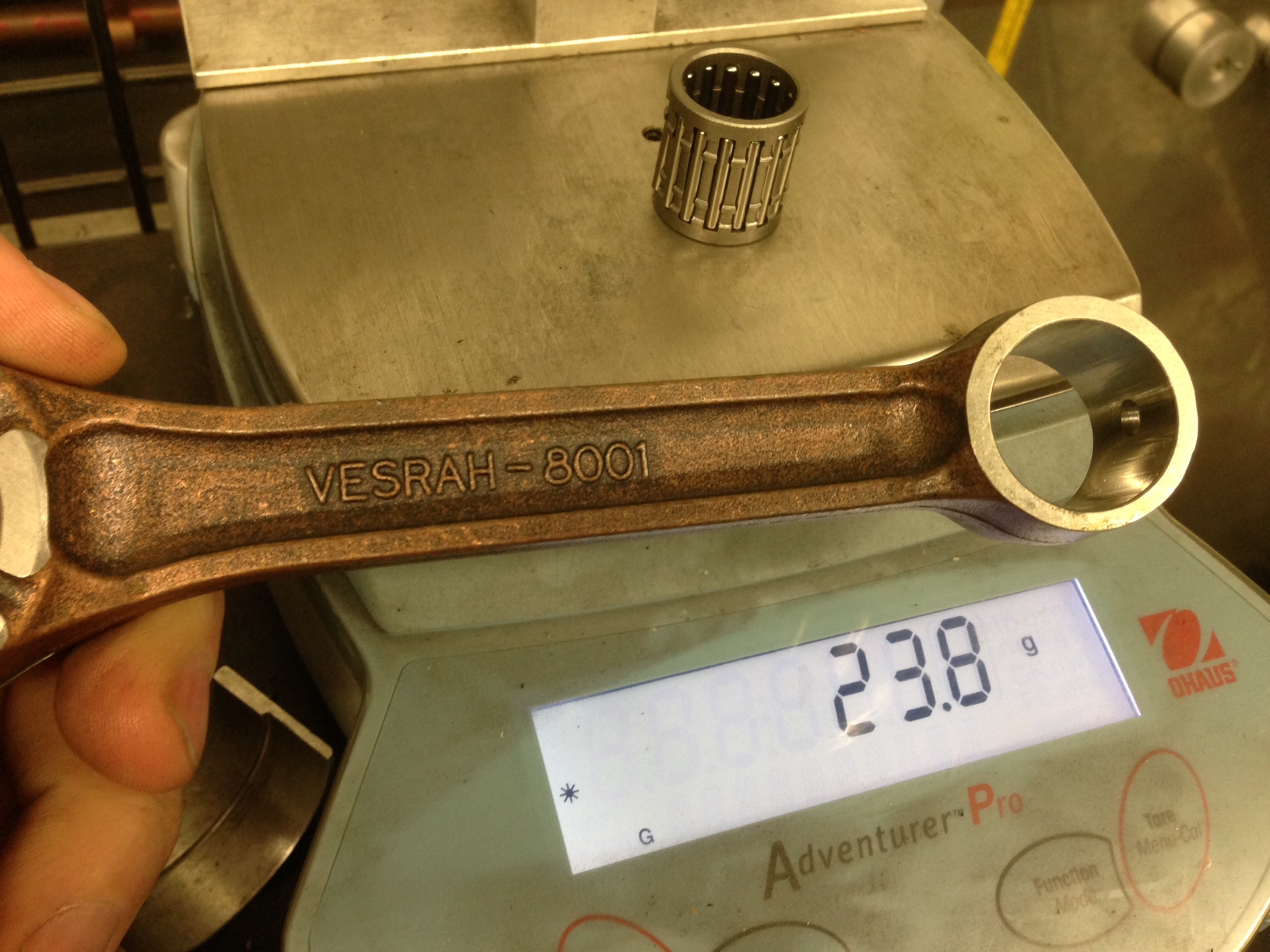

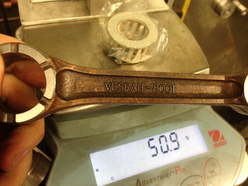

VESRAH
Total 302.1 GRAMS
BIG END (CRANK END)
186.3 GRAMS
115.8 GRAMS

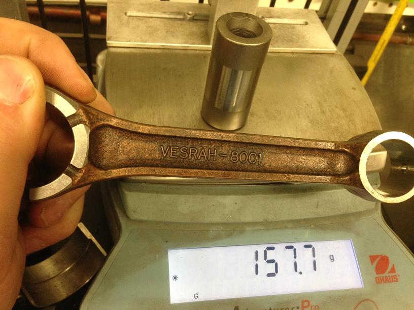

WRIST PIN
157.7 GRAMS
WRIST PIN BEARING
50.9 GRAMS

Here is some pics of Roost weighing some rods and how he did it.
