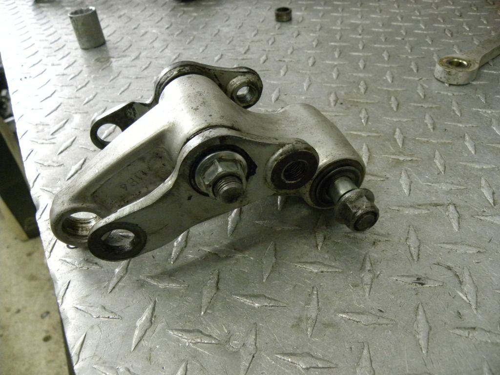

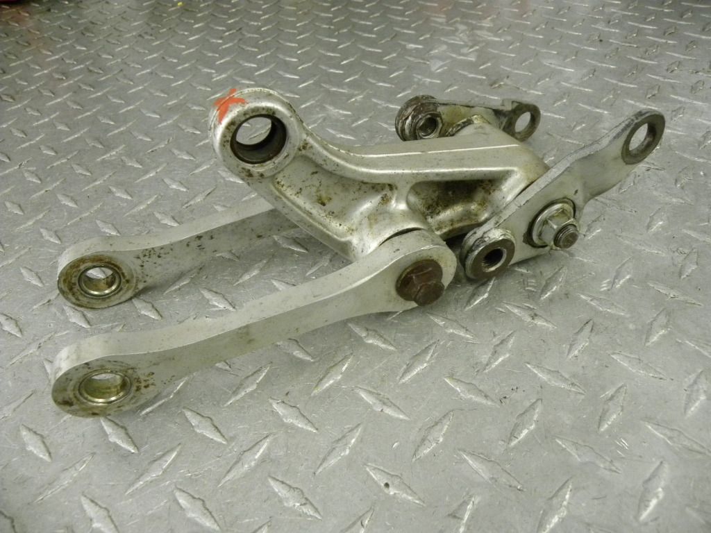

In this example we are using a shock arm linkage from a 2000 Kawasaki KX500.
Here is the setup:
As you can see, it is a little dirty, one of the bearings is shot, and one of the arms is very worn.
No question there, replace that arm.

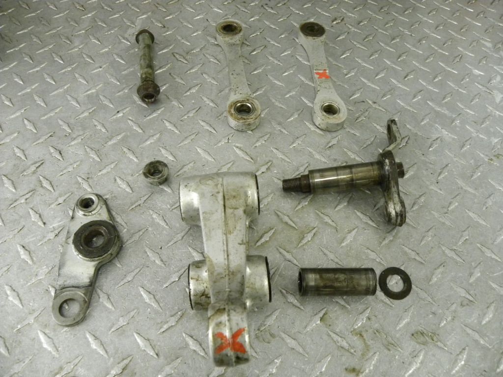

Here is the assembly after it was disassembled:

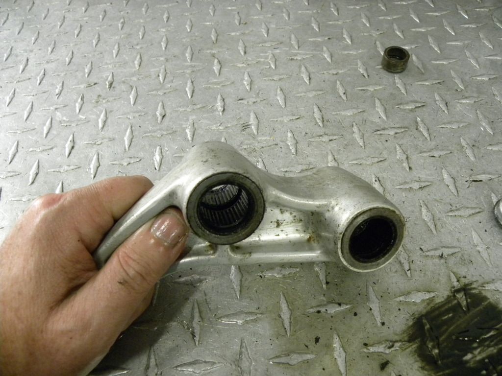

One of the first indicators if the bearings are good or bad is how hard the sleeves are to pull out from the bearing.
If they are stuck or hard to get out most likely you will need to replace them.
If the sleeves pull out fairly easy take a look at the surface of the sleeves.
Are they very smooth or are they pitted or rusty?
In this example the sleeves look good after wiping them off with some WD-40 as a cleaner (Not a lubricant).
To get these bearings ultra clean you can remove the seals, put the bearings into a can of diesel or kerosene, scrub them with a nylon brush (Your wife's tooth brush) let the reader use discretion :shock:
Once they are clean, put your finger inside the bearing and see if the individual needles spin.
Also, spin the bearings around and see if it is smooth.

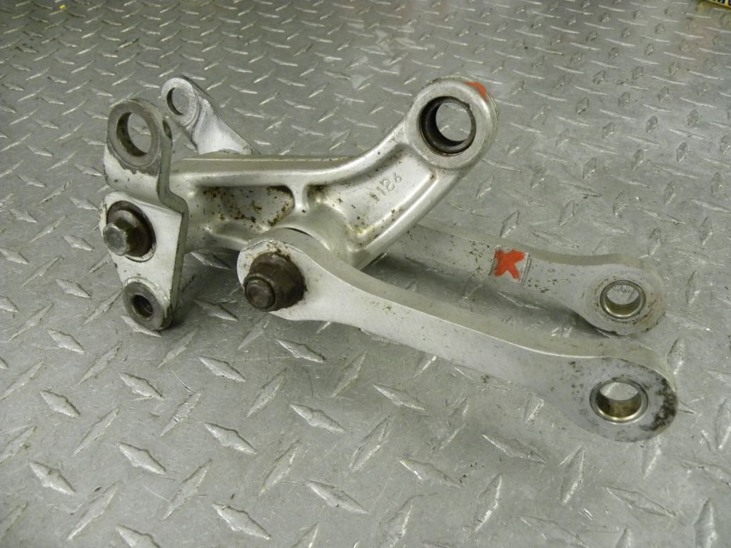

This pic was taken after the bearings were cleaned:
In the picture you can see that the bearings are clean and ready for grease.
If it feels gritty clean again.
If it still feels gritty you will need to decide if you need bearings.
If you plan on keeping the bike in excellent condition, replace the bearings.
If they are smooth or you do not plan on replacing them right away go ahead and use a good quality grease and grease the bearings liberally.
