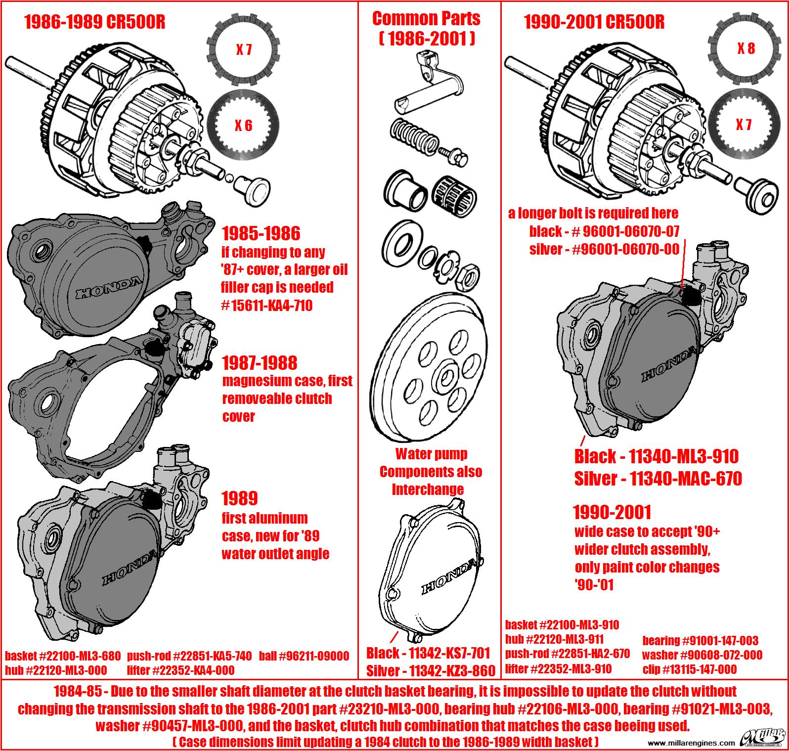

Can't find a right side clutch cover for a earlier CR500?
Posted: Tue Sep 30, 2014 2:01 am
Put a newer one on!!!!
Thanks to Adam Millar for his hard work and research..
Millar Clutch Spec and Interchange.jpg (511.19 KiB) Viewed 8690 times
