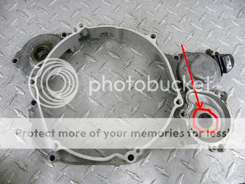

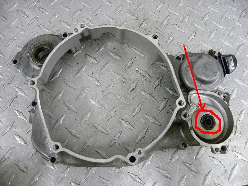

The seal you need replaced will look like this:

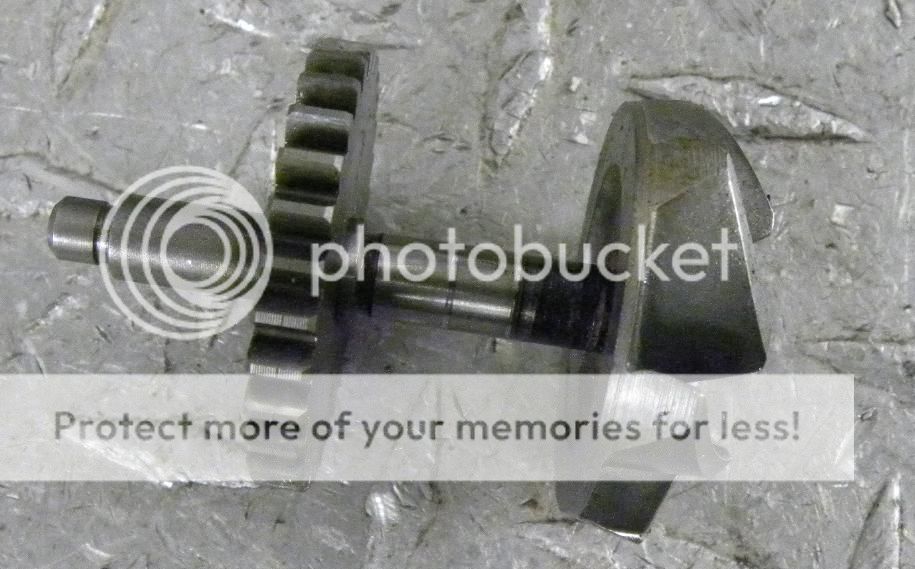

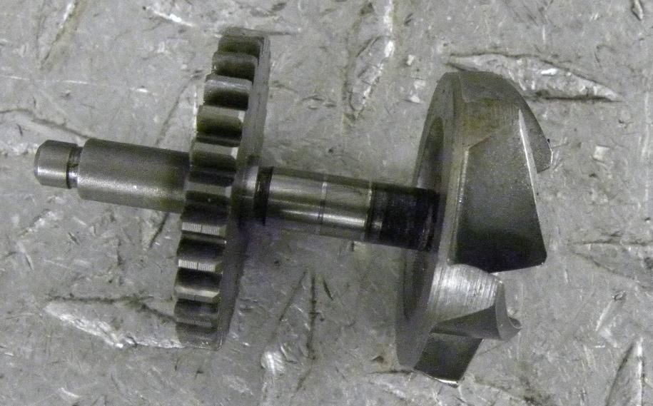

Take a look at the impeller shaft.
In this example the shaft is in really bad shape and needs to be replaced.
