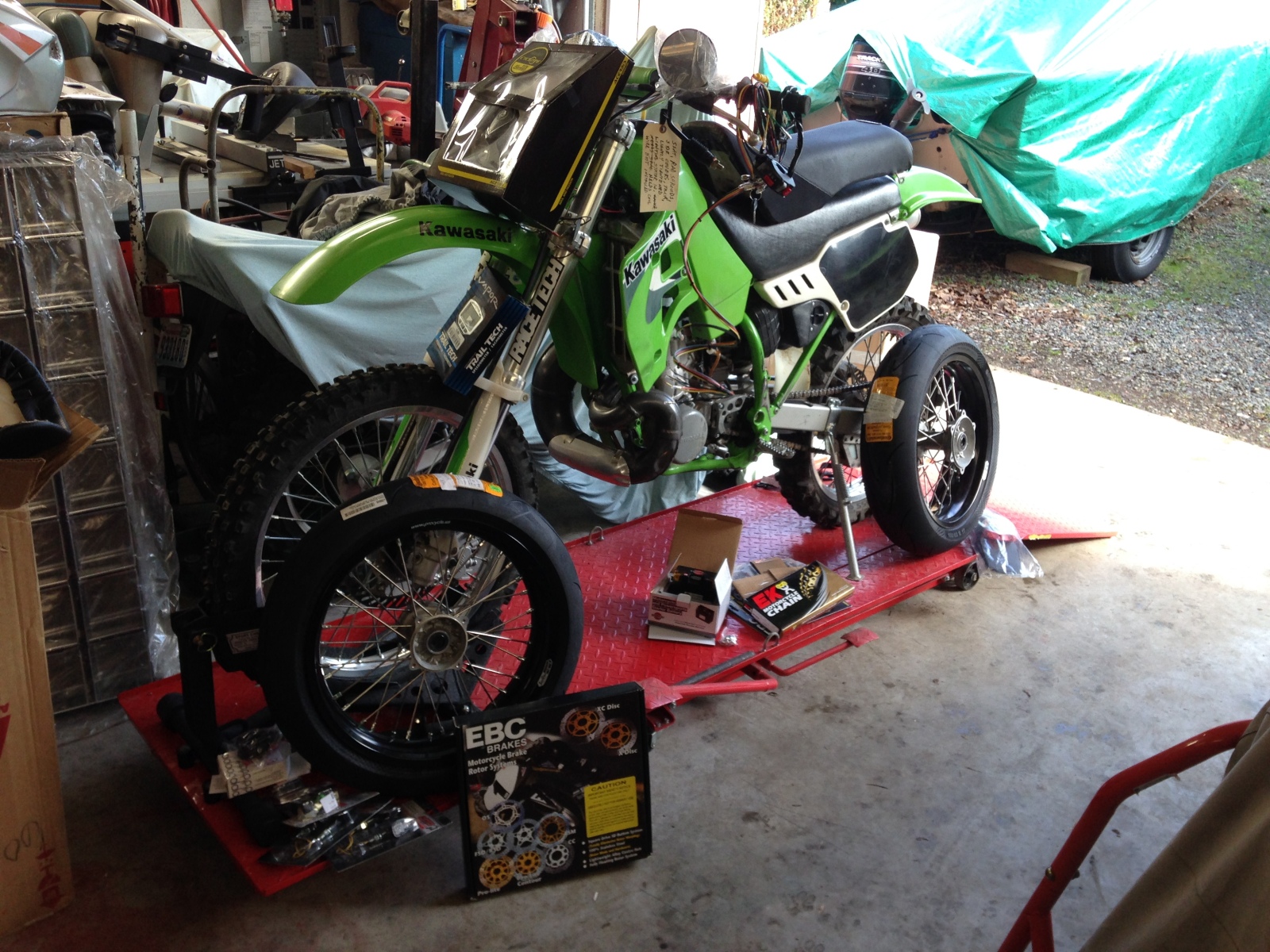

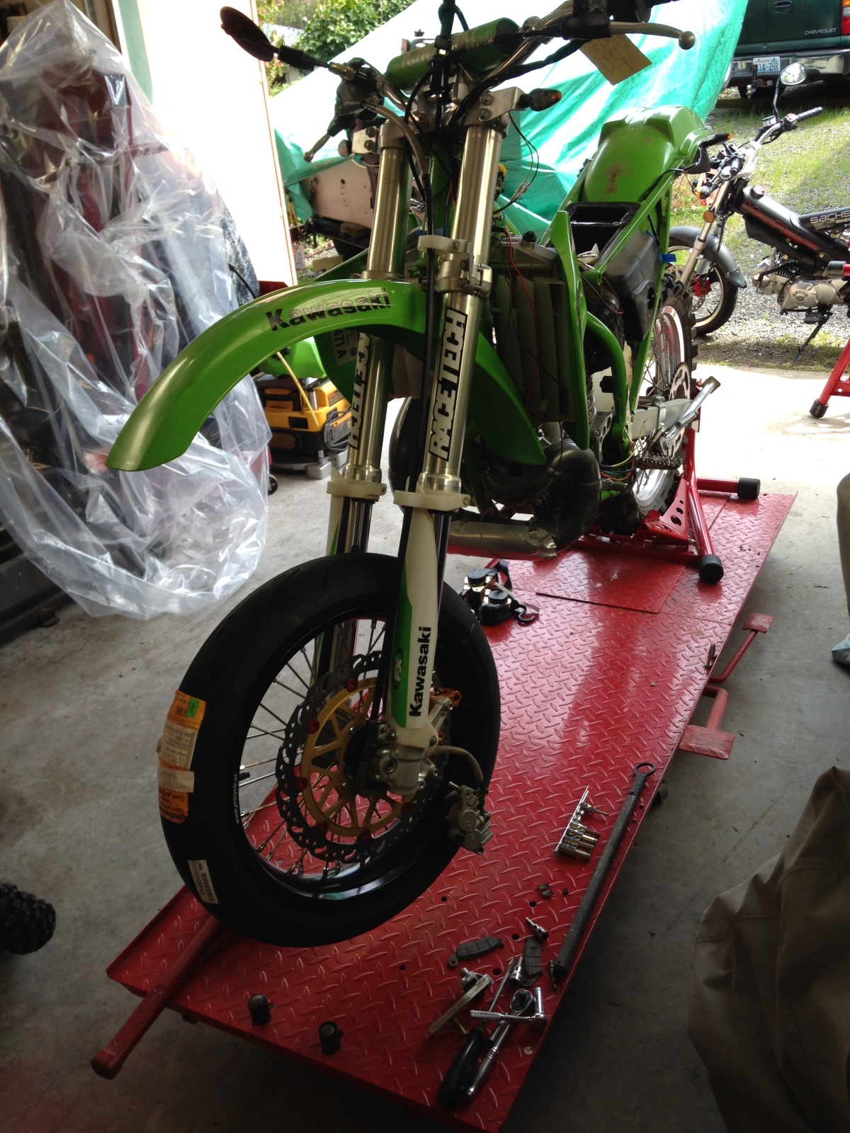

Here are a couple of pics of the project. First is all the nice bits scattered around the bike.
BRUTES 2000 KX500 SUMO BUILD 1.jpg (777.93 KiB) Viewed 8316 times

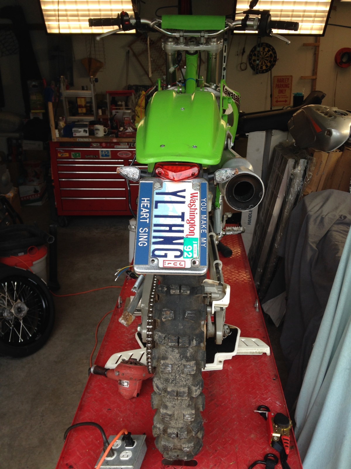

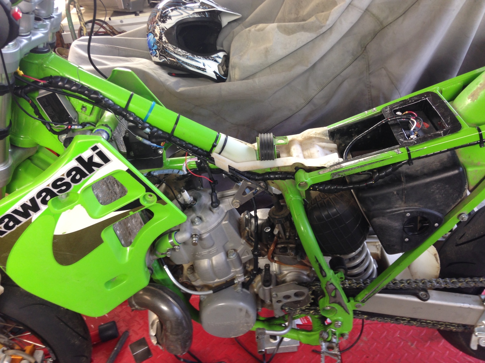

Second is a shot from the back with a plate frame and personalized plate off of one of my crotch rockets from '92. Used it to mark and drill the holes in the fender. Can not see the mirrors but they are pretty much where I want them. The control switch cluster is on the left bar.
BRUTES 2000 KX500 SUMO BUILD 2.jpg (708.24 KiB) Viewed 8316 times
Going to leave the engine stock. It was running good at the end of last year so will probably leave it alone. MZB 100 watt lighting coil is already installed. Should be fun once I get it done. Will take pics and post as I move along. No, I will not be putting the personalized plate and heavy plate frame on this bike, though the plate name probably fits this one better!

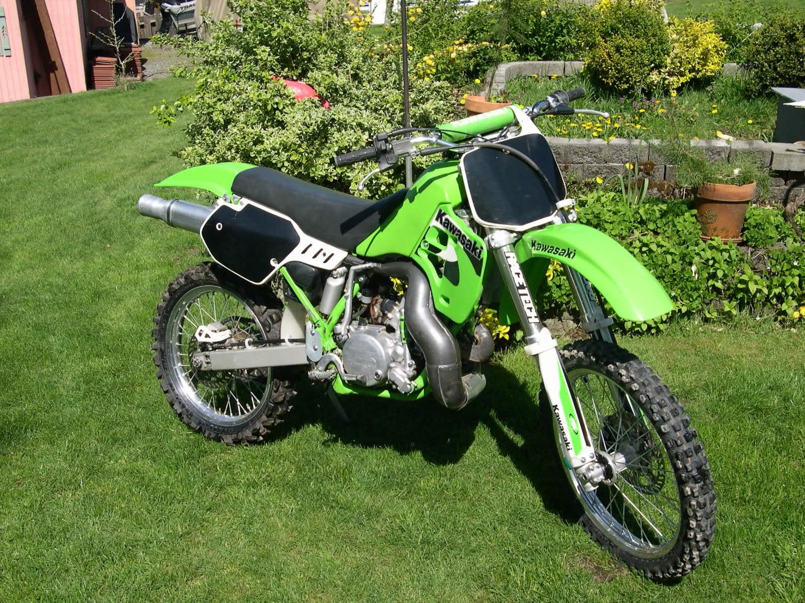

Hey Foxx, missed your question. I think this older pic will explain what you are seeing. Spark arrestor. Not guard. cheesy And an ugly one at that!

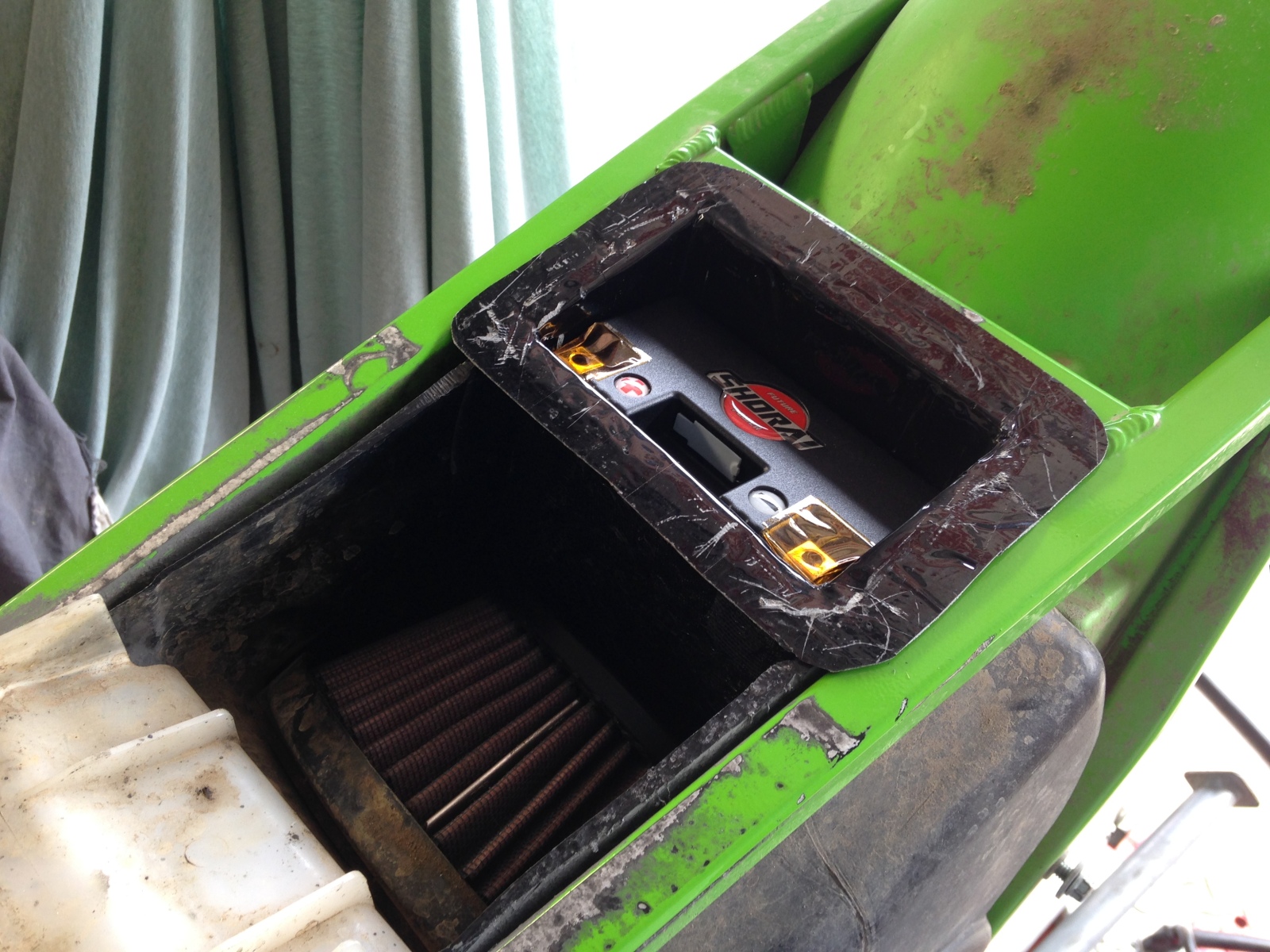

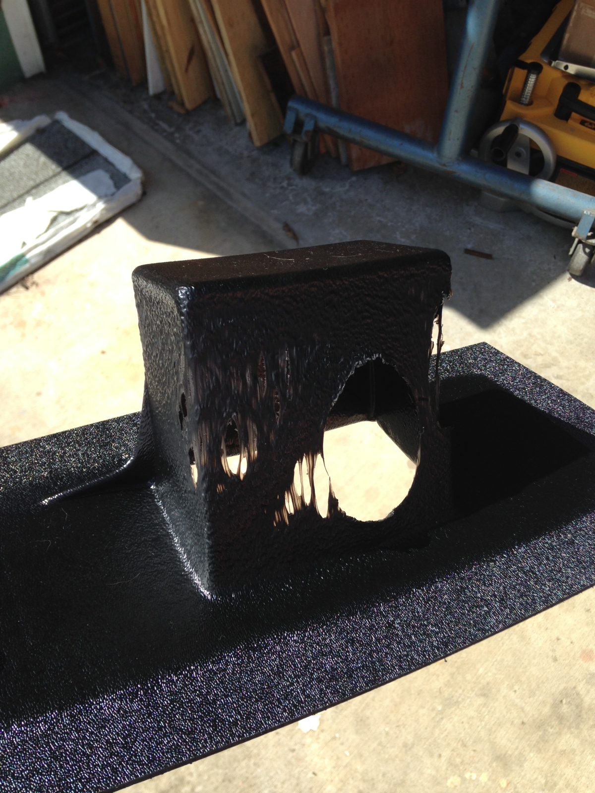

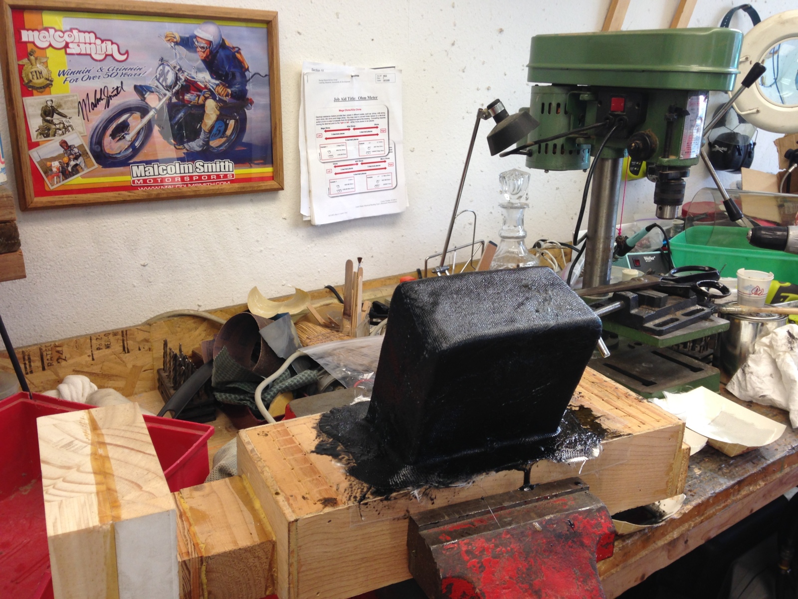

Finally got around to trying the form with .93 ABS. Though the sheet was too small for the stretch I thought I would try it anyway. Oops. The good thing is it allowed me to see that it might have been a tiny bit too short but there was room to add a spacer to the bottom of it.
BRUTES 2000 KX500 SUMO BUILD 5.jpg (774.26 KiB) Viewed 8315 times

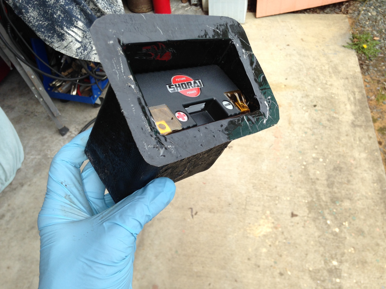

So on to fiberglass. Taped the form and base with strapping tape, mixed a little black pigment with the resin, and 'glassed 'er up. Did it last night so have not been to the shop to check it yet. Yes, that is a signed Malcolm Smith poster. Had a fun few hours visiting with him a couple years ago. He is really as nice as he seems. Still rides!
BRUTES 2000 KX500 SUMO BUILD 6.jpg (742.3 KiB) Viewed 8315 times
Re: Brutes 2000 KX5 Street SuMo Build
Box trimmed with battery in place.
BRUTES 2000 KX500 SUMO BUILD 7.jpg (609.21 KiB) Viewed 8315 times
Box in bike. As was said in the movie 'Babe'; "That'll do pig, that'll do..."
BRUTES 2000 KX500 SUMO BUILD 8.jpg (624.56 KiB) Viewed 8315 times
Interesting note; The piece of wood I used dried and warped after I cut it down. Makes the battery a tight fit.
Motorrad
Dam that's clean. I may have to copy that ideas for bat box

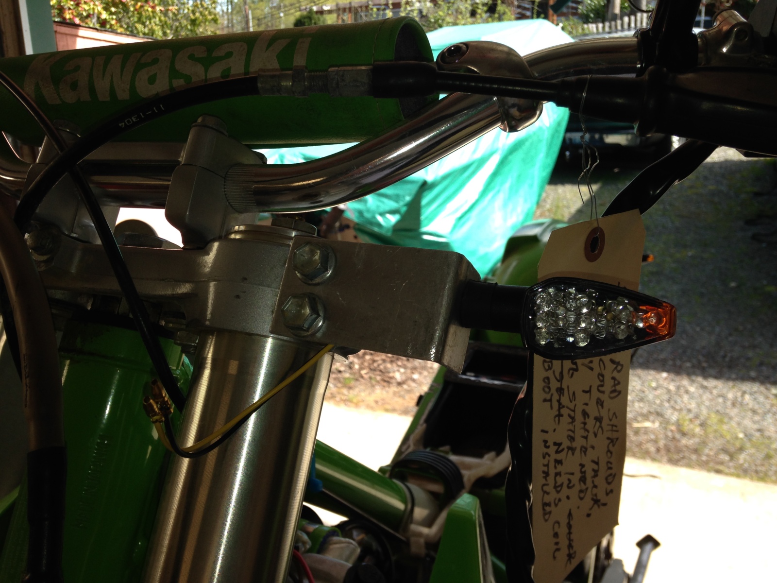

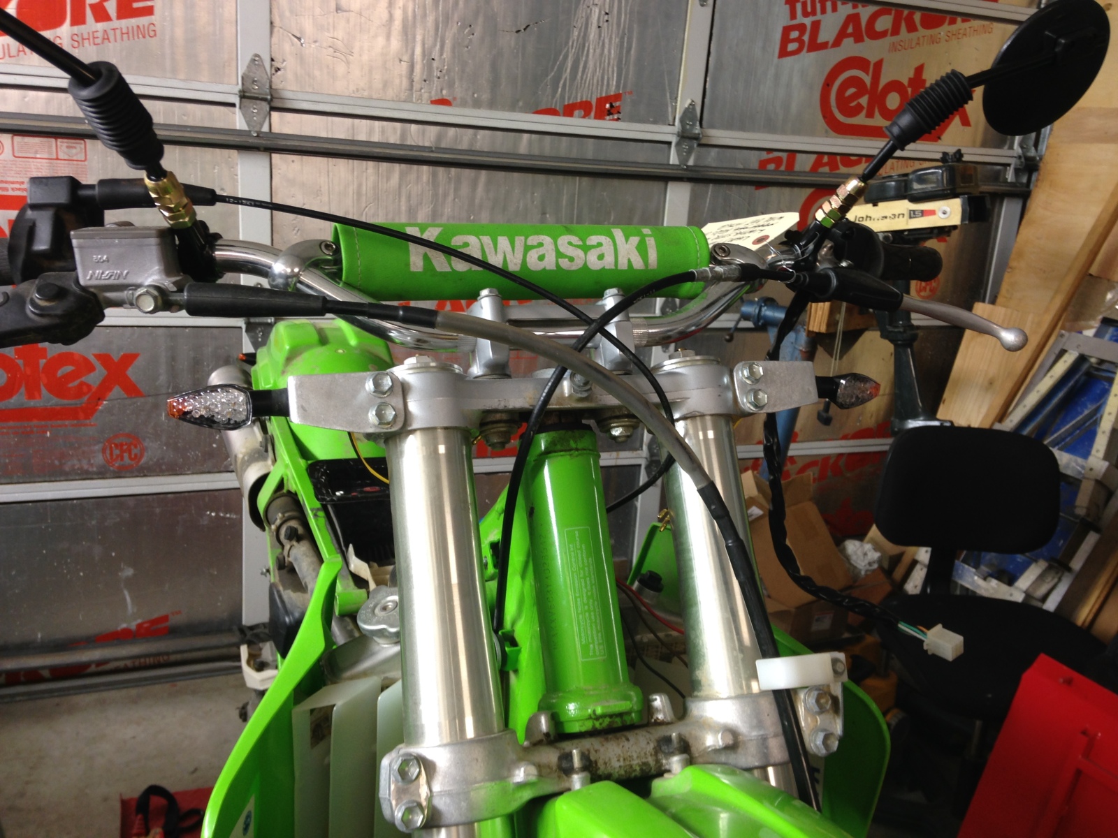

Got a couple things done. Roughed out front turn signal mounts. Need to round the corners and clean them up a bit but I think that is where they will be.
BRUTES 2000 KX500 SUMO BUILD 9.jpg (549.46 KiB) Viewed 8315 times

Finally got back to rounding off the corners of the brackets and mounting them permanently. May do a bit more to them but they are good for now.

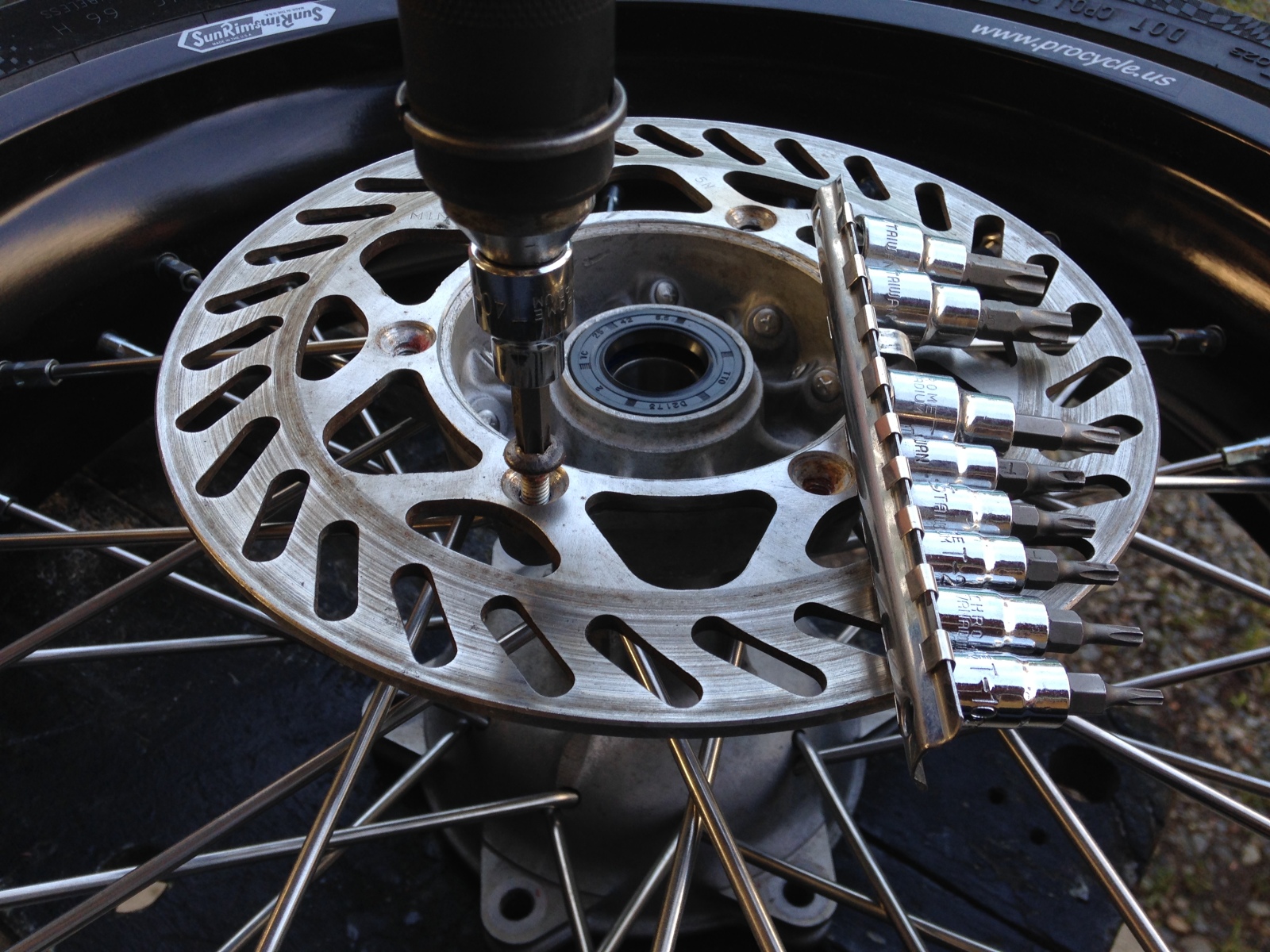

After getting the 'honey do' list done today I puttered around in the shop and finally decided to stop dicking around and work on getting the old rear rotor off, for better or worse. Did a lot of broken and stuck bolts over the years on old bikes and when I worked at the Electric Motor and Pump Shop. Pumps and electric motors on ocean going boats take a beating!
Dug the Oxy/Acet set out and was showing 15 lbs on the Acetylene bottle. Have not even used it for at least 10 years. Put my smallest tip on and started pulling bolts. There was a couple of hosed up ones but with the hammer driver and the heat five came out with only a little effort. The last one was really hosed up. After determining it was not coming out 'normally' I used my first line of pulling stuck allen head bolts.
I drove a Torx bit into it with my short hand sledge, put the heat to it and smacked it with the hammer driver. BOOM! Out it came! Not near the pain in the rear I thought it would be. Excellent!

sandblaster
Yep, I have removed a few thousand of them and you hit the nail on the head, without heat your beating a dead horse.
I use map gas and hit the bolt for about 30 seconds.
Usually that's enough to get them right out.
Oxy/Acet will do it MUCH faster smiley
Hammer driver? Mandatory...

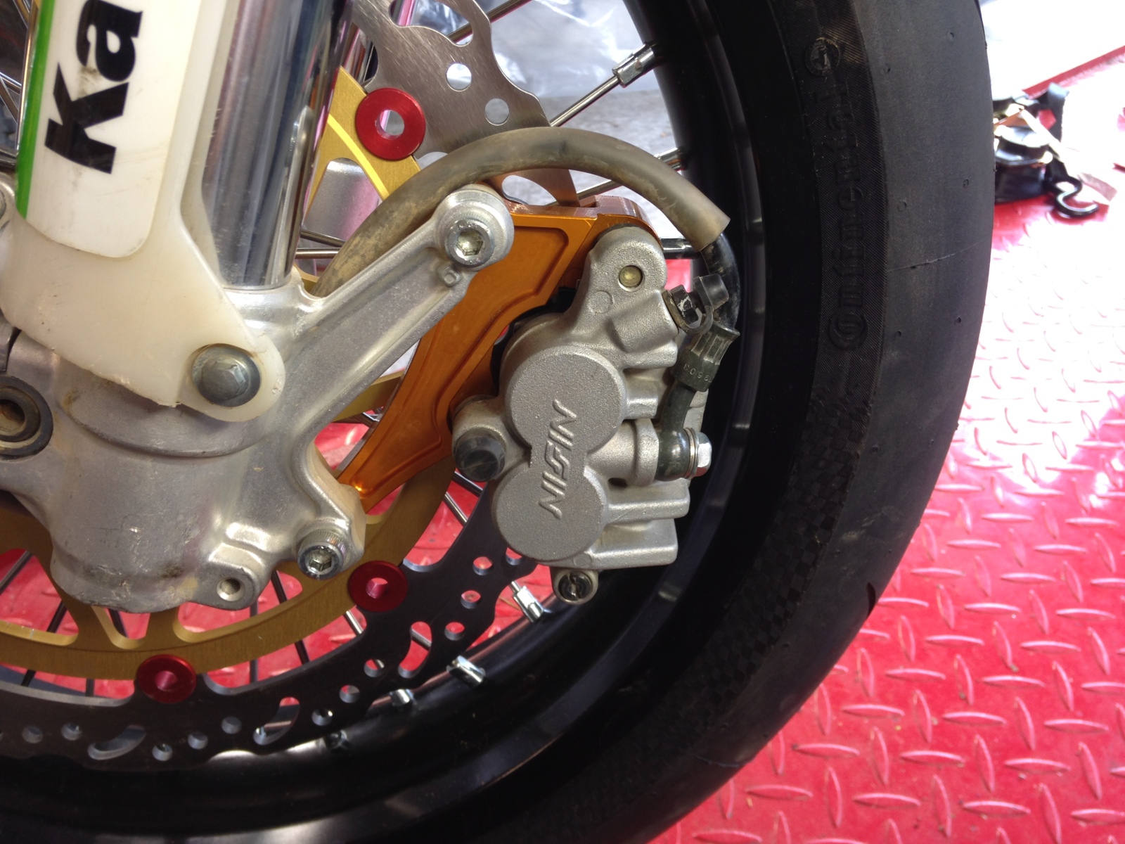

I did a search for info on the 320mm front brake rotor install to save some trouble but no joy. No instructions included with it other then basic 'make sure it fits without binding'.
Looks like the stock line routing is not going to work, the line brackets will have to go and I will have to pull the line up pins (at least one) out of the caliper to
BRUTES 2000 KX500 SUMO BUILD 9-3.jpg (818.46 KiB) Viewed 8314 times
install into the new parts. Ah yes, the joys of modifying stuff!

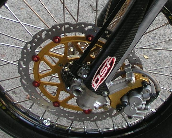

Here's how I routed mine.

Looks like the line routing will work. The lower bracket is touching the rotor and that is where I stopped. Figured the whole thing might need to move. Not sure my EBC bracket looks like yours. I will look closer at it before mounting. The rotor bolts were incorrect that were sent with the kit so now I am wondering if something is amiss.
sandblaster
Yeah, I didn't think my EBC set up was gonna work at first either.
But, as you can see it will work with not much to spare.

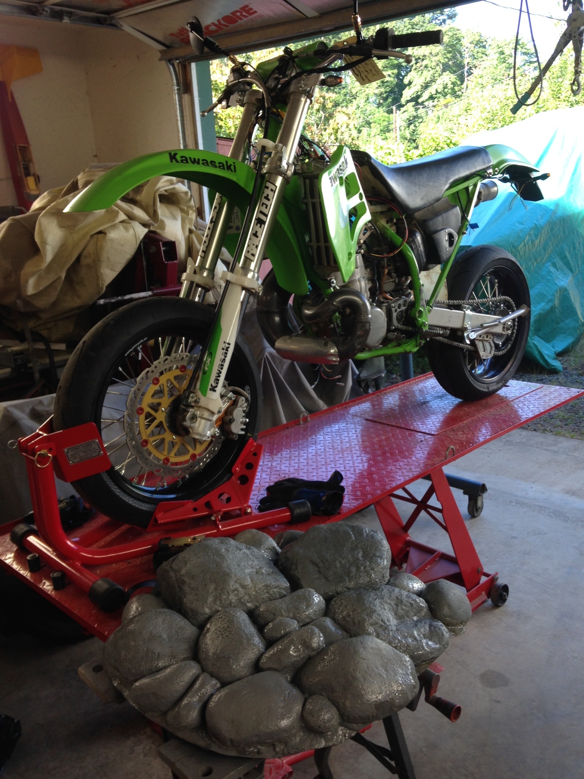

Finally got the rear wheel on. Rock (foam) filter cover I have been working on is in the foreground. May have a bit more time to work on the bike now that it is mostly done. tongue

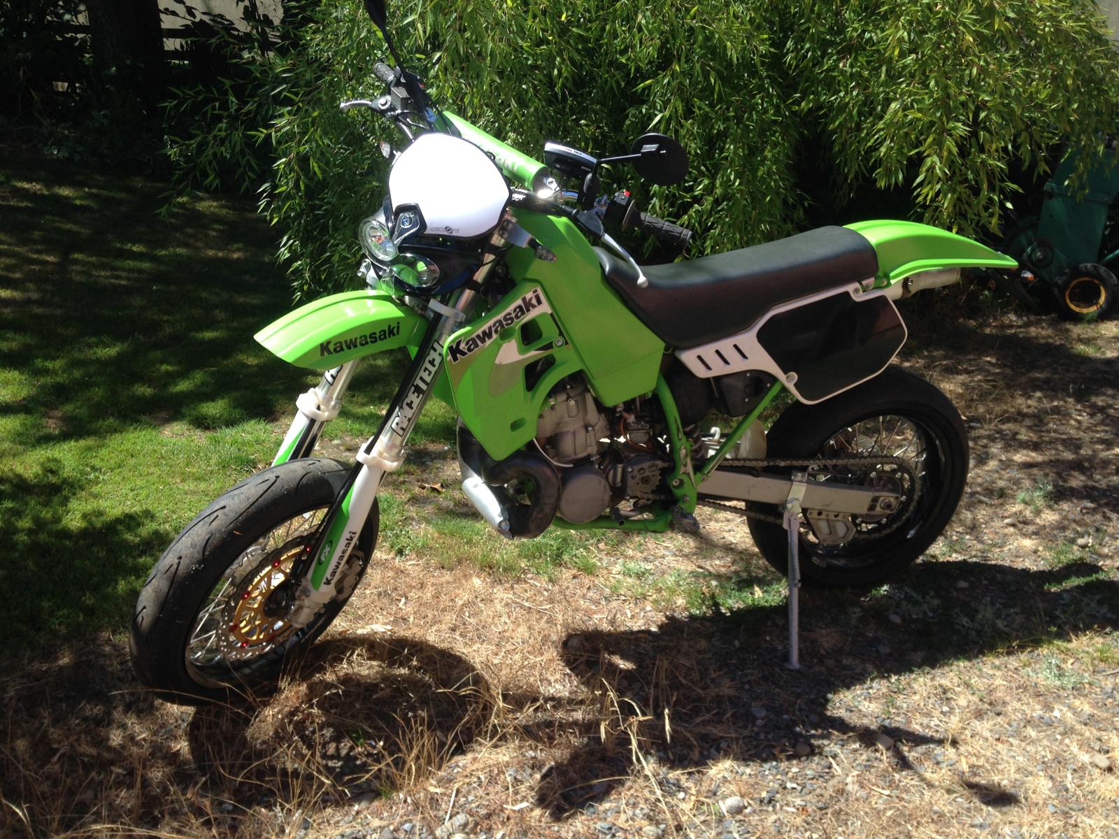

Bagged the crotch rocket fender and cut the original to the same length from the mount holes to the end as the rear part of the fender is. Made a template off of the end of the front part of the fender and used that to cut the end off so to give it the same profile as the original.
Also routed wires and drilled some holes to route them where I wanted them to go. Ended up cutting the 'custom' harness to make it fit better so will solder and shrink wrap the sections I will use back on. No pics this time.
First time I have actually attached the headlight unit where I want it to go. I think it will look good. Repaired the broken turn signal as well. Making progress!

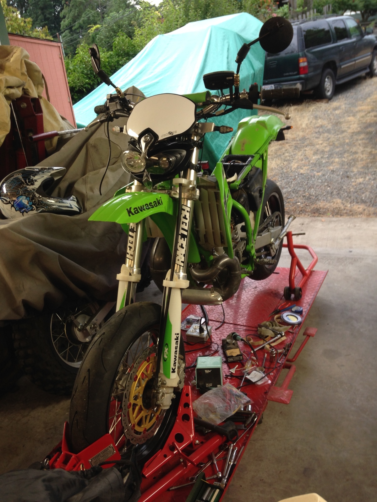

Well, I think it is done. Thought it was done this morning but while cleaning up saw a wire with a 'thing' on the end and realized I had not put the speedometer pickup on it. after making a bracket, running the wire and glueing in a magnet I 'think' it is done again. smiley
Will fire it off tomorrow. Checked for spark while the plug was out and it has spark. Kick stand 'may' be short enough but a strong breeze might blow it over. Have to park on a hill or put the stand in a depression for safety. Or just cut the thing down. undecided
I will call the place about inspecting it for a plate today and see what they need.
Took long enough!
