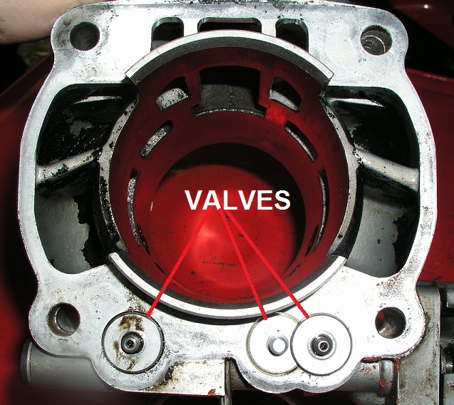

89-04 is easy.
If you have a 3 valve set up it's 89-04 and they are all the same.
89-04 KX500 CYLINDER.jpg (162.47 KiB) Viewed 12666 times

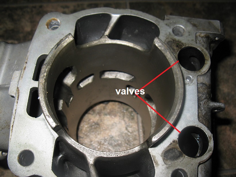

Here's where it gets a bit more tricky.
86-88 kx500's all have two valves,
86-88 cylinder.jpg (167.69 KiB) Viewed 12666 times

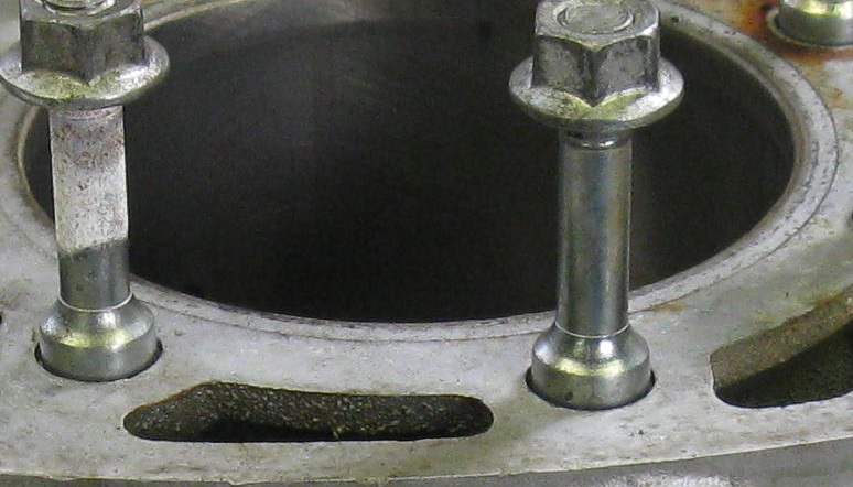

The 88 is the only year of the 3 that uses 8mm standard head studs like this:
88 kx500 cylinder head studs.jpg (88.4 KiB) Viewed 12666 times

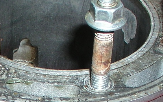

Both 86 and 87 use counter bored studs like this:
86-87 kx500 head studs.jpg (98.94 KiB) Viewed 12666 times

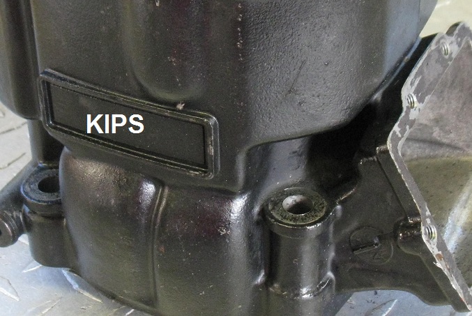

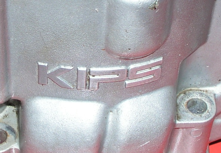

And the 88 kx500 cylinder is the only year that has KIPS in raised letters like this:
88 kx500 kips id on side of cylinder.jpg (146.04 KiB) Viewed 12666 times

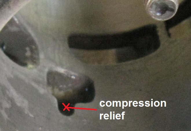

Take a look at this 87, note the compression reliefs on the kips valve ports:
87 kx500 cylinder kips compression reliefs.jpg (67.93 KiB) Viewed 12666 times

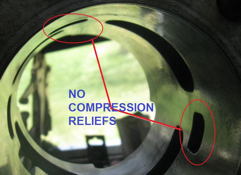

Now take a look at the 86 kx500 kips ports, note that there is no KIPS compression reliefs:
86 KX500 KIPS PORTS WITH NO RELIEFS.jpg (146.78 KiB) Viewed 12666 times
So that should help you out.
