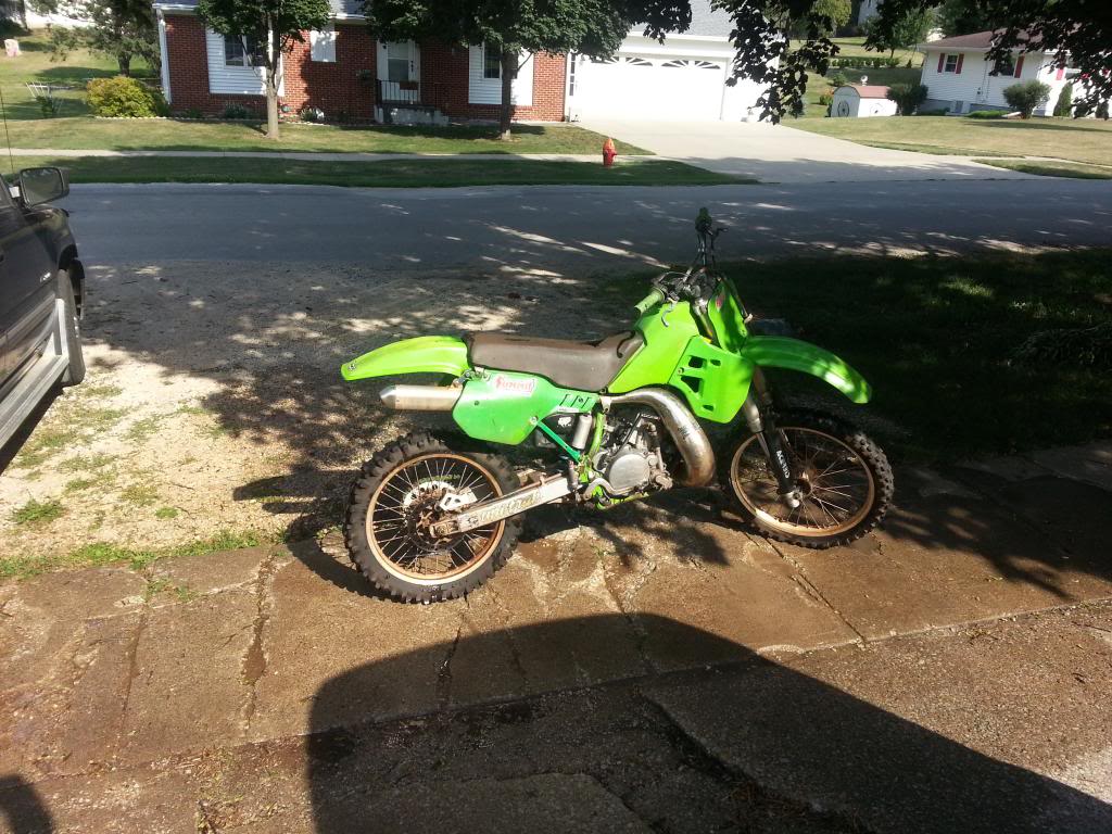

Okay so a little back ground first. i stopped racing motocross 20 years ago. At that time i was racing a 93 KX500. My wife at the time didnt like the risk and we just bought a house and were starting a family so racing and the K5 went. 20 Yrs later i am divorced and the kids are doing well so i thought it was time i started riding again. Dont want a 4 stroke so i bought a 2001 kKX250 gave it some love and have been riding it since May. Man have i missed riding dirt bikes. I really wished i wouldnt have waited 20 yrs to start back up. Here is the 01 KX250 i have been riding.
2000 kx250 TO k5 conversion 1.jpg (102.92 KiB) Viewed 7549 times
It has been really fun to ride and i have been having a blast but, I really miss the bark of the K5. So i found this place and thought i would try to do my own conversion. I really like the 99-2001 KX250 chassis. So i figured that is the chassis i would use plus then i would have 2 of the same yr chassis so they would share all of the parts minus motors.
Here is the donor bike i just bought this saturday. i picked it up for $500 it is a 2000 KX250 that has a blown motor but everything else is there and in pretty good shape.

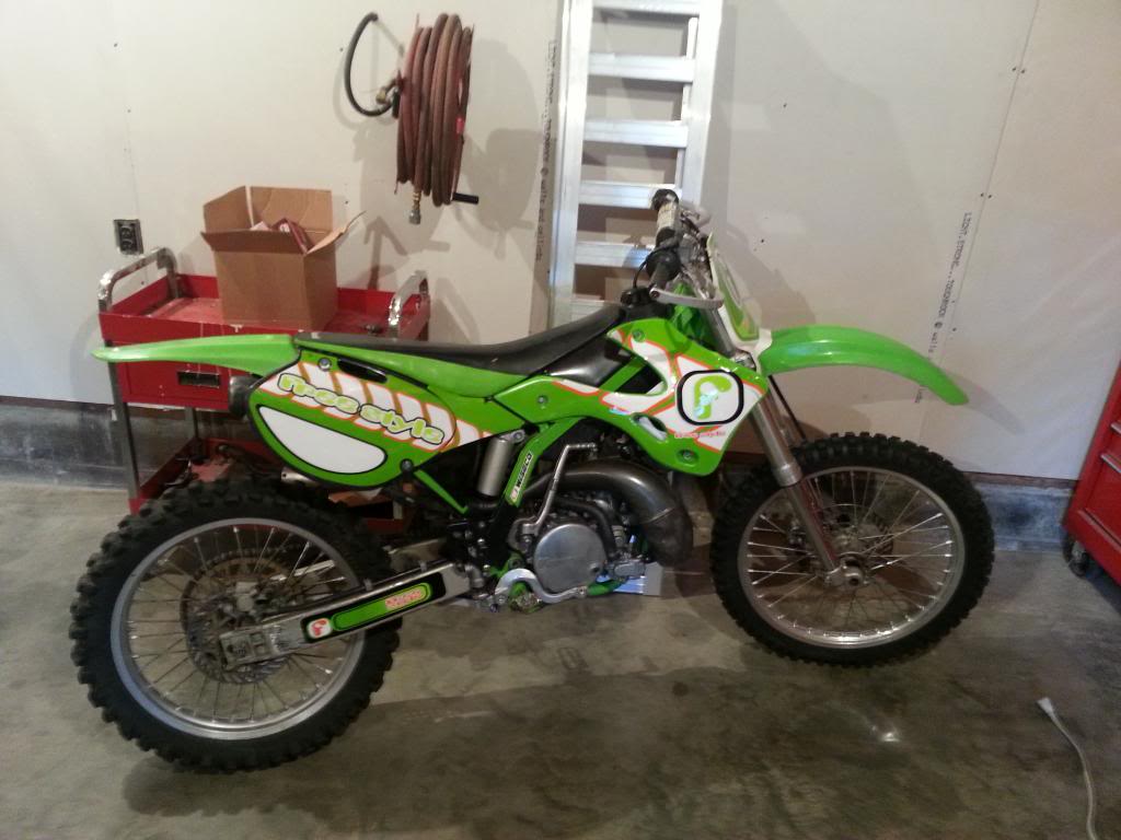

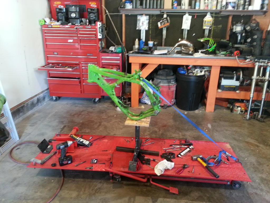

Well I got a little farther on the build or i guess tear down at this point. I got the the donor frame all disassembled at this point.I need to power was everything to get it cleaned up.Sorry about the blurry pics all i have is my phone.

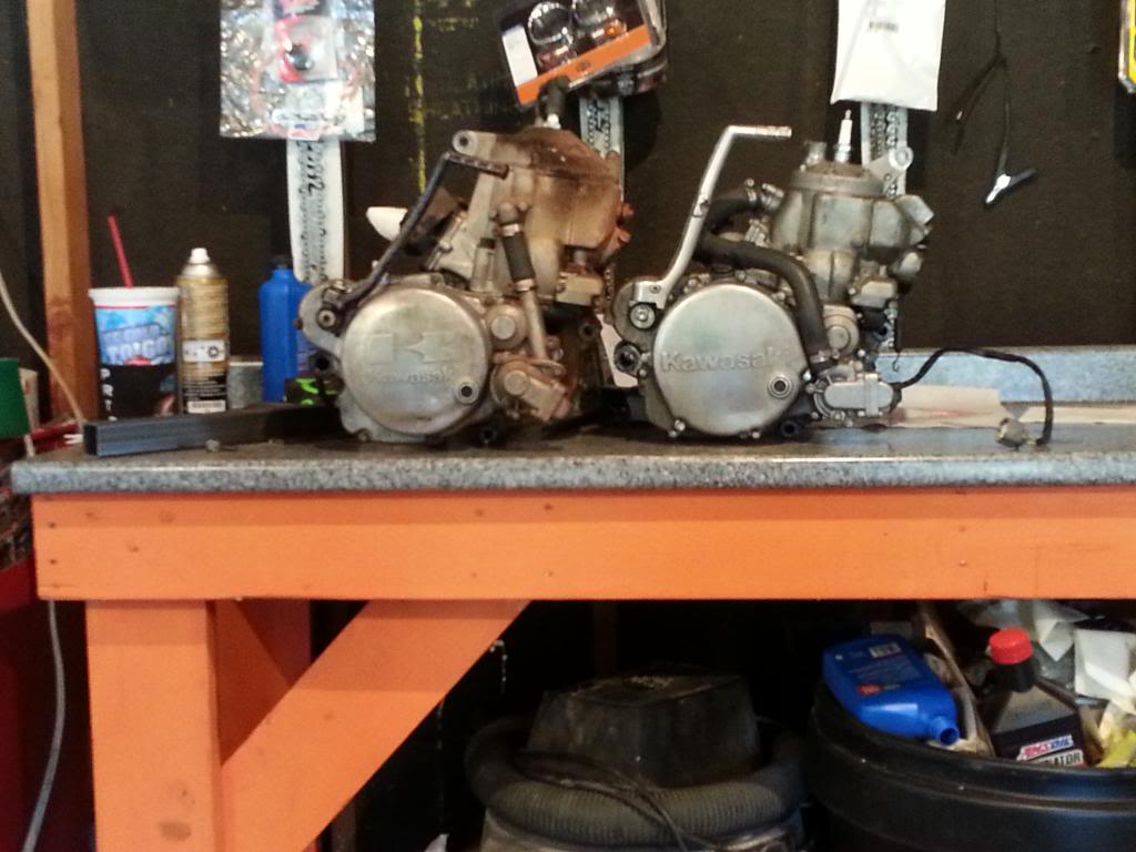

I got the motor out of the donor k5. Looked into the exhaust port and it looked real nice in there. Still has the cross hatch on the cylinder walls. Looks pretty fresh. Here is a pic of the K5 next to the kx250 motor.
2000 kx250 TO k5 conversion 5.jpg (85.38 KiB) Viewed 7549 times
Know I need to get a 43/64 drill bit.
what is the best way of cleaning the motor with out tearing it apart?

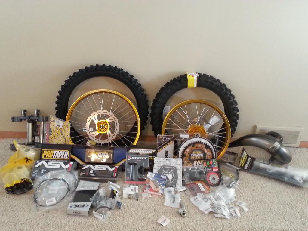

ok, so I have not been able to do any work to the K5 due to the weather still. I thought I would atleast post a pic of some of the parts I have been gathering for it. Enjoy!!

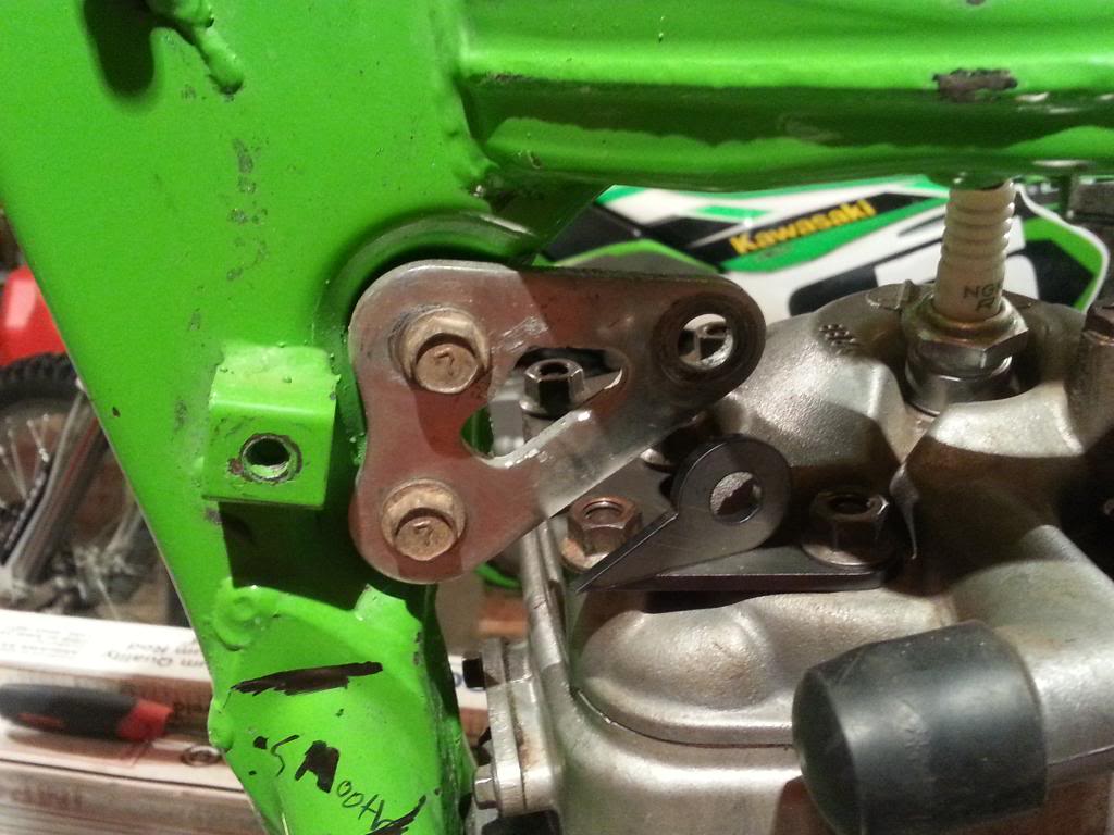

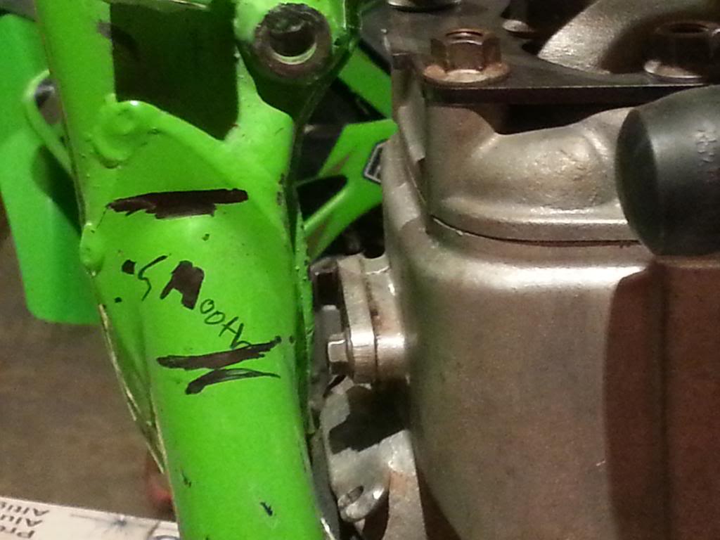

I have a couple questions on the 99-02 conversions. First, when fitting the crossover hose from the radiator to radiator I know you grind down the pinch weld to gain room. I was wondering if anyone wished they would have notched the frame slightly to gain more room? Here is a pic of the area I am talking about. The area I am talking about is marked "smooth" in the pic.

The next question is for anyone who has used the JFab headstay kit. When putting it on I can not figure out anyway to get this thing to line up. It is a 2000 kx250 frame with a 90 k5 motor. It looks to be way off or I am really missing something easy. Here is a pic of what I am talking about. You can see the bracket actually touches the headstay mount on the bottom. This is after flipping the bracket upside down to gain the extra room. Also the piece sitting on the bracket in the fore ground is the rest of the bracket kit that is needed to be welded on to mount to the bracket. There are 2 of these pieces. I must be really missing something. I have asked JFab to take a look at the pics to help me out. I would like to say that I am in no way bashing the quality or workmanship of this kit. I am missing something and just put this out here for help nothing more. I think this is a quality kit and I am very happy with the purchase.

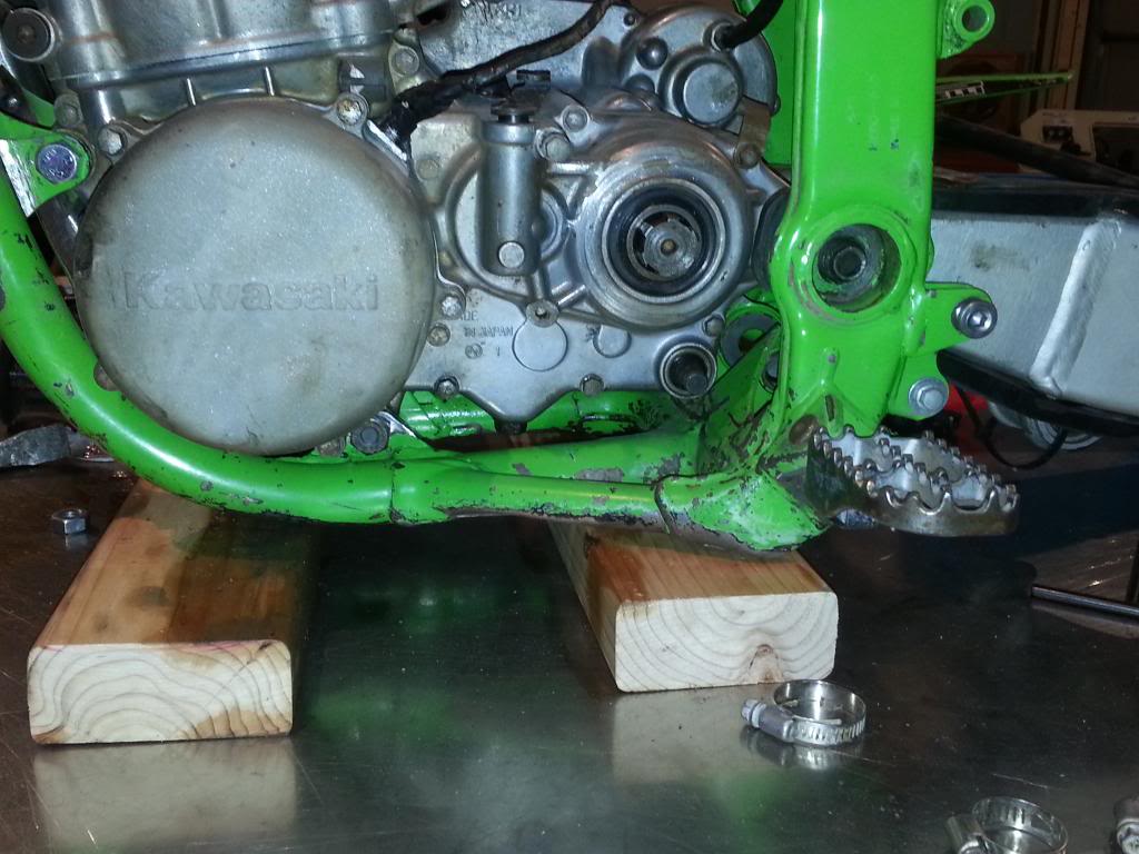

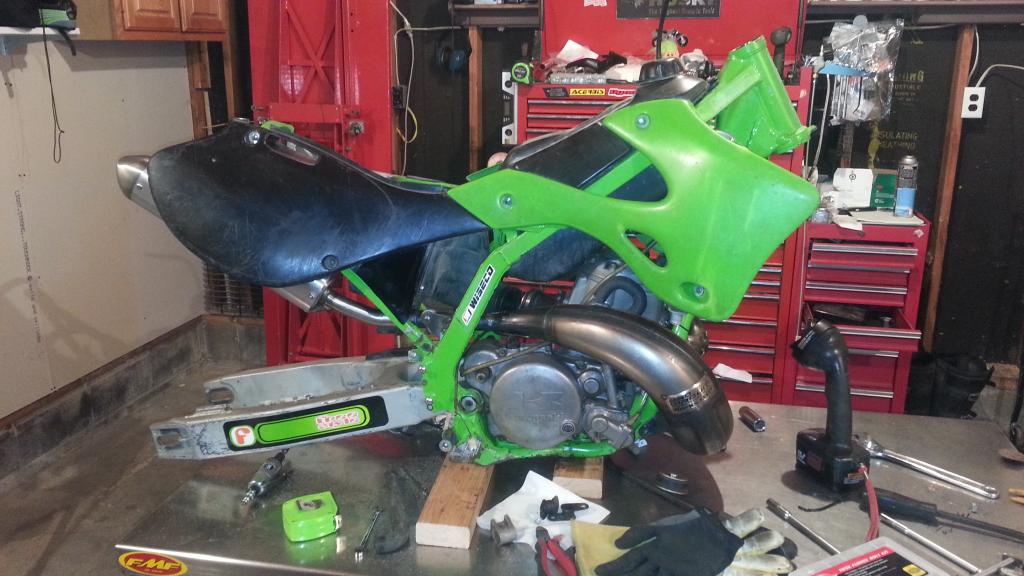

Here is a pick of the over all motor in the chassis so you can get an idea of how it is setting. It is bolted through the swing arm and the lower mount lined right up. It has a bolt through it and the front mount has been cut off and tack welded in the current location to work with the rest of them. Thanks for looking.

motopunk
the j-fab headstay kit is a cool thing... but you have to make your own brackets. the kx250 headstay-brackets could not used or modified to the kx500 engine. the k5 engine sits closer to the mounts in the frame.
which radiators do you want to use? the stock 250-rads would work with only cutting the tube to the right length, that goes to the cylinder on the left side .
you should contact don46 . he had made several of this 99-2002 frame conversions.. maybe he could help you a little bit forward...
kranker1450
Just spoke to JFab. He cleared everything up. Great guy. As i thought and as Motopunk said i need to make my own bracket. No biggie, just thought i was missing something else.
Moto: I am planning on using the 250 rads. They will fit with just the grinding of the pinch weld with a little clearance. Was just curious if anyone wish they would have notched the frame afterwords for more clearance. Figured now is the time instead of later.
Thanks
motopunk
how was the fitting before with the 250 engine? i do not understand the reason for grinding on the frame, because this are the rads, made for this frame..
mounting with washers to get the rads a little bit away from the frame is in my eyes a better option. 2. option : cut off the rad mounts and lift the rads up u little bit , but watch out, that the fork legs couldn´t touch them by full turn of the handlebar.
i have an 86 k5 engine in a 93 250 frame with k5 rads..because the bike is completely assembled from used ebay-parts and new spareparts. so i could do it without any modifying to the 90-93 paralell cooling system. the k5-rads did also fit perfectly to the 93 kx250 frame. all i had to do was made little brackets to get them a little bit forward on the upper side to find the clearance for the big crosstube between tank and frame.
kranker1450
moto: With the k5 motor the gap between the cylinder is greatly reduced. If the weld is not ground down I am afraid that the hose would chaff and eventually wear a hole in it. I will be moving the lower rad mount forward slightly to gain some clearance for the hose to cylinder which will push it into the weld on the front. This is why I need to remove the seem. Hope that makes sense. With the 250 motor in it there is plenty of room between the head and the frame for the hose to have ample clearance.
Thanks Tom
motopunk
ok.. now i see what your thinking is ... some times its hard only imagine some things without seeing the parts directly...

don46
I smoothed the area for the hose and put another piece of rubber in fact I think it was a heavy duty heat shrink in the area that rubbed to pervent wear. I too like the "works" pipe look. always used those on our race bikes as well, wd-40 after every wash and if they looke a little ratty a little naval jelly and back to the works look. I really liked the 99-02 conversion it was by far the easiest to do and the frames are plentiful. I think the only difficult part was the tank, warming and reshaping to clear everything. looks good
