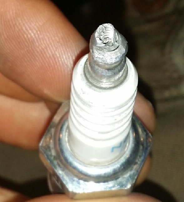

Member:
ok I rode today the bike was performing greatly did they plug chop at the end of my ride just to get an idea how it was running the plug was a medium to light brown not tan when I got home I pulled the plug and that is that the top of the plug where the wire connects was smashed deformed if you will have never seen anything like it any ideas I'm running a 165 main jet like you guys recommended at sea level with a rad valve and gnarly series fmf with a pro circuit 304 93 pump gas mixed 40 to 1 pilot jet is a 52 stock needle on the third position what smashed the little piece on the top of my plug and do I need to lean it out just a little to get a tan. Plug plz help me out thanks

My response:
Plug color?.... Whoa!!!!! I wouldn't go any leaner....
Smashed end? looks like it was done before it was put on the bike.
How does the plug wire cap attach to the spark plug, is it loose or tight?
