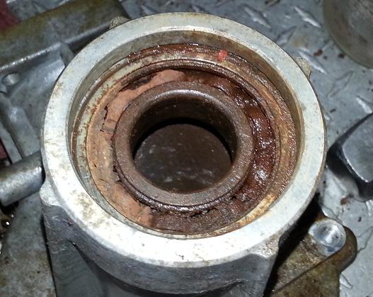

Here is a perfect example...
A guy sold me a 07 Polaris Phoenix 200 quad because it had a bad noise in the rear end.
He said he thought it was the rear brake but it sounded like a much bigger problem to me so I bought it cheap.
When you tried to turn the rear axle it would squeak like crazy.
Here was the problem.
grease your stinkin bearings 2.JPG (43.15 KiB) Viewed 7248 times
grease your stinkin bearings 3.JPG (46.24 KiB) Viewed 7248 times

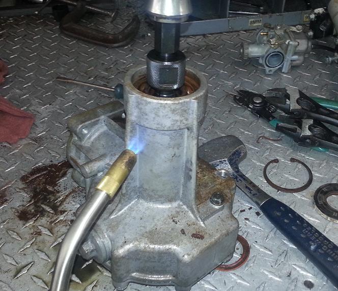

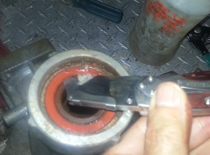

And believe me when I say that this bearing did not want to come out.
grease your stinkin bearings 4.JPG (86.14 KiB) Viewed 7248 times
grease your stinkin bearings 5.JPG (77.33 KiB) Viewed 7248 times
After the heat was applied it came out with some difficulty but, it came out.

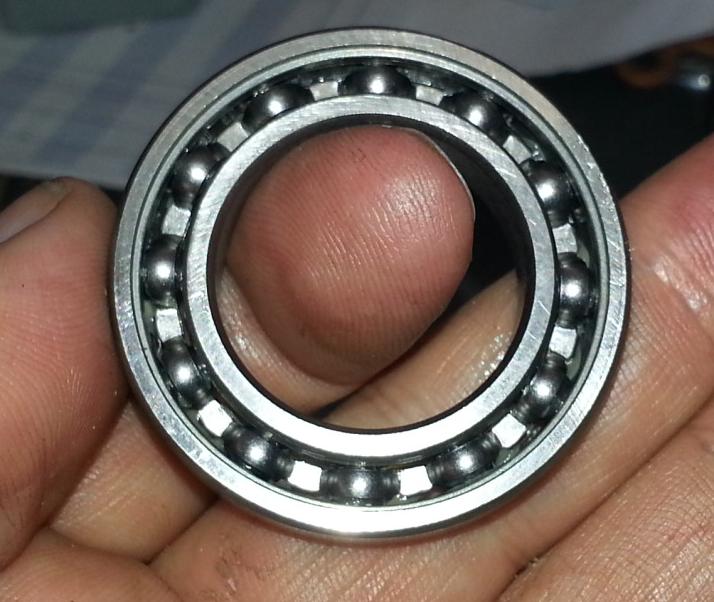

So, I took a little trip to our local bearing house and picked up a replacement bearing for $10.
First things first, I opened it and confirmed that it had grease in it.
The bearing house told me that it should be at 1/3 total capacity.
Check!

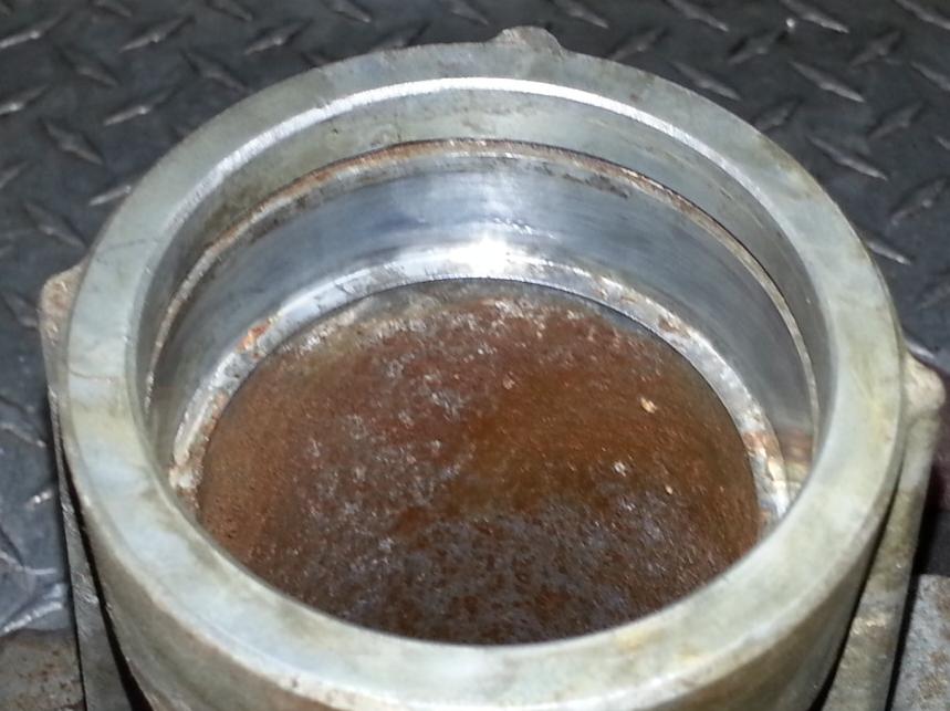

Clean the bearing mating surface.
grease your stinkin bearings 5-1.JPG (64.56 KiB) Viewed 7247 times
Check!

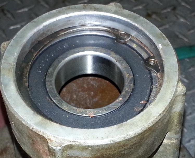

Install bearing.
grease your stinkin bearings 5-3.JPG (63.35 KiB) Viewed 7247 times
