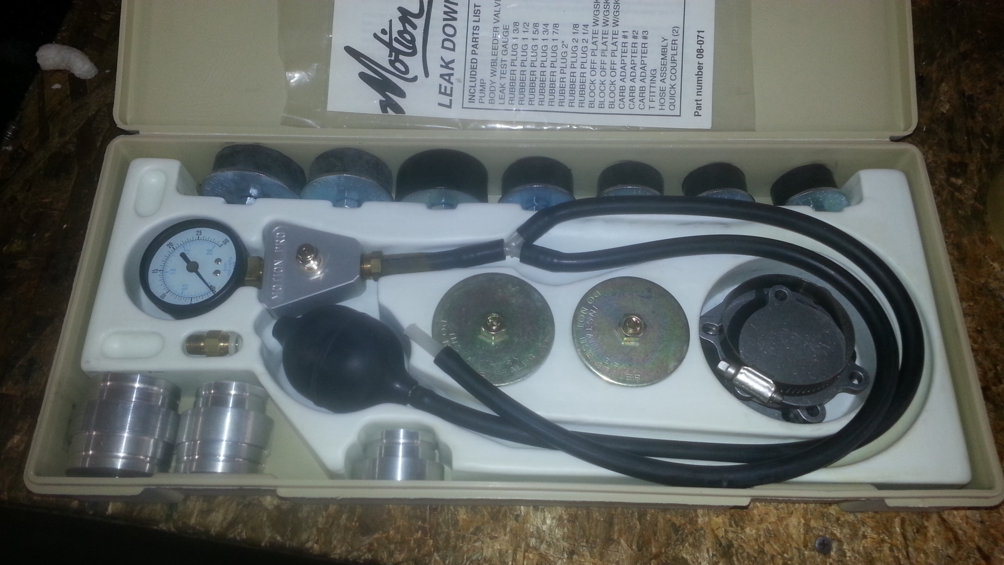

Motion Pro Leak Down Tester 08-0071
Posted: Tue Jul 15, 2014 1:55 am
After having a home made job I decided to get something a little more universal.
More to come

Re: Motion Pro Leak Down Tester 08-0071
Posted: Wed Jul 23, 2014 12:01 am
I had one very similar to the one here:
viewtopic.php?f=40&t=516
The problem is, we are now testing many other 2T's besides the K5 and we needed more flexibility.
So the next thing I need to do is test a few engines :D
Post your pics when you can.
