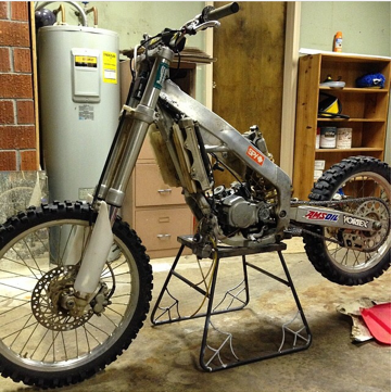

Here is what he started with.

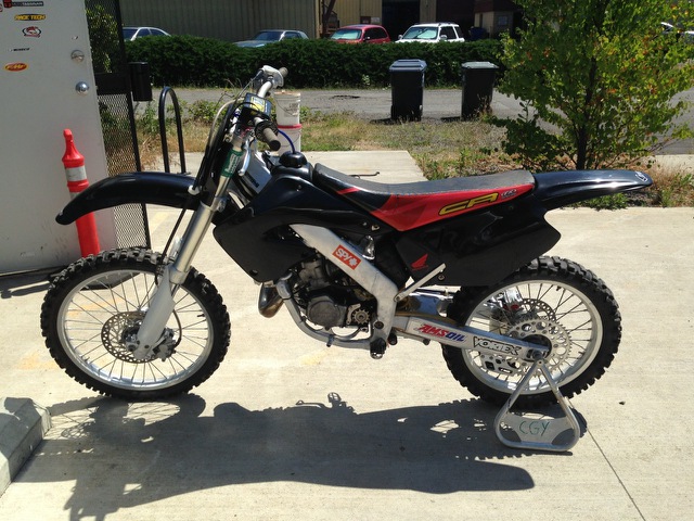

Here is what Rameen ended up with..
