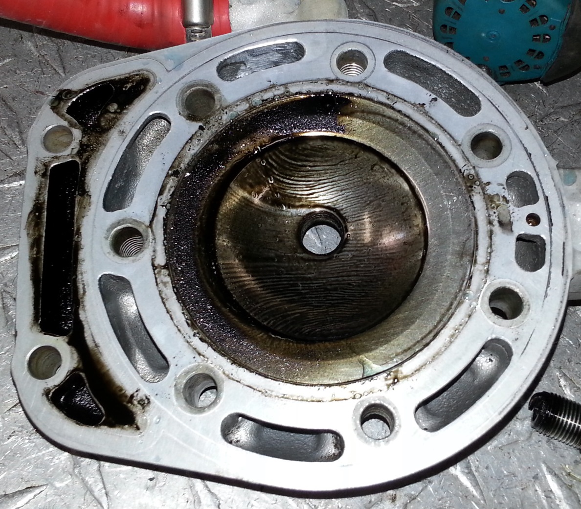

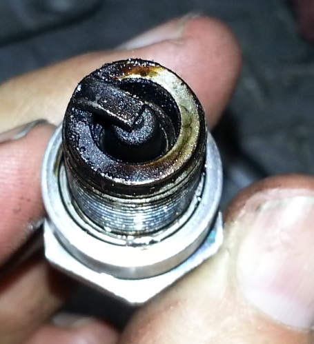

One of the things I was going to have done before I left is have the squish changed.
The head was re-cut once before but Motorrad has some mods that I wanted to try.
So, I pulled the head off to send it away.
This is what I found..
Obviously it has some issues but I expected much worse :shock:
A quick wipe with a rag made the head look much better
So... the quest goes on...
