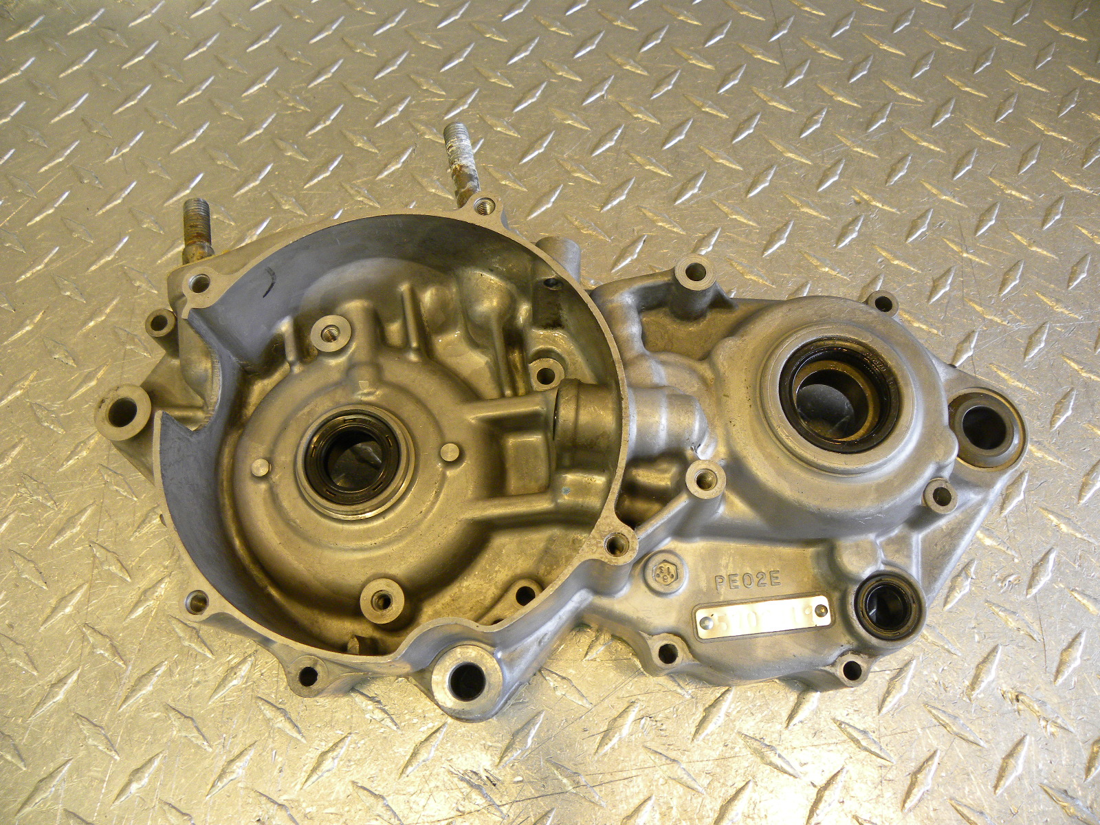

CR500 Engine tag plate where is the tag plate?

Look on your left engine case toward the back.
Then compare the first two numbers on the tag with this chart
1981 CR450 PE02E-500XXXX
1982 CR480 PE02E 5100000
1983 CR480 PE02E-5200000
1984 CR500 PE02E-530XXXX
1985 CR500 PE02E-540XXXX
1986 CR500 PE02E-550XXXX
1987 CR500 PE02E-550XXXX
1988 CR500 PE020E-570XXXX
1989 CR500 PE02E-580XXXX
1990 CR500 PE02E-590XXXX
1991 CR500 PE02E-5000000
1992 CR500 PE02E-5100000
1993 CR500 PE02E-5200000
1994 CR500 PE02E-5300000
1995 CR500 PE02E-5400000
1996 CR500 PE02E-5500000
1997 CR500 PE02E-5600000
1998 CR500 PE02E-5700000
1999 CR500 PE02E-6000000
2000 CR500 PE02E-6100000
2001 CR500 PE02E-6200000
