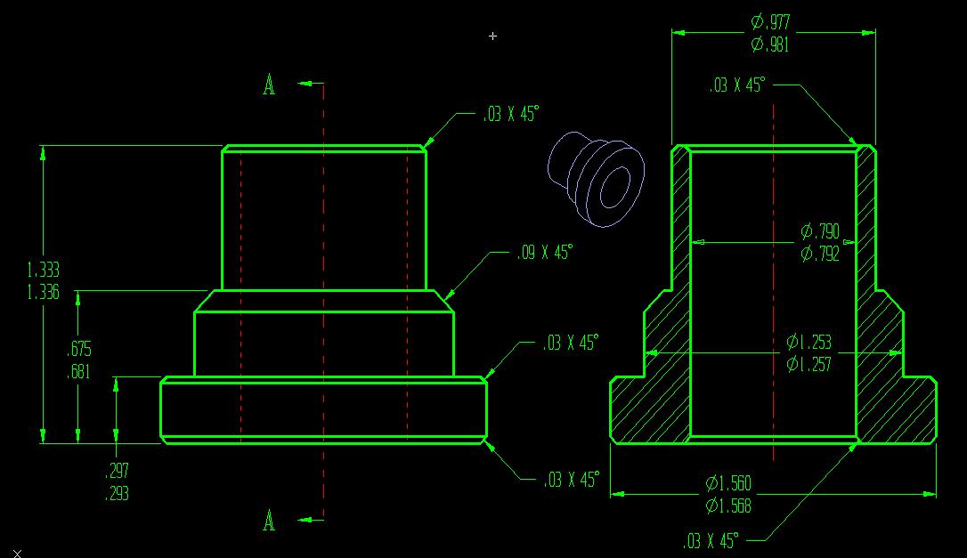

HOW TO CONVERT A KX450F TO KX500 REAR WHEEL.
Just make yourself two of these and your good to go :D
EXCEPT...... You will need to remove 20mm off the diameter of your rotor to make it work :shock:
