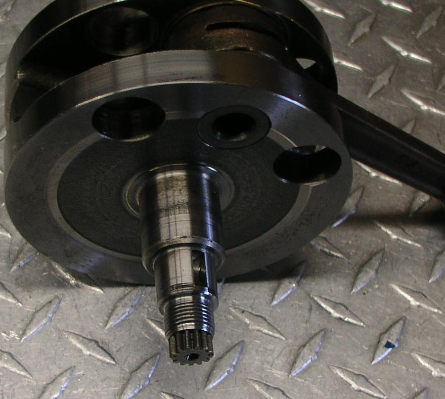

Here is a pic of the 85-86 kx500 clutch side of crank.
1986 KX500 CRANK SHAFT.JPG (122.51 KiB) Viewed 25008 times
Here is a pic of the 1987 KX500 crank.
1987 KX500 CRANK SHAFT.JPG (81.79 KiB) Viewed 25008 times
Here is a pic of the 1988 KX500 crank.
1988 KX500 CRANK SHAFT.JPG (75.94 KiB) Viewed 25008 times
Re: KX500 Service Specifications page
Posted: Tue Mar 11, 2014 6:56 pm
The pic below looks just like a 89-04 KX500 crank.
This pic is of a 1992-2004 KX500 crank.
Trying to determine the difference between the 89-91 and the 92-04.
I have heard that the 89-91 kx500 crank shaft is lighter then the 92-04.
But, that will require some verification.
92-04 KX500 CRANK SHAFT.JPG (58.79 KiB) Viewed 25007 times
Posted: Tue Mar 11, 2014 8:09 pm
From what I can see, 85-87 kx500 crank shafts look identical.
From what I can see, 88 is the only kx500 crank shaft where it uses the snap ring on the primary crank gear but has the holes in the crank halves..
From what I can see, 89-04 crank shafts look identical.
So my best prognostication is that 85-04 can all be swapped as long as you have the correct primary crank gear asy to match the crank you are using.
