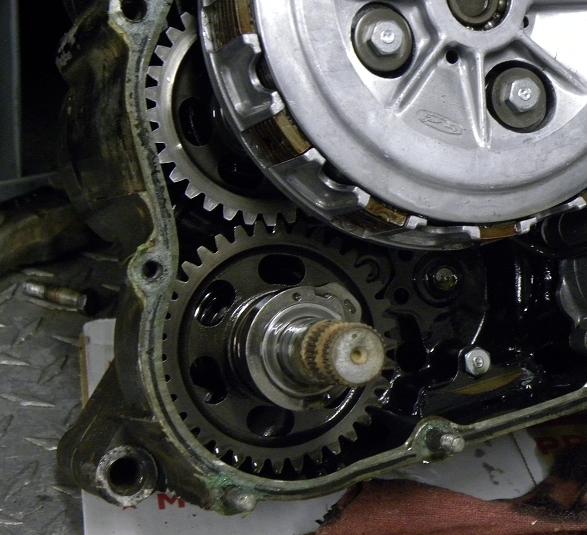

First remove your kick lever and clutch cover.
XR KICK LEVER SHAFT REMOVAL 1.JPG (50.79 KiB) Viewed 6944 times

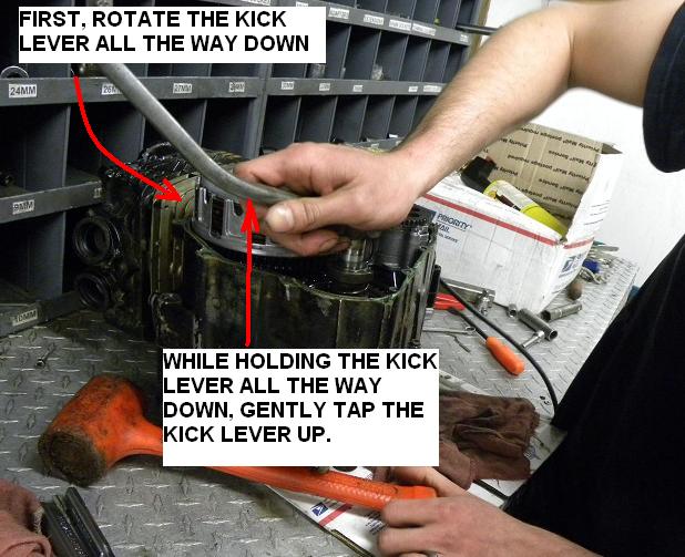

Then, bolt your kick lever back on.
XR KICK LEVER SHAFT REMOVAL 2.JPG (48.45 KiB) Viewed 6944 times

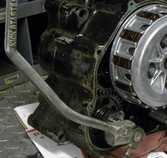

Lay the engine on it's side..
XR KICK LEVER SHAFT REMOVAL 3.JPG (26.52 KiB) Viewed 6944 times

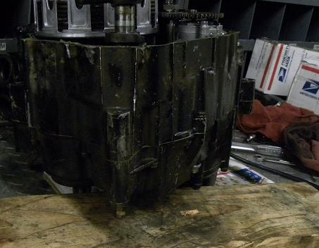

Now, pull the lever all the way down... and tap upward on the bottom of the kick lever.
You don't have to tap very hard.
XR KICK LEVER SHAFT REMOVAL 4.JPG (64.91 KiB) Viewed 6943 times

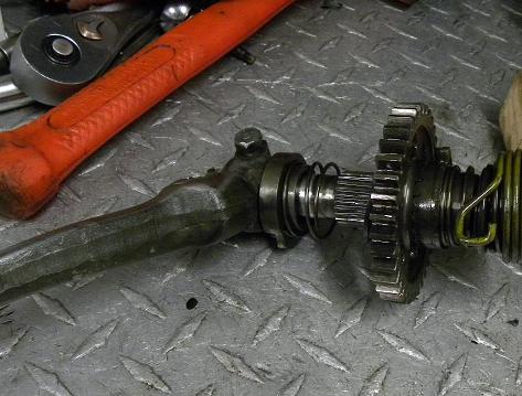

The kick lever shaft will pop out but you will have to move it around a bit to get it out.
XR KICK LEVER SHAFT REMOVAL 5.JPG (34.89 KiB) Viewed 6943 times
