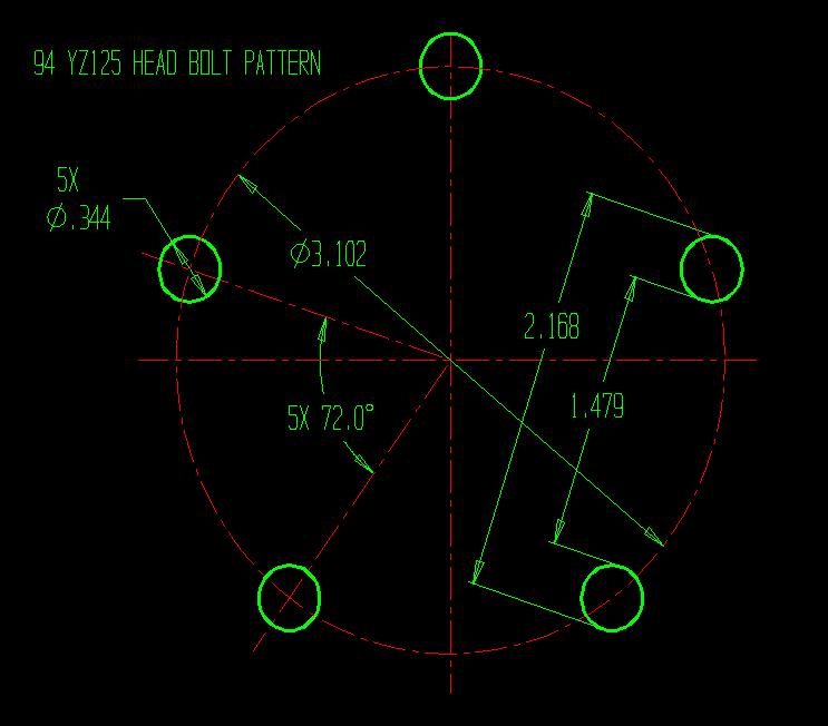

94 YZ125 HEAD BOLT PATTERN MEASUREMENTS PICS
4JY FITS 94-95 YZ125 - 11111-00-00
