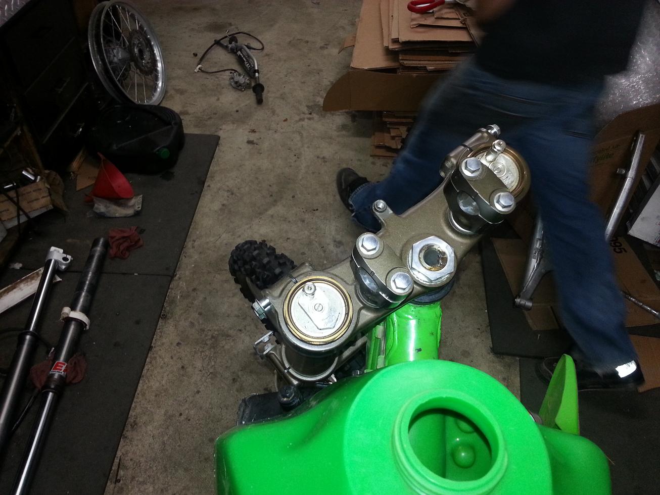

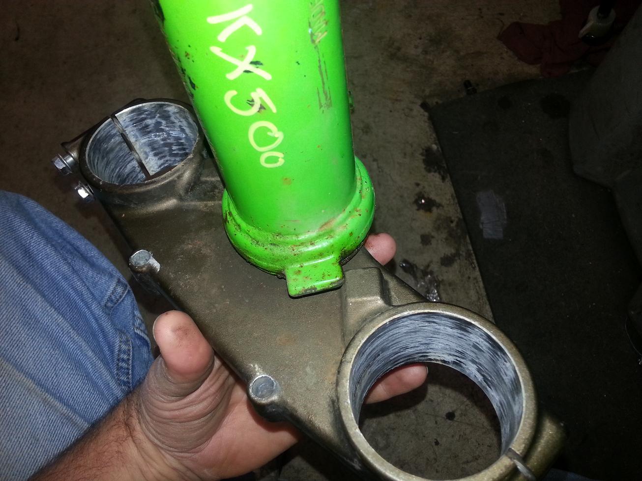

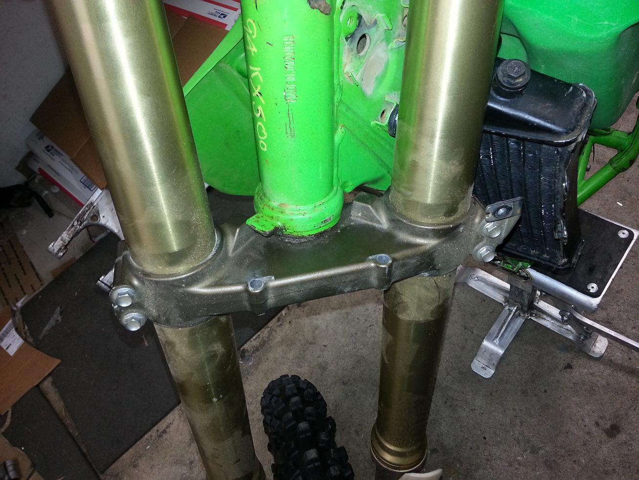

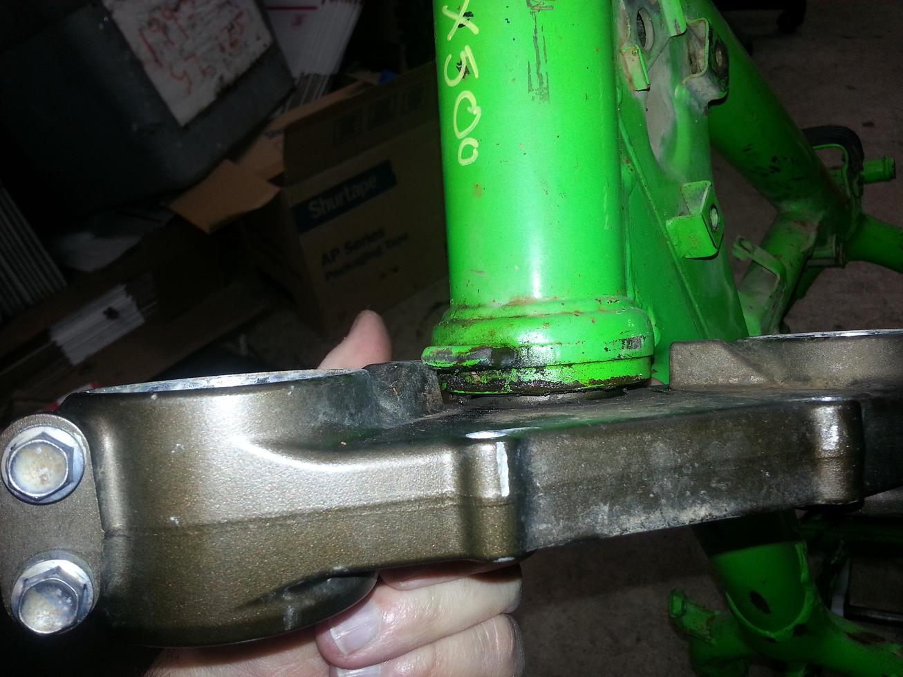

First off, will the triple clamps bolt right up?
Nope...
Let's take a look at why not..

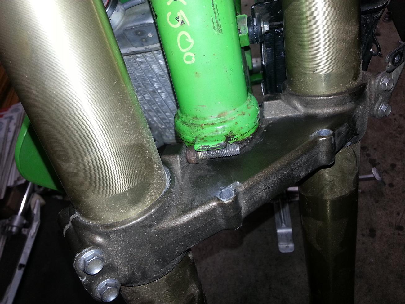

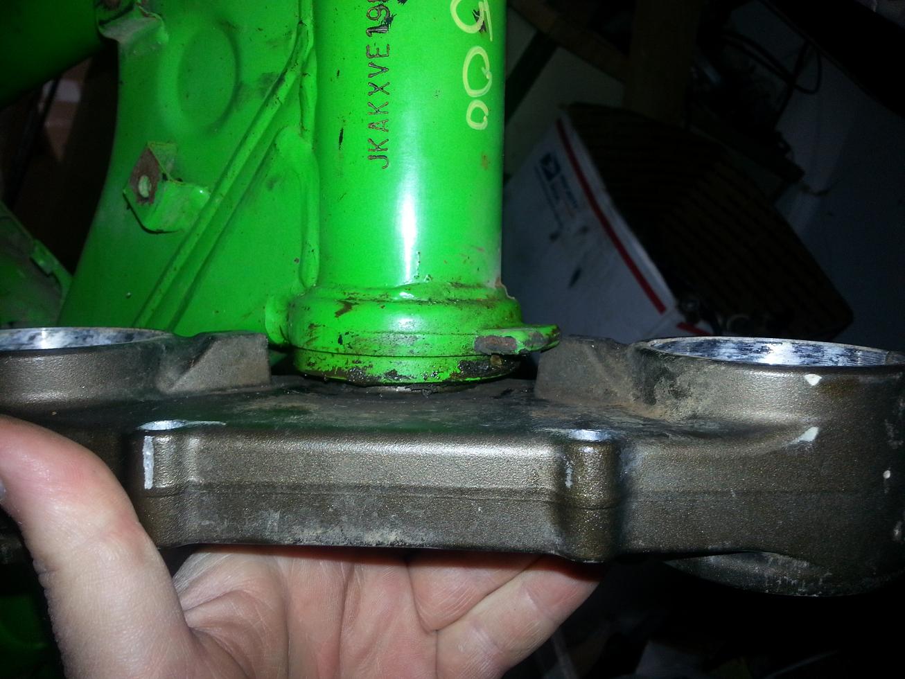

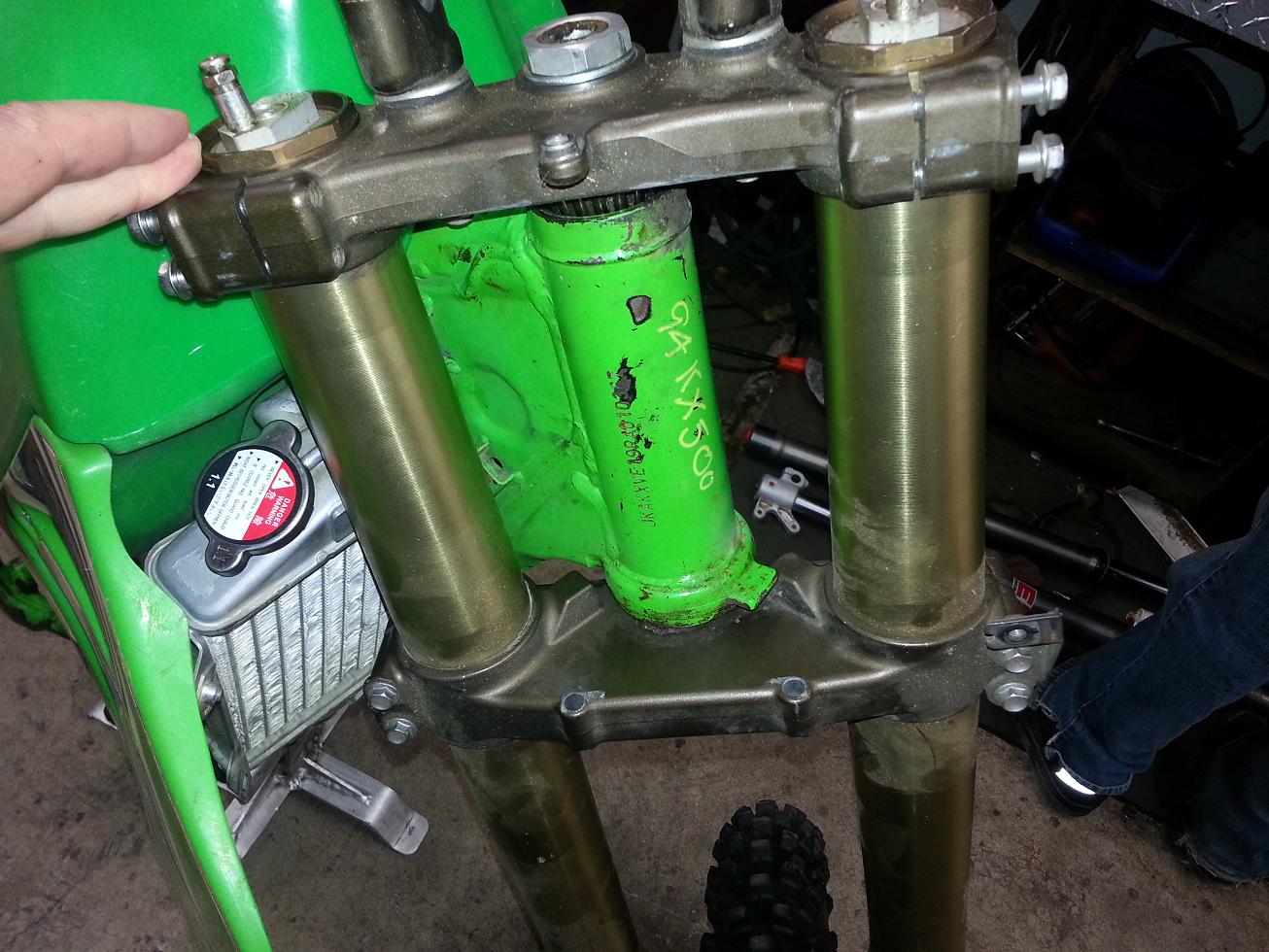

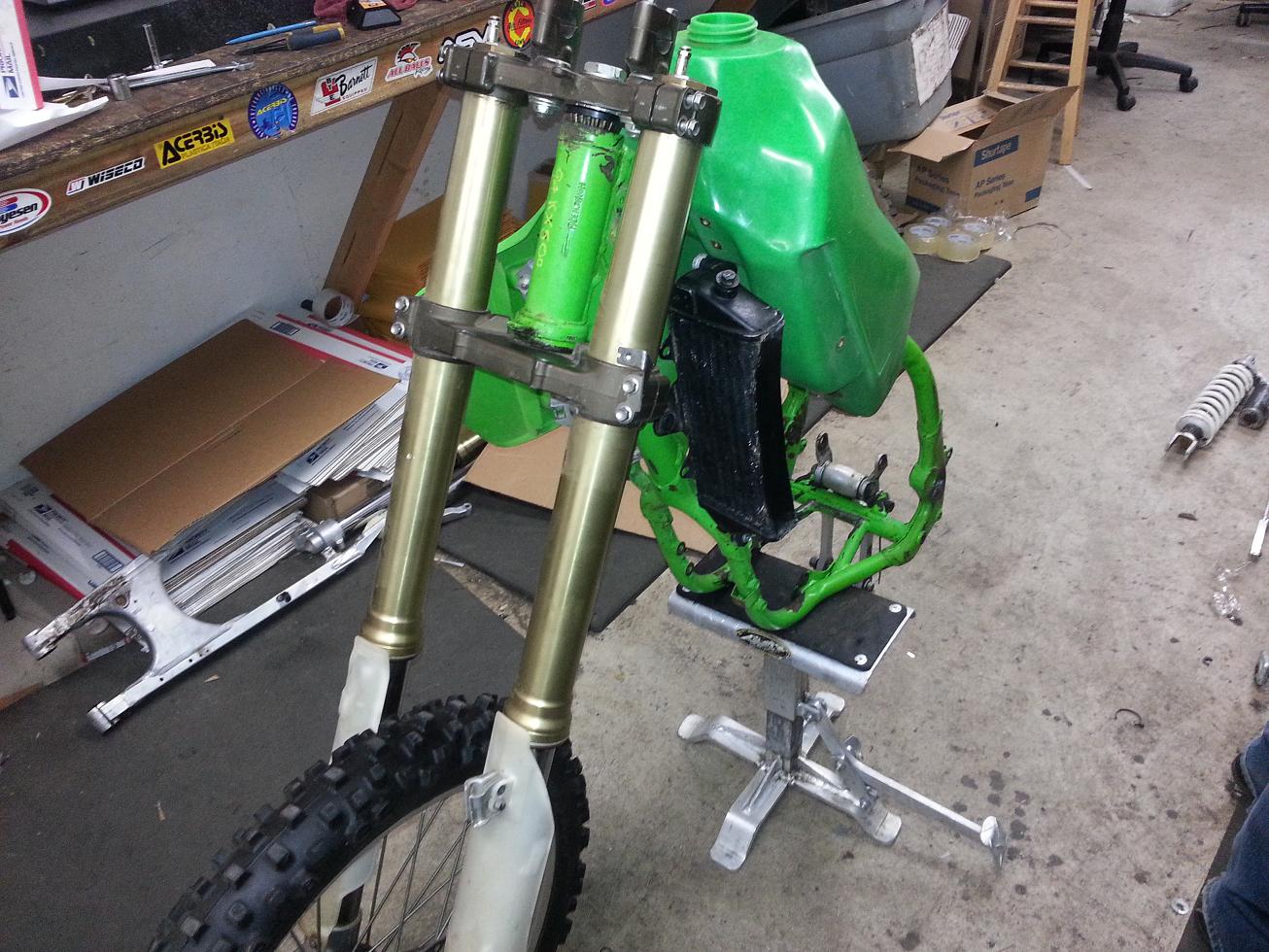

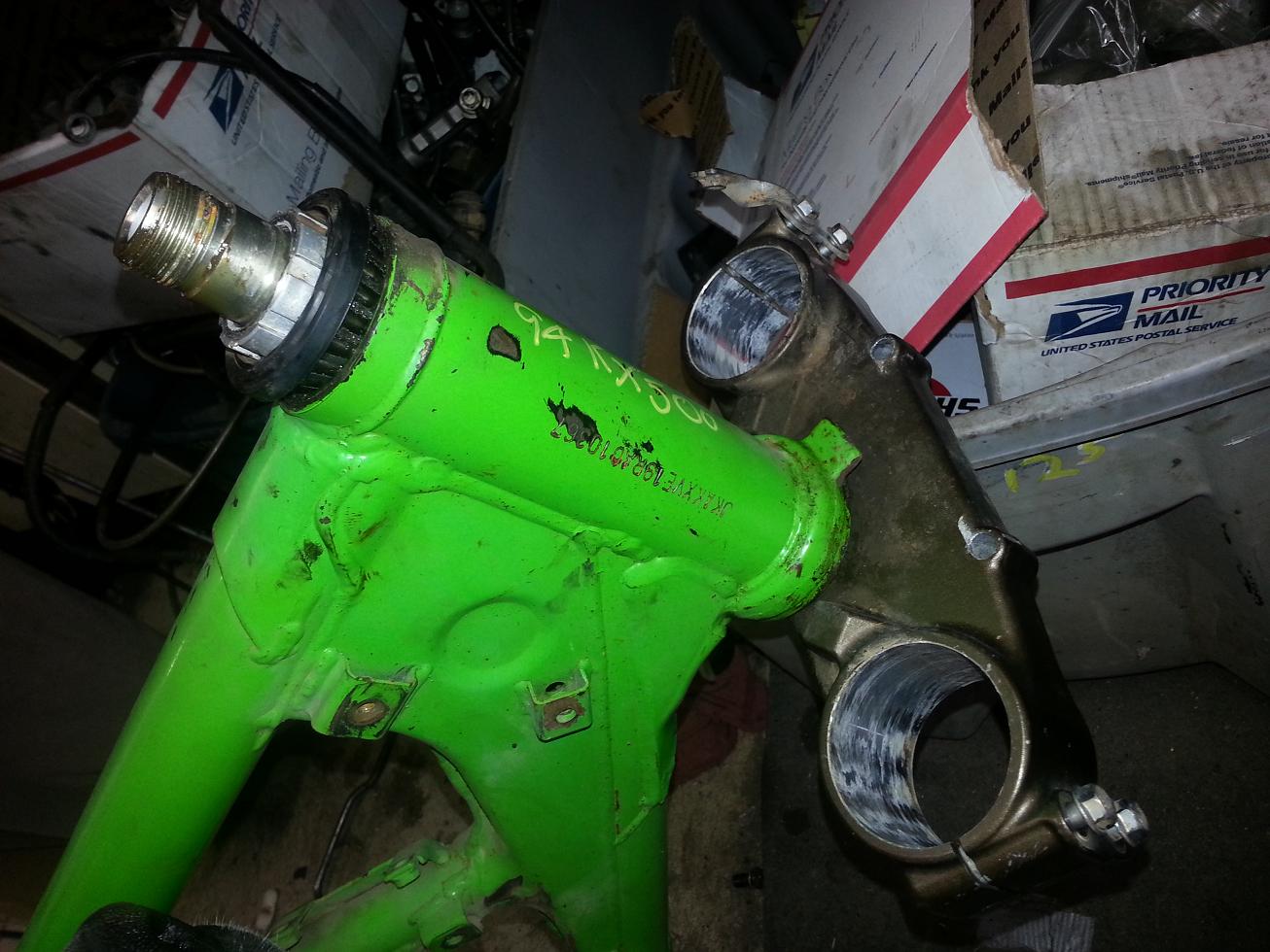

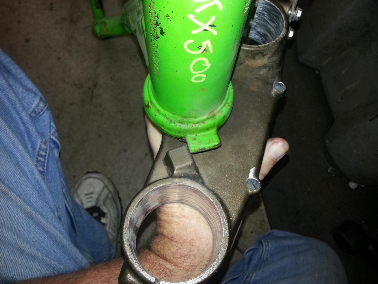

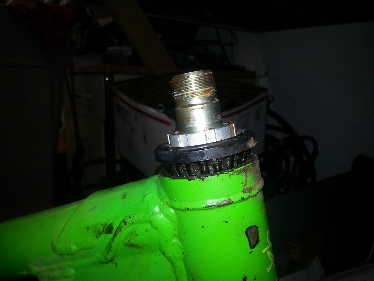

What I am using for this demonstration is a 94 KX500 frame and a 07 KX250F triple clamp.
KX500 FRAME WITH A 07 KX250F TRIPLE CLAMP 1.JPG (158.97 KiB) Viewed 73476 times
KX500 FRAME WITH A 07 KX250F TRIPLE CLAMP 2.JPG (159.26 KiB) Viewed 73476 times
KX500 FRAME WITH A 07 KX250F TRIPLE CLAMP 3.JPG (161.05 KiB) Viewed 73476 times
KX500 FRAME WITH A 07 KX250F TRIPLE CLAMP 4.JPG (140.42 KiB) Viewed 73476 times
KX500 FRAME WITH A 07 KX250F TRIPLE CLAMP 5.JPG (166.78 KiB) Viewed 73475 times
KX500 FRAME WITH A 07 KX250F TRIPLE CLAMP 6.JPG (94.23 KiB) Viewed 73475 times

The first thing I found when I began researching this swap is that the KX500 and 07 KX250F share the same lower steering head bearing.
This allows the 250F triples to slide into the KX500 frame, and everything is taken care of as far as the LOWER bearing goes.

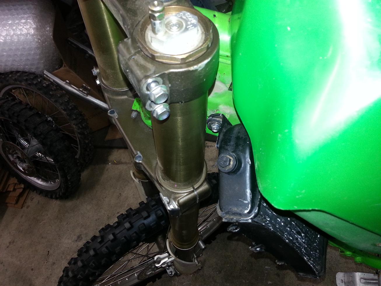

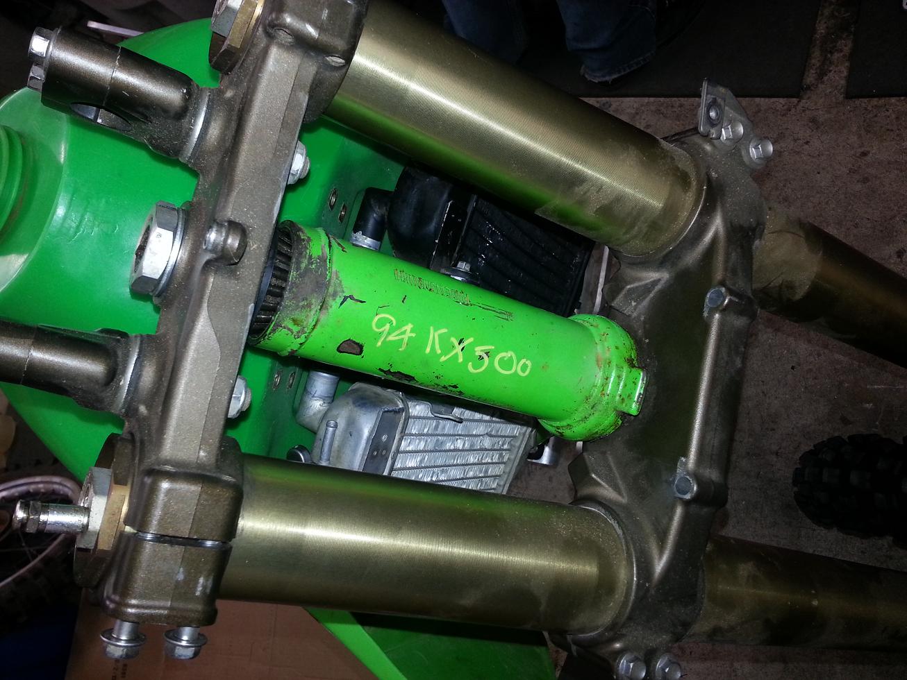

What we have here is a 94 KX500 frame mounted up with a front end from a 07 KX250F.
We already discussed the need for a different steering stem.
Here is the front end mounted up.
KX250F 2007 FORKS ON A 94 KX500 FRAME 1.JPG (218.94 KiB) Viewed 73464 times
KX250F 2007 FORKS ON A 94 KX500 FRAME 2.JPG (181.45 KiB) Viewed 73464 times

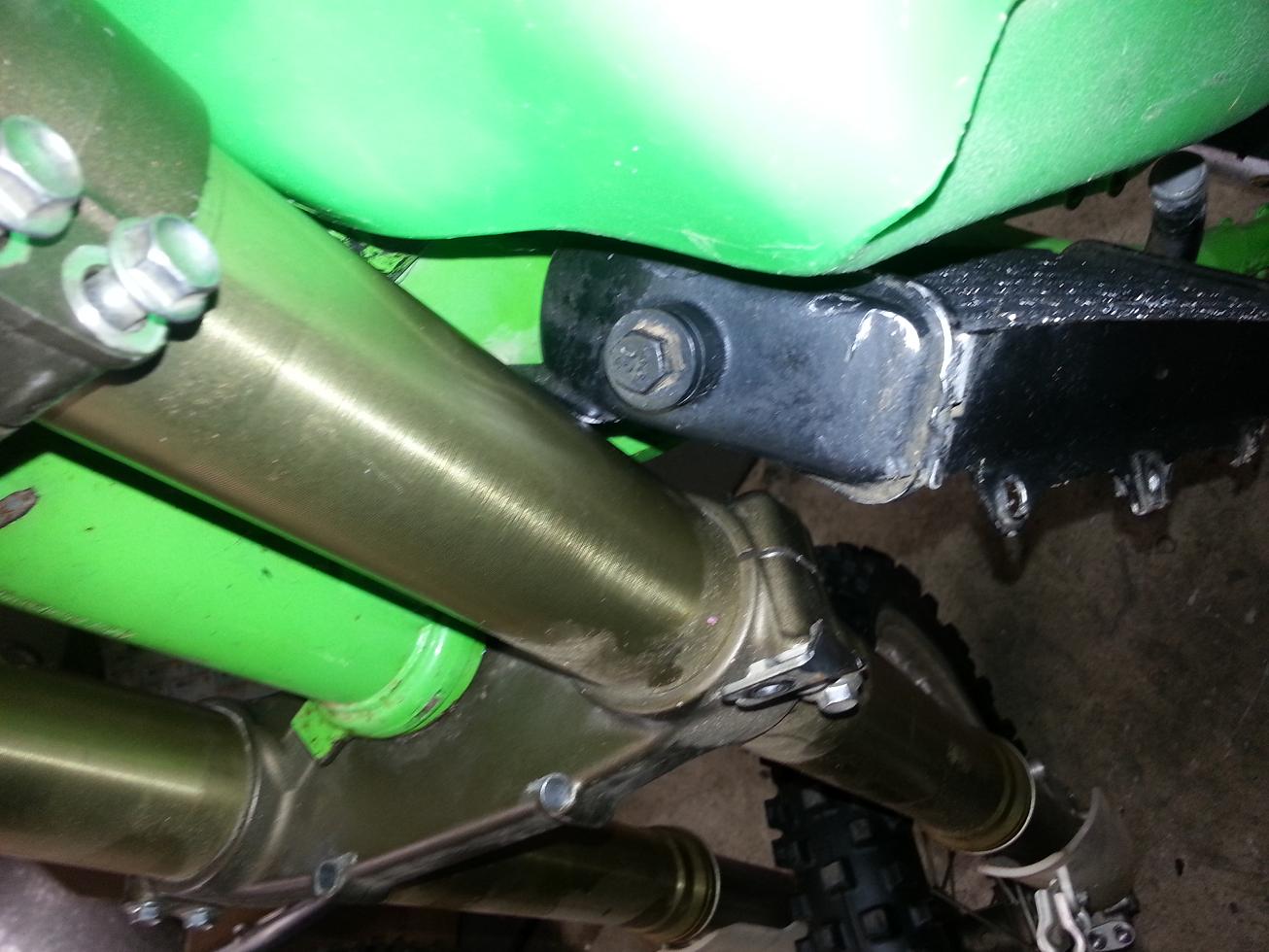

The next pics show the front end turned all the way to the right.
As you can see, the forks touch the gas tank and just barely miss the right radiator... Not good....
KX250F 2007 FORKS ON A 94 KX500 FRAME 3.JPG (193.94 KiB) Viewed 73464 times
KX250F 2007 FORKS ON A 94 KX500 FRAME 4.JPG (110.56 KiB) Viewed 73464 times
KX250F 2007 FORKS ON A 94 KX500 FRAME 5.JPG (147.18 KiB) Viewed 73464 times
The next pic shows the front end turned all the way to the left.
KX250F 2007 FORKS ON A 94 KX500 FRAME 6.JPG (190.51 KiB) Viewed 73464 times
As you can see the forks hit the gas tank and the radiator.
KX250F 2007 FORKS ON A 94 KX500 FRAME 7.JPG (136.83 KiB) Viewed 73464 times
Bummer right???
Not really.
It will take very little to fix this problem.
Something as simple a bolt welded to the bottom of the steel stop on the frame will easily fix this issue.
KX250F 2007 FORKS ON A 94 KX500 FRAME 8.JPG (193.4 KiB) Viewed 73464 times
With the bolt sitting there and the forks turned all the way to the left you can see that there is plenty of room...
KX250F 2007 FORKS ON A 94 KX500 FRAME 9.JPG (116.39 KiB) Viewed 73464 times
KX250F 2007 FORKS ON A 94 KX500 FRAME 10.JPG (158.37 KiB) Viewed 73464 times
KX250F 2007 FORKS ON A 94 KX500 FRAME 11.JPG (160.24 KiB) Viewed 73464 times
Not shown in the pics is the steering turned all the way to the right, there is also plenty of room.
In fact, there is room for a narrower bolt head, block of steel, or if you wanted to get really fancy you could use a block that is tapped all the way through and you could install a bolt in either end that you could adjust exactly at what point the stops worked.
