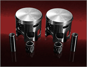

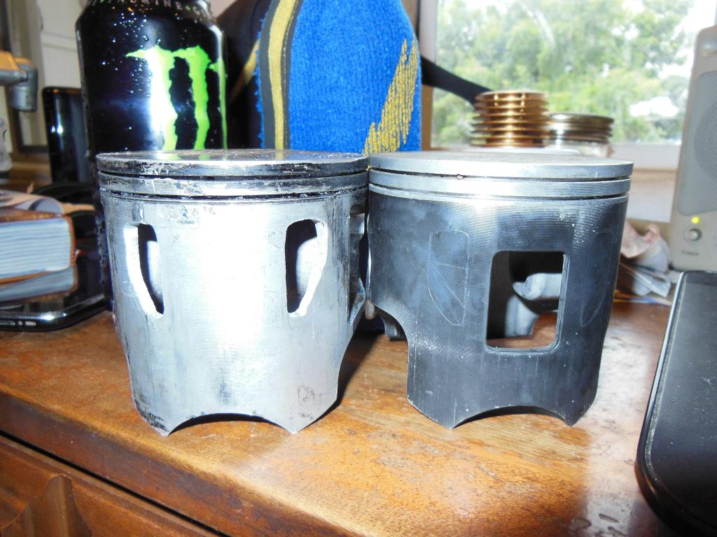

Here is the rest of the info..
For years the common belief of big bore KX riders was to window your piston.
According to all the information I could find it adds 2 hp and keeps your engine cooler.
So over at KXRiders several members are discussing the viability of it as well as modifications to the existing design.

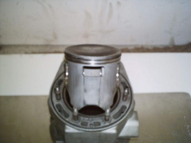

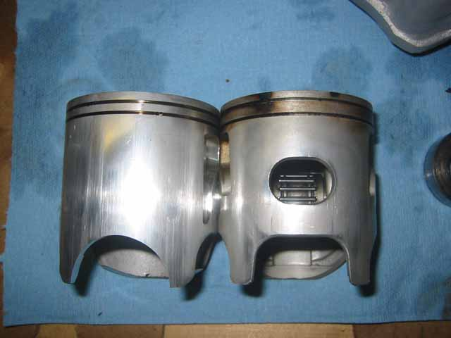

What is a windowed piston?
Simply, a piston with a hole in the side.
Obviously the size and placement of the window will have a real impact on performance.
The post below are directly taken from KXriders. I didn't include all comments as there was some a little off track:

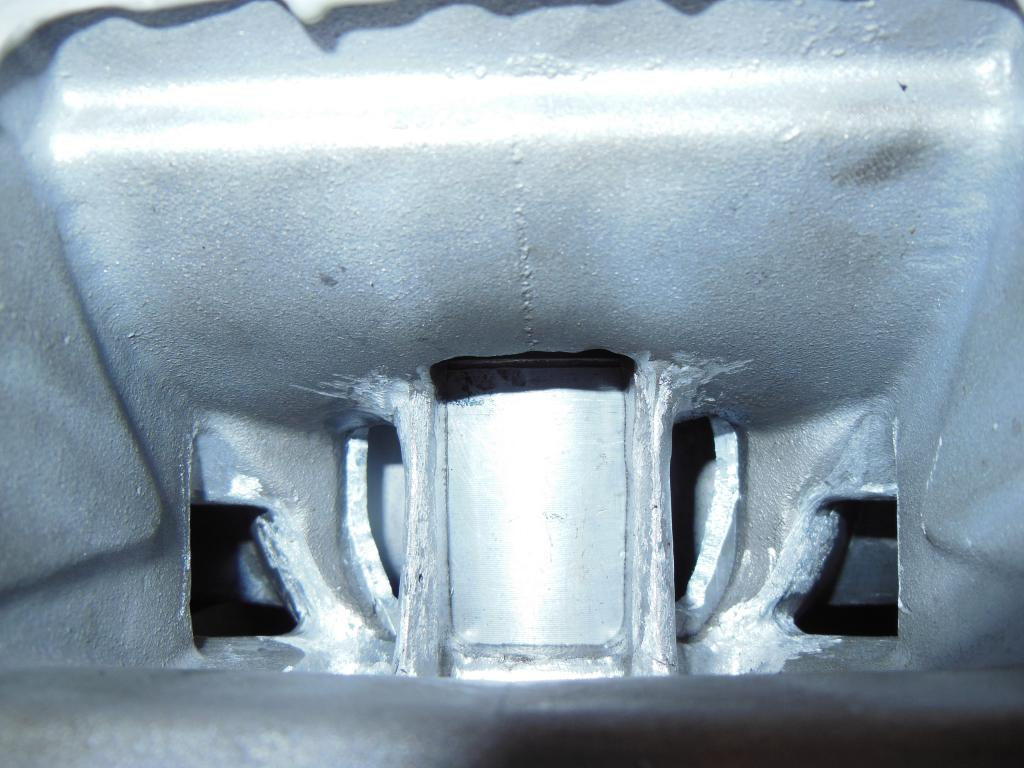

I guess my theory is... why would one add a piston port right in the middle of a Rear boost port... causing the intake charge to go to the crank case, instead of a direct path to where it needs to go....
I hope people jump in on this discussion. Im not a one man band here.

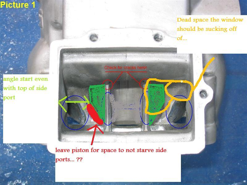

Here is a VERY VERY crude drawing of what Im talking about... live with it.
motorrad 1.png (742.86 KiB) Viewed 47590 times

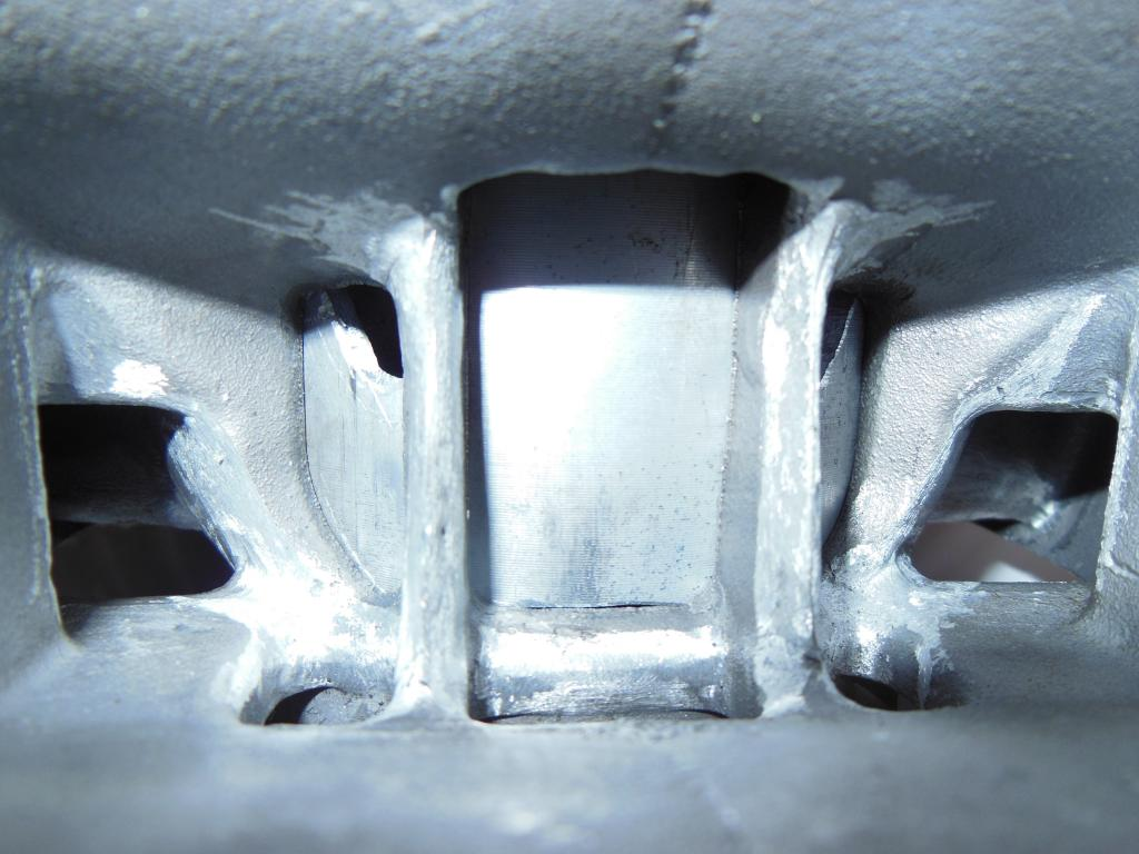

Motorrad:
my theory on how air will travel. (look at arrows in middle section.. and imagine if there was a big hole cut in the piston... how that would starve the rear boost port (which is at the top of the middle section), and the floor ports... making the air travel MUCH further than it has to to get to the comb chamber)
motorrad 3.png (848.62 KiB) Viewed 47589 times

Motorrad:
and my theory.. bring as much as possible flow to the engine for as much as possible performance, that is needed, but dont cut to much, to be safe that the cylinder dont crack up there... wink
I agree there is an improvement in running a window vs not. But I think we can improve on the current design.
to me , the current one is like slapping a U-turn in the transfer ports, making them go back to the crank case before they can then go to the comb chamber again..... kinda bass akwards

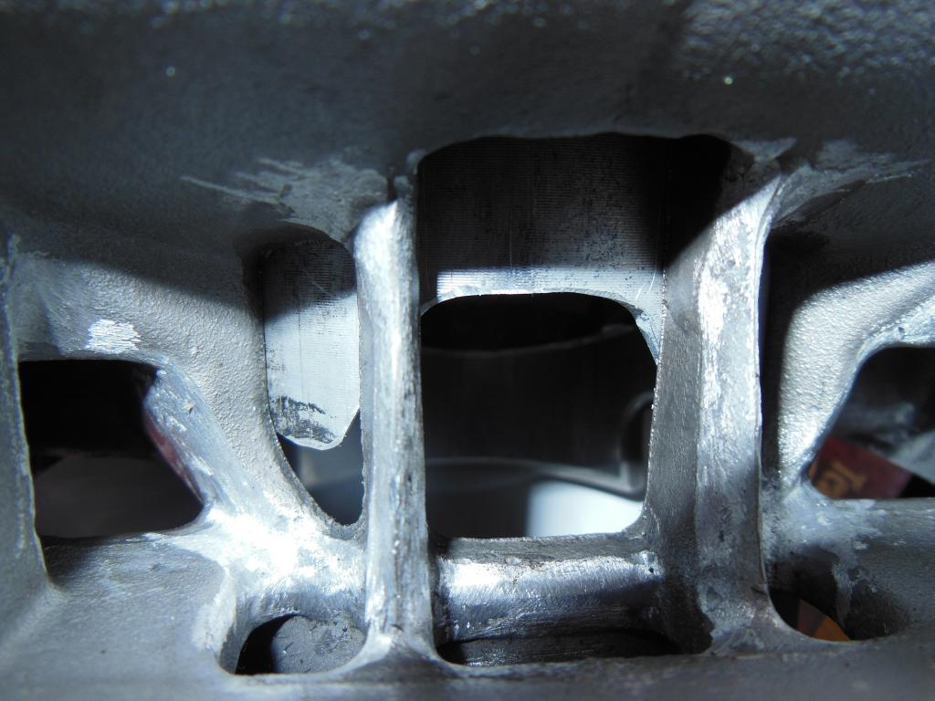

Motorrad:
the windows seem to just Skirt (yes pun intended) the re-inforcing ribs in the piston (wiseco) will have to test the wosssener. so that is a good thing.. that was one thing I was worried about.
motorrad 4.png (1.29 MiB) Viewed 47589 times

Good day folks. I think you are on to something here Motorrad. I too think that the large lower port starves the boost ports, as the boost port pressure differential is higher than the huge gaping hole in the middle of the skirt creating a short circuit. By moving the piston port to the sides like that, the air will be diverted to the sides much better due to the pressure differential in the intake being moved outwards to the side triangle shaped ports, like you have cut. I believe this will in turn direct much more air to the side boost ports while the piston is still covering the main intake port.
cbrfrenzie:
I have a dyno at my work that I have full access to, anytime I need / want. I am already working on a test using two different window porting options to see what the relative results are. Perhaps I can help you guys out with some distinct numbers on these mods and the result (torque curve is what we are really interested in here). I will be plumbing in a couple pressure sensors so I can see the resulting waveforms with respect to the dyno run, to give me a closer idea of what the air is doing in there. I will be logging exhaust pressure, intake pressure at 2 different points, EGT, RPM and torque.

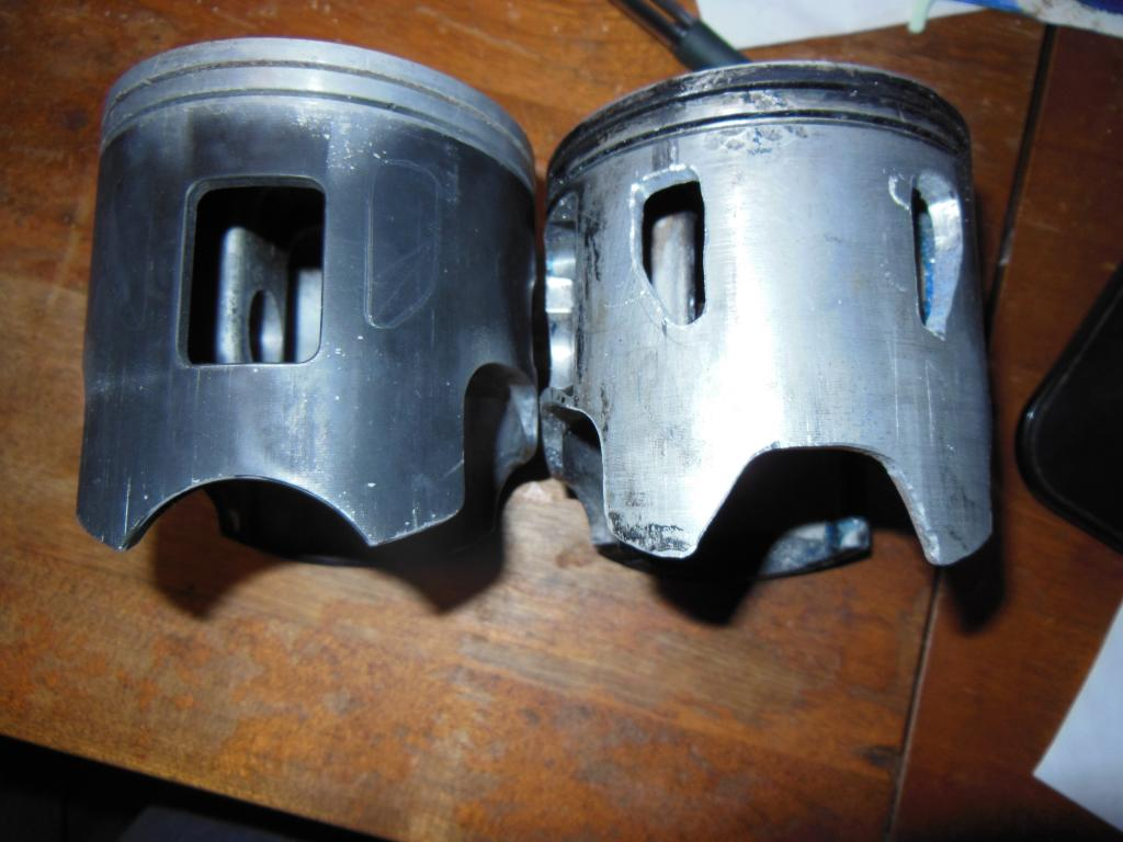

here is what I was thinking from the yz250 pistons.
this bottom cut CLOSES just as the transfers open...... which should keep it from starving the lower floor port and the boosters...
(last 2 pictures taken right as transfers open)

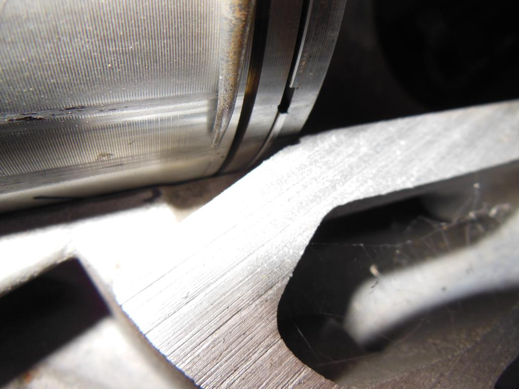

Interesting idea there with the lower piston skirt shaping there in the last 2 pictures. I think we want to be careful with that area, as to not decrease the pumping effect of the piston moving down. If there is an opening there when the pressure under the piston is greater than the intake, air will flow in reverse into the reed chamber. Your pictures are very informative, I like how the angle you cut into the piston is different than than the angle of the boost port. This gives a nice transition into the piston boost port, which will reduce negative turbulence as the piston moves upward sucking air into the case. That angle and depth may be good parameters to experiment with. Keep it up, I'm liking your ideas!
Motorrad:
I 100% agree we need to be carefull in that area... I think as long as it closes the bottom before the transfers open up... we should be fine... Huh huh
heck.. would be better than that low window in the "S" pistons. that would be a problem just as you described.

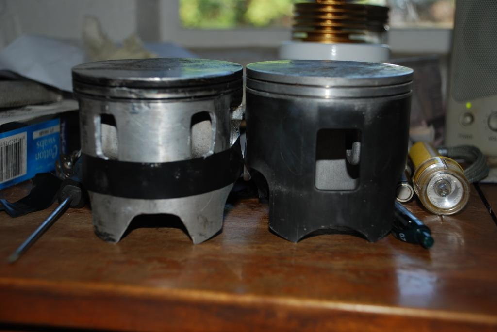

How much closing is enough huh
Motorrad:
For refferance.... here is a "S" piston in exactly the same location as the last to pictures above. (exactly when the transfers open) you can imagine how that would starve the rear boost port....... and as far as lower skirt cutting.. the one I showed cut, that closes as the transfers open.. has to have better pumping action than the "S" piston, that is WIDE OPEN .... YES NO? Im just going off my thoughts here... What ya think CB?

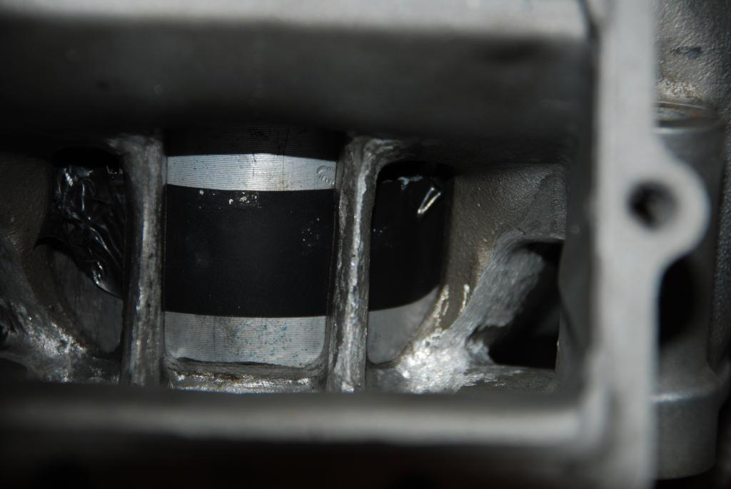

okay,. keep in mind this is on stock hight jug. and dont judge the CRUDE work. just playing and testing at this point, and the dremel and fast cuts is the easyest way to do that right now. once figured out, angles etc will all be cut on the mill...
bottom skirt cut closes 2mm before the transfers open..
windows start to open 1.5mm after transfers open..... they arnt fully open untill BDC..
the tape line is to cover where I cut further down the piston to start... decided we dont need to go that far. ??
motorrad 14.png (965.44 KiB) Viewed 47589 times
Here is BDC. note, They window doesnt go all the way to the bottom... in theory, to keep from starving the floor ports, and the booster ports.. (also need that hight, to keep them from opening before the transfers). hard to tell in the picture.. but when FULLY oepen at bdc. the bottom of the window is half way up the side boosters...
motorrad 15.png (724.14 KiB) Viewed 47589 times
here they are just starting to open... 1.5mm AFTER the transfers have opened.
motorrad 16.png (706.18 KiB) Viewed 47589 times

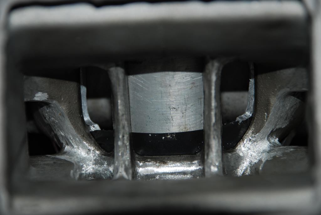

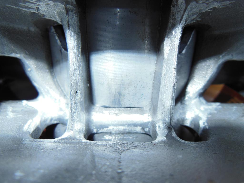

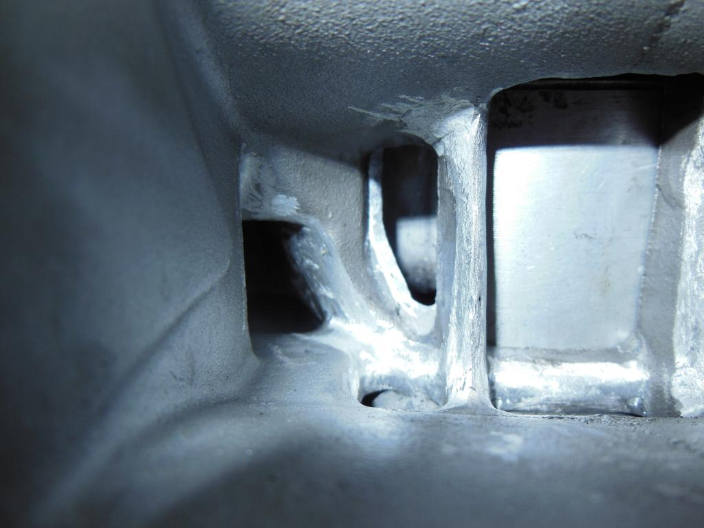

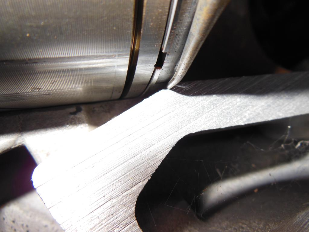

Okay. I wanted to run the top window port as wide as the widest part of the rear boost port.
mocked it up in my Half jug.
and. when the transfers JUST open. the top of that port will already be roughly halfway down the wide portion of the rear boost port.
sooooo.
I can either cut it as a upside down trapezoid, or make it square and the same width as the narrow portion of the rear boost port (same width as the previous "S" pistons)...
The pointed (stainless dental tool) marks where the top of the window port would be, when the ports open.
motorrad 19.png (1.1 MiB) Viewed 47589 times
here is the top of the boost port (dental tool)
motorrad 20.png (1.02 MiB) Viewed 47589 times

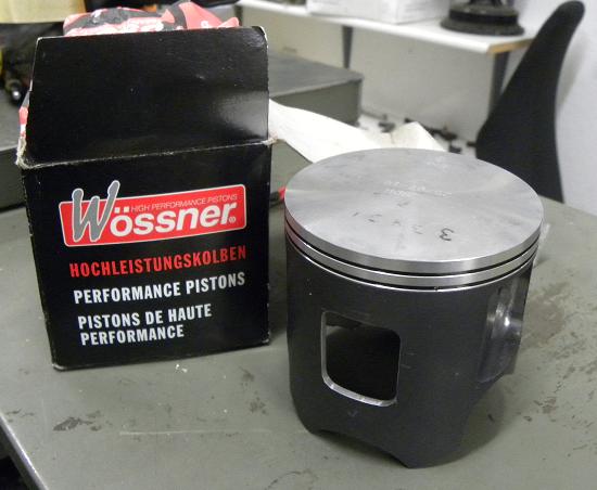

which is roughly here... special note (making my calculations based on WOSSENER piston machining, as there is a big step cut there in the crown... )
motorrad 21.png (1.45 MiB) Viewed 47589 times

I believe that the center "S" design will and DOES effect the floor and rear boost flow.
I believe the HIGH center port idea, will effect the rear boost port, even though it may clear the hiding charge under the piston?Huh
Im thinking. that since the big K5 already has OVERSIZED transfer ports. we need all the squeeeze we can get.
Im now thinking that some Skirt modifications in the transfer port area like I already do is in order.
and some skirt modifications on the intake side. as like the transfer area, the radius's were made and designed for cast pistons to live. but since we are running FORGED pistons. we can get away with more... and thus, modify the bottom profile some.
thinking keeping the greatest ammount of area under (bottom profile) of the intake skirt open as long as we can till just before the transfers open up... is perhapse the way to go here...
so they will close JUST before the transfers open.. so we still have the nearly the same port duration as a window, with only a few degrees of closure, before the aux and boost ports pick it back up. (floor ports still cause it to be full duration open anyways) causing the piston to be a big plunger.... helping to shove the LAZY intake charge through those over sized ports....
thoughts??
warning. I didnt proof read this. just typed it............... rolleyes
keep in mind. I build power for DESERT PEOPLE. not drags, or hill climbs so windows may work better for those "other" types.
Motorrad:
Team green really had a problem of under lubed upper end bearings in the baja 1000.... rolleyes
USMC 500:
If this is figure is correct, I can say this.......its a K5, is 2 HP going to break my heart?.......If so I'm sure that 2 HP can be found somewhere else. It would be nice to have a dyno, KX500, multiple pistons with different cuts, and a Motorrad all in the same place for a few days to put an end to this debate but these conditions are hard to come by.
Motorrad:
And not saying "S" was wrong. or right... so lets assume its a good 2HP
many I have chatted with agreed that if there was to be a window.. to move it up, and make it smaller. myself included.
Im just saying. if the window was good for 2hp. (theory)... was it because of added intake duration (360deg)? venting the trapped gass's? or evil elf magic shocked ??
BUT.
what if another method was better?
Im thinking that with the window. you get a good initial "squeeze" on the charge. when the transfers first open, you get a rush, that is then short circiuted by the window. since it all trys to equilize due to the sort of short circiut the window and rear boost port cause. possibly... in theory remember. causing the second half (1/3 or whatever) portion of the charge to get lazy...
NOW..
with the skirt trimmed.
you still have Nearly the same 360 port duration, since the second the piston closes the intake, the transfers open up, causing the AUX ports and rear boost to take over the "360" effect the window had. then the piston has the chance to COMPRESS the crapola out of the charge, through the entire cycle, as it cant escape from the window into the boost port., causing it to keep the velocity up in the transfers (oversized remember), through the ntire cycle........ the only issue here is trapped gass's, and reverse flow, short circiut from the floor ports..? But the floor ports are fairly small, vs the transfers, so the charge should stick to the transfer route, and actually pull from the floor??
oh wouldnt a flow bench be nice. with colored air... and transparent Jugs.
sandblaster:
And a ultra high speed camera to watch it in really slow motion

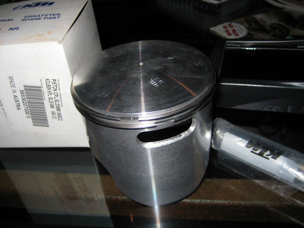

81cr450:
ktm 500 way of doing it, I'd imagine they been to a dyno
motorrad 23.png (433.13 KiB) Viewed 47589 times
Motorrad:
Go check out late model KTM 300
And last of the cr250
Both of which run awesome
Qsixteen
Posts: 30
Re: To Window a KX500 piston or not to window???
Post by Qsixteen »
There was a member over there that tested a piston skirt mod change if I remember right and had good luck with a improvement on power. This was back many years ago.
Yeah I believe it was Stewart that tested and dyno'd it.
It was a bit before I joined there so I may be wrong.... Nah!
I'm not saying he didn't gain 2-3 hp, but judging from his work and business ethics I think there may be some skepticism.
Also, I think the window is to big and in the wrong spot.
But, the only way we will know for sure is to try some different configurations.
Hoping we will get some more ideas....
There is a private dyno in our area but I have not been able to get any time on it yet... :(
Qsixteen
Posts: 30
Post by Qsixteen »
No it was not stewart somebody else and it was not a window mod and I think it was a skirt mod. I know on the 125 motors you pick up about 1 hp from 4500-8000K rpm range and less up top end with a window verus a piston without window. The piston without window makes more power up topend. These pistons mods are a choice for somebody that what's to keep there cylinder stock.
That's interesting...
I've got to get some dyno time with my SM to get a good base line while it is basically stock...
Then start adding mods one at a time with dyno runs in between..
It's too bad there are no other KX500 nuts locally with a dyno...
