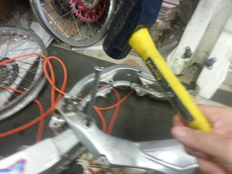

Well, you can get a beater pin and a mallet and try to beat it out and sometimes it actually works...
Other times you destroy the pivot pin.
Using brute force has to be used with caution.
You can completely mushroom the end of your bolt and then it is useless and worse, it can make it harder to get the bolt out...

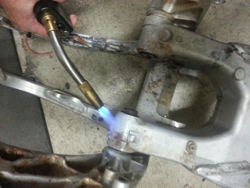

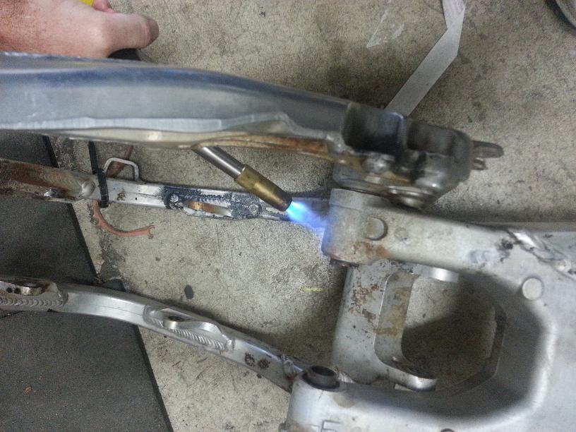

The method that often works the best is heat...
Getting both sides of the swing arm heated up can be tricky but more often then not, heat is what works the best...
If you use heat you will need to replace all the bearings and seals..... You would have probably had to any way but it's just a friendly heads up.

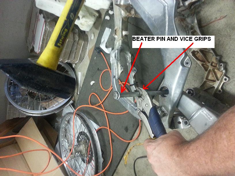

After getting both sides hot enough to cause the grease in the bearings to boil, get out the mallet and beater pin and go to town...
As a side note, missing the bolt with your hammer can result in serious injury so I always wear safety glasses and I use a pair of vice grips to hold the beater pin..
Of course in these pics I have the engine already out so these pics are to demonstrative how I do it... ;)
