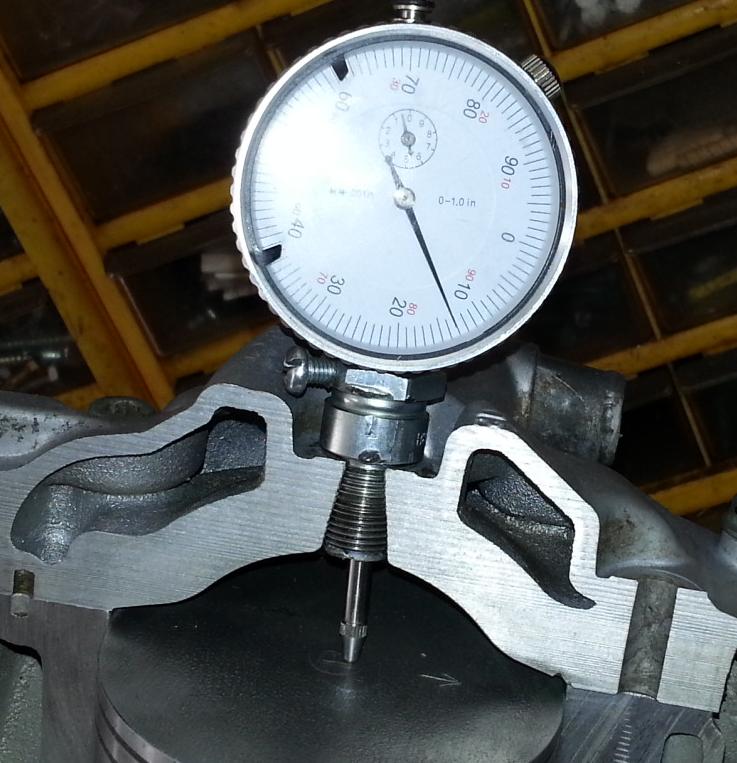

So now that we have the preliminaries out of the way, we need to be able to move the piston to top dead center and then roll the motor back .086" and install the flywheel.
So how can you get the timing exact?
Just need the right tool.
I used a dial indicator and a old hollowed out spark plug.
The first pic here is of my cut away motor.
I am seeing if I have enough travel in my dial indicator to zero the indicator out when the piston is at top dead center, and then still have enough travel to back the motor off to .086".
This is the set up:
[attachment=1]kx500 mzb ignition 1.JPG[/attachment]
In the next pic I rotated the crank so that the top of the piston is at top dead center and zeroed out my indicator.
Then I rotated the crank so that the indicator is not touching the piston at all and got a reading of .132"
Looks good even when we factor in the gasket thickness that is not on the mock up engine.
However, it is really close so I may have to modify my spark plug adapter some to gain some travel in the indicator.

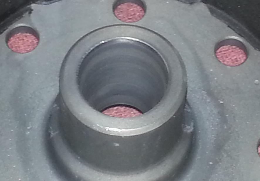

I didn't get any pics before I started but the tapered flywheel ID was bright and shiny.
After applying some fine lapping compound and spinning the flywheel back and forth, round and round, it should be dull..
KX500 2001 MZB INSTALLATION 1-1.JPG (40.19 KiB) Viewed 18500 times

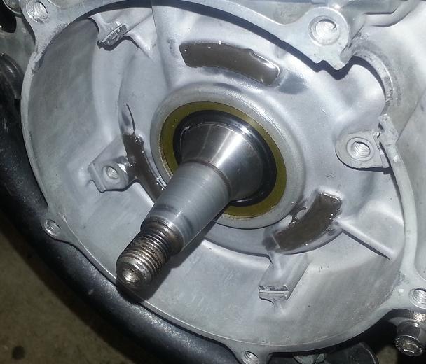

Here's how the crank looks..
KX500 2001 MZB INSTALLATION 1-2.JPG (46.82 KiB) Viewed 18499 times

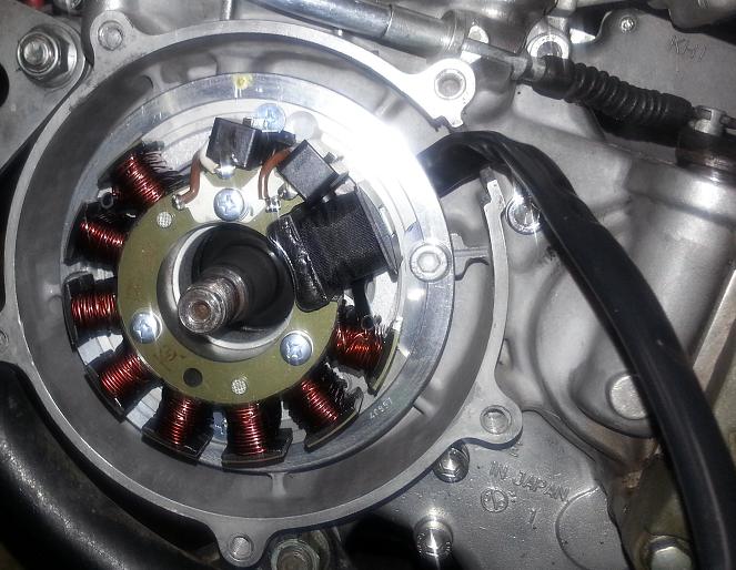

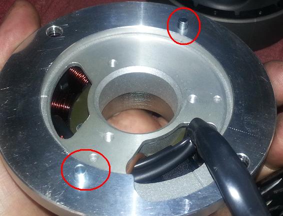

The next thing I did was test fit the stator.
When I tried to seat it, it rocked back and forth.
No matter how much I moved it, it just wouldn't seat..
Here is the culprits...
KX500 2001 MZB INSTALLATION 1-3.JPG (38.34 KiB) Viewed 18499 times
Re: MZB INSTALLATION ON A KX500
Posted: Wed Aug 20, 2014 11:28 pm

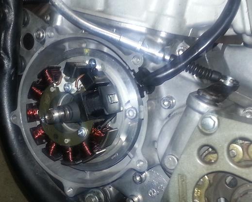

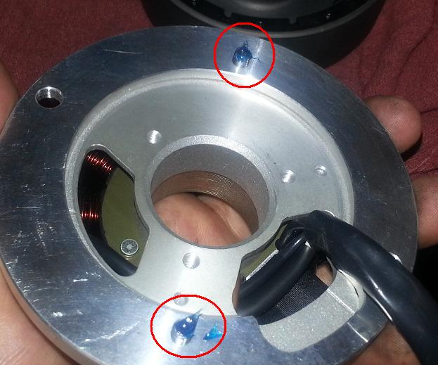

Just to make sure, I put some grease on the end of the bolts and did a test fit.
KX500 2001 MZB INSTALLATION 1-4.JPG (47.58 KiB) Viewed 18499 times
Sure enough that was the problem.
After I ground the bolts shorter the stator went right in with no problems.
KX500 2001 MZB INSTALLATION 1-5.JPG (64.56 KiB) Viewed 18499 times
I used a dab of Blue Loctite on the bolts.
Probably don't need it but I wanted to be sure I don't loose a bolt and destroy my system :shock:

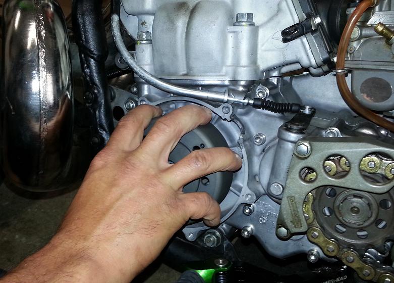

The next thing I had to do was cut down the length of the grommet that sites between the engine case and the stator cover.
KX500 2001 MZB INSTALLATION 1-6.JPG (36.08 KiB) Viewed 18499 times
Turns out the grommet is about an inch too long.
I plan on using some RTV Black Silicon to help seal the wire and grommet.

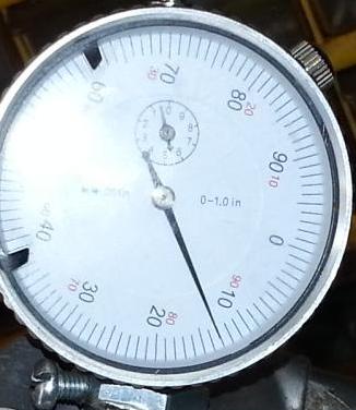

Note that my indicator reads backwards so if you were reading it normally it would appear to be .014".
(The dial indicator is reading .013" because we had a change in timing... Use .014"
KX500 2001 MZB INSTALLATION 2-7.JPG (78.96 KiB) Viewed 18499 times
But look a bit closer.... Notice the small red numbers?
KX500 2001 MZB INSTALLATION 2-8.JPG (21.25 KiB) Viewed 18499 times
Reading the small red numbers it's .086".... PERFECT!!! **** CORRECTED INFO NOW IT'S .086" ****

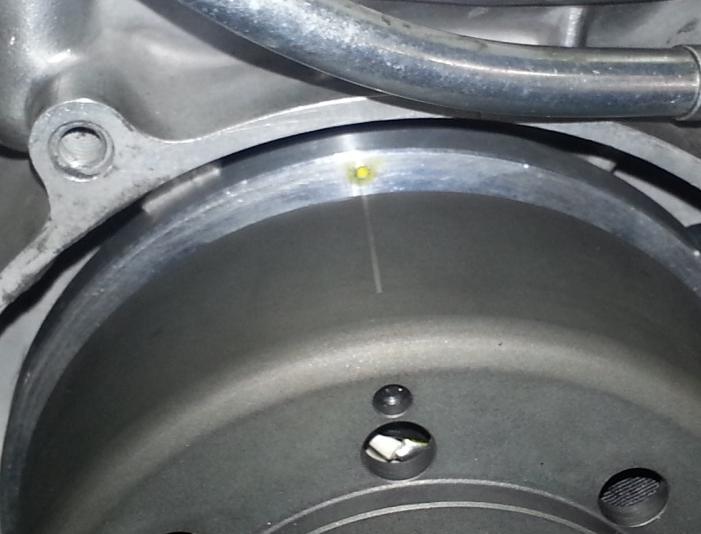

On this model my stator has a small Yellow dot.
The flywheel has a line on the outside edge.
You need to line the line and the dot up and set it into place while maintaining the .086" reading :shock:
