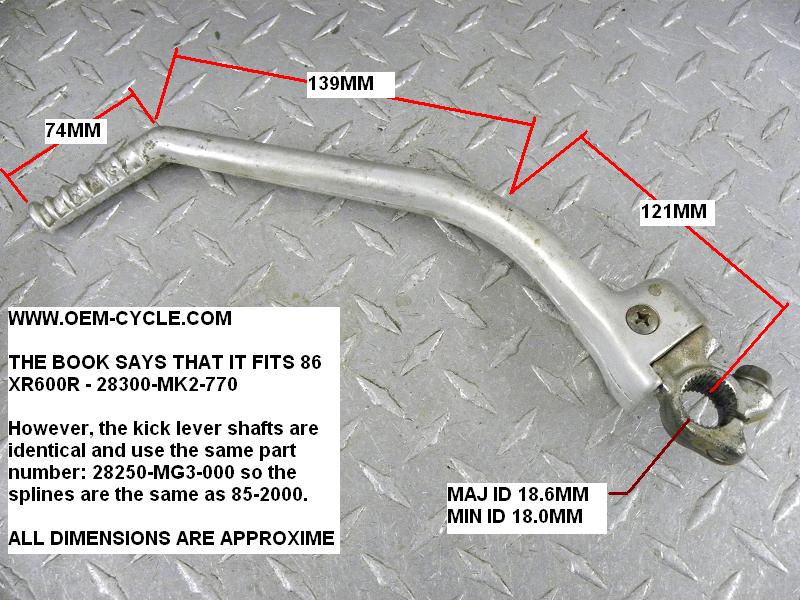

28250-MG3-000 - 1986 XR600R HONDA KICK LEVER PICS AND MEASUREMENTS
The book shows that this part only fits 86 XR600R.
However, the kick lever shaft is the same from 85-00 XR600R so we know the splines are identical.
The only question in the length and angle of the lever.
