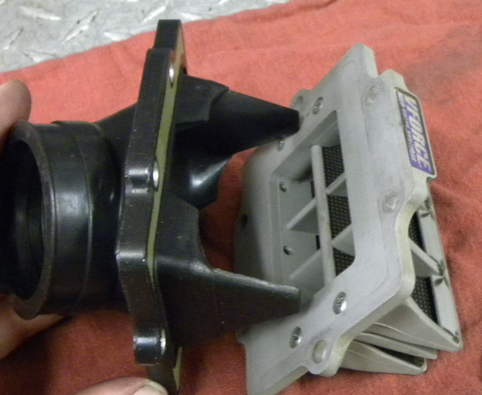

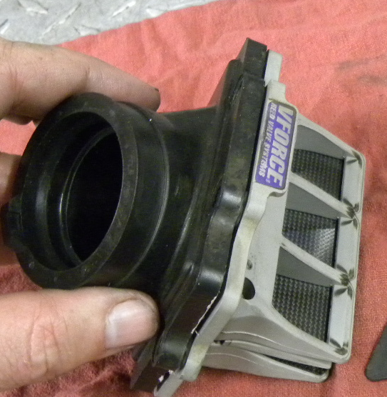

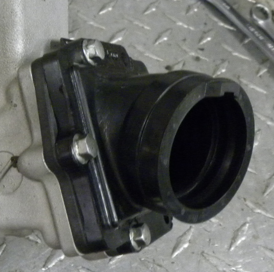

The first thing you notice is that the carb boot just don't work....
V FORCE 2 REED VALVE INSTALLATION -1.PNG (492.52 KiB) Viewed 226504 times
V FORCE 2 REED VALVE INSTALLATION -2.PNG (774.78 KiB) Viewed 226504 times

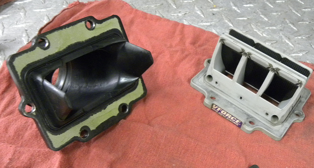

So, you need to cut the ears off... :o
I recommend leaving the ears a little long so you can fine grind them to size.
V FORCE 2 REED VALVE INSTALLATION -3.PNG (668.39 KiB) Viewed 226504 times
That's better..
V FORCE 2 REED VALVE INSTALLATION -4.PNG (625.29 KiB) Viewed 226503 times

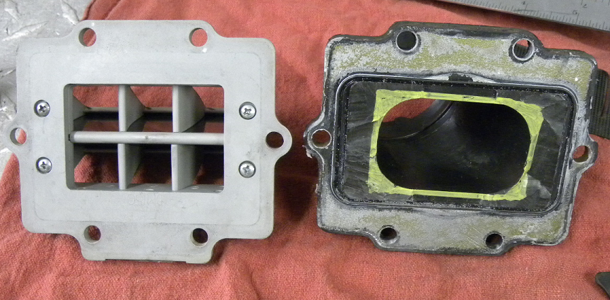

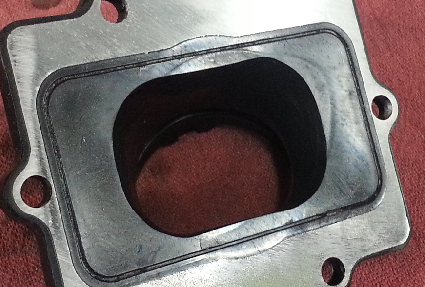

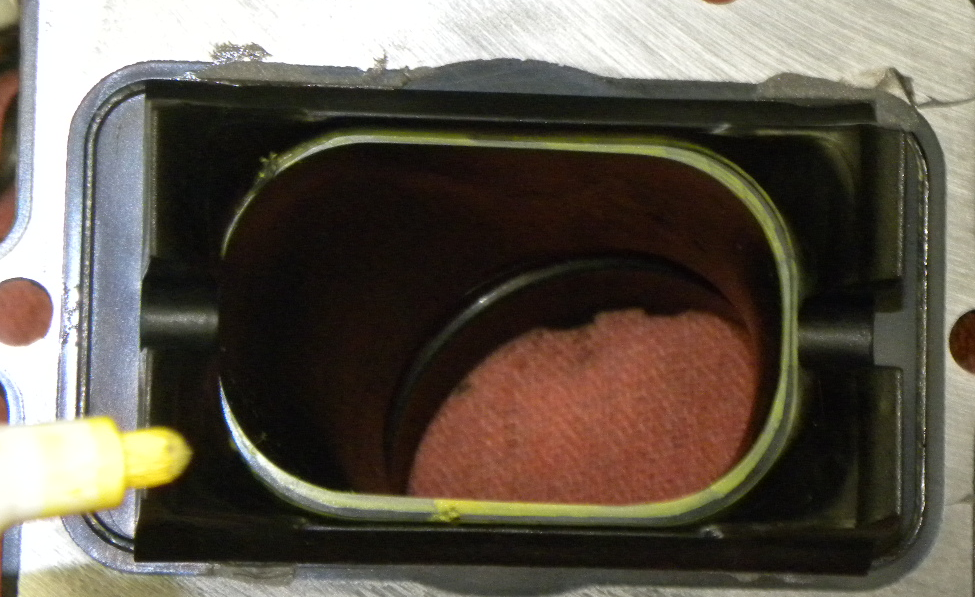

After cutting the ears, the next thing I noticed is the difference between the carb opening and the reed opening.
Marked in yellow you can see the huge difference.
My first instinct was to dremel out the difference.
But you don't want to do this as you will lower the port velocity.
I'll cover more of that in a bit.
V FORCE 2 REED VALVE INSTALLATION -5.PNG (852.22 KiB) Viewed 226503 times

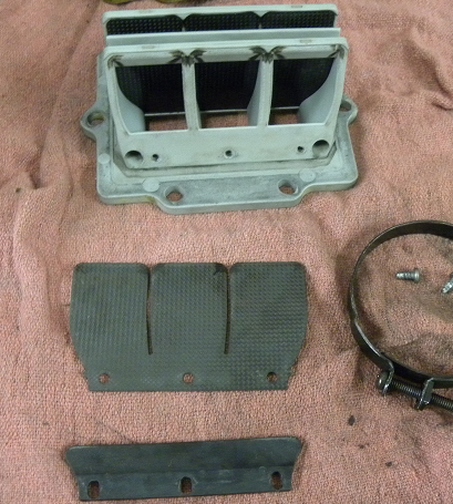

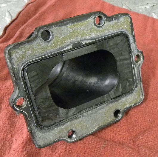

Note how the reed pedal clamp is slotted?

Here is what the boot looks like after it has been ground to it's final size:
V FORCE 2 REED VALVE INSTALLATION -7.PNG (1.04 MiB) Viewed 226489 times
It's hard to see but the mating surface is very smooth after grinding it on a 80 grit 18" diameter wheel.
The smooth surface is important for mating but also marking.

Here is where MR. Motorrad really saved my bacon.
I'll be using a larger carburetor so I need to try to maintain the correct velocity.
If I make the hole to big I will loose velocity, too small and I will loose top end.
So how on earth do you decide.
To begin with even the stock boot is too large so if you don't plan on using a larger carb and modding your engine don't mess with it.
Simply bolt it on with some Yamagoo (Yamabond) and call it good.
Since I am going to do some mods I will need to enlarge it slightly to un-shroud the outer reeds so as not to starve the boost ports.
But how on earth do you know how much is too much?
MR. Motorrad asked me if I had a V-Force 3 laying around.
Yes I do...

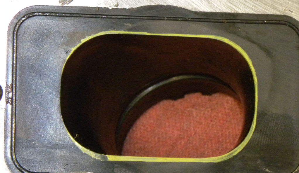

What we want to do is use the hole pattern from the V-Force 3 stuffer and transfer that pattern to the stock boot.
But, how can you accurately do that?
Once you get your boot ears off and it is properly ground you want to take the V-Force 3 reed and put 4 small dabs of silicone on the stuffer block.
Assemble the boot with the V-Force 3 reed on your cylinder and let it dry.
Once the silicone is dry you remove everything while leaving the V-Force stuffer attached to the boot.
Then you can mark the boot, Dremel it, and use it.
I will have some pics showing how by tomorrow....
So, stay tuned..

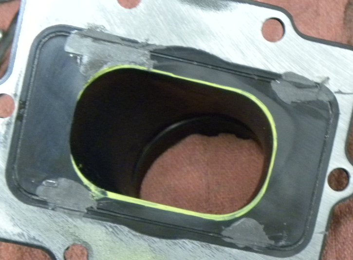

Re: Installing a VForce 2 Reed valve in a KX500
Posted: Tue Jun 25, 2013 7:46 pm
You can see spots where the silicone was applied.
Just a small dab will do you.
I applied it to the back of the stuffer only.
V FORCE 2 REED VALVE INSTALLATION -8.PNG (714.19 KiB) Viewed 226477 times
Then I bolted it all together and let it dry over night.
V FORCE 2 REED VALVE INSTALLATION -9.PNG (480.21 KiB) Viewed 226477 times
The next morning I carefully removed the bolts and pulled the boot and reed out.
Then I carefully removed the reed which left the stuffer behind.
You can see the difference in the opening size..
V FORCE 2 REED VALVE INSTALLATION -9-1.PNG (921 KiB) Viewed 226477 times
Then I marked the difference.
V FORCE 2 REED VALVE INSTALLATION -9-2.PNG (1.02 MiB) Viewed 226477 times

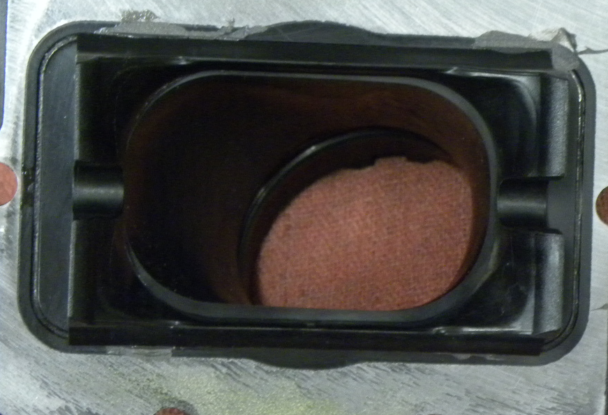

After I marked it, I pulled the stuffer off leaving just the boot with the yellow marks that I will carefully remove.
V FORCE 2 REED VALVE INSTALLATION -9-3.PNG (1.13 MiB) Viewed 226477 times
Posted: Tue Jun 25, 2013 9:51 pm
After a few minutes with the Dremel using a drum sander attachment, the boot is looking good..
V FORCE 2 REED VALVE INSTALLATION -9-5.PNG (1.05 MiB) Viewed 226475 times

Ok, so your all ready to install your new set up right?
Not so fast Jack.....

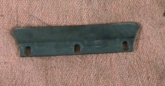

You still need to set the Tension on the reed pedals.
How is this done?
Look carefully at the reed clamp.
Note that they are slotted.
V FORCE 2 REED VALVE INSTALLATION -9-6.PNG (313.79 KiB) Viewed 226475 times

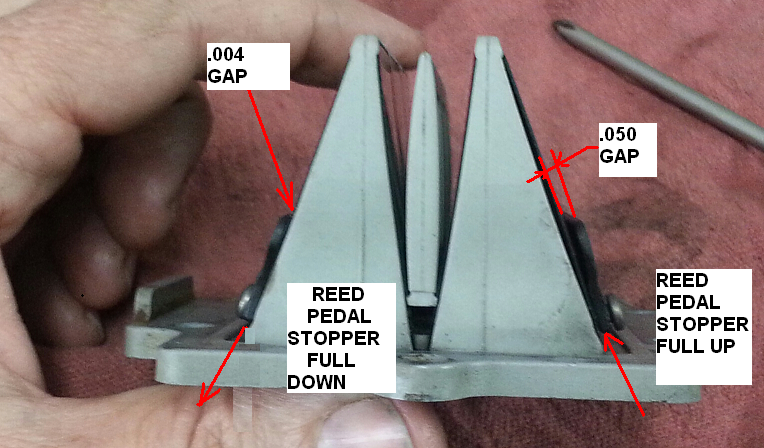

According to Moto Tassinari the Low tension setting is for low to mid range power and the hi tension setting is for High end power.
After conversing with Motorrad and others who have dyno'd all the different combinations they found that the low tension setting did nothing more on the KX500 then wear the reed pedals out faster.
So, I will use the Hi Tension settings.
Here is a pic demonstrating the high tension vs. low tension settings.
V FORCE 2 REED VALVE INSTALLATION -5.PNG (726.46 KiB) Viewed 226475 times
Note that there is a .004" gap when you set the reed clamp closest the carburetor making it harder to open the reed pedals.
When you set the reed clamp further from the carburetor there is a .050" gap allowing the reed pedals to open easier.
So just for the record:
Reed clamp closer to the carburetor = High tension setting
Reed clamp farther from the carburetor = Low tension setting
This is my story and I'm sticking to it for now :|
