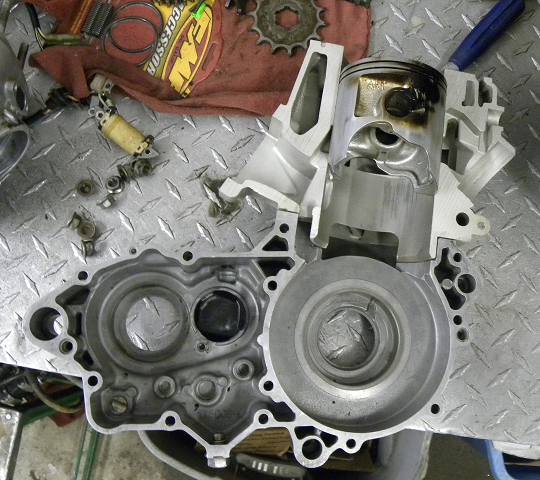

KX500 CYLINDER CUT AWAY!
Posted: Wed Jun 19, 2013 11:50 pm
Thanks to Tobys 2 strokes for donating a KX500 Cylinder.
Have you always wondered how it all works or what happens when in relation to....
We will explore this together :D
KX500 CYLINDER CUT AWAY 1.PNG (682.17 KiB) Viewed 19867 times
KX500 CYLINDER CUT AWAY 2.PNG (605.61 KiB) Viewed 19867 times

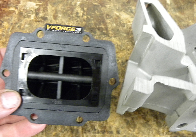

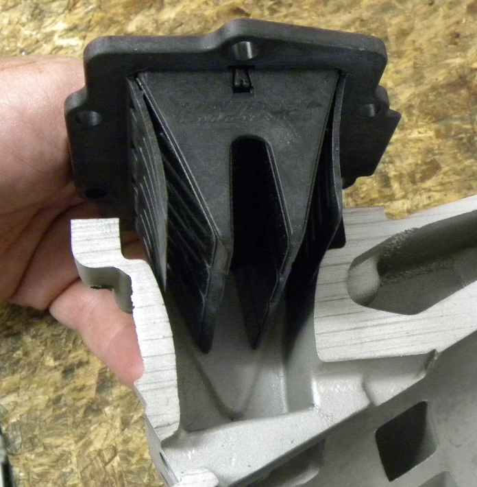

So, how do the reed valves fit into the cylinder?
I'll start with a V-Force 3 and go from there...
V FORCE 3 KX500 1.PNG (643.48 KiB) Viewed 19820 times
V FORCE 3 KX500 2.PNG (552.67 KiB) Viewed 19820 times
This is how far the V Force 3 will slip into the cylinder before the reed begins to touch on the top and bottom.
V FORCE 3 KX500 3.PNG (984.56 KiB) Viewed 19820 times

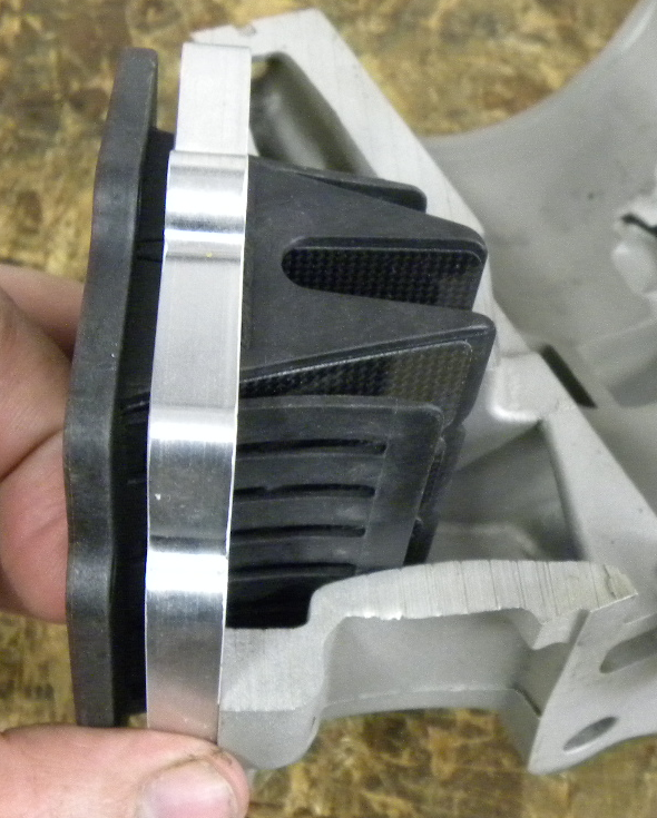

Here is a view from the side to show just how much further the reed valve has to go into the cylinder and it is already touching on the top and bottom.
V FORCE 3 KX500 4.PNG (895.96 KiB) Viewed 19820 times

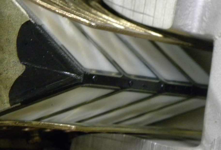

By the time you install the reed all the way in look how far it is pinching shut :o
V FORCE 3 KX500 5.PNG (1.13 MiB) Viewed 19820 times

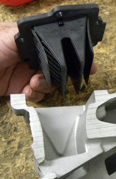

Here is the side view of the same thing.
V FORCE 3 KX500 6.PNG (1.12 MiB) Viewed 19820 times
V FORCE 3 KX500 7.PNG (770.6 KiB) Viewed 19820 times
This view shows how much material would have to be removed in order for the reed to be able to fully open.
While the cylinder could be opened up enough on top to make that happen, the bottom is too thin.
It's hard to see from the picture but the 3 "X"'s are part of the excess casting.
If I removed it you would see that the bottom would be extremely thin, and I suspect it would probably break all the way through :shock:
Even if it did open up that much you would probably loose velocity.....
V FORCE 3 KX500 8.PNG (828.91 KiB) Viewed 19819 times
As you can see, this is not really the best of designs..

Here is a view with a 10mm reed spacer installed.
This is how far it will slide into the cylinder before the top and bottom start to touch.
V FORCE 3 WITH 10MM SPACER KX500 1.PNG (815.83 KiB) Viewed 19820 times
Here is a side view of the same thing.
V FORCE 3 WITH 10MM SPACER KX500 2.PNG (536.73 KiB) Viewed 19820 times
Here is a view with the reed all the way in.
V FORCE 3 WITH 10MM SPACER KX500 3.PNG (536.67 KiB) Viewed 19820 times
As you can see it is better but still far from optimal...

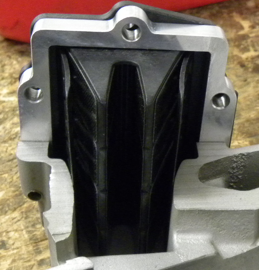

STOCK KX500 REED VALVE FITMENT AND CUTAWAY
Posted: Thu Jun 20, 2013 11:11 pm
This is the stock reed..
It does not have any interference fitment issues..
