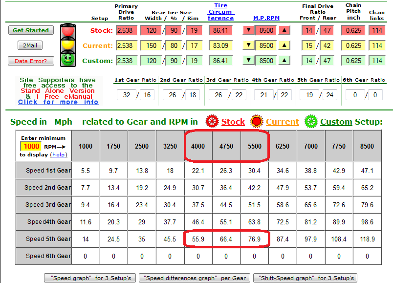

I was trying to figure out my RPM's at hwy speeds for my KX500 Supermoto.
Here is stock:
gearing commander 1.png (61.11 KiB) Viewed 3222 times

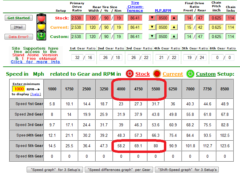

Here is the numbers with my current gearing:
gearing commander 2.png (53.44 KiB) Viewed 3222 times

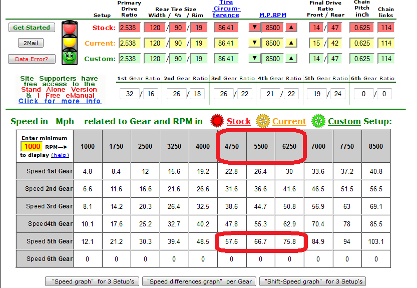

Then, I changed the rear wheel size for the use of a 17" rear wheel:
gearing commander 3.png (53.44 KiB) Viewed 3222 times
It should be said that just because you put the numbers in there, does not mean your engine will pull it :o
Do I think my stock KX500 engine will pull 124 MPH?
NO :lol:
With a few mods?
Maybe 8-)
Will I have the hair to hold the throttle on for that long to test that theory?
We'll see :D
