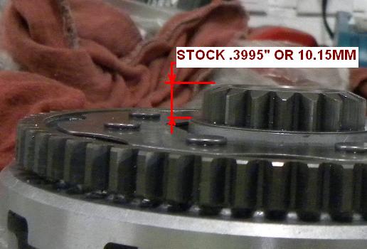

So we looked a little harder and found that the small gear on the back of the clutch basket stuck out away from the back of the basket.
This is what a good basket was measured at:
99 CR250 CLUTCH BASKET -1.JPG (27.12 KiB) Viewed 12948 times
I could not find any specs for this in the Clymer Service Manual.
But as you can see ours measured .3995" or 10.15mm.
The customers measured 0.4232" or 10.75mm.
So, the customer is going to press his gear back to our measurements.

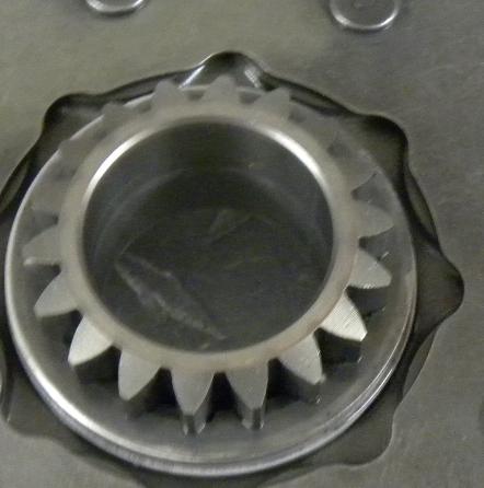

He will support the basket by the steel rivets and press it from the small gear on the back
Support from this side on the steel rivets.

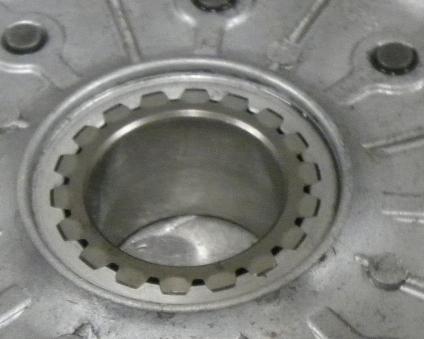

He will press from this side on the gear with a block of wood to keep from marring the gear face surface.
