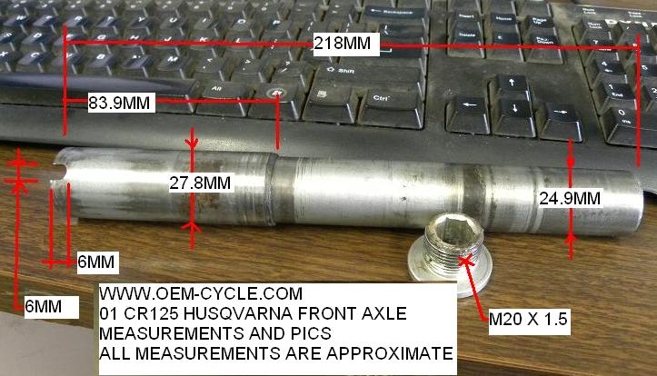

CR125 HUSQVARNA FRONT AXLE MEASUREMENTS AND PICS
01 CR125 HUSQVARNA FRONT AXLE MEASUREMENTS AND PICS.JPG (65.47 KiB) Viewed 7645 times

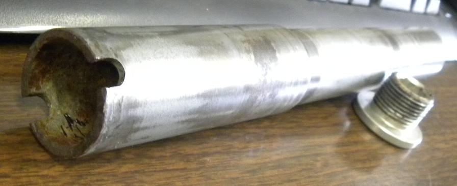

01 CR125 HUSQVARNA FRONT AXLE MEASUREMENTS AND PICS -1.JPG (26.02 KiB) Viewed 7645 times

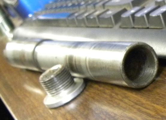

01 CR125 HUSQVARNA FRONT AXLE MEASUREMENTS AND PICS -2.JPG (35.1 KiB) Viewed 7645 times
