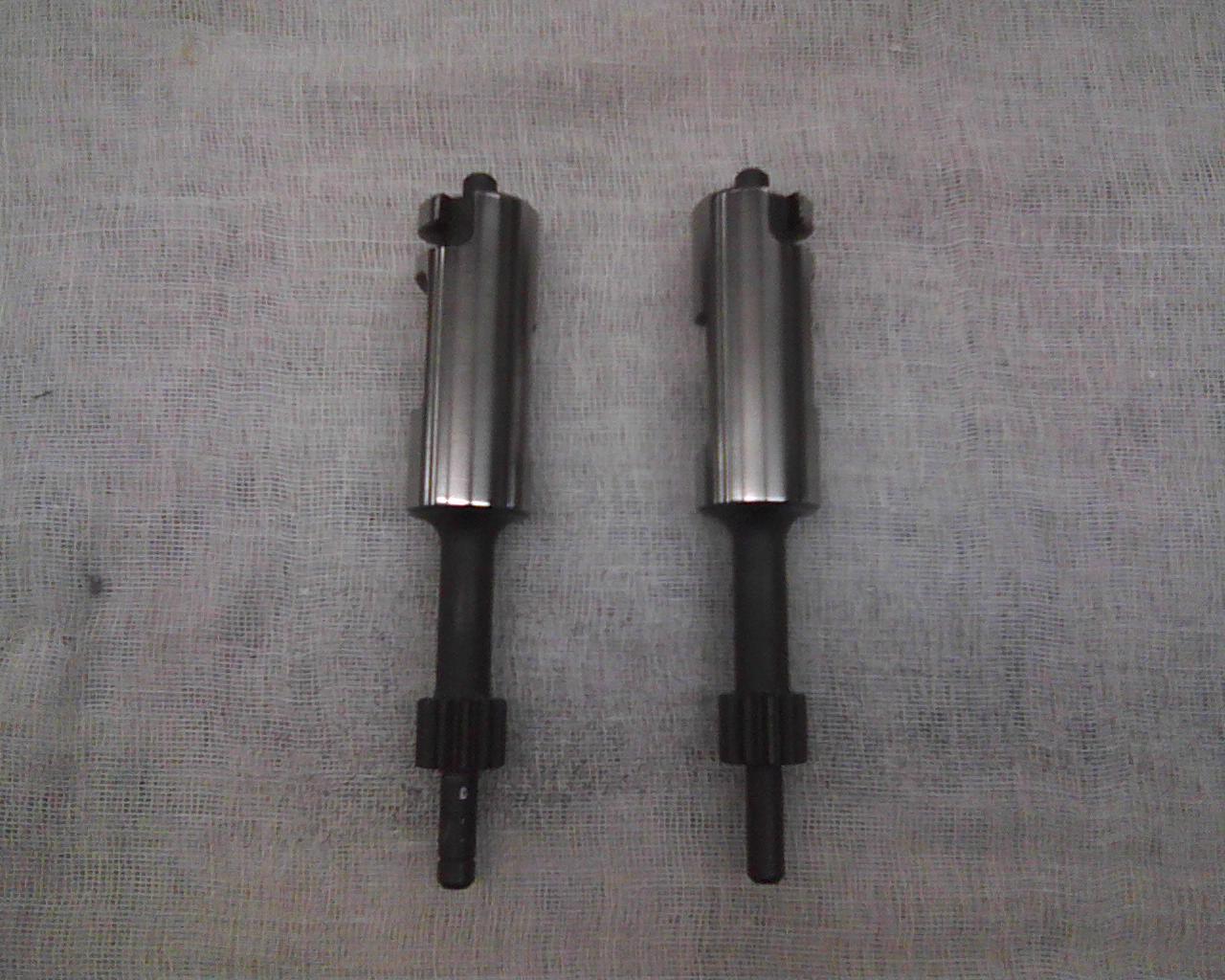

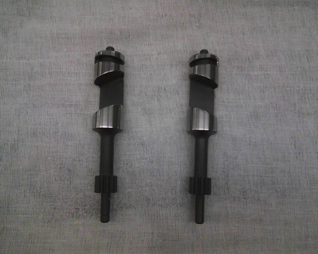

A picture says more than I can:

Those do look sweet.
There's a mildly abrasive wheel on the grinder @ work, its actually for tool sharpening but it will shine them up nice like that. I like to hit the area in where the exhaust would flow through too so the carbon has a harder time sticking there as well.

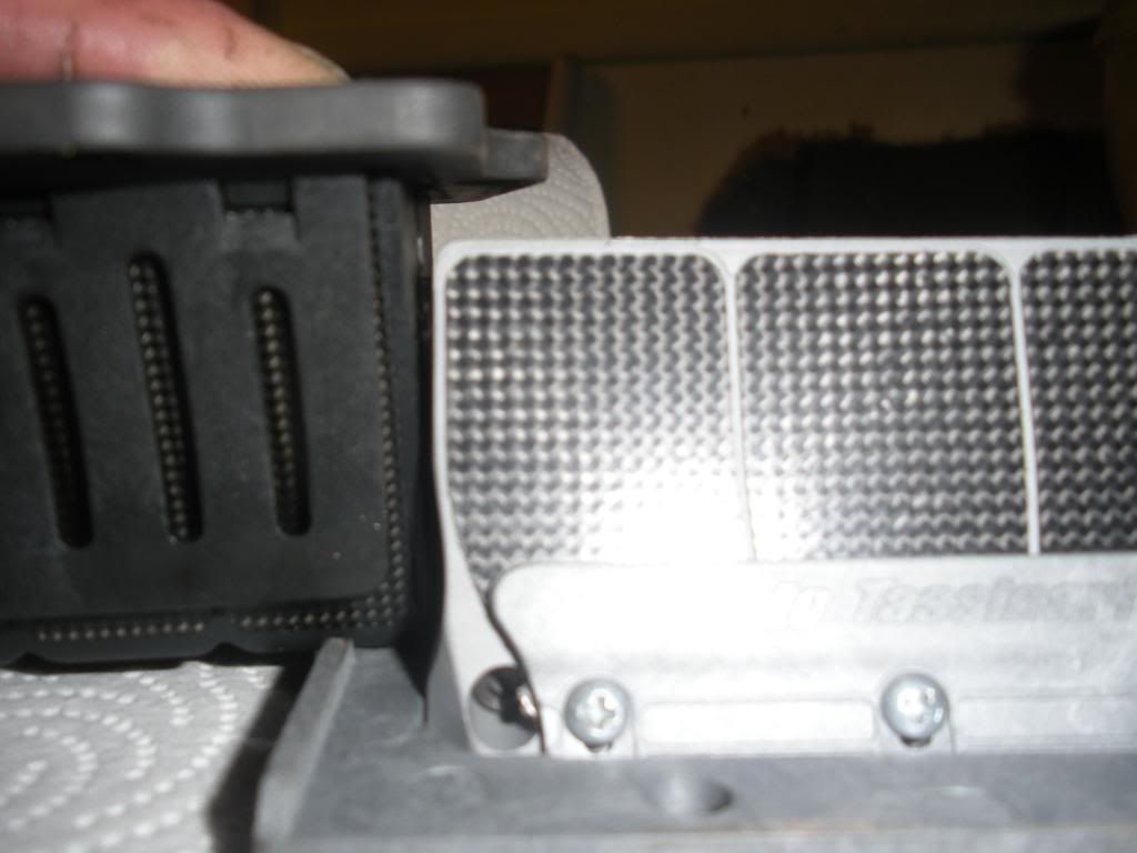

Let me show you my "reed spacer"
The shorter one is the VF2's.
Really though its hard to give up the hit where I ride we have hills a 250 wont pull cause they just dont have enough power to pull from a dead stop & get the momentum moving. The 550 was a bit much but honestly I'm going to do it again. Gearing is at 15 47 but if I can get the first gear to go together I should be able to step into the 16 45 range easy enough. I guess the gearing I run is part of why I dont like flywheel weights, Todd P. says the 125/250 ignition hits even harder which has me tempted. My cr is geared 14 43. Its just the area , you want the high speed for the desert connecting runs but when you get to the hill you still need the snap out of the bottoms of these deep V'ed washes that shoot up football fields standing on end.
