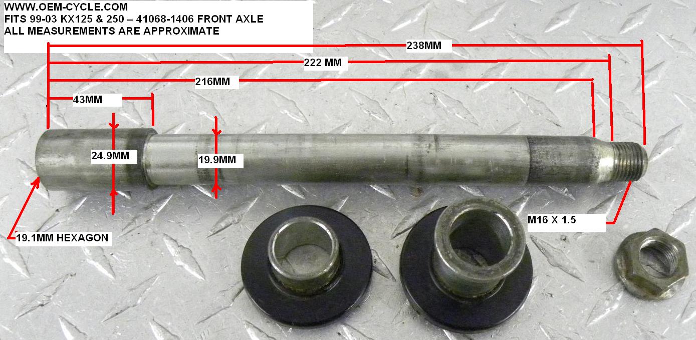

99-03 KX125 and KX250 FRONT AXLE – 41068-1406 PICS AND MEASUREMENTS
FITS 1999 2000 2001 2002 2003 KX125 AND KX250
99-03 KX125 and KX250 FRONT AXLE – 41068-1406 PICS AND MEASUREMENTS WWW.OEM-CYCLE.COM
FRONT AXLE MEASUREMENTS.JPG (156.27 KiB) Viewed 10348 times
Any questions?
Feel free to post or PM.
