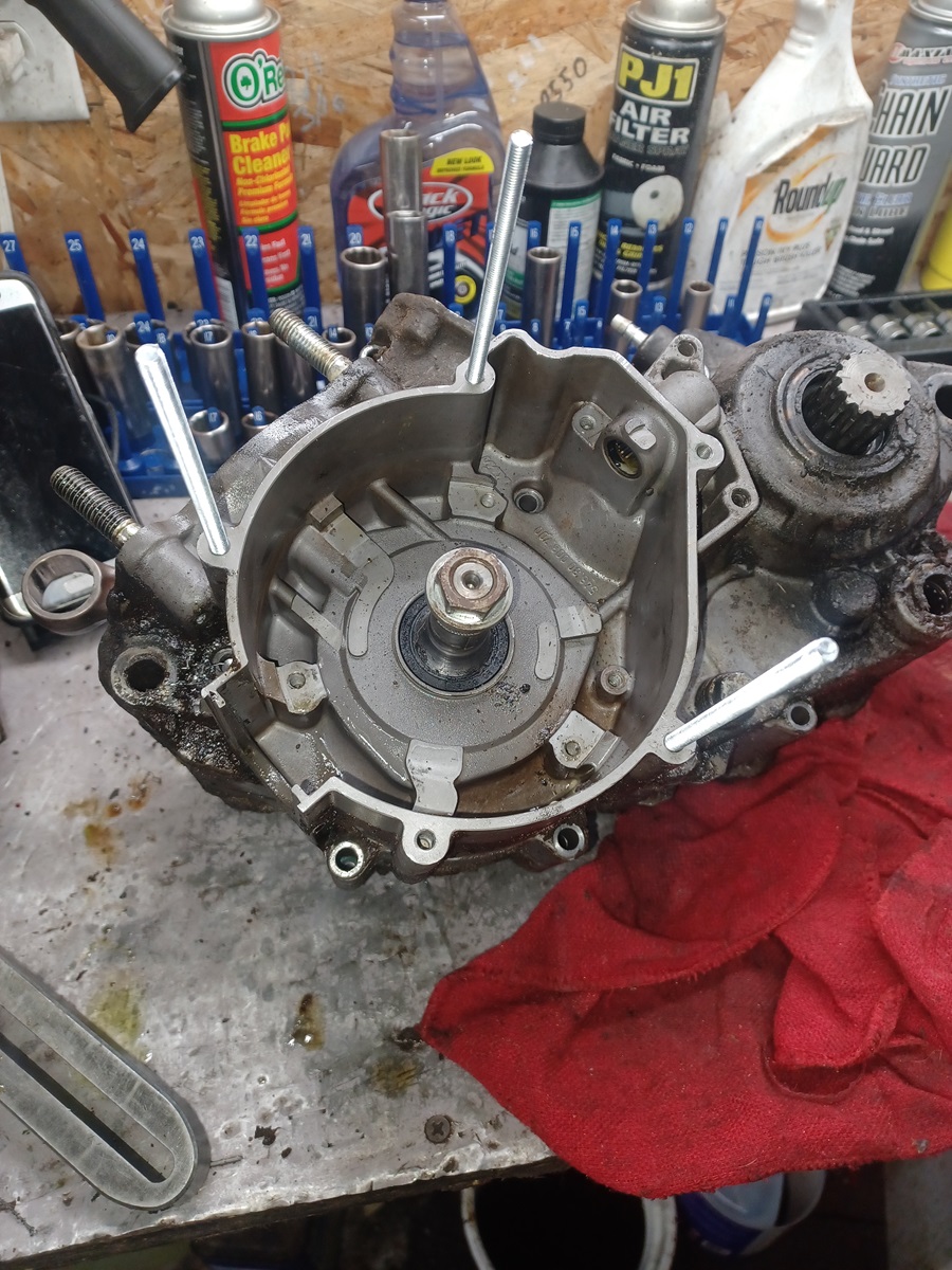

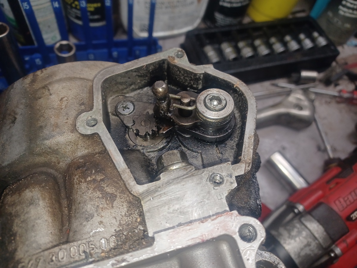

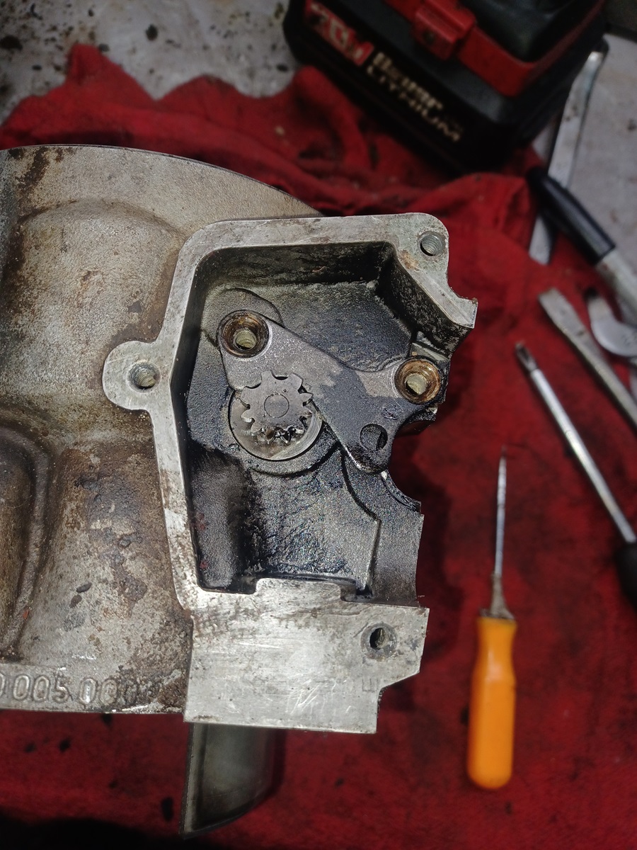

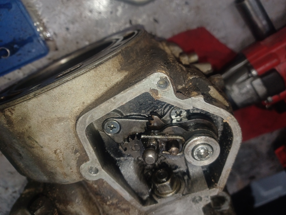

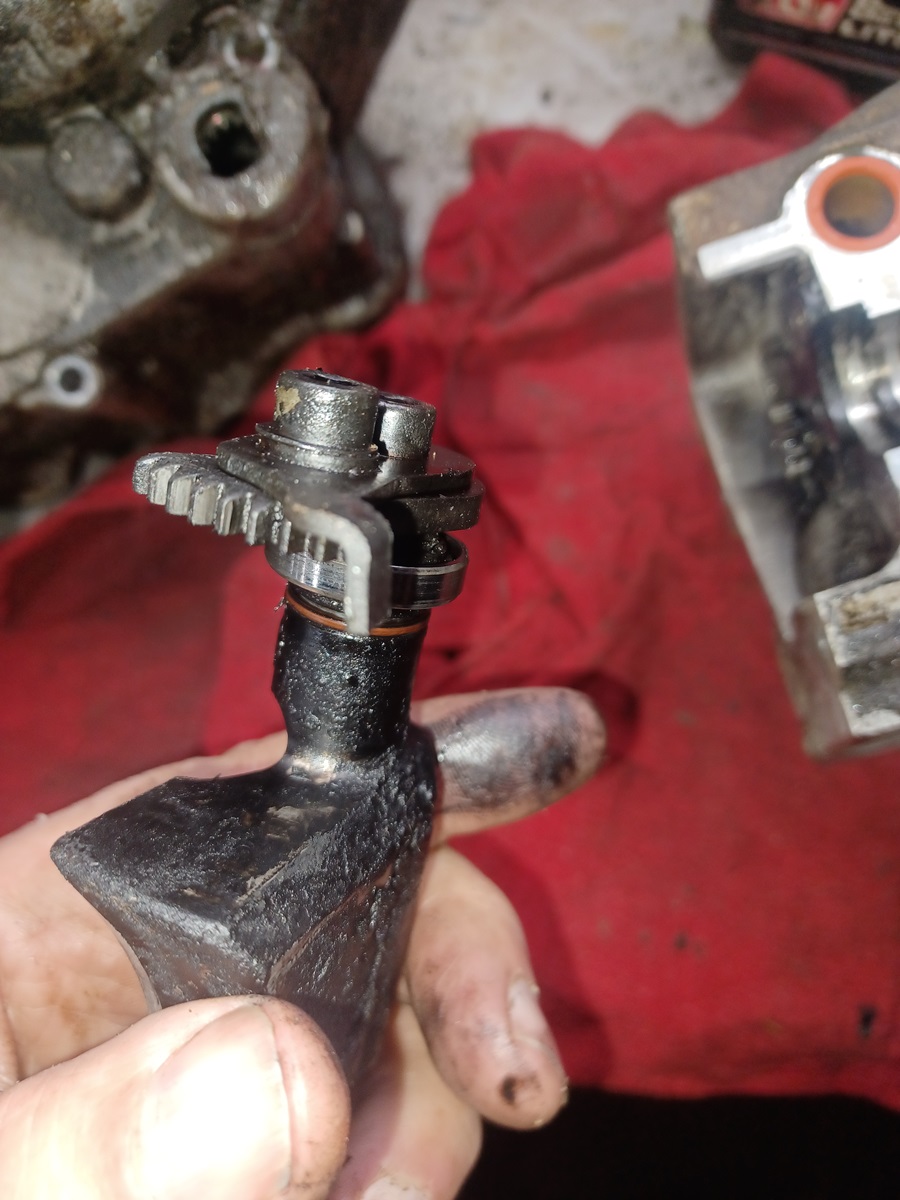

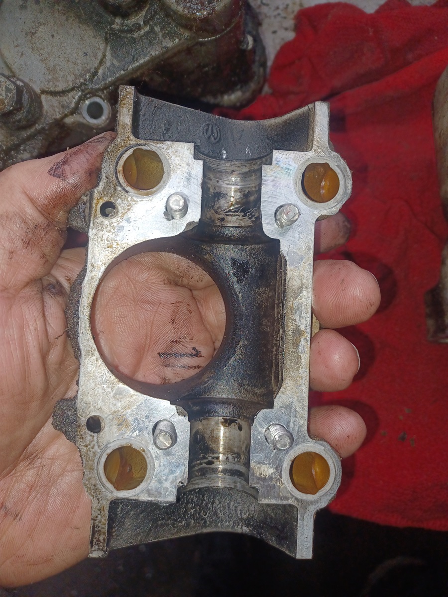

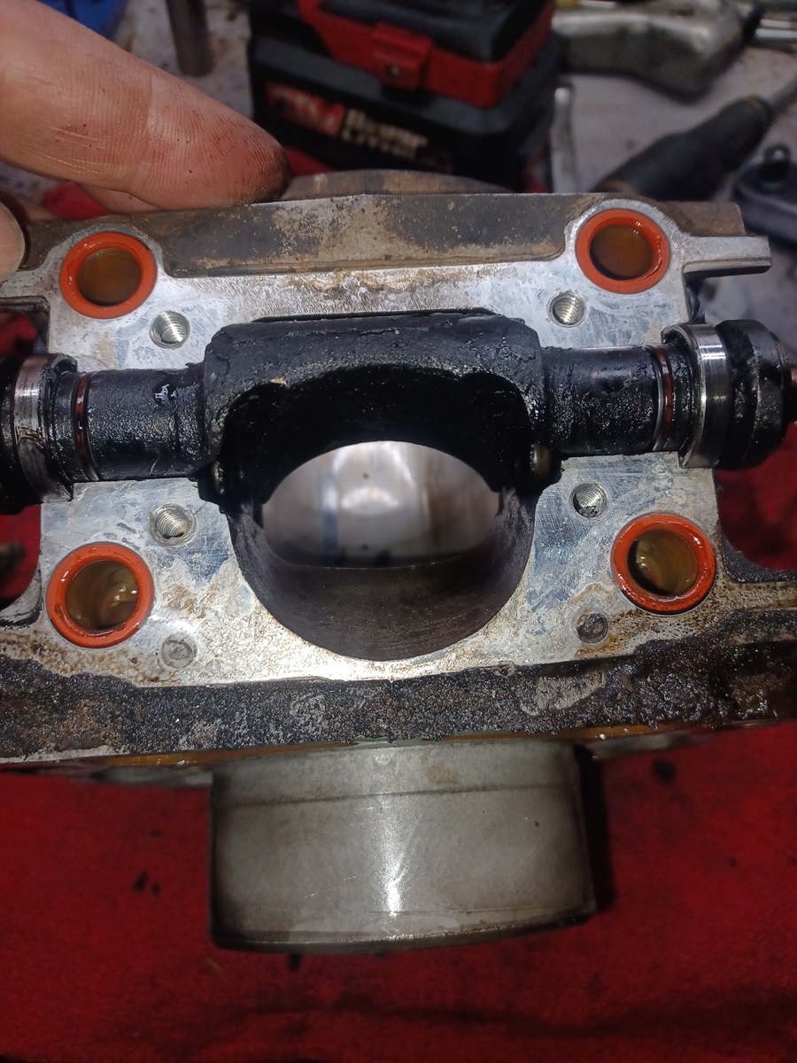

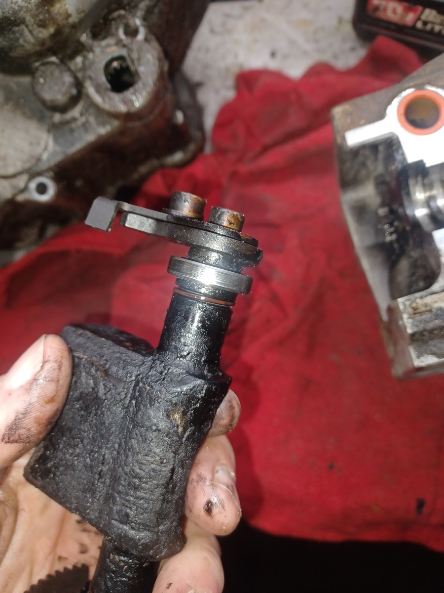

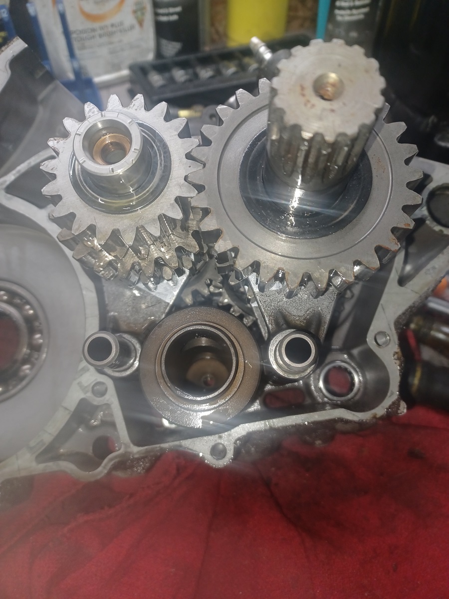

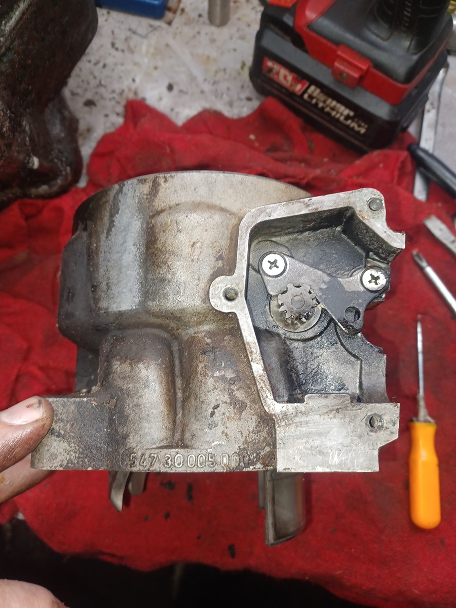

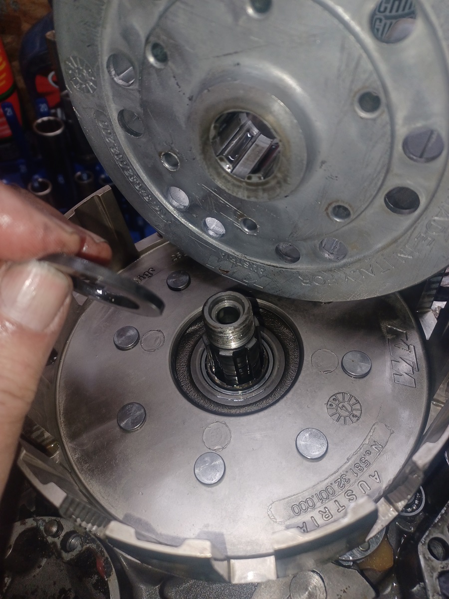

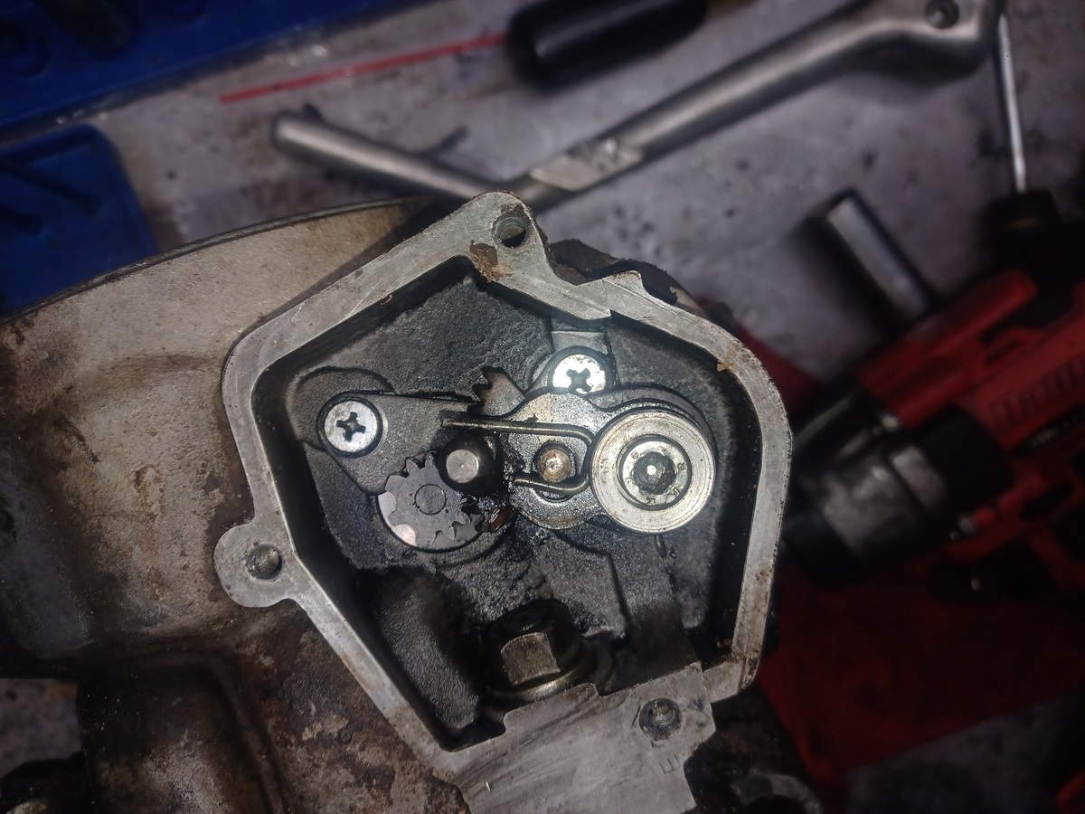

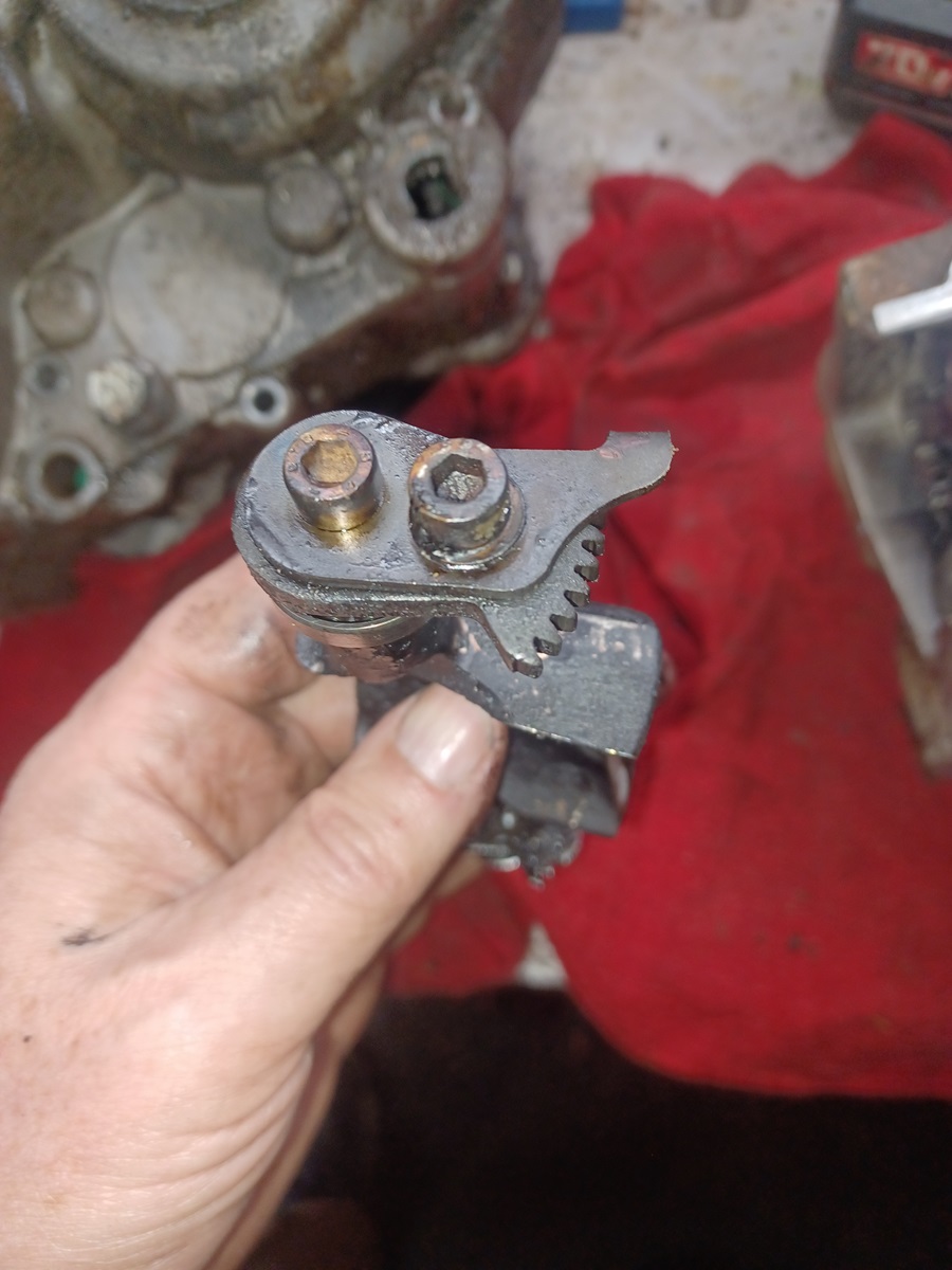

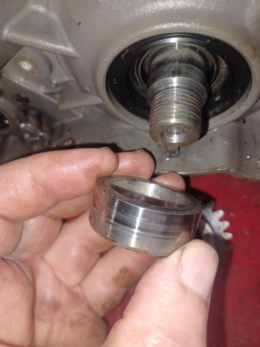

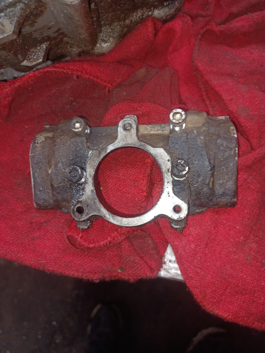

The engine is out and ready for disassembly..
Re: 96 KTM 360 EXC INDUCTION CRANK BUILD IN A 2021 GAS GAS CHASSIS

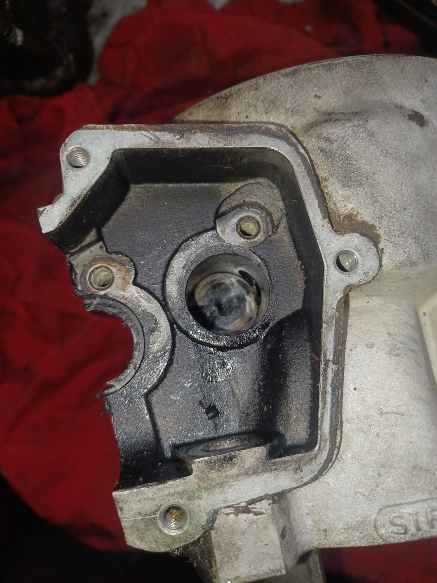

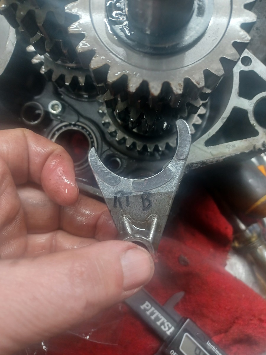

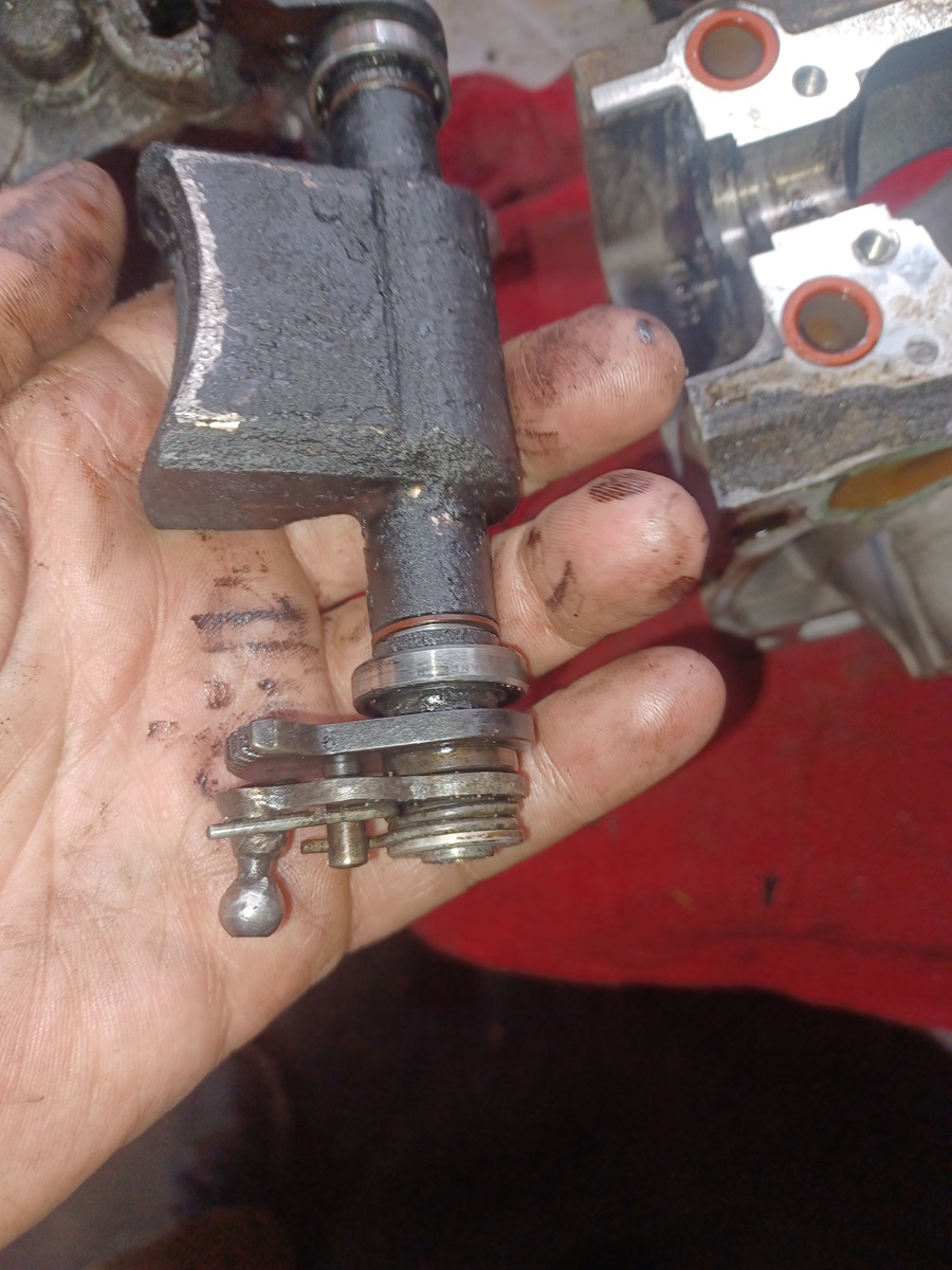

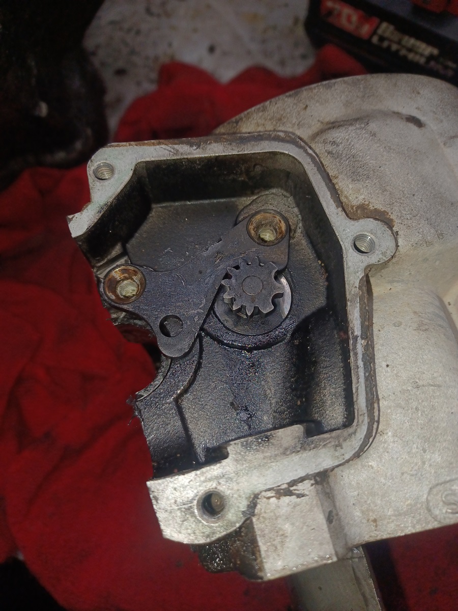

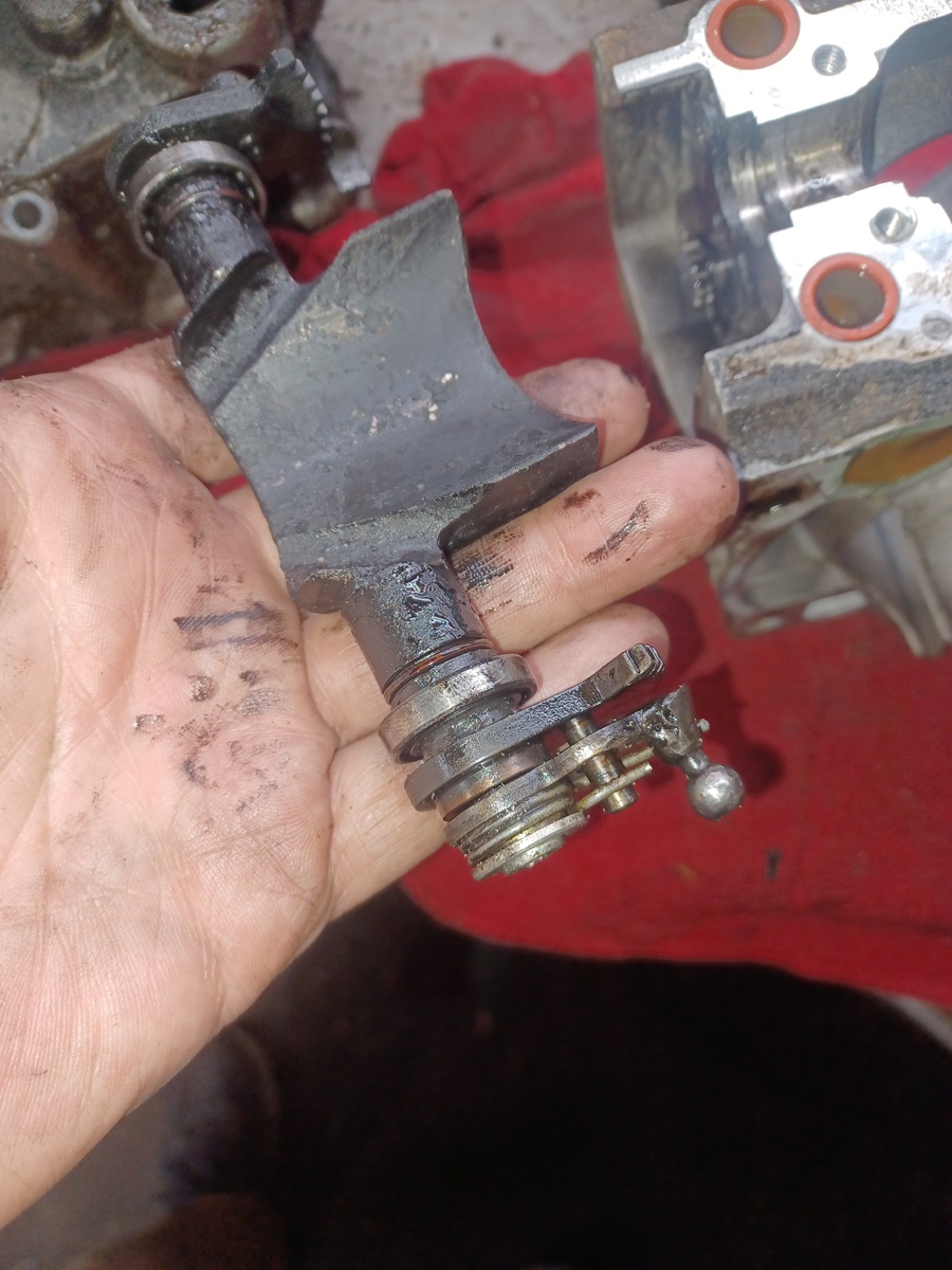

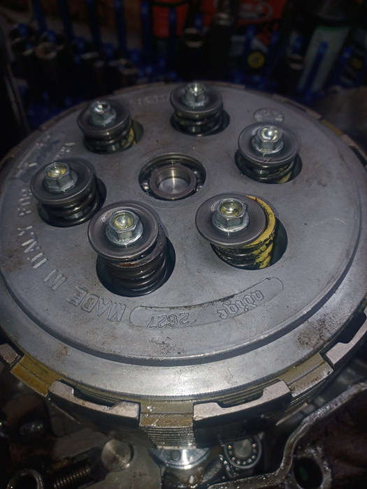

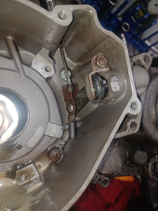

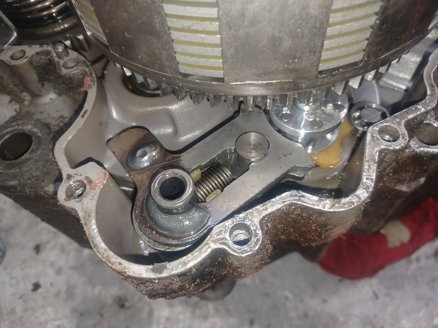

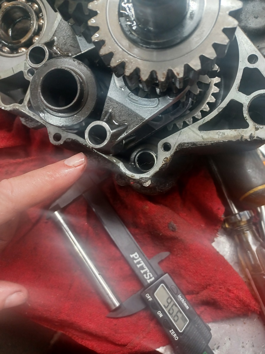

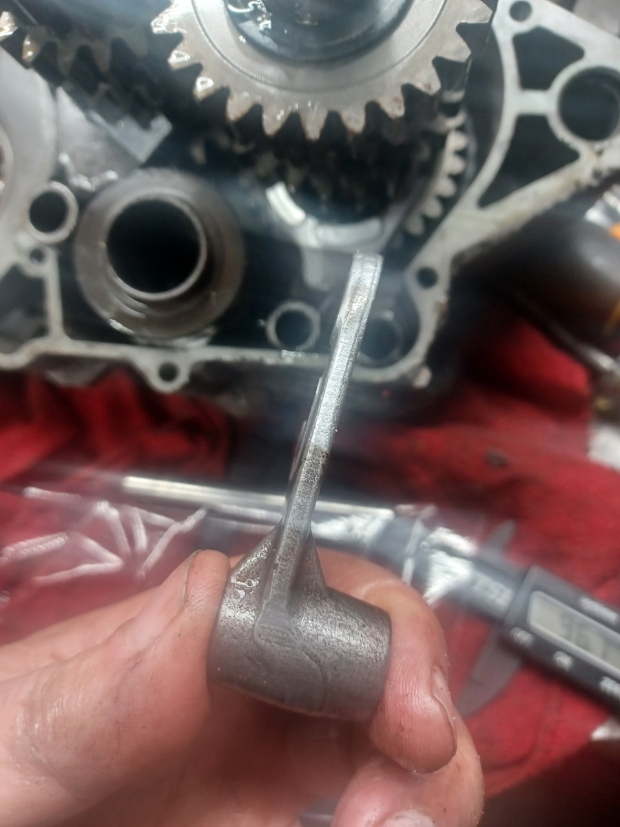

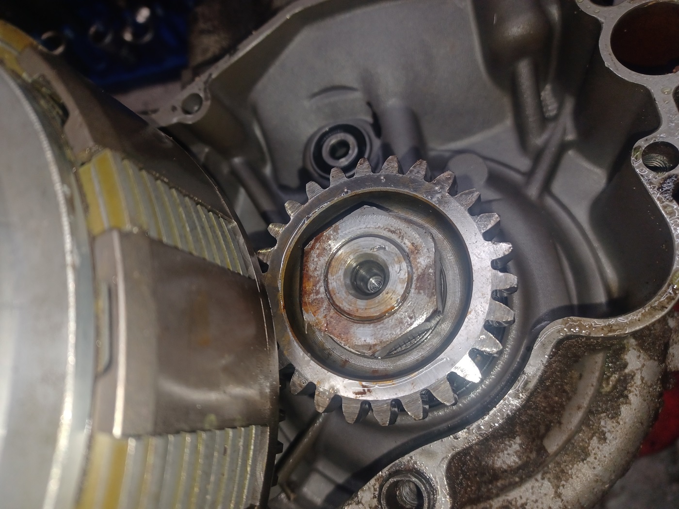

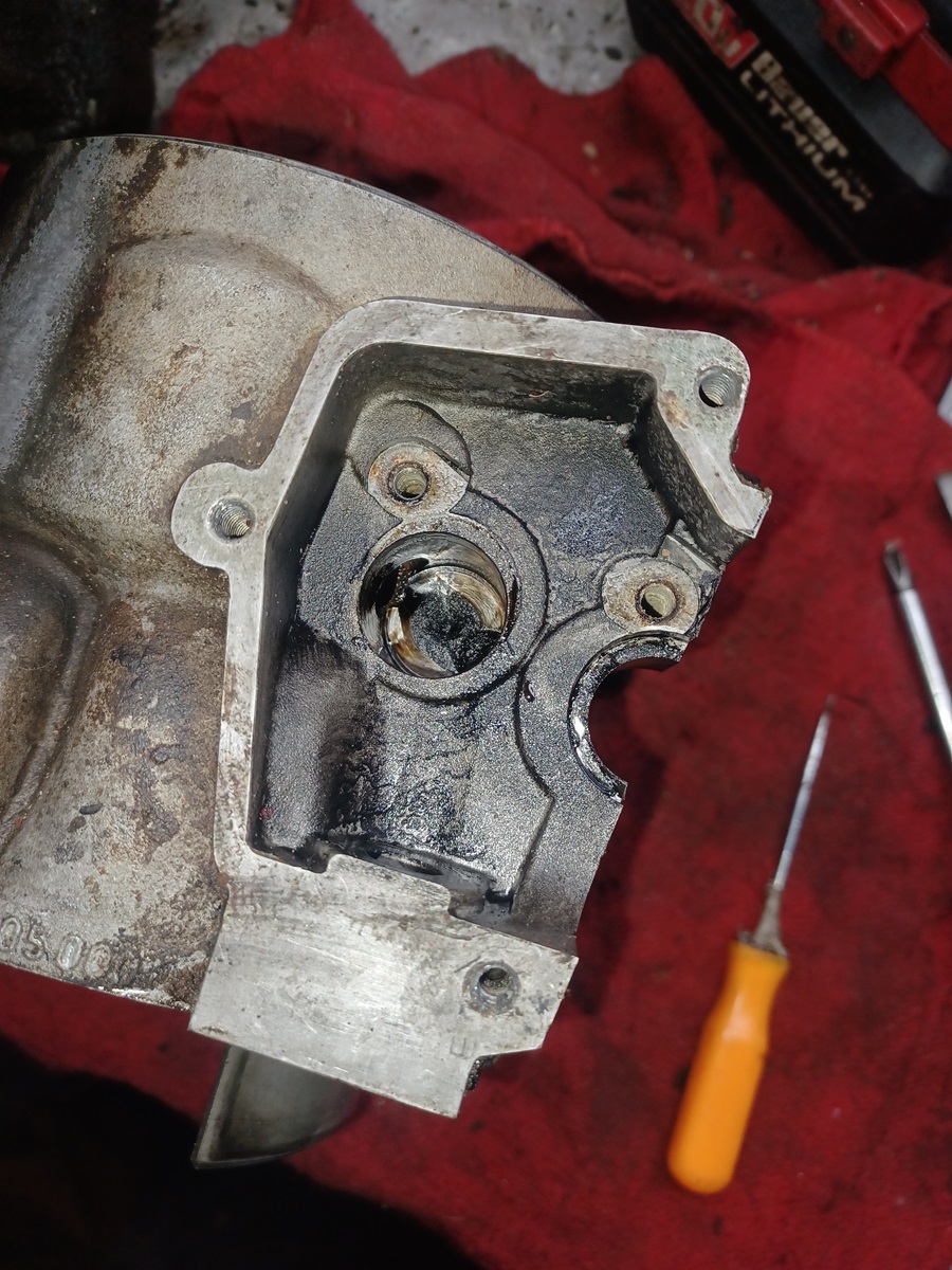

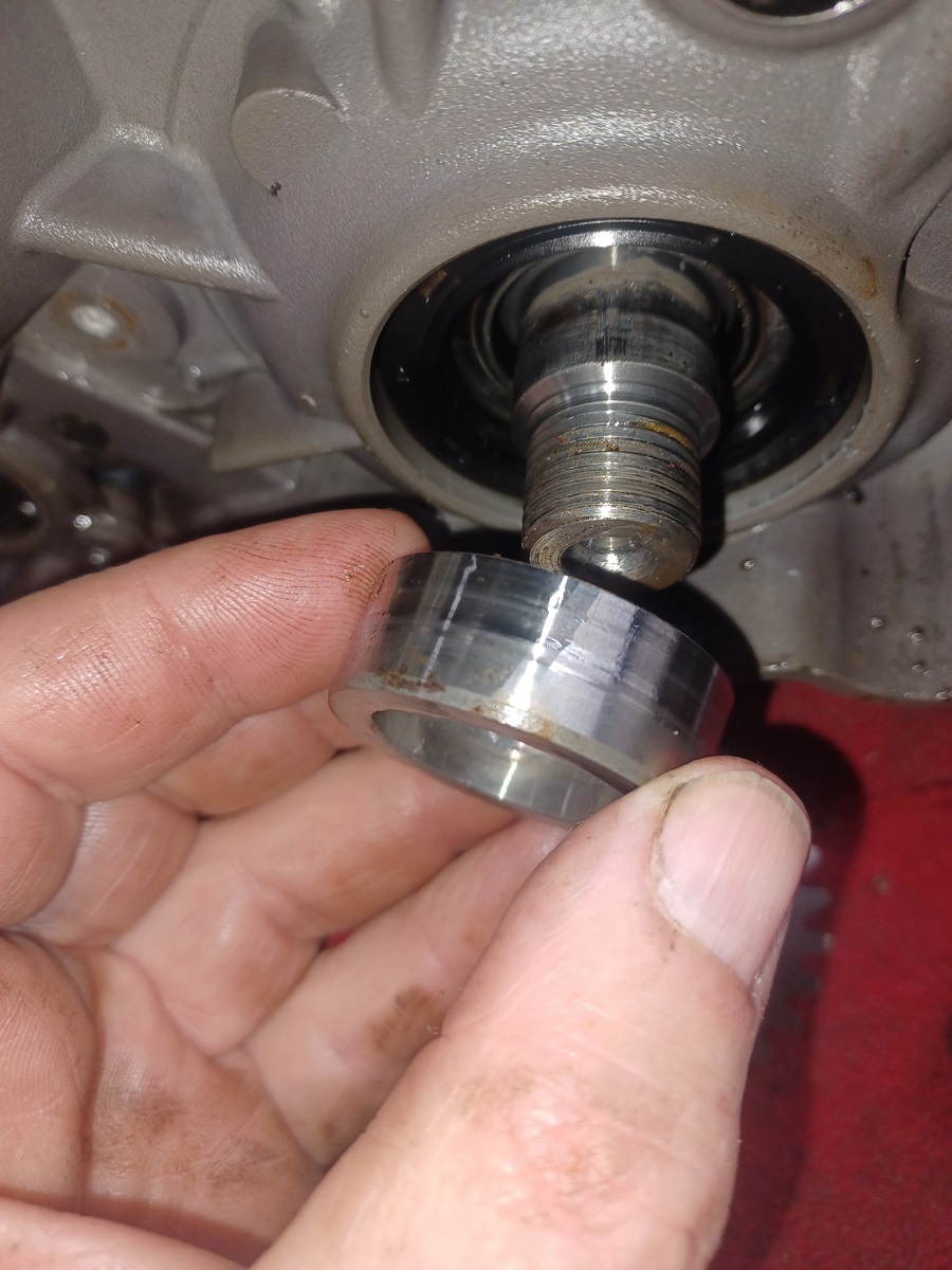

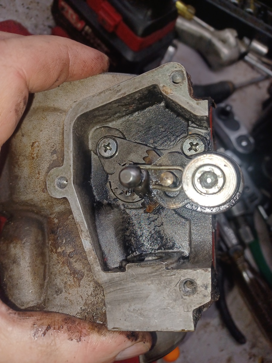

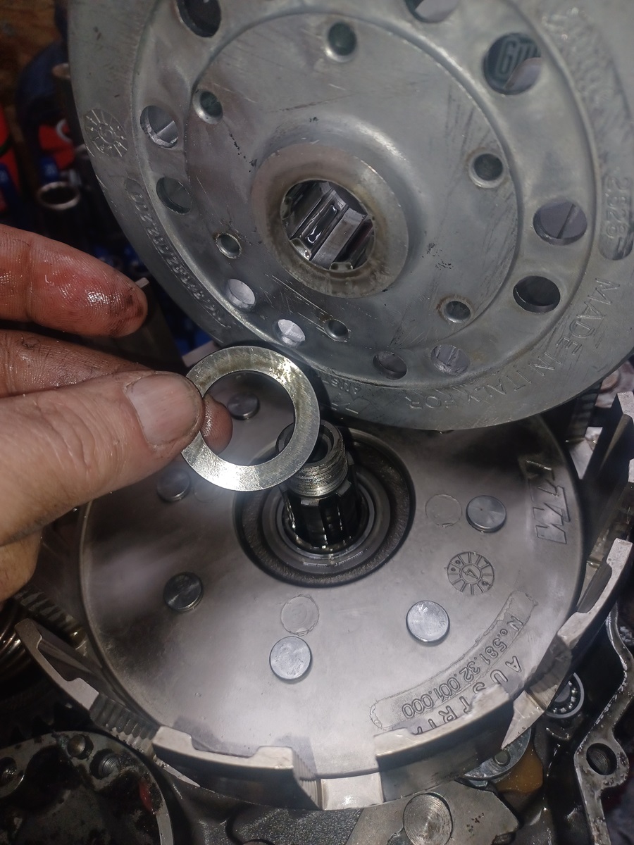

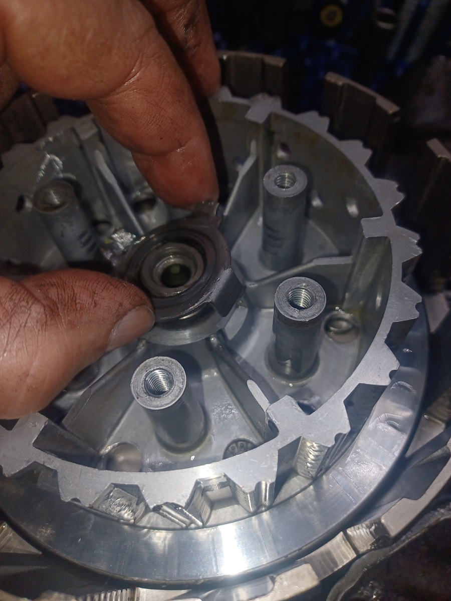

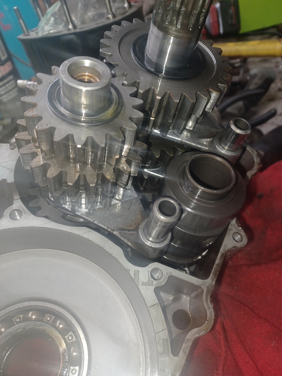

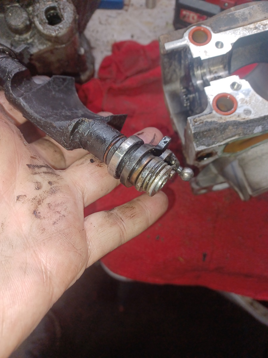

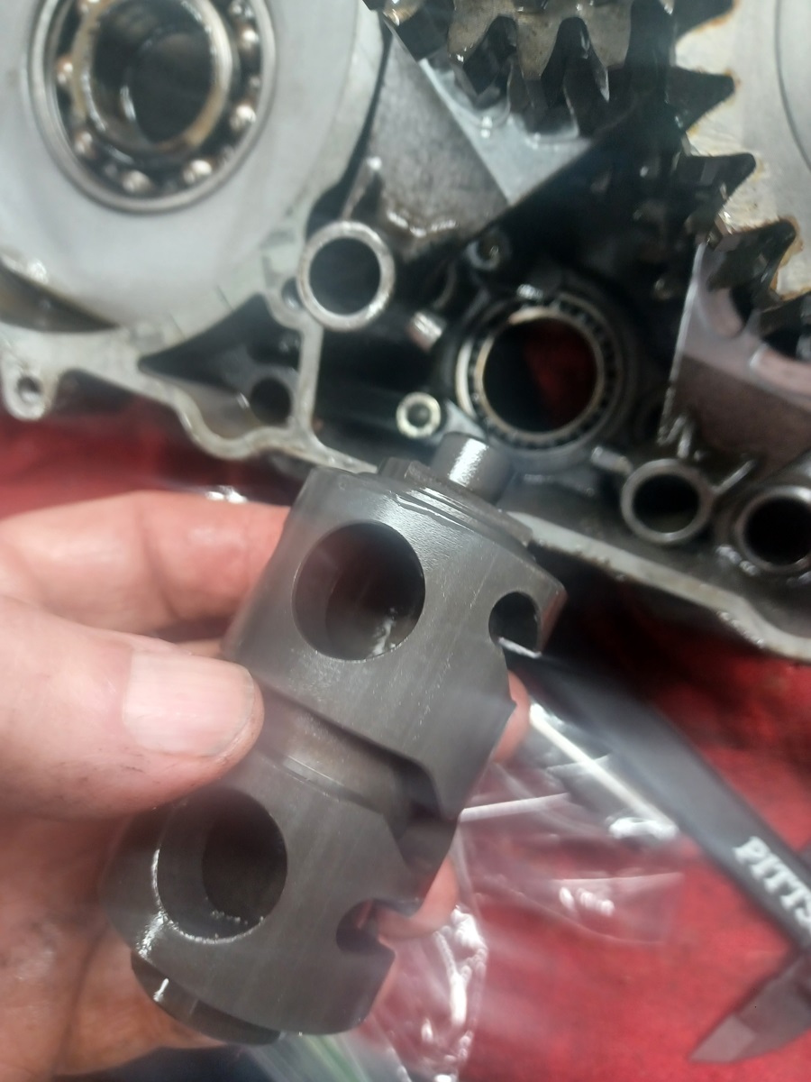

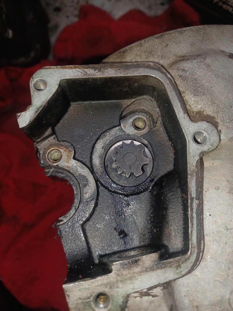

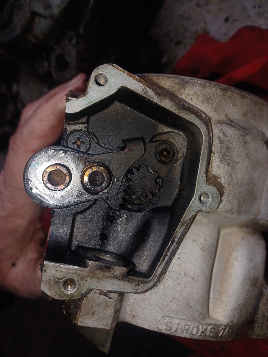

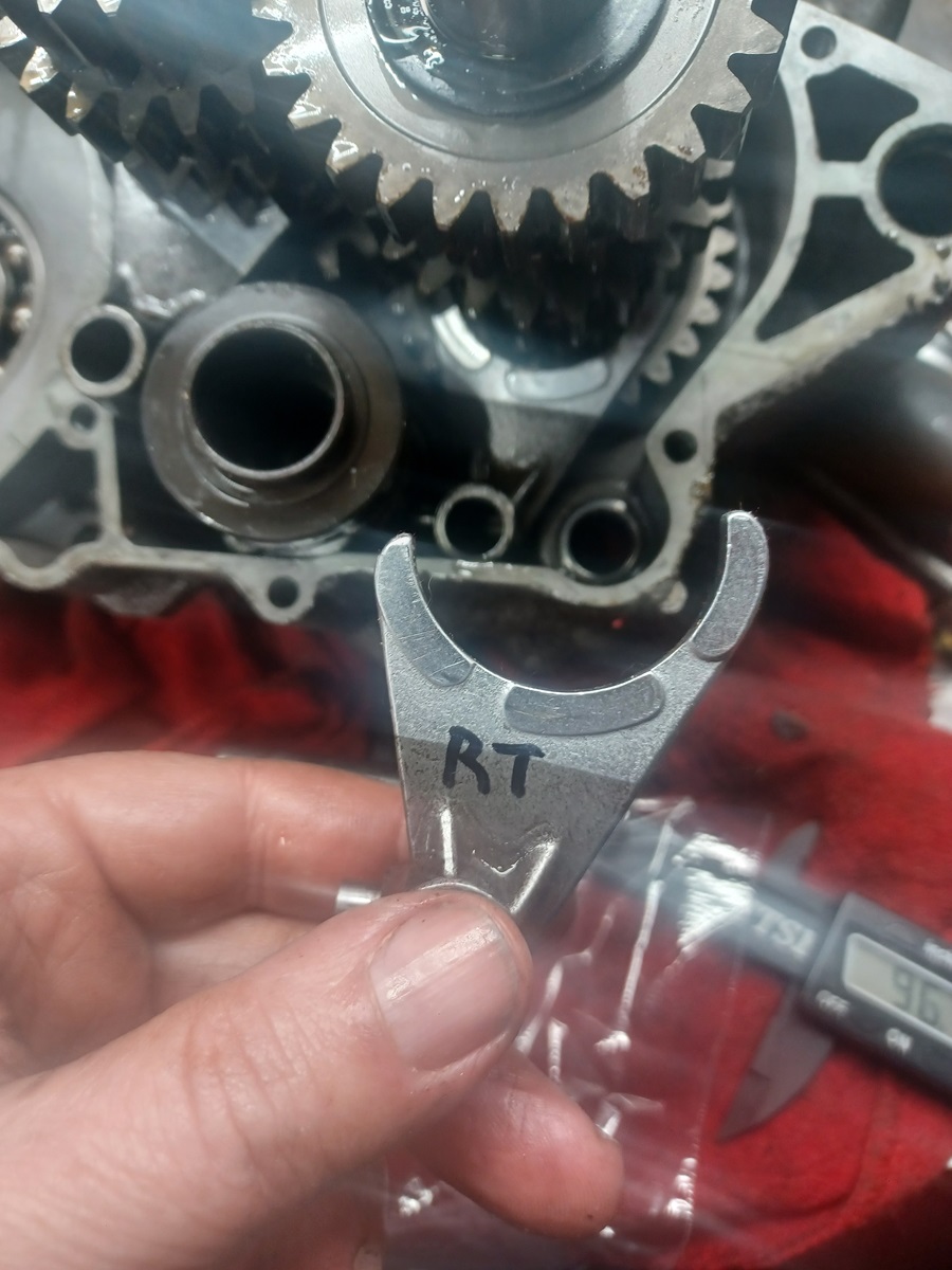

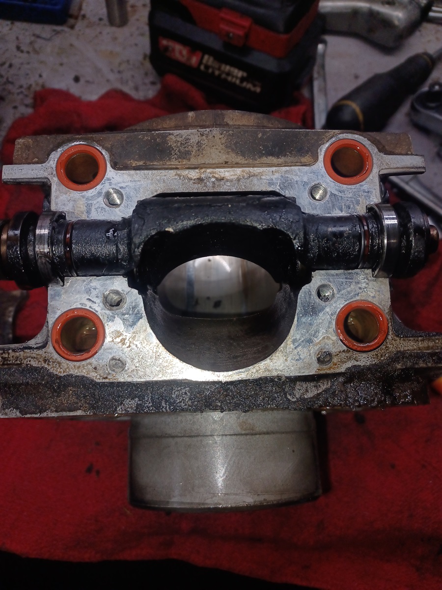

I will be posting a pictorial to show how it comes apart.
These pics are for reference so that I remember how it all goes back together :lol:
