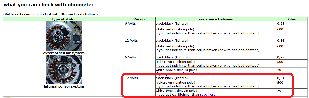

If you are still getting nothing... Check your ohm specs.
Yes, you will need a ohm meter.
You can get one for less than 30 dollars at your local hardware or home improvement store.
Here are the specs.
ohm specs for stator.png (136.86 KiB) Viewed 12691 times
Re: KX500 Panthera Electric starter issues and solutions
Black to black is not a issue unless your having difficulties with the charging system... but check it anyway and record your numbers...
Do not expect to match these numbers 100%.
The impedance or internal resistance of each ohm meter can be a little different.
+/- 10% can be expected, so here is a test range
Black to black .31 - .38
Red to brown 450 - 550
White to brown 63 - 77
For White to brown spec there is a note at the bottom.
"If you get a ca 35ohms, than read here" (Translations are wonkey :lol: )
That link goes to another page that says one of your coils is bad...
