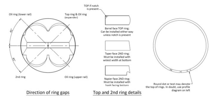

Inspect the piston ring end gap in your cylinder, approximately 13mm (.500”) down from the top of the cylinder.
Install one piston ring at a time, use the piston to assure the ring is flat and square to the cylinder bore. Ring gap
can be measured using a feeler gage

NOTE: Piston ring oil rails should be a minimum gap of .35 – 1.0mm (.014 - .040”)
NOTE: Three piece oil ring separators should be installed with the ends butted only, and not overlapped
NOTE: Two piece oil rings require that the coil expander gap is located opposite of the rail end gap
NOTE: Top and second ring axial clearance should be between .03 - .04mm (.0011 - .0015”)
