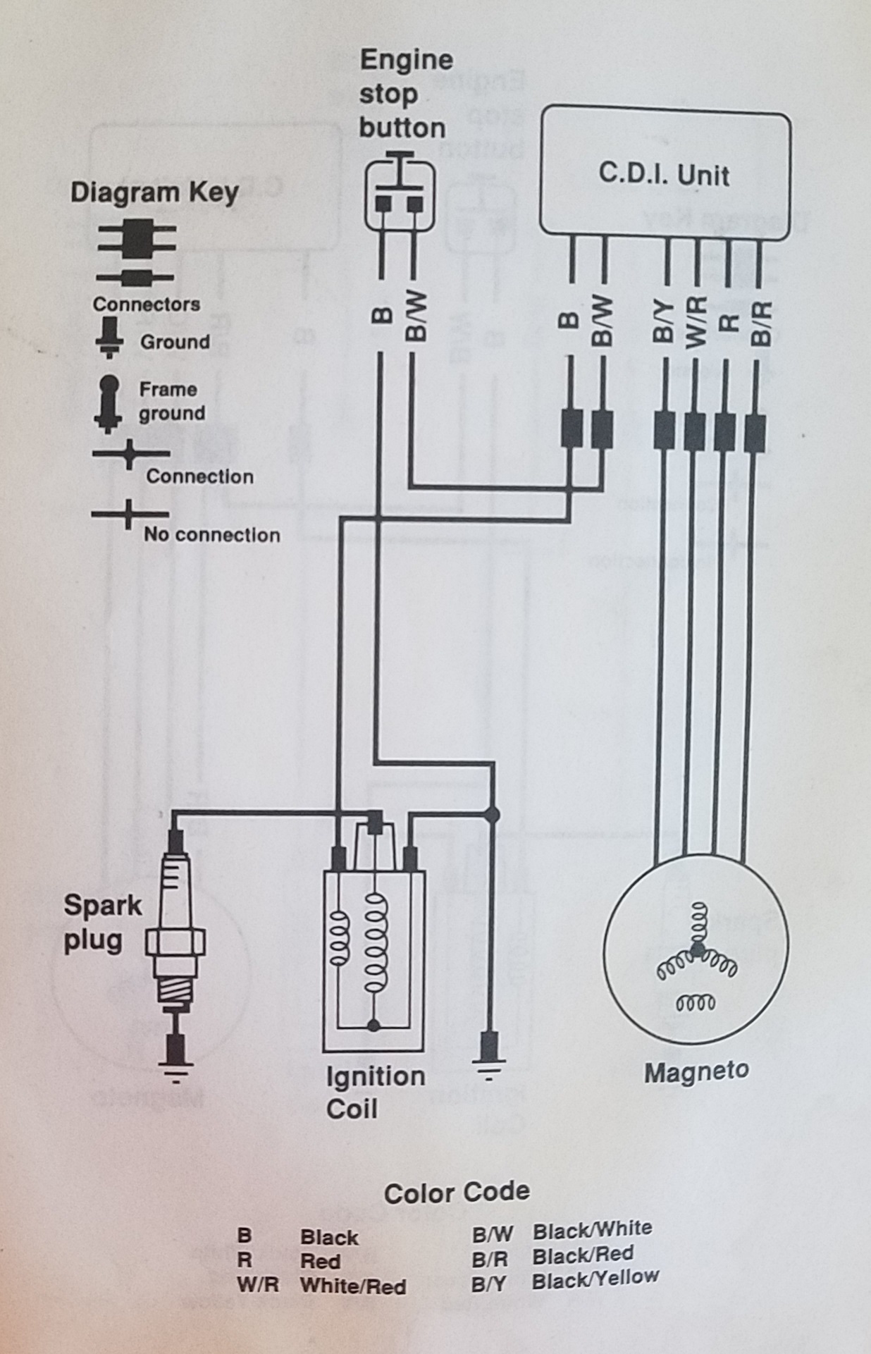

Re: KX500 ELECTRICAL SPECS & WIRING DIAGRAM

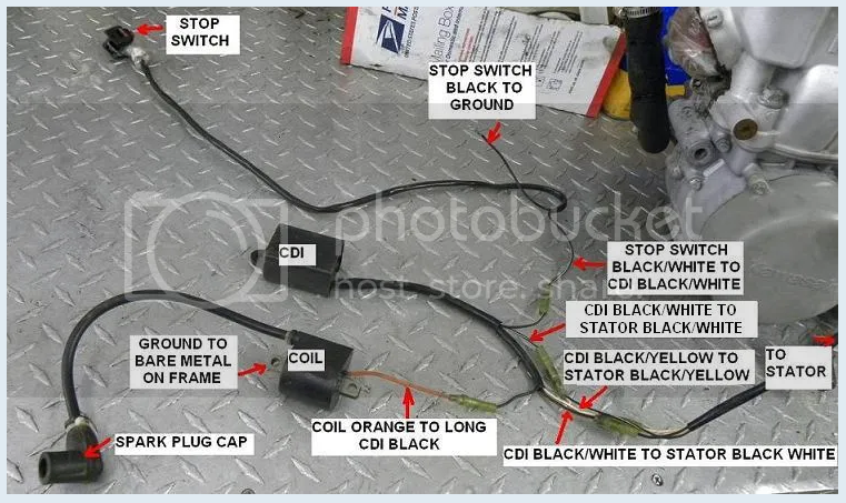

83-85 KX500
83-85 KX500.jpg (459.29 KiB) Viewed 11941 times

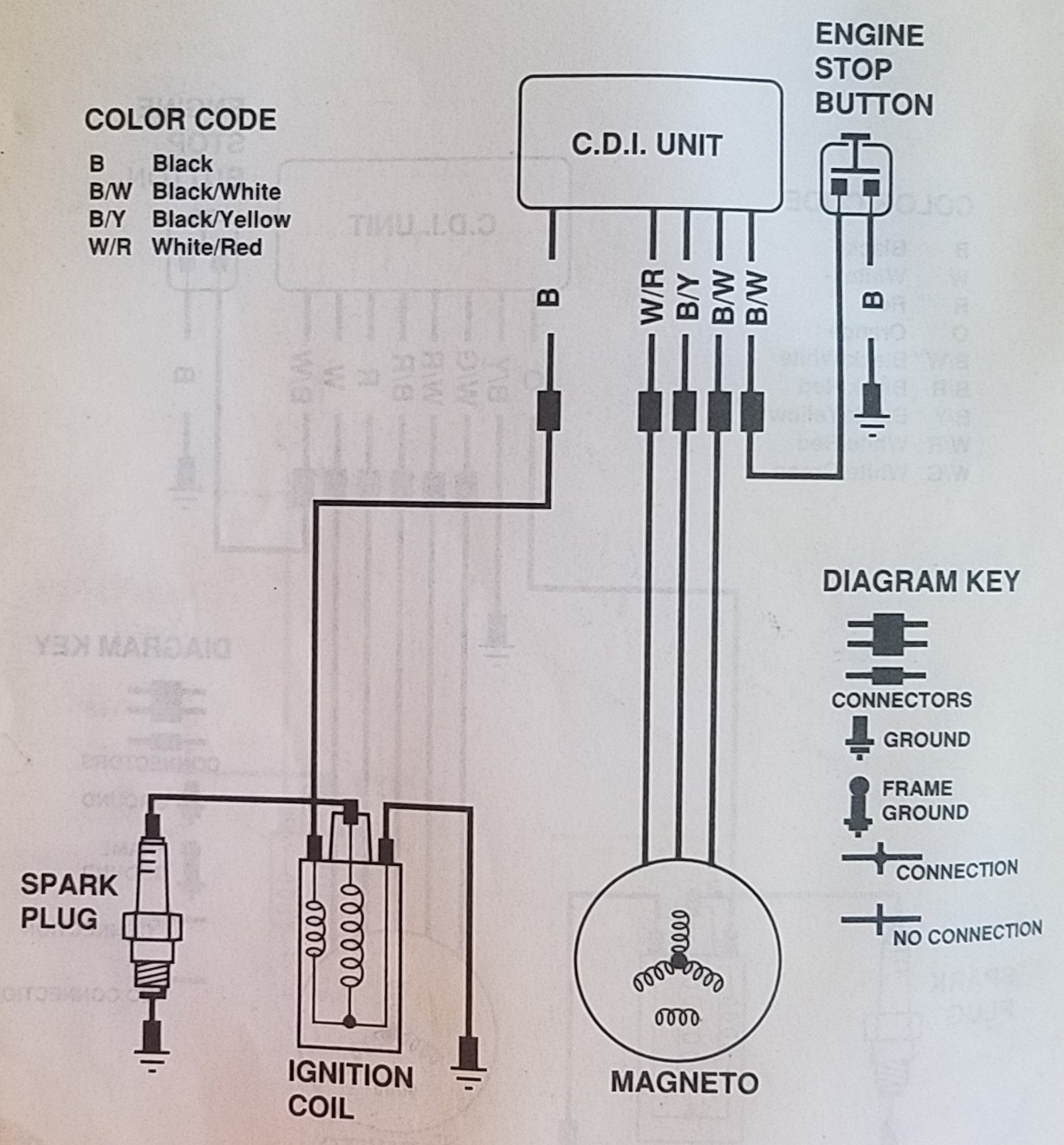

1986 KX500
86 KX500.jpg (565.64 KiB) Viewed 11941 times

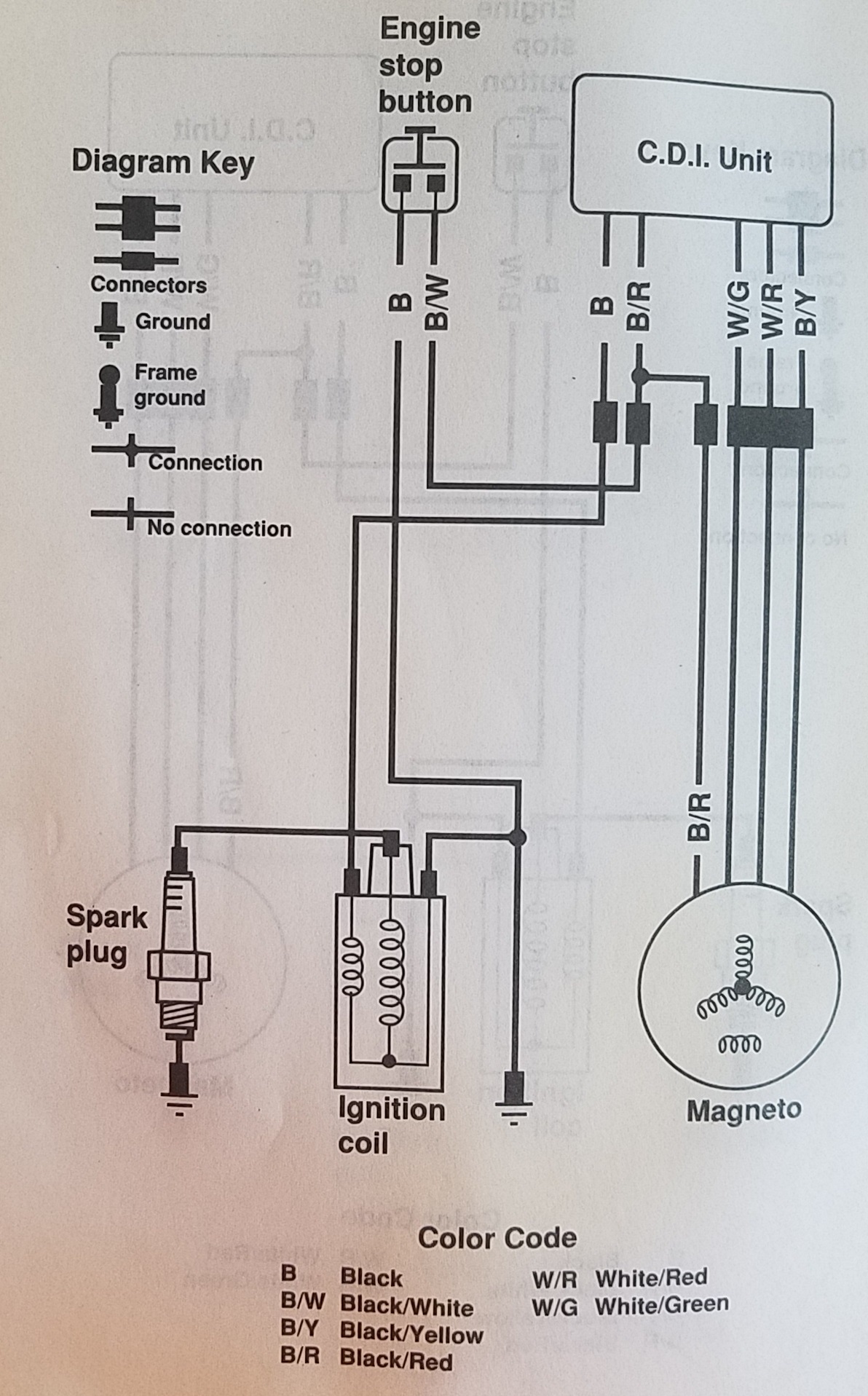

1987 KX500
1987 KX500.jpg (483.22 KiB) Viewed 11941 times

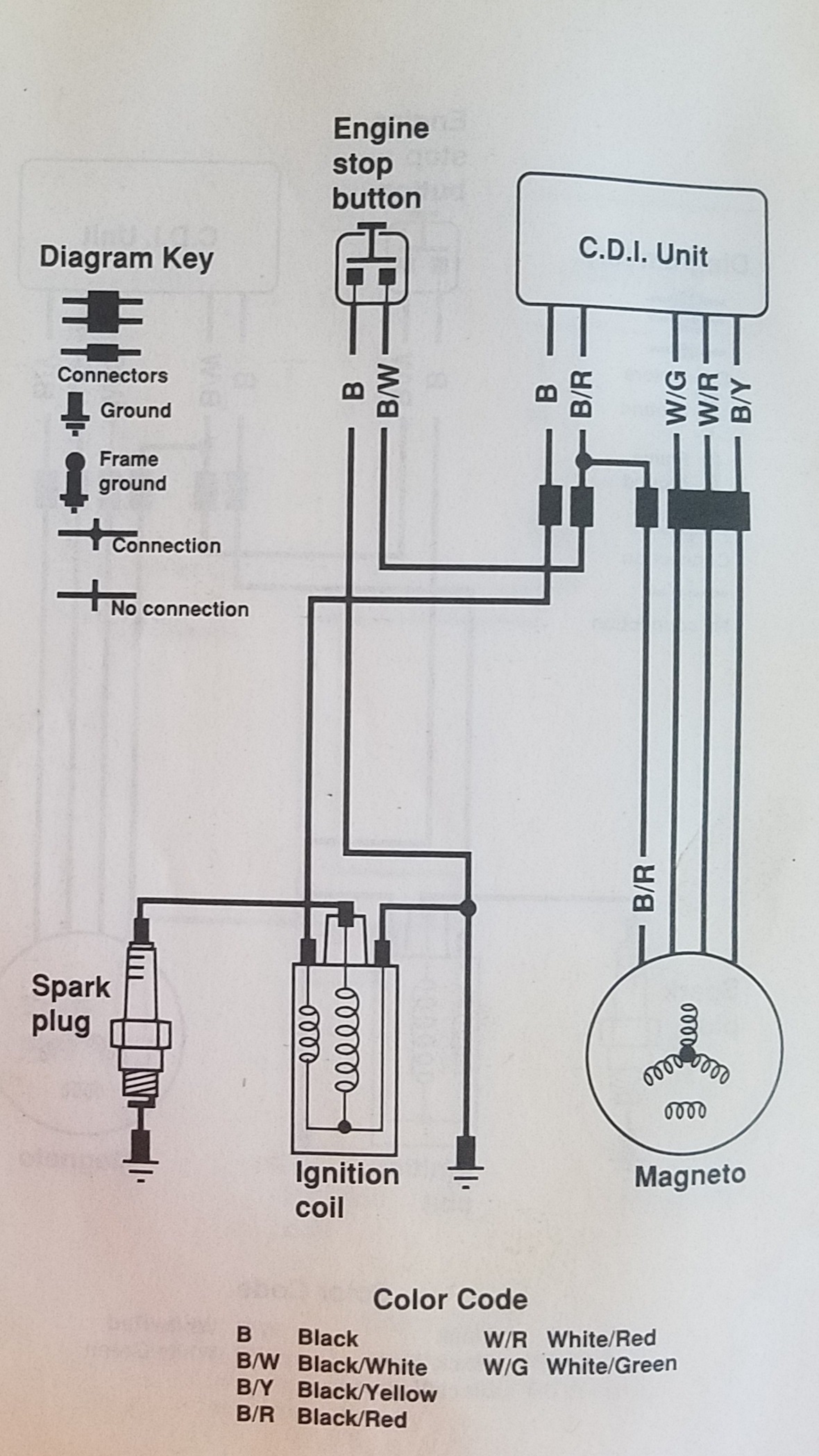

1988 KX125 KX250 KX500
88 KX125 KX250 KX500.jpg (522.12 KiB) Viewed 11940 times

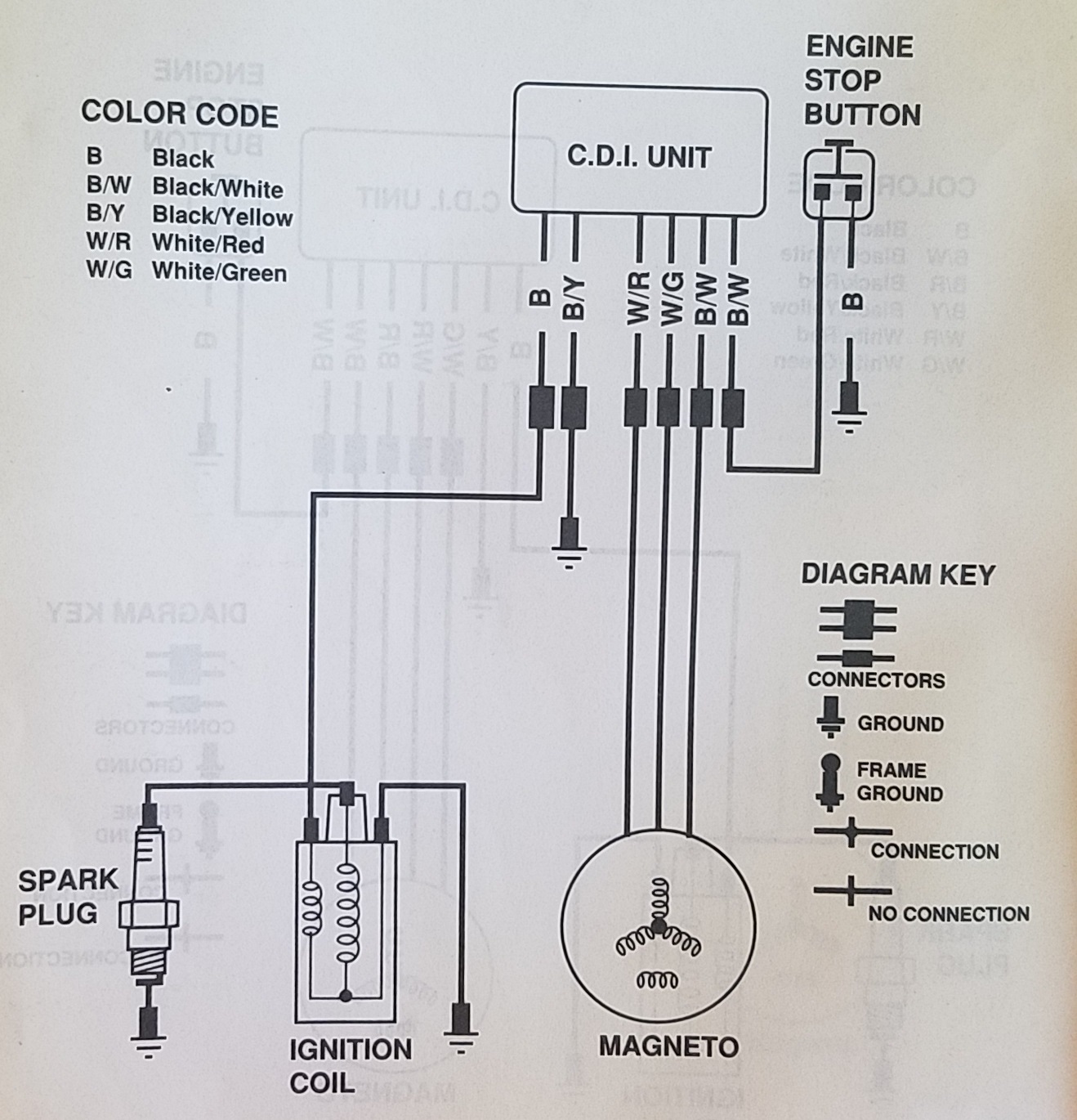

1989 KX500
1989 KX500.jpg (415.29 KiB) Viewed 11940 times

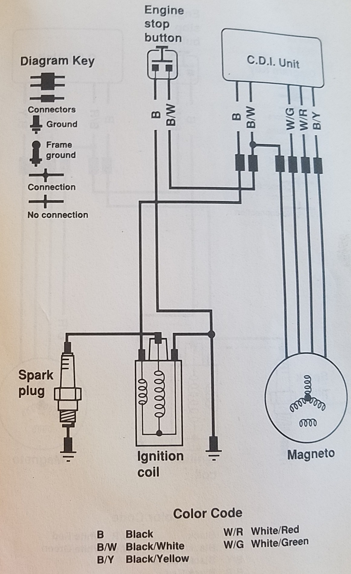

1990-2004 KX500
90-04 KX500.jpg (374.04 KiB) Viewed 11940 times
ELECTRICAL SPECS KX500 1990-2004.png (546.89 KiB) Viewed 11938 times
