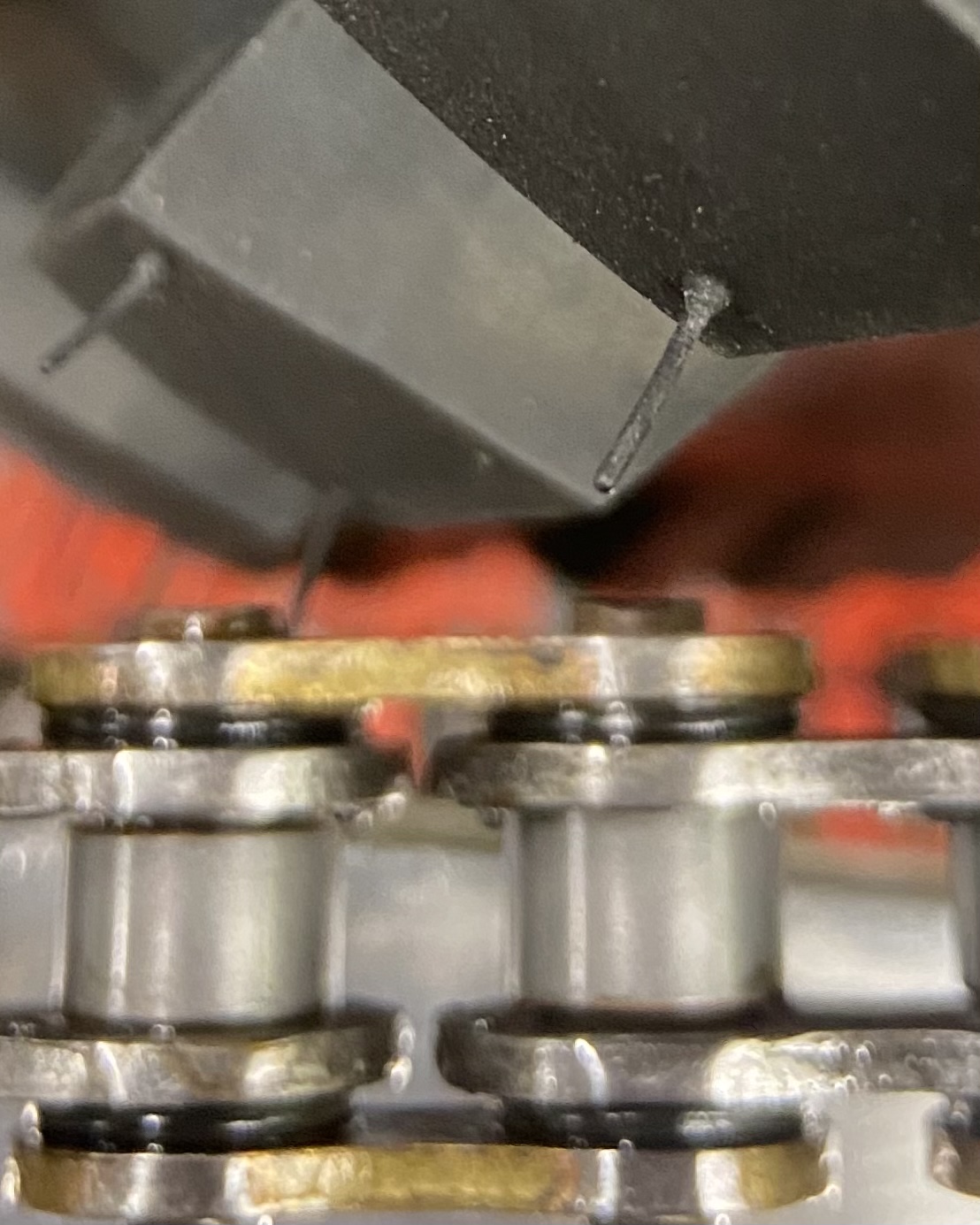

Well, for anyone out there who wants to try this tire on a KX500, it fits. Barely. But, it fits. The chain is the only obstacle. I’ll let y’all know how I like this tire when I get a chance to ride it. Here’s a quick pic.
